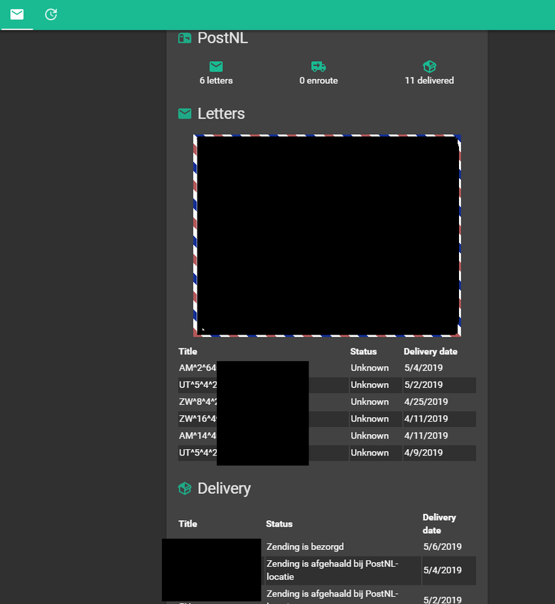

Vind het wel lekker overzichtelijk werken ook, voor wat ik in HA wil tonen maak ik een sensor aan die ik vul met de MQTT waarde (MQTT discovery staat uit).
Afbeeldingslocatie: https://i.imgur.com/20xij0f.png

  • JBS
JBS
Toevallig meer mensen die problemen ervaren met het custom updater component https://github.com/custom-components/custom_updater?
De twee bestanden geplaatst in config\custom_components\custom_updater
Afbeeldingslocatie: https://community-home-assistant-assets.s3.dualstack.us-west-2.amazonaws.com/original/3X/b/3/b3dc83c9ec0c8c9abf0cb2b68ff57144840ccd23.png
In configuration.yaml:
YAML:
custom_updater:
  component_urls:
    - https://raw.githubusercontent.com/xirixiz/Home-Assistant-Sensor-Afvalwijzer/master/custom_updater.json
    - https://raw.githubusercontent.com/peternijssen/lovelace-postnl/master/tracker.json
In ui-lovelace.yaml:
YAML:
resources:
  - url: /customcards/monster-card/monster-card.js
    type: js
  - url: /customcards/github/custom-cards/tracker-card.js?track=true
    type: module
  - url: /customcards/slider-entity/slider-entity-row.js
    type: js
  - url: /customcards/postnl-card.js
    type: module
En in ui-lovelace.yaml:
YAML:
cards:
  - type: custom:tracker-card
    title: Updates
    trackers:
      - sensor.custom_card_tracker
      - sensor.custom_component_tracker
Error log:
Log Details (ERROR)
Fri May 03 2019 09:42:36 GMT+0200 (Midden-Europese zomertijd)
'local_location'
File "/usr/local/lib/python3.7/site-packages/homeassistant/components/websocket_api/commands.py", line 121, in handle_call_service
connection.context(msg))
File "/usr/local/lib/python3.7/site-packages/homeassistant/core.py", line 1138, in async_call
self._execute_service(handler, service_call))
File "/usr/local/lib/python3.7/site-packages/homeassistant/core.py", line 1160, in _execute_service
await handler.func(service_call)
File "/config/custom_components/custom_updater/__init__.py", line 110, in check_all_service
await components_controller.cache_versions()
File "/config/custom_components/custom_updater/__init__.py", line 222, in cache_versions
information = await self.pyupdate.get_sensor_data(True)
File "/config/deps/lib/python3.7/site-packages/pyupdate/ha_custom/custom_components.py", line 64, in get_sensor_data
local_file = self.base_dir + str(component['local_location'])
KeyError: 'local_location'
Wanneer ik op 'Check' klik:
Afbeeldingslocatie: https://i.imgur.com/OqkClzv.png
Iemand een idee?

Misschien is deze custom Postnl component hier al bekend maar ik vind m super, vervangt de app volledig.
https://community.home-as...lovelace-postnl/112433/48
postnl
  • JBS
JBS
SPX420 schreef op dinsdag 7 mei 2019 @ 12:08:
[Afbeelding: postnl]
Klopt, vrij uitgebreid en het mooie is ook dat je kunt configureren wat je wel en niet wilt zien.
Bijvoorbeeld niet de brieven tonen, geen foto van de meest recente inkomende brief, etc.: https://github.com/peternijssen/lovelace-postnl
De brieven/pakketten zijn ook klikbaar en verwijzen naar de PostNL Track&Trace pagina.
