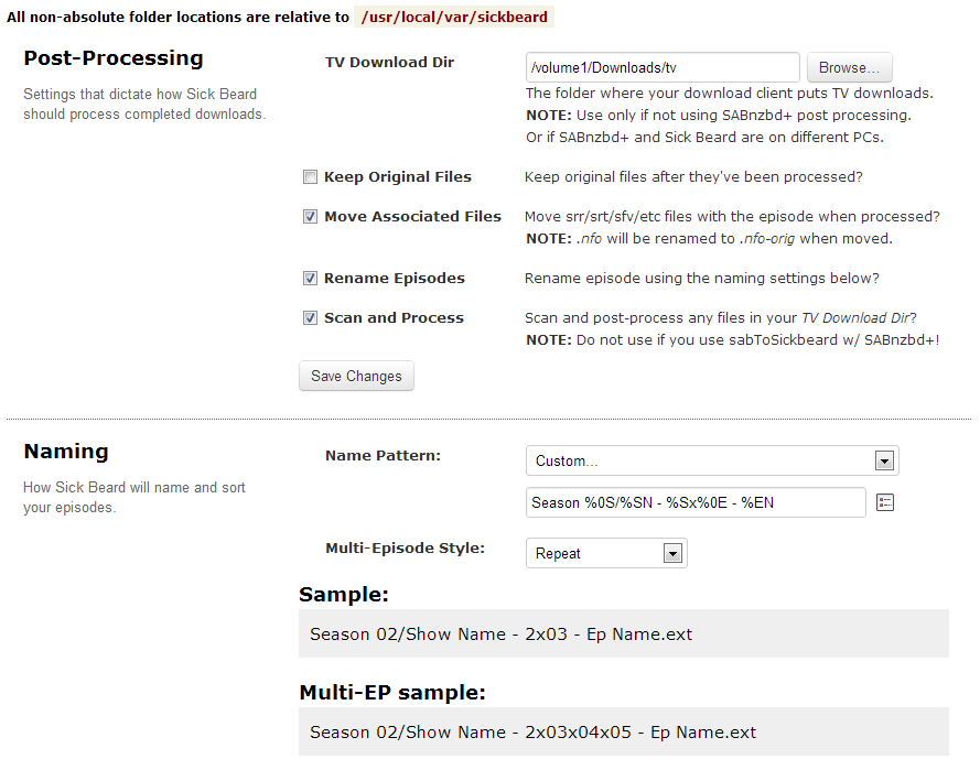

schumi2004 schreef op donderdag 29 november 2012 @ 12:21:
@nzbget
Currently i'm trying with the default settings. (Not the modified script you posted)
My destination folder is /volume1/nzbget/Movies or Series (AppendCategorie enabled)
Post processing starts and is successful (according debug log) but for some reason they stay in /volume1/nzbget/Movies or Series
I don't see any lines that say moving to /volume2/movies or /volume1/series/<seriename>/<season>/etc.
http://pastebin.com/HNLWDhVv
NZBGet comes with the default post-processing script which neither move completed files nor have support for SickBeard/CouchPotato.
I see the log line "Post-Process: Running SickBeard's postprocessing script" meaning you are using a custom post-processing script. Can you post it along with its conf-file.
Are there any logs in SickBeard? I must admit I have never used SickBeard or CouchPotato. I probably have to install and play with them to understand the integration questions/issues better.

Please try following. In your post-processing script there is a line
  $PythonCmd $SabToSickBeard "$NZBPP_DIRECTORY" "$NZBPP_NZBFILENAME" >/dev/null 2>&1
the redirecting ">/dev/null 2>&1" eats all error messages. remove it:
Now you might have more logging entries in nzbget. May be the SabToSickBeard-script prints some error messages because of the redirecting to nul.

I think i found the problem, took a while but i'm close.
Thu Nov 29 2012 13:55:44    Post-Process: Not enough arguments received from SABnzbd. Please update it.
INFO    Thu Nov 29 2012 13:55:42    Post-Process: Running SickBeard's postprocessing script
I think my current SickBeard script can't be used by NZBget since it doesn't return the proper values for failed download handling like SAB does, so going to replace that 1.

Are you using sabToSickBeard-script which comes with Sick-Beard?
The current file should print another error message:
"No folder supplied - is this being called from SABnzbd?"
The oldest history entry in SeakBeard source control is from "Nov 26, 2009" and it has the same message.
So I wonder where do you get your version of sabToSickBeard.py from?
I googled for "Not enough arguments received from SABnzbd. Please update it." and guess what I've found? This message is printed by sab2CouchPotato.
I think you have missoncfigured your post-processing script and have put the path to "SabToCouchPotato" in the option which should hold path to "SabToSickBeard".

No, it's a modified version which comes with a SickBeard version which can handle failed downloads
sabToSickBeard.py http://pastebin.com/aEPfW4dk
Modified SickBeard https://github.com/Tolstyak/Sick-Beard/tree/development
https://github.com/Tolsty...01f17766fb9d752f0606a2ed7
Now testing with default script.
schumi2004 schreef op donderdag 29 november 2012 @ 14:17:
I see.
The script expects the following parameters:
# SABnzbd argv:
# 1 The final directory of the job (full path)
# 2 The original name of the NZB file
# 3 Clean version of the job name (no path info and ".nzb" removed)
# 4 Indexer's report number (if supported)
# 5 User-defined category
# 6 Group that the NZB was posted in e.g. alt.binaries.x
# 7 Status of post processing. 0 = OK, 1=failed verification, 2=failed unpack, 3=1+21
From these params it uses only 1,2 and 7.
Then you should to modify the calling code.
From
to something like this:
$PythonCmd $SabToSickBeard "$NZBPP_DIRECTORY" "$NZBPP_NZBFILENAME" 0 0 0 0 0

Kan iemand mij adviseren / de goede kant op schoppen wat betreft het sorteren van tv-series met NZBGet?
Ik gebruik nu sab, maar wil in verband met een snellere internetverbinding overstappen naar NZBGet.
NZBGet draait, download alles netjes naar /volume1/Downloads, maar mijn series moeten zoals vanouds naar een hele andere map, en netjes per serie/seizoen en dergelijke.
Hoe het al geruime tijd werkt in sab:
Afbeeldingslocatie: http://tweakers.net/ext/f/amylBAGiRXByF3GiPzenE0aG/full.png
Afbeeldingslocatie: http://tweakers.net/ext/f/tHjVBCCII3e8tzuNKn5o4MWG/full.png
Nu heb ik geprobeerd om het postprocessen over te laten nemen door sickbeard, maar daar heb ik eigenlijk weinig aan. Sickbeard kan immers alleen binnen mijn standaard downloadmap ( /volume1/Downloads) renamen, maar niet verplaatsen naar een totaal andere map zoals ik sab liet doen.
Edit: oh, hij lijkt nu wel te snappen waar alles heen moet, alleen maakt hij geen seasonmapjes terwijl de boel zo ingesteld staat:
Afbeeldingslocatie: http://tweakers.net/ext/f/PdQN2iUbkeFfthLkighIEmkd/medium.png
[ Voor 14% gewijzigd door Gizz op 30-11-2012 17:20 ]
  • SidewalkSuper
  • Laatst online: 10:41
Heeft Sickbeard create rechten in die folder?
  • Gizz
  • Laatst online: 12:23
Gizz
Dunder-Mifflin, Inc.
Opgelost! De serie waarmee ik aan het testen was had stiekem de optie flatten folders aan staan O-)
