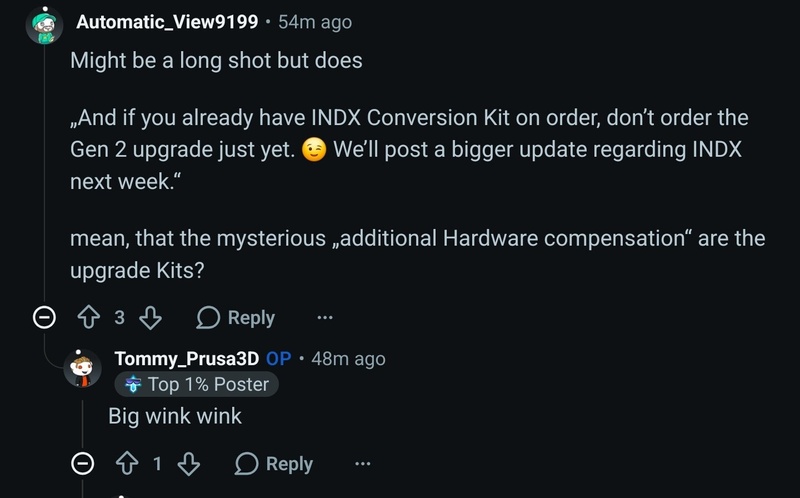

Net een mailtje gehad van Prusa:
INDX verzending is uitgesteld tot mid augustus in verband met eerder genoemd nozzle issue. Het kan zelfs nog later worden maar dat ligt aan de oplossing en supply vanuit bondtech.
Geven wel aan dat er extra hardware als een sorry bij de eerste batch INDX conversie kits wordt gestopt. Wat dit is staat er niet bij.
Inhoud van de hele mail voor de compleetheid:
Update Regarding Your INDX Order - Nozzles & Shipping
Hi,
Thanks again for being part of the first wave of the INDX Conversion kit for the CORE One/+ printer. With the founders wave having been shipped out, we’ve been seeing some amazing feedback and projects from the community, as well as many videos from creators, such as a recent feature from Linus Tech Tips! While we're extremely excited to get the product to you soon, there are a few important updates that you need to be aware of, so lets rip the bandaid off with the most critical of news:
Shipping postponed until mid-August
We planned to start shipping the INDX conversion kits for CORE One/+ by the end of July. We have now postponed the start of shipping until mid-August.
This decision is the result of a recent update from Bondtech.
Bondtech has recently confirmed that the nozzles currently supplied with the INDX system are surface-hardened rather than fully hardened as originally planned, and has not yet finalized the compensation plan for affected customers. We believe it is better to wait until both we and you have clearer information, rather than ship the kits while this important question remains unresolved.
More important information about the supplied nozzles
If you bought the INDX with the intention of printing mainly abrasive filaments, the currently available configuration is not suitable for this purpose. Bondtech specifically mentions in their Wednesday’s blog post: “The currently shipped nozzles are great for the vast majority of 3D prints and an incredibly wide range of filaments (PLA, PETG, ABS, ASA, TPU, TPE, PVA, BVOH, HIPS, PC, Nylon, PP, PBT, unfilled PC Blend, and other non-abrasive materials). These materials will perform exactly as they should with the high-quality steel nozzle you received. Materials like Prusa Galaxy filaments and similar are also fine as they do not contain abrasive particles.”
As soon as we learned about the issue, we shifted our focus specifically onto abrasive filaments, and these were our early findings:
After printing 5 kg of PETG-CF on several printers, the nozzles still showed great print quality and little to no wear. However, when printing just 100g of our super-abrasive Ultraglow filament, the protective coating appears to wear through. And after that, the performance degrades rapidly, causing wider extrusion lines and reducing print accuracy before making the nozzle completely unusable. This is likely why we didn't pick up on this during our own testing, as while many testers tried abrasive materials, it was with limited quantities and alternating nozzles and with great results.
We are also updating the product information in our e-shop to reflect the current nozzle specification and its suitability for different materials.
Per Bondtech, the manufacturing of the INDX tools (nozzles) is very difficult at scale. This is also slowing the supply for us. We may not receive enough tools to complete the full first batch by the end of August, but we will ship every conversion kit we can.
What we are doing for you as a Prusa customer
Proper hardened nozzles are probably quite far away. We didn’t want to sit idly, so regardless of the solution Bondtech ultimately offers, we’re adding something on top of that. We will include additional hardware for the initial batch Prusa INDX conversion kit orders, at our own expense. We will be sharing specifics about it in the near future (before shipping), and you’ll know it when you see it.
As for the hardened nozzles, we are waiting for details from Bondtech and cannot provide a reliable availability date or price. Developing, validating and preparing these nozzles for serial production is expected to take time.
All INDX Conversion kits for the CORE One/+ orders will ship in order, based on the date and time of the order.
Your return and refund options
It goes without saying that you can, of course, cancel your order anytime before the shipment and receive a full refund. As mentioned in the beginning, shipping has been postponed to mid-August, giving you additional time to review this information and decide whether you would like to keep or change your order. And even after delivery, you will still be covered by our extended 60-day return policy.

Nieuwe versies van de core one+ en xl. https://www.prusa3d.com/p...e-one/?a_aid=CoreOne+Gen2
https://all3dp.com/4/prus...-core-one-and-core-one-l/
The Prusa XL+, Core One L+, and second-generation Core One+ bring nozzle wiping, revised belts, and other quality-of-life upgrades while existing owners are promised upgrade paths.
Prusa XL+ adds a Tool Offset Sensor that Prusa claims aligns toolheads around 20 times faster.
Core One+ (Gen 2) drops the “absorbing heat” step for beds at 85 °C or lower.
Prusa is selling the refreshed XL+, Core One+, and Core One L+ without price increases.
The hardware refresh also arrives alongside a string of upcoming announced additions to Prusa’s ecosystem.
The company says the first INDX automatic toolchanger systems for the Core One+ are close to shipping and will be fully compatible with Gen 2 machines. Customers who already ordered a Bondtech INDX Conversion Kit will receive the Gen 2 hardware upgrade at no additional cost. Prusa is also testing INDX on the larger Core One L.
*edit* inmiddels blog post hier: https://blog.prusa3d.com/...ig-product-update_137539/

Heel nice, meteen maar besteld voor de printer waar ik geen INDX op ga zetten. Ik hoop stiekem een beetje dat de upgrade kit met de INDX mee gaat komen voor de andere printer.
Ontwikkelaar van de OpenQuatt hardware en Itho Daalderop warmtepomp control module
  • Caelorum
  • Laatst online: 21:38
leejoow schreef op donderdag 13 augustus 2026 @ 18:34:
Afbeeldingslocatie: https://tweakers.net/i/bHwu2bRBiZQQjaMOgGM6FNN_cj4=/800x/filters:strip_icc():strip_exif()/f/image/hV27tUv02wAvNWfu4NCWCyI2.jpg?f=fotoalbum_large
Maar we gaan het volgende week horen

  • 8-tool INDX kit: €140 Prusa Store credit or €104 cash refund.
  • 4-tool INDX kit: €70 Prusa Store credit or €52 cash refund.
We will send out the vouchers via email in waves, synchronized with the shipping of individual INDX batches. If you can’t find the voucher in your inbox within 2-3 days after your INDX has arrived, please contact our tech support team. If you prefer the cash refund instead, you can request it by reaching out to our support via live chat or email.
An additional gift from us
In the previous email, we’ve teased that regardless of the solution Bondtech offers, we’re adding something on top of that.
 We can now reveal what it is: the newly announced hardware upgrade that turns your CORE One+ into the latest CORE One+ (Gen 2).
 We include this upgrade for the initial batch Prusa INDX conversion kit orders, at our own expense. Specifically the new belts, the belt pulleys and new thermal expansion joints, all resulting in better print quality, faster print starts and better ease of use. So you can upgrade your printer to the latest version while installing the new INDX parts. You can find the installation instructions in our CORE One+ (Gen 2) upgrade guide.
Shipping is ready to start this week
INDX Conversion Kits will ship in the existing queue, based on the date and time of the order, as we receive tool shipments from Bondtech. You do not need to do anything if you want to keep your order.
 If the current nozzle specification doesn't work for your use case, you can of course cancel your order before shipment and receive a full refund at no cost to you. After delivery, you will also remain covered by our extended 60-day return policy.
