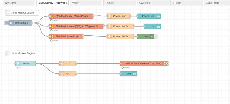

Hierbij een node-red flow.
Mocht je nog gaan beginnen met home assistant, raad ik een odroid N2+ of C4 aan, met 64 gb emmc geheugen ipv raspberry pi met sd kaartjes.
Je zal dan wel een HA image erop moeten zetten met een emmc writer.
Node-red is een add-on in home assistant
Modbus tcp/ip dient eerst aangezet te worden in de omvormer (als installateur)
Ergens SBFspot opzetten kan ook om de SMA uit te lezen. (is al wat lastiger en wat kennis van linux/ubuntu nodig)
[{"id":"c2a41e2a673aa431","type":"tab","label":"SMA 10.0 Modbus logging","disabled":false,"info":""},{"id":"ad0c97302d5711a7","type":"function","z":"c2a41e2a673aa431","name":"extract buffer data","func":"let DCCurrent1    = msg.payload[1] / 1000;       // 30769\nlet DCVoltage1    = msg.payload[3] / 100;        // 30771\nlet DCPower1      = msg.payload[5];              // 30773\nlet PowerTot      = msg.payload[7];              // 30775\nlet PowerL1       = msg.payload[9];              // 30777\n\nlet GridVoltagePhase1= 0;\nif (msg.payload[15] !== 65535) {\n    GridVoltagePhase1 = msg.payload[15] / 100;  // 30783\n}\n\nlet GridVoltagePhase2= 0;\nif (msg.payload[17] !== 65535) {\n    GridVoltagePhase2 = msg.payload[17] / 100;  // 30785\n}\n\nlet GridVoltagePhase3= 0;\nif (msg.payload[19] !== 65535) {\n    GridVoltagePhase3 = msg.payload[19] / 100;  // 30787\n}\n\nlet GridCurrent = 0;\nif (msg.payload[27] !== 65535) {\n    GridCurrent = msg.payload[27] / 1000;       // 30795\n}\n\nlet GridFrequency = 0;\nif (msg.payload[35] !== 65535) {\n    GridFrequency = msg.payload[35] / 100;       // 30803\n}\n\nlet _msg = {\n    payload: []\n};\n\n_msg.payload=\n    {\n\t\t\tdc_current1: DCCurrent1,\n\t\t\tdc_voltage1: DCVoltage1,\n\t\t\tdc_power1: DCPower1, \n\t\t\tac_power_tot: PowerTot,\n\t\t\tac_power1: PowerL1,\n\t\t\tac_voltage1: GridVoltagePhase1,\n\t\t\tac_current1: GridCurrent,\n\t\t\tac_frequency: GridFrequency\n\t}\n\n\nreturn _msg;","outputs":1,"noerr":0,"initialize":"","finalize":"","x":510,"y":120,"wires":[["287661a2b3a72589","87d7a788edcf27e6"]]},{"id":"19a145cf6ab984e5","type":"influxdb batch","z":"c2a41e2a673aa431","influxdb":"a0b0c36c.f222b","precision":"","retentionPolicy":"","name":"","database":"","retentionPolicyV18Flux":"","org":"","bucket":"","x":1260,"y":240,"wires":[]},{"id":"bb6d8051a51b24cf","type":"modbus-getter","z":"c2a41e2a673aa431","name":"DC1 - AC","showStatusActivities":false,"showErrors":true,"logIOActivities":false,"unitid":"3","dataType":"HoldingRegister","adr":"30769","quantity":"36","server":"2948ce6fd8672ea9","useIOFile":false,"ioFile":"","useIOForPayload":false,"emptyMsgOnFail":false,"keepMsgProperties":false,"x":280,"y":120,"wires":[["ad0c97302d5711a7"],[]]},{"id":"2969d96fae487185","type":"inject","z":"c2a41e2a673aa431","name":"Inject","props":[{"p":"payload"},{"p":"topic","vt":"str"}],"repeat":"15","crontab":"","once":true,"onceDelay":"7","topic":"","payload":"","payloadType":"date","x":110,"y":120,"wires":[["bb6d8051a51b24cf","40ac625183ee18be","3953ab994cb32b93","01c14fdae3e1b5ee","f87becdefd3af59d"]]},{"id":"40ac625183ee18be","type":"modbus-getter","z":"c2a41e2a673aa431","name":"Yield","showStatusActivities":false,"showErrors":true,"logIOActivities":false,"unitid":"3","dataType":"HoldingRegister","adr":"30529","quantity":"4","server":"2948ce6fd8672ea9","useIOFile":false,"ioFile":"","useIOForPayload":false,"emptyMsgOnFail":false,"keepMsgProperties":false,"x":270,"y":240,"wires":[["dc6e91529c62e64c"],[]]},{"id":"dc6e91529c62e64c","type":"function","z":"c2a41e2a673aa431","name":"extract buffer data","func":"let yieldCycle = msg.payload[0];    // 30531\nlet yieldCycleValue = 65535;    // 30531\nlet yieldCurrent = msg.payload[1];\n\nlet TotalYieldwH = (yieldCycle * yieldCycleValue) + yieldCurrent;\nlet TotalYield = TotalYieldwH / 1000;\n\nlet _msg = {\n    payload:[]\n};\n\n_msg.payload=\n    {\n\t\t\ttotalyield: TotalYield,\n\t}\n\n\nreturn _msg;","outputs":1,"noerr":0,"initialize":"","finalize":"","libs":[],"x":510,"y":240,"wires":[["287661a2b3a72589"]]},{"id":"3953ab994cb32b93","type":"modbus-getter","z":"c2a41e2a673aa431","name":"Temp - DC2 - AC","showStatusActivities":false,"showErrors":true,"logIOActivities":false,"unitid":"","dataType":"HoldingRegister","adr":"30953","quantity":"26","server":"2948ce6fd8672ea9","useIOFile":false,"ioFile":"","useIOForPayload":false,"emptyMsgOnFail":false,"keepMsgProperties":false,"x":310,"y":180,"wires":[["7920acf3e0f2e9de"],[]]},{"id":"7920acf3e0f2e9de","type":"function","z":"c2a41e2a673aa431","name":"extract buffer data","func":"let DCCurrent2 =    msg.payload[5] / 1000;      // 30957\nlet DCVoltage2 =    msg.payload[7] / 100;       // 30959\nlet DCPower2 =      msg.payload[9];             // 30961\nlet InternalTemperature = msg.payload[1] /10; // 30953\nlet _msg = {\n    payload: []\n};\n\n_msg.payload=\n    {\n\t\t\tdc_current2: DCCurrent2,\n\t\t\tdc_voltage2: DCVoltage2,\n\t\t\tdc_power2: DCPower2,\n\t\t\ttemperature: InternalTemperature,\n\t}\n\n\nreturn _msg;","outputs":1,"noerr":0,"initialize":"","finalize":"","x":510,"y":180,"wires":[["287661a2b3a72589","87d7a788edcf27e6"]]},{"id":"129c3190f4f3ef42","type":"function","z":"c2a41e2a673aa431","name":"Filter","func":"inputjson  = JSON.parse(msg.payload);\n\nvar _fields = {};\nfor(var item in inputjson){\n    _fields[item] = inputjson[item];\n}\n\nmsg.payload = [\n    {\n        measurement: \"energy\",\n        fields: _fields,\n        timestamp: new Date(),\n        tags:{\n\t\t    device: \"SMA_10.0\",\n\t\t     },\n    },\n    ];\nreturn msg;\n\n","outputs":1,"noerr":0,"initialize":"","finalize":"","libs":[],"x":770,"y":180,"wires":[["72b64f7baffc1b1e"]]},{"id":"6f354d88cd781ba7","type":"json","z":"c2a41e2a673aa431","name":"","property":"payload","action":"str","pretty":false,"x":870,"y":120,"wires":[["129c3190f4f3ef42"]]},{"id":"72b64f7baffc1b1e","type":"switch","z":"c2a41e2a673aa431","name":"","property":"payload[0].fields.dc_voltage1","propertyType":"msg","rules":[{"t":"neq","v":"0","vt":"num"}],"checkall":"true","repair":false,"outputs":1,"x":910,"y":180,"wires":[["90e44e57588ca081","c189cab7b62d51c3","19a145cf6ab984e5"]]},{"id":"287661a2b3a72589","type":"join","z":"c2a41e2a673aa431","name":"","mode":"custom","build":"merged","property":"payload","propertyType":"msg","key":"topic","joiner":"\\n","joinerType":"str","accumulate":false,"timeout":"5","count":"","reduceRight":false,"reduceExp":"","reduceInit":"","reduceInitType":"","reduceFixup":"","x":730,"y":120,"wires":[["6f354d88cd781ba7"]]},{"id":"fd9f0247602034c6","type":"join","z":"c2a41e2a673aa431","name":"","mode":"custom","build":"object","property":"payload","propertyType":"msg","key":"topic","joiner":"\\n","joinerType":"str","accumulate":false,"timeout":"2","count":"11","reduceRight":false,"reduceExp":"","reduceInit":"","reduceInitType":"","reduceFixup":"","x":870,"y":540,"wires":[["3c726ee983728226"]]},{"id":"1ec45c85574a5410","type":"change","z":"c2a41e2a673aa431","name":"V1","rules":[{"t":"move","p":"payload[0].fields.totalyield","pt":"msg","to":"payload","tot":"msg"},{"t":"set","p":"topic","pt":"msg","to":"v1","tot":"str"},{"t":"set","p":"payload","pt":"msg","to":"$string($number(payload)*1000)","tot":"jsonata"}],"action":"","property":"","from":"","to":"","reg":false,"x":690,"y":540,"wires":[["fd9f0247602034c6"]]},{"id":"400a7a30caa6bbb5","type":"change","z":"c2a41e2a673aa431","name":"V2","rules":[{"t":"move","p":"payload[0].fields.ac_power_tot","pt":"msg","to":"payload","tot":"msg"},{"t":"set","p":"topic","pt":"msg","to":"v2","tot":"str"},{"t":"set","p":"payload","pt":"msg","to":"$string(payload)","tot":"jsonata"}],"action":"","property":"","from":"","to":"","reg":false,"x":690,"y":580,"wires":[["fd9f0247602034c6"]]},{"id":"8a46548a04234309","type":"change","z":"c2a41e2a673aa431","name":"V5","rules":[{"t":"move","p":"payload[0].fields.temperature","pt":"msg","to":"payload","tot":"msg"},{"t":"set","p":"topic","pt":"msg","to":"v5","tot":"str"},{"t":"set","p":"payload","pt":"msg","to":"$string(payload)","tot":"jsonata"}],"action":"","property":"","from":"","to":"","reg":false,"x":690,"y":620,"wires":[["fd9f0247602034c6"]]},{"id":"154b0da45d5c654f","type":"change","z":"c2a41e2a673aa431","name":"V6","rules":[{"t":"move","p":"payload[0].fields.ac_voltage1","pt":"msg","to":"payload","tot":"msg"},{"t":"set","p":"topic","pt":"msg","to":"v6","tot":"str"},{"t":"set","p":"payload","pt":"msg","to":"$string(payload)","tot":"jsonata"}],"action":"","property":"","from":"","to":"","reg":false,"x":690,"y":660,"wires":[["fd9f0247602034c6"]]},{"id":"3c726ee983728226","type":"function","z":"c2a41e2a673aa431","name":"Set API key here 1","func":"msg.action = msg.payload;\nmsg.headers = { \n 'X-Pvoutput-Apikey': 'b7e91b830a121c97101b4cbff7758d1b680e1f6c',\n 'X-Pvoutput-SystemId': '88393',\n 'Content-Type': 'application/x-www-form-urlencoded'\n};\n\nreturn msg;","outputs":1,"noerr":0,"initialize":"","finalize":"","libs":[],"x":950,"y":600,"wires":[["e027eea8a8a6c979"]]},{"id":"e027eea8a8a6c979","type":"function","z":"c2a41e2a673aa431","name":"Set up data","func":"msg.action = msg.payload;\n\nmsg.url = \"http://pvoutput.org/service/r2/addstatus.jsp\";\n\n\n\nreturn msg;\n\n","outputs":1,"noerr":0,"x":950,"y":660,"wires":[["46bf45cc7833071b"]]},{"id":"46bf45cc7833071b","type":"http request","z":"c2a41e2a673aa431","name":"Post","method":"POST","ret":"txt","paytoqs":false,"url":"","tls":"","persist":false,"proxy":"","authType":"","x":950,"y":720,"wires":[["5f728c1ee833fde9"]]},{"id":"5f728c1ee833fde9","type":"debug","z":"c2a41e2a673aa431","name":"headercheck","active":false,"tosidebar":true,"console":false,"tostatus":false,"complete":"true","targetType":"full","x":950,"y":780,"wires":[]},{"id":"8ba0b372b880086c","type":"moment","z":"c2a41e2a673aa431","name":"Date","topic":"d","input":"","inputType":"date","inTz":"Europe/Amsterdam","adjAmount":0,"adjType":"days","adjDir":"add","format":"YYYYMMDD","locale":"C","output":"payload","outputType":"msg","outTz":"Europe/Amsterdam","x":690,"y":460,"wires":[["fd9f0247602034c6"]]},{"id":"1e883b51a7bfb220","type":"moment","z":"c2a41e2a673aa431","name":"Time","topic":"t","input":"","inputType":"date","inTz":"Europe/Amsterdam","adjAmount":0,"adjType":"days","adjDir":"add","format":"HH:mm","locale":"C","output":"payload","outputType":"msg","outTz":"Europe/Amsterdam","x":690,"y":500,"wires":[["fd9f0247602034c6"]]},{"id":"e66eb68ccec38888","type":"change","z":"c2a41e2a673aa431","name":"C1","rules":[{"t":"set","p":"topic","pt":"msg","to":"c1","tot":"str"}],"action":"","property":"","from":"","to":"","reg":false,"x":690,"y":860,"wires":[["fd9f0247602034c6"]]},{"id":"e8f4e36d5635207c","type":"change","z":"c2a41e2a673aa431","name":"Set Cumulative Flag","rules":[{"t":"set","p":"payload","pt":"msg","to":"1","tot":"str"}],"action":"","property":"","from":"","to":"","reg":false,"x":500,"y":860,"wires":[["e66eb68ccec38888"]]},{"id":"3b8f0170d2b27ccb","type":"change","z":"c2a41e2a673aa431","name":"V7","rules":[{"t":"move","p":"payload[0].fields.dc_voltage1","pt":"msg","to":"payload","tot":"msg"},{"t":"set","p":"topic","pt":"msg","to":"v7","tot":"str"},{"t":"set","p":"payload","pt":"msg","to":"$string(payload)","tot":"jsonata"}],"action":"","property":"","from":"","to":"","reg":false,"x":690,"y":700,"wires":[["fd9f0247602034c6"]]},{"id":"2aaee5e3752c47a6","type":"change","z":"c2a41e2a673aa431","name":"V8","rules":[{"t":"move","p":"payload[0].fields.dc_voltage2","pt":"msg","to":"payload","tot":"msg"},{"t":"set","p":"topic","pt":"msg","to":"v8","tot":"str"},{"t":"set","p":"payload","pt":"msg","to":"$string(payload)","tot":"jsonata"}],"action":"","property":"","from":"","to":"","reg":false,"x":690,"y":740,"wires":[["fd9f0247602034c6"]]},{"id":"d9c980ac767b20fe","type":"change","z":"c2a41e2a673aa431","name":"V9","rules":[{"t":"move","p":"payload[0].fields.dc_power1","pt":"msg","to":"payload","tot":"msg"},{"t":"set","p":"topic","pt":"msg","to":"v9","tot":"str"},{"t":"set","p":"payload","pt":"msg","to":"$string(payload)","tot":"jsonata"}],"action":"","property":"","from":"","to":"","reg":false,"x":690,"y":780,"wires":[["fd9f0247602034c6"]]},{"id":"72b6922da2e3cfe8","type":"change","z":"c2a41e2a673aa431","name":"V10","rules":[{"t":"move","p":"payload[0].fields.dc_power2","pt":"msg","to":"payload","tot":"msg"},{"t":"set","p":"topic","pt":"msg","to":"v10","tot":"str"},{"t":"set","p":"payload","pt":"msg","to":"$string(payload)","tot":"jsonata"}],"action":"","property":"","from":"","to":"","reg":false,"x":690,"y":820,"wires":[["fd9f0247602034c6"]]},{"id":"90e44e57588ca081","type":"delay","z":"c2a41e2a673aa431","name":"","pauseType":"rate","timeout":"5","timeoutUnits":"seconds","rate":"1","nbRateUnits":"1","rateUnits":"minute","randomFirst":"1","randomLast":"5","randomUnits":"seconds","drop":true,"allowrate":false,"outputs":1,"x":390,"y":460,"wires":[["8ba0b372b880086c","1e883b51a7bfb220","1ec45c85574a5410","400a7a30caa6bbb5","8a46548a04234309","3b8f0170d2b27ccb","2aaee5e3752c47a6","d9c980ac767b20fe","72b6922da2e3cfe8","e8f4e36d5635207c","154b0da45d5c654f"]]},{"id":"93f7593568c47a6b","type":"comment","z":"c2a41e2a673aa431","name":"change api key and system","info":"","x":1210,"y":600,"wires":[]},{"id":"a10aa105ebfa5e74","type":"comment","z":"c2a41e2a673aa431","name":"change influxdb database","info":"","x":1250,"y":280,"wires":[]},{"id":"fb194394780e461b","type":"comment","z":"c2a41e2a673aa431","name":" and connect to function block","info":"","x":1280,"y":320,"wires":[]},{"id":"cfb1b6b74b322463","type":"mqtt out","z":"c2a41e2a673aa431","name":"","topic":"","qos":"","retain":"","respTopic":"","contentType":"","userProps":"","correl":"","expiry":"","broker":"f935c11c.41462","x":1330,"y":180,"wires":[]},{"id":"cdaed63e22dd7310","type":"join","z":"c2a41e2a673aa431","name":"","mode":"custom","build":"merged","property":"payload","propertyType":"msg","key":"topic","joiner":"\\n","joinerType":"str","accumulate":false,"timeout":"4","count":"16","reduceRight":false,"reduceExp":"","reduceInit":"","reduceInitType":"","reduceFixup":"","x":1210,"y":180,"wires":[["cfb1b6b74b322463"]]},{"id":"c189cab7b62d51c3","type":"change","z":"c2a41e2a673aa431","name":"move to msg","rules":[{"t":"move","p":"payload[0].fields","pt":"msg","to":"payload","tot":"msg"},{"t":"set","p":"topic","pt":"msg","to":"sma_10.0","tot":"str"}],"action":"","property":"","from":"","to":"","reg":false,"x":1070,"y":180,"wires":[["cdaed63e22dd7310"]]},{"id":"092b5f942a03619c","type":"mqtt in","z":"c2a41e2a673aa431","name":"","topic":"sma_10.0","qos":"2","datatype":"json","broker":"f935c11c.41462","nl":false,"rap":false,"inputs":0,"x":1060,"y":80,"wires":[["77bfd1ab3b2eebc5"]]},{"id":"77bfd1ab3b2eebc5","type":"debug","z":"c2a41e2a673aa431","name":"Debug","active":false,"tosidebar":true,"console":false,"tostatus":false,"complete":"payload","targetType":"msg","statusVal":"","statusType":"auto","x":1210,"y":80,"wires":[]},{"id":"01c14fdae3e1b5ee","type":"modbus-getter","z":"c2a41e2a673aa431","name":"Earthleakage","showStatusActivities":false,"showErrors":true,"logIOActivities":false,"unitid":"3","dataType":"HoldingRegister","adr":"31247","quantity":"2","server":"2948ce6fd8672ea9","useIOFile":false,"ioFile":"","useIOForPayload":false,"emptyMsgOnFail":false,"keepMsgProperties":false,"x":290,"y":300,"wires":[["de9ebe02e078b2cd"],[]]},{"id":"de9ebe02e078b2cd","type":"function","z":"c2a41e2a673aa431","name":"extract buffer data","func":"let Earthleakage =    msg.payload[1] / 1000;      // 30225\n\nlet _msg = {\n    payload: []\n};\n\n_msg.payload=\n    {\n\t\t\tearthleakage: Earthleakage,\n\t}\n\n\nreturn _msg;","outputs":1,"noerr":0,"initialize":"","finalize":"","x":510,"y":300,"wires":[["287661a2b3a72589"]]},{"id":"f87becdefd3af59d","type":"api-current-state","z":"c2a41e2a673aa431","name":"","server":"871b27b3b6de84ae","version":3,"outputs":1,"halt_if":"","halt_if_type":"str","halt_if_compare":"is","entity_id":"sensor.daily_sma_10_0","state_type":"num","blockInputOverrides":false,"outputProperties":[{"property":"payload","propertyType":"msg","value":"","valueType":"entityState"},{"property":"data","propertyType":"msg","value":"","valueType":"entity"}],"for":0,"forType":"num","forUnits":"minutes","override_topic":false,"state_location":"payload","override_payload":"msg","entity_location":"data","override_data":"msg","x":370,"y":360,"wires":[["1a64e52054bc7119"]]},{"id":"1a64e52054bc7119","type":"function","z":"c2a41e2a673aa431","name":"extract buffer data","func":"let Todayyield =    msg.payload;      // 30225\n\nlet _msg = {\n    payload: []\n};\n\n_msg.payload=\n    {\n\t\t\ttodayyield: Todayyield,\n\t}\n\n\nreturn _msg;","outputs":1,"noerr":0,"initialize":"","finalize":"","x":650,"y":360,"wires":[["287661a2b3a72589"]]},{"id":"87d7a788edcf27e6","type":"debug","z":"c2a41e2a673aa431","name":"","active":false,"tosidebar":true,"console":false,"tostatus":false,"complete":"payload","targetType":"msg","statusVal":"","statusType":"auto","x":890,"y":40,"wires":[]},{"id":"a0b0c36c.f222b","type":"influxdb","hostname":"127.0.0.1","port":"8086","protocol":"http","database":"energy","name":"","usetls":false,"tls":"","influxdbVersion":"1.x","url":"","rejectUnauthorized":false},{"id":"2948ce6fd8672ea9","type":"modbus-client","name":"SMA 10.0","clienttype":"tcp","bufferCommands":true,"stateLogEnabled":true,"queueLogEnabled":false,"tcpHost":"192.168.2.100","tcpPort":"502","tcpType":"DEFAULT","serialPort":"/dev/ttyUSB","serialType":"RTU-BUFFERD","serialBaudrate":"9600","serialDatabits":"8","serialStopbits":"1","serialParity":"none","serialConnectionDelay":"100","serialAsciiResponseStartDelimiter":"","unit_id":"3","commandDelay":"100","clientTimeout":"1000","reconnectOnTimeout":true,"reconnectTimeout":"2000","parallelUnitIdsAllowed":true},{"id":"f935c11c.41462","type":"mqtt-broker","name":"MQTT","broker":"core-mosquitto","port":"1883","clientid":"","autoConnect":true,"usetls":false,"protocolVersion":"4","keepalive":"60","cleansession":true,"birthTopic":"","birthQos":"0","birthPayload":"","birthMsg":{},"closeTopic":"","closeQos":"0","closePayload":"","closeMsg":{},"willTopic":"","willQos":"0","willPayload":"","willMsg":{},"userProps":"","sessionExpiry":""},{"id":"871b27b3b6de84ae","type":"server","name":"Home Assistant","version":5,"addon":true,"rejectUnauthorizedCerts":true,"ha_boolean":"y|yes|true|on|home|open","connectionDelay":true,"cacheJson":true,"heartbeat":false,"heartbeatInterval":30,"areaSelector":"friendlyName","deviceSelector":"friendlyName","entitySelector":"friendlyName","statusSeparator":"at: ","statusYear":"hidden","statusMonth":"short","statusDay":"numeric","statusHourCycle":"h23","statusTimeFormat":"h:m","enableGlobalContextStore":true}]

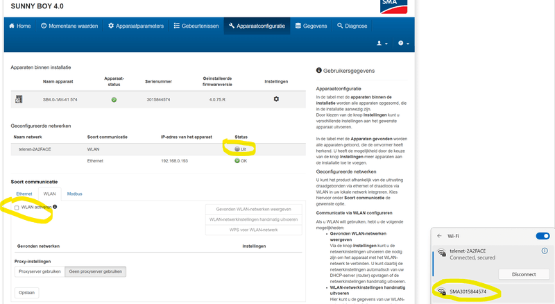

  • Jornth
  • Registratie: September 2023
  • Laatst online: 21-01-2024

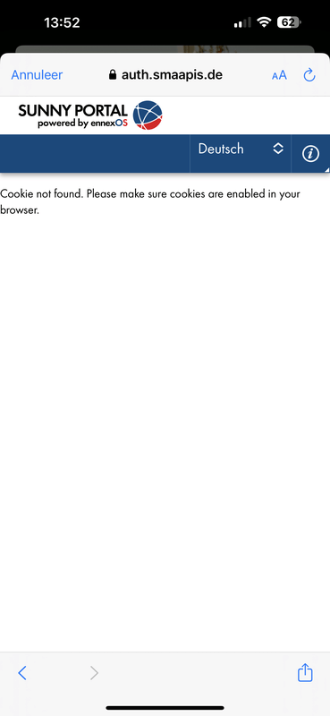

Hallo,
Ik heb een vraag m.b.t. onze nieuwe zonnepanelen installatie. De installateur heeft alles naar behoren geïnstalleerd geeft SMA ook aan, maar we komen niet verder dan de stap hieronder:
Afbeeldingslocatie: https://tweakers.net/i/vMuFpDwrh2ZKgv61TwnWlMr4RBw=/800x/filters:strip_icc():strip_exif()/f/image/iLzq12sFb6SswpG7O8qm6lCI.jpg?f=fotoalbum_large
Het kan niet liggen aan de te geringe DC-spanning zegt zowel de installateur als SMA (installateur heeft meerdere keren contact gehad, en er is ook een support case aangemaakt). SMA gaf ook aan dat ze gisteren, toen ze hier niet mee verder kwamen, meerdere meldingen van soortgelijke problemen hebben binnen gekregen.
De software is qua firmware up-to-date. Hij is verbonden met een vaste internetverbinding vanuit de router.
In plaats van te wachten tot waarschijnlijk na het weekend voor een update vanuit de installateur m.b.t. de aangemaakte case, dacht ik het hier te proberen. Wellicht met jullie kennis of soortgelijke ervaring qua problemen met de installatie dat we er achter komen in welke richting we moeten zoeken voor een oplossing.
Ik heb al e.e.a. rondgezocht, en kwam op wat sites met m.b.t. port-forwarding of DMZ instellingen. Echter is dit met de huidige omvormer van mij niet meer nodig volgens mij. Het betreft dus de Sunny Boy 4.0-1AV-41. Zie hieronder de status:
Afbeeldingslocatie: https://tweakers.net/i/ZnflIkC5HfhZARdIkoIEdOTCxoo=/800x/filters:strip_icc():strip_exif()/f/image/P79Y56bYrhkoT1UgqsjwRy9v.jpg?f=fotoalbum_large
Hopelijk kunnen jullie me op weg helpen, de installatie was al 3 weken geleden, en om verschillende redenen (vertraging met de installatie + vorige week ontbreken van de juiste landcode) duurt het dus al even, waarbij we toch al flink wat zonnige dagen hebben misgelopen.
Ter aanvulling: het blauwe lampje brandt continue, maar het groene en rode lampje knipperen.
[ Voor 2% gewijzigd door Jornth op 16-09-2023 13:21 . Reden: Ter aanvulling ]
  • Capt Waffles
  • Registratie: November 2022
  • Laatst online: 16:41
Jornth schreef op zaterdag 16 september 2023 @ 13:14:
Ik liep bij onze indienststelling tegen precies dezelfde stap vast en kreeg dezelfde melding, maar de volgende ochtend lukte het wel. Het had bij mij mogelijk wel met de spanning te maken aangezien het de avond ervoor al donker was toen ik het probeerde Aan de andere kant, een SMA instructie filmpje vermeldde dat voor dit proces geen spanning nodig is, dus zeker ben ik niet wat het gefixt heeft. Alleszins werkte het de dag erop wel.

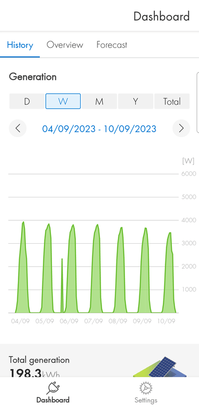

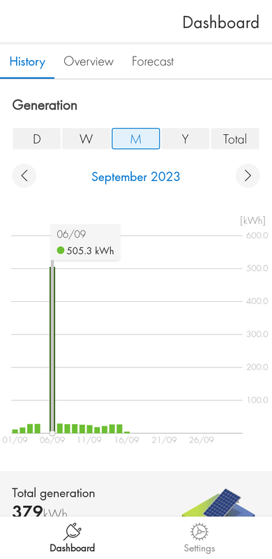

Ik kijk vrijwel nooit in de SMA app, want alles is gemakkelijker uit te lezen in HA.
6 September zag er wel raar uit.

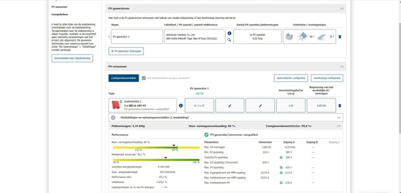

450 euro op ebay.de
Het gekke is dat die SMA batterij niet op de lijst "Compatible with the following batteries" in bovenstaande link van de SMA hybrid inverters staat. Weet jij hoe dat zit?
  • Franciesco
@Andrehj ik denk dat SMA nog niet alle documenten bijgewerkt heeft (zoals de Approved battery list).
In de datasheet van de SMA Home Storage staat de SMA hybride omvormer overigens wel vermeld: vrijwel helemaal onderaan staat “Compatible SMA products: STP-SE…”.
STP-SE= Sunny TriPower Smart Energy
Op de pagina van de Home Storage staat de STP-SE ook vermeld als compatibel.

Weet er iemand waarom ik de Wifi van onze Sunny Boy 4.0 actief blijft? Ik dacht dat ik 'm uitgeschakeld had (zie screenshot) maar ik blijf een Wifi netwerk van SMA zien. Ik vermoed dat wat ik in deze settings uitgeschakeld heb de wifi verbinding is die de SMA met m'n router maakt voor monitoring etc, maar dat dit niet het eigen wifi signaal uitgezonden door de omvormer te installeren betreft (dat denk ik enkel dient om te omvormer te kunnen benaderen tijdens de installatie). Maar dat vind ik niet meteen waar ik dat zou kunnen uitschakelen.
De omvormer zit met een netwerkkabel rechtstreeks op de router ingeplugd dus Wifi mag helemaal uit. Moet ik dan de antenne van de omvormer afschroeven? Ik vermoed dat het wifi signaal voor een deel van het sluipverbruik van de omvormer zorgt (~4W)
Afbeeldingslocatie: https://tweakers.net/i/vpkGFYlsiTnkZ_AwUfGF5sdyl40=/800x/filters:strip_exif()/f/image/OIjVWq8PpLT6ANKl9zv07euX.png?f=fotoalbum_large
Gevonden! Met behulp van deze link was het zo gepiept: https://www.sma-sunny.com...rters-with-built-in-wifi/
Vannacht eens kijken of dat het sluipverbruik doet dalen :)
Edit #2:
En jawel, sluipverbruik is van ~4W naar 0W gegaan, succes!

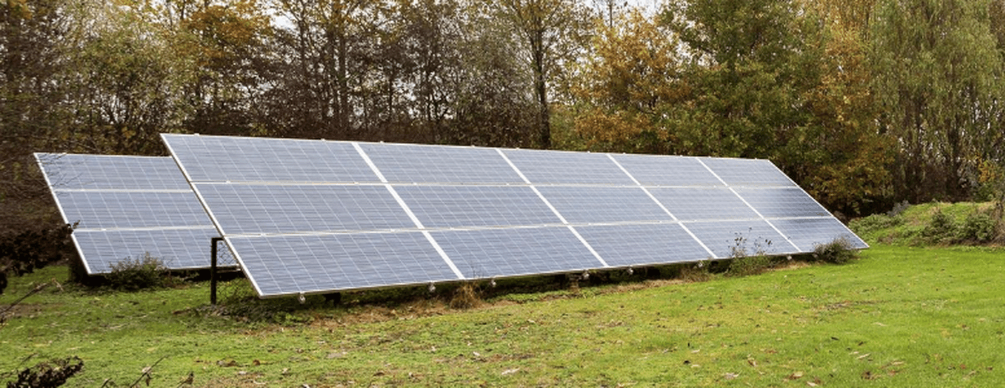

Hoi allen,
We zouden graag een 13 tal panelen plaatsen op ons dak. Ze stellen ons verschillende oplossingen voor aangezien ons dak 2 orientaties heeft. (ik vraag het hier omdat het niet helemaal lukt om dit in de sunnycalc te plaatsen)
Er zouden 10 panelen op de lengte liggen en dan nog 3 op het schuine stukje.
Het bedrijf raad ofwel 2 omvormers aan ofwel 1 omvormer met 3 optimisers voor deze panelen.
Is dat nodig aangezien SMA beschikt over shadowfix?
De installatie is een 3N400V aansluiting.
Afbeeldingslocatie: https://tweakers.net/i/YdVMZhHOn9vWKfeJpleRRyR5EGc=/full-fit-in/4000x4000/filters:no_upscale():fill(white):strip_exif()/f/image/H7M0aIhfa2FLw6AHR9I23dXx.png?f=user_large
Afbeeldingslocatie: https://tweakers.net/i/Jv6_56N-VBrZyrYLuTgV2oZ3FmU=/full-fit-in/4000x4000/filters:no_upscale():fill(white):strip_exif()/f/image/ksGHjXzaSWgf3CtM3WtIFRLs.png?f=user_large
Afbeeldingslocatie: https://tweakers.net/i/CmAqUKURrvZ_MIgJD7B0vqlHFb8=/full-fit-in/4000x4000/filters:no_upscale():fill(white):strip_exif()/f/image/zXtkbutjHFcxYxnV3leMOTF4.png?f=user_large
Afbeeldingslocatie: https://tweakers.net/i/oIeeJBJEF7NzU7ScfrmAdjyEjA0=/full-fit-in/4000x4000/filters:no_upscale():fill(white):strip_exif()/f/image/XMUCD7SqusYpmo5QCx4cMn4N.png?f=user_large

Mijn 2 Sunny Boy 1.5 1VL-40's hebben twee maanden geen werkende internetverbinding gehad. Dat is nu hersteld.
In de sunny portal is de data inmiddels terug te zien van de afgelopen maand waarin er geen verbinding was (dat duurde een paar dagen). Maar de maand ervoor is nog leeg.
Kan ik zelf triggeren dat hij de DB in sunny potal aanvult?
En is dit de plek op het tweakers forum om deze vraag te stellen?

  • AUijtdehaag
AUijtdehaag
@zierbeek
Sunnydesignweb (zie startpost hoe te gebruiken) komt als ideale omvormer voor die 10 x 435Wp met een 3.6 enkelfase.
Je gaat er weinig aan missen als je een 5 kW neemt of een 3,6 kW
(energie rendementsfactor 100% is precies goed. 99,8% is ietsjes aftoppen maar dat is erg weinig op jaarbasis)
Afbeeldingslocatie: https://tweakers.net/i/rMJvkAWjnfzh8_S9vQgG4ahPV_E=/800x/filters:strip_icc():strip_exif()/f/image/Vinv14fecGKXOaPO4gJt5lGM.jpg?f=fotoalbum_large
Afbeeldingslocatie: https://tweakers.net/i/uZm0rtSnNIhq69ftqm_tUfv_DBw=/800x/filters:strip_icc():strip_exif()/f/image/40EBM2vMkCvMiZbrYwEbEkhs.jpg?f=fotoalbum_large

Ik wil uit eindelijk de SMA toevoegen aan domoticz.
Alvast bedankt voor het meelezen / denken.
Zie https://github.com/SBFspot/SBFspot/discussions/634

@Wim Leers Dat is niet dezelfde fout: in #634 kan de omvormer niet communiceren met SBFspot, hier is het een verkeerd password.
@Syq86 In de config moet het user (gebruiker) passwoord staan. Als je het installer passwoord wil gebruiken moet je dit meegeven op de commandline:
-installer -password:your_installer_password

Ik ben bezig met mijn zonnepanelen te vervangen door panelen met hogere opbrengst.
Op mijn studio dak liggen nu 8 trina solar 425wp panelen portrait (esdec) die zijn aangsloten op een SMA SB3.0-1AV-40 deze panelen liggen op het zuiden.
Op mijn garage dak komen volgende week 12 Trina vertex panelen va 430 wp waarvan er eerst 9 worden aangesloten op ook een SMASB3.0-1AV-40 Deze panelen liggen ook op het zuiden
de helft van deze panelen liggen tot 11.00 uur in de schaduw van mijn huis. De rest van de dag volledig in de zon.
Ik wil begin volgend jaar een SMA SMA Sunny Tripower 6.0 Smart Energy hybride omvormer aanschaffen en beide sets dus 8 x 425 WP en 12 x 430 wp hier op aansluiten.
Is dit mogelijk ? of is er een andere oplossing?
Kan ik de set van 12 ook splitsen en er 2 strings van maken of is dit niet nodig IVM shadefix ?
Graag jullie mening.

Heb je het al eens in sunny design ingevoerd en doorgerekend? Zie startpost.
  • Aad
  • Laatst online: 12:09
Aad
dat heb ik vanmorgen gedaan, de 6kw omvormer kan de panelen niet aan, de 8 en 10 kw wel.
nu weet ik nog niet wat ik zal doen, de 10KW of de 8KW
iemand suggesties ?
  • AUijtdehaag
AUijtdehaag
@Aad
Ik denk dat een 6.0 ook nog wel gaat, maar je zal iets meer aftoppen op de goede dagen.
Je kan handmatig de 6 kiezen in sunnydesignweb, hoewel hij met een 8 of 10 komt maar niet met een 6
Afbeeldingslocatie: https://tweakers.net/i/IrRzpcrKl4yoNaKcq6TSllGeHRc=/800x/filters:strip_icc():strip_exif()/f/image/axIBW7FO5wagpvgs9caiy8a5.jpg?f=fotoalbum_large
  • Aad
Aad
oké, bedankt voor het meedenken, ik had de 6 er in gezet maar daar gaf hij bij mij fouten,
maar bij de 8 en 10 gaf hij dit aan
PV-generator/omvormer beperkt compatibel
PV-generator en type omvormer zijn slechts beperkt compatibel, omdat de omvormer voor deze combinatie overgedimensioneerd is (> 94 %).
Oplossingen
Als de vermogensverhouding (nominale vermogensverhouding c.q. dimensioneringsfactor) bewust is gekozen en is gebleken dat deze goede opbrengsten oplevert, is een wijziging niet noodzakelijk.
Om het standaardbereik te bereiken:
Vergroot het aantal PV-panelen.
Kies een omvormer met minder vermogen.
Ik denk, dat ik toch voor de 8 ga misschien komen er later nog wel meer panelen.
Bedankt
Toevallig nog meer mensen met dit probleem? Als ik probeer in te loggen via de sma energy app krijg ik steeds deze melding betreft cookies.
Afbeeldingslocatie: https://tweakers.net/i/yjN9ZPEBTPnB3TX5g988Fw4c-cM=/x800/filters:strip_exif()/f/image/zuta45LkKOdTtUPBgD29Ckfa.png?f=fotoalbum_large
  • _Arthur
  • Laatst online: 17:21
_Arthur
blub
Verwijderd schreef op maandag 8 januari 2024 @ 13:53:
Toevallig nog meer mensen met dit probleem? Als ik probeer in te loggen via de sma sunny app krijg ik steeds deze melding betreft cookies.
En toen heb je cookies enabled en het nog eens geprobeerd?

Sunny Portal app is toch tijden geleden al vervangen door SMA energy app? Op Android tenminste. Die werkt bij mij gewoon.
De pop-up webbrowser geeft geen cookies banner weer waar ik cookies kan accepteren oid.
Sorry type fout, het gaat om te sma energy app voor ios
Wat ik tot nu toe geprobeerd heb:
- Open in chrome, opent wel de app maar logt niet in.
- Javascript enabled in safari, geen succes.
- app opnieuw geïnstalleerd
[ Voor 37% gewijzigd door Verwijderd op 08-01-2024 16:09 ]

Chrome en ook SMA opnieuw geïnstalleerd, zodra ik op de aanmeld knop druk stuurt hij mij gelijk weer naar diezelfde pagina toe. Zelfs als ik geen credentials invul en op aanmelden druk wederom zelfde pagina.
  • AUijtdehaag
AUijtdehaag
@Verwijderd
En inloggen via https://sunnyportal.com lukt wel?
@AUijtdehaag
Inloggen via die link werkt ook niet, zowel chrome en safari.
Vriendin met android telefoon logt zonder problemen in via de app.
Afbeeldingslocatie: https://tweakers.net/i/RZI4dGGZRmKqcQ7OdZJImuca1QA=/800x/filters:strip_exif()/f/image/x7MMuDyzKgvCKPg6BdYG97zY.png?f=fotoalbum_large
  • AUijtdehaag
AUijtdehaag
@Verwijderd
Die site vroeg mij ook naar de cookies te accepteren.. Op de iphone.
Zal toch wel iets er mee te maken hebben denk ik.
Ben geen expert in de iphone dus kan je er niet verder mee helpen vrees ik
@AUijtdehaag
Ja klopt, de had ik ook geaccepteerd.
Maar toch bedankt voor het meedenken!
  • LXXI
Heb je niet een of andere blocker op de telefoon staan, of iets in de browsers ingesteld? Cookies al eens verwijderd?
@LXXI ja gevonden! Bij instellingen van safari stond “blokkeer alle cookies” aan 🥴
Geen idee waarom deze aanstond…

Ik heb een SMA sunny tripower 5.0
en ben bezig geweest om een slider te maken om het omvormer vermogen aan te sturen.
Ik heb veel gelezen welke register te gebruiken maar denk nu dat het werkt. Moet nog wel de test doen als er weer opwekking is en dan kijken of het ook echt terug schaalt. Maar ik kan nu wel zien dat de limiet waarde aankomt in de omvormer.
Ik gebruik register 40023 om de waarde te zetten. Mijn valkuil was dat ik van 10 to 100% naar dit register stuurde maar dit register verwacht voor 100% het getal 10000 omdat dit 100.00% voorstelt.
Voor de teruglezing gebruik ik register 41255 ook hier is het bv het getal 8500 dat 85.00% is.
Voor de slider maak ik gebruik van nodered dat via de modbus node kan lezen en schrijven.
Update flow: https://github.com/hansva....0---Active-Power-Control

"tostatus": false,
"complete": "payload",
"targetType": "msg",
"statusVal": "",
"statusType": "auto",
"x": 870,
"y": 180,
"wires": []
"id": "67aa8a7899544f4d",
"type": "modbus-client",
"name": "SMA Modbus",
"clienttype": "tcp",
"bufferCommands": true,
"stateLogEnabled": false,
"queueLogEnabled": false,
"failureLogEnabled": true,
"tcpHost": "192.168.178.4",
"tcpPort": "502",
"tcpType": "DEFAULT",
"serialPort": "/dev/ttyUSB",
"serialType": "RTU-BUFFERD",
"serialBaudrate": "9600",
"serialDatabits": "8",
"serialStopbits": "1",
"serialParity": "none",
"serialConnectionDelay": "100",
"serialAsciiResponseStartDelimiter": "0x3A",
"unit_id": 3,
"commandDelay": 1,
"clientTimeout": 1000,
"reconnectOnTimeout": true,
"reconnectTimeout": 2000,
"parallelUnitIdsAllowed": true,
"showWarnings": true,
"showLogs": true
"id": "4fb0db5cea9cd881",
"type": "ui_group",
"name": "SMA settings",
"tab": "cccf47e4.857ec8",
"order": 2,
"disp": true,
"width": "6",
"collapse": true,
"className": ""
"id": "cccf47e4.857ec8",
"type": "ui_tab",
"name": "Energy",
"icon": "battery_charging_60",
"order": 2,
"disabled": false,
"hidden": false
