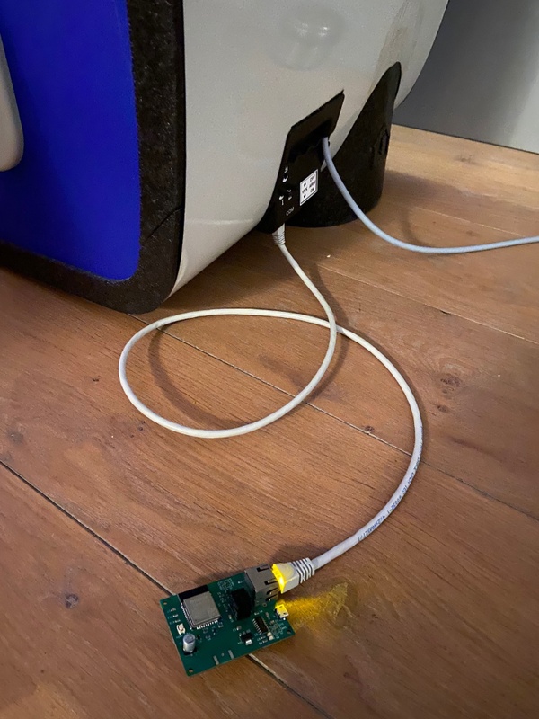

Wat gaaf! Sluit je dat bord dan aan op de service port van de demandflow unit of op de HRU zelf?
  • arjenhiemstra
  • Laatst online: 01:39
arjenhiemstra
Dogooder schreef op dinsdag 21 september 2021 @ 12:42:
Kan beide, het is dezelfde interface (mits HRU350), oudere modellen hebben een andere interface

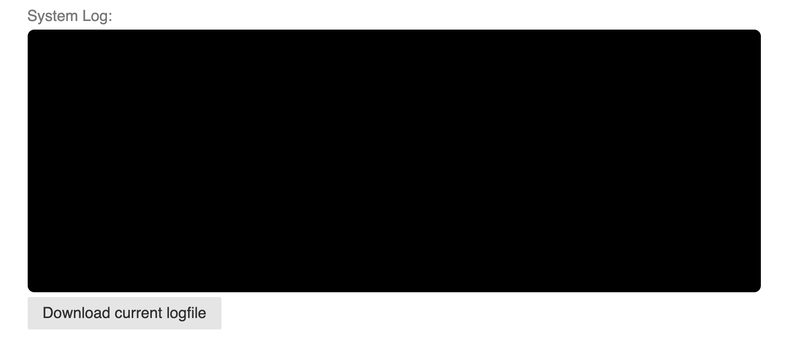

2021-09-21 05:32:07 N: System boot, last reset reason: OWDT_RESET
2021-09-21 05:32:07 N: HW rev: 2, FW ver.: 2.3-alpha8
2021-09-21 05:32:11 N: WiFi: connection successful
2021-09-21 05:32:11 N: WiFi info:
2021-09-21 05:32:11 N: Mode:STA
2021-09-21 05:32:11 N: Status:3
2021-09-21 05:32:11 N: IP:192.168.1.198
2021-09-21 05:32:11 N: Setup: Virtual remote ID: 110,194,56
2021-09-21 05:32:11 N: Setup: init of CC1101 RF module successful
2021-09-21 05:35:20 N: MQTT: connected, System config: 1
2021-09-21 05:35:20 N: Webserver: started
2021-09-21 05:35:20 N: mDNS: started
2021-09-21 05:35:20 N: Hostname: nrg-itho-c238
2021-09-21 05:35:20 N: Setup: done
2021-09-21 05:35:21 N: Error: Task SysControl timed out!
2021-09-21 05:35:30 N: Virtual remote join command send
2021-09-21 05:35:30 N: Error: Task SysControl timed out!
2021-09-21 11:35:14 N: Mem free: 174152, Mem low: 139676, Mem block: 97392
2021-09-21 13:44:16 N: Reboot requested
2021-09-21 13:43:24 N: System boot, last reset reason: SDIO_RESET
2021-09-21 13:43:24 N: HW rev: 2, FW ver.: 2.3-alpha8
2021-09-21 13:43:28 N: WiFi: connection successful
2021-09-21 13:43:28 N: WiFi info:
2021-09-21 13:43:28 N: Mode:STA
2021-09-21 13:43:28 N: Status:3
2021-09-21 13:43:28 N: IP:192.168.1.198
2021-09-21 13:43:28 N: Setup: Virtual remote ID: 110,194,56
2021-09-21 13:43:28 N: Setup: init of CC1101 RF module successful
2021-09-21 13:43:29 N: MQTT: connected, System config: 1
2021-09-21 13:43:29 N: Webserver: started
2021-09-21 13:43:29 N: mDNS: started
2021-09-21 13:43:29 N: Hostname: nrg-itho-c238
2021-09-21 13:43:29 N: Setup: done
2021-09-21 13:43:29 N: Error: Task SysControl timed out!
2021-09-21 13:44:33 N: Virtual remote join command send
2021-09-21 13:44:33 N: Error: Task SysControl timed out!
2021-09-21 14:09:02 N: Reboot requested
2021-09-21 14:09:02 N: System boot, last reset reason: SDIO_RESET
2021-09-21 14:09:02 N: HW rev: 2, FW ver.: 2.3-alpha8
2021-09-21 14:09:06 N: WiFi: connection successful
2021-09-21 14:09:06 N: WiFi info:
2021-09-21 14:09:06 N: Mode:STA
2021-09-21 14:09:06 N: Status:3
2021-09-21 14:09:06 N: IP:192.168.1.198
2021-09-21 14:09:06 N: Setup: Virtual remote ID: 110,194,56
2021-09-21 14:09:06 N: Setup: init of CC1101 RF module successful
2021-09-21 14:09:09 N: MQTT: connected, System config: 1
2021-09-21 14:09:09 N: Webserver: started
2021-09-21 14:09:10 N: mDNS: started
2021-09-21 14:09:10 N: Hostname: nrg-itho-c238
2021-09-21 14:09:10 N: Setup: done
2021-09-21 14:09:10 N: Error: Task SysControl timed out!
2021-09-21 14:09:19 N: Virtual remote join command send
2021-09-21 14:09:19 N: Error: Task SysControl timed out!

zo :)
Afbeeldingslocatie: https://tweakers.net/i/yzeRu4yR61s1dEEaYuRgJslIuCc=/x800/filters:strip_icc():strip_exif()/f/image/Hbc5Q16nWkDuHH1WQd6Z1doi.jpg?f=fotoalbum_large
  • smesjz
Nice! En deze module is nog work in progress en niet te bestellen? Ik had wel verwacht dat zoiets een aparte voeding nodig had maar mooi dat het zo werkt.
Volgende stap is natuurlijk om uit te lezen wanneer het muggenfilter vol. ;)

Ik ben de firmware nog geschikt aan het maken. De PWM 2 I2C print waar de originele firmware op gebaseerd is werkt niet met de hru en demandflow. Ik ben nu de verschillende info opties aan het toevoegen (die zitten in de laatste alpha versie en werken ook voor de hru / demandflow), de remote commando's moeten in de API (bijna klaar) en de settings en info mapping moet uitgeplozen worden (nog aan het begin).
Als dit geregeld is heb je in de basis een werkend product en zal ik ze aanbieden.

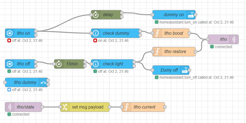

Hoe zouden jullie het volgende programmeren in Home Assistant? Is dit de enige manier of is er een makkelijkere mogelijkheid?
Pseudo code:
if event "up" and current state = low >newState medium
if event "up" and current state = medium >newState High
if event "up" and current state = High >newState low
if event "down" and current state = low >newState High
if event "down" and current state = medium >newState Low
  • Woodski
  • Laatst online: 25-11 10:16

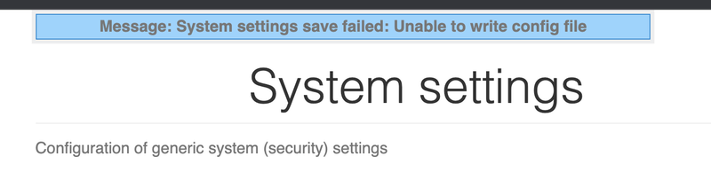

Hallo daar,
Vorige week heb ik ook een bordje geplaatst in mijn CVE-S ECO, beetje vogelen met wat scriptjes uit deze post in Home Assistant en hoppa! Begon goed. Super leuk om eindelijk mijn ventilatie te kunnen toevoegen aan mijn smart home!
Toen de eerste errors en 2.3alpha 9 geprobeerd, dat werkte iets beter maar na een uur of 6 geen reactie meer. In het begin wilde de stroom er af wel helpen maar nu boot het bord in AP mode en heb ik de firmware terug kunnen zetten naar 2.2.1 maar de module schrijft geen settings meer, joint niet het opgegeven ssid en ook een reset kan niet uitgevoerd worden.
Afbeeldingslocatie: https://tweakers.net/i/R4SOOMs9bQgc22HL78dQhMgNuss=/800x/filters:strip_exif()/f/image/gEurDUlgfmjuJwJi4KHOreVx.png?f=fotoalbum_large
Afbeeldingslocatie: https://tweakers.net/i/rFiuhDiS5ET8qRo8Ja80DZ4c--0=/800x/filters:strip_exif()/f/image/86Exoy3cPgdPPedCf4SozvVv.png?f=fotoalbum_large
Ook is het logfile en filesystem leeg:
Afbeeldingslocatie: https://tweakers.net/i/IlF4jfLkIMB5EriVdOF4xTpFlHQ=/800x/filters:strip_exif()/f/image/u0T62FLbYQXQgABM6KXArExm.png?f=fotoalbum_large
Afbeeldingslocatie: https://tweakers.net/i/L6CiOTwmRBK11UsM8pN3L_OTo2w=/800x/filters:strip_exif()/f/image/iEc3yaNWE3tprVzD4uae3gsc.png?f=fotoalbum_large
Ik weet zo 123 niet of dit hw2 bord een diode heeft die er af moet maar het niet schrijven van settings is nieuw volgens mij?
What to do?
En klopt het dat deze module de auto functie van de itho gebaseerd op luchtvochtigheid overuled? De itho slaat nl helemaal niet meer automatisch aan sinds het bordje geplaatst is en uitaard ook niet nu het bordje vast gelopen is.
[ Voor 27% gewijzigd door balsteroid op 27-09-2021 21:54 ]

balsteroid schreef op maandag 27 september 2021 @ 21:44:
Hallo daar,
What to do?
Wow! ik weet dat ik deze error meldingen ingebouwd heb maar ik heb ze zelf nog nooit gezien! Dat is niet goed... Je zou nog kunnen proberen om een fail save boot te doen, de flash partitie krijgt dan een format. Je hoeft geen nieuwe firmware te uploaden. Als het formatteren klaar is start een access point op en knippert het wifi ledje. Daarna een power cycle en dan start de add-on op zoals je die kreeg (als het goed is).
Als het dan nog niet OK werkt is er een hardware issue denk ik.
Niet per se, alleen als je deze functie gebruikt: Afbeeldingslocatie: https://tweakers.net/i/IL4cXvwEfU23J-z3gGyPVdpBFDs=/800x/filters:strip_exif()/f/image/nRH0Rok3SMLaxdfgsPNX9snP.png?f=fotoalbum_large
Als je deze functies aan zet op firmware 2.2(.1) dan loopt je itho vast. In alpha9 is dat opgelost.
Buttom line; gebruik deze functies alleen als je een alternatieve hum sensor in je itho hebt of de besturing vanuit de itho firmware uit wilt zetten.

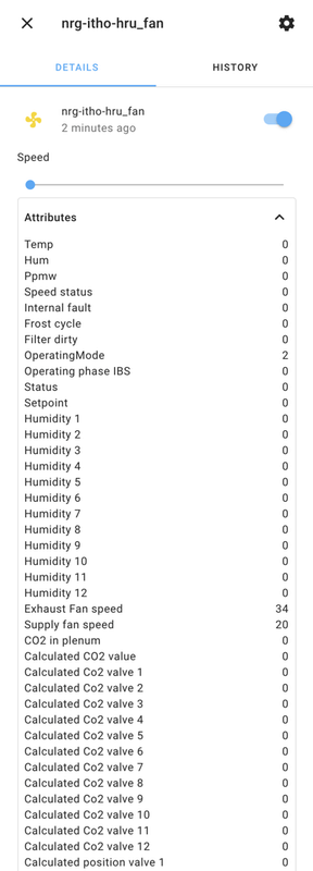

Ik weet niet of het iets aan mijn kant is (Home Assistant die iets vreemds doet?) maar ik met dat mijn Timers (de timer knop of de RF remote) het niet meer goed doen.
Wanneer ik de Timer knop 1 keer indruk dan zou hij volgens de instellingen 10 minuten op 220 moeten draaien en daarna weer terug moeten gaan naar de vorige stand. Na het indrukken van de knop gaat hij keurig op 220 draaien, maar hij gaat alleen nooit weer terug naar de vorige stand. Ik moet hem dan handmatig (via de webinterface, de RF remote of via Home Assistant) weer op een lagere stand zetten.
Kan ik ergens in de Itho WiFi addon debuggen waar dit eventueel mis gaat? In de Debug logs kan ik op dit moment niets terug vinden, maar is er misschien ergens een Verbose mode aan te zetten ofzo?

Saeverix schreef op dinsdag 28 september 2021 @ 14:06:
met het commando: http://[nrg-itho-1234]/api.html?get=queue
krijg je de queue te zien zoals hieronder:
{"queue":[{"index":0,"speed":220,"valid":582400},{"index":1,"speed":-1,"valid":0},{"index":2,"speed":-1,"valid":0},{"index":3,"speed":-1,"valid":0},{"index":4,"speed":-1,"valid":0},{"index":5,"speed":-1,"valid":0},{"index":6,"speed":-1,"valid":0},{"index":7,"speed":-1,"valid":0},{"index":8,"speed":-1,"valid":0},{"index":9,"speed":-1,"valid":0}],"ithoSpeed":220,"ithoOldSpeed":220,"fallBackSpeed":43}
Als er een timer actief is zou op index 0 valid > 0 moeten zijn en elke keer als je reload moet valid afnemen totdat die 0 is, daarna gaat de instelling als het goed is weer naar de fallBackSpeed waarde (in dit voorbeeld naar 43).

Helaas blijft de queue bij mij leeg:
JSON:
24

Ook bij twee keer de Timer knop indrukken (20 minuten) veranderd er niets. Ik zie ook dat "ithoOldSpeed" op 220 staat, terwijl de vorige snelheid 140 was. Ook de "fallBackSpeed" staat op 220, terwijl die in de configuratie op 140 staat.
Afbeeldingslocatie: https://tweakers.net/i/UhvMnZnelJnTO2Woo2Uh8BnxBpQ=/full-fit-in/4000x4000/filters:no_upscale():fill(white):strip_exif()/f/image/zHw3m8EaLJghE9px1jQYYc3r.png?f=user_large
Afbeeldingslocatie: https://tweakers.net/i/qgLpsYilg5RnRRH6TBQkAj2mgT0=/full-fit-in/4000x4000/filters:no_upscale():fill(white):strip_exif()/f/image/D9PMdWVhMiQv56Tu0kukhAck.png?f=user_large
Voordat ik deze vraag had gepost was ik al van Firmware 2.2.1 naar 2.2.0 gegaan. Ik dacht misschien zit daar ergens een foutje in, of lost het opnieuw flashen van de firmware het probleem op.
People who live in glass houses shouldn't throw stones.

fallBackSpeed in dit overzicht is de snelheid waarnaar de itho terug gaat na de timer. Dat is iets anders dan wat normaal in de interface te zien is (niet handig maar normaal zie je deze queue ook niet ;-))
Ik weet vrij zeker dat op 1 of andere manier er een loopje in je config zit, er komt een bericht binnen (een normaal snelheid commando, niet de timer) die de queue overruled. Een non-timer commando maakt de queue weer leeg namelijk. Zoek dus even in je config waar dat kan zijn (zet ff MQTT uit of andere integraties om het te testen). Met het queue commando kun je zien of het effect heeft.
Er is nog een manier om die queue overrule uit te zetten maar dat is wat omslachtig:
bij debug -> file editor -> edit config.json
veranderd "nonQ_cmd_clearsQ":1 in "nonQ_cmd_clearsQ":0
flash dezelfde firmware via de update pagina (heeft iets met een bug te maken....)
Reboot de add-on
Als je nu een timer commando geeft en er komt toch een commando binnen dan blijft de timer actief. Waarschijnlijk blijft er bij fallBackSpeed 220 staan. Als je vervolgens via de interface onder de slider op het knopje medium klikt komt in de queue in jouw geval waarschijnlijk fallBackSpeed:140 te staan van je medium setting. Als de timer voorbij is gaat de itho naar deze snelheid. Als dat zo werkt weet je zeker dat er een loop zit in je config.

  • Woodski
Mijn eerste node red flow :)
Deze gaat niet uit van statische waardes maar gebruikt dynamisch de huidige waarde plus een boost
Dus als de ingestelde waarde op dat moment 80 is gaat hij naar 80+60=140
En als de flow klaar is gaat hij weer terug naar 80
Ik ben geen programmeur en heb wellicht onlogische stappen genomen dus tips zijn welkom
- Licht in de WC gaat aan
- Itho krijgt een boost van 60 (range is 0 tot 255)
- Licht gaat uit
- Na 15 minuten gaat de Itho terug naar de uitgangswaarde
Er zit een veiligheid in dat de waarde niet blijft verhogen tijdens spelen met het lichtknopje
En ook een voor spelen met het lichtknopje en dan langer dan 15 minuten kleien.
Afbeeldingslocatie: https://tweakers.net/i/nse6RZTOxvzbte6t3dSJ7Rgszz8=/800x/filters:strip_exif()/f/image/v7zonFfZHjwWTryqyBgxWG8r.png?f=fotoalbum_large

arjenhiemstra
Dogooder schreef op vrijdag 15 oktober 2021 @ 20:52:
Ik lees dit met heel veel interesse. Hoeveel functionaliteit van de demandflow komt er nu beschikbaar?
Ik trek er nu alle data uit die beschikbaar is, hangt een beetje van de firmware van de demandflow af wat beschikbaar is, hier een voorbeeld van die van mij en hoe het in home assistant door komt:
Afbeeldingslocatie: https://tweakers.net/i/8NCIUA2oD59OC1rTMo7qeA8ZuhA=/x800/filters:strip_exif()/f/image/cxdljiHmDFRFRlGsjnT40TYW.png?f=fotoalbum_large
Afbeeldingslocatie: https://tweakers.net/i/t92zdV9ulH9ByfL63ohsIr8n1gQ=/x800/filters:strip_exif()/f/image/E9oPwtXFFn9rmVv01LPqShQj.png?f=fotoalbum_large
Daarnaast zijn de settings te veranderen, ik zie er ook manueel klep standen regelen en motorsnelheid regelen ertussen staan. Dit werkt nu alleen via de webinterface maar in de toekomst kan dit ook via MQTT of HTML API als dat wenselijk is maar ik kan de use cases nog niet helemaal goed inschatten omdat ik het systeem zelf niet actief in gebruik heb.
