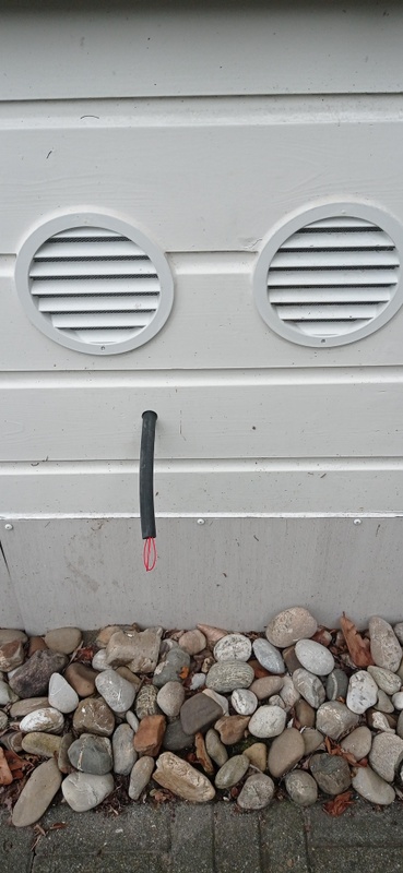

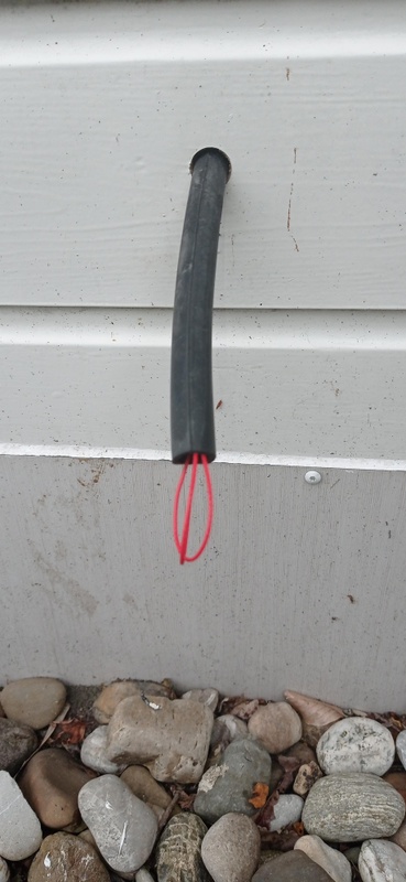

Since 5/2024 Innova offers a optional "Condensate Drain Pipe Heater Kit" for the 2.0 models.
Named GB1119 Resistor Kit
The 'Condensate Drain Pipe Heater Kit' is designed for the new Innova model released in May 2024. This has a specially made connector under the device where it is plugged in and works on 220V. I'm not a fan of this, especially in combination with water. This is the solution for models with serial numbers lower than <IN23*****. This works on 12V. Although with an adapter, because the older models simply do not have a connector on the bottom of the device:Afbeeldingslocatie: https://tweakers.net/i/ubr3sVCOOTWWZsYo-SJ543wAQE4=/x800/filters:strip_icc():strip_exif()/f/image/f380dCcESN4guJbcuug9uxJx.jpg?f=fotoalbum_large
Afbeeldingslocatie: https://tweakers.net/i/u1qBaM--OuTQPMog5fY1c5JDq08=/800x/filters:strip_icc():strip_exif()/f/image/rhUcJPipCmoUaBK9JqKoFvyL.jpg?f=fotoalbum_large
Afbeeldingslocatie: https://tweakers.net/i/6y8O21gBrJZ2TRivECXpPuOGdEw=/x800/filters:strip_icc():strip_exif()/f/image/YidWJxWqFEC0h84M8iivKlZW.jpg?f=fotoalbum_large
Afbeeldingslocatie: https://tweakers.net/i/L0yiRhRo1m3tuCrPBsTEkc5zq6k=/800x/filters:strip_icc():strip_exif()/f/image/1wExFZ7mNbNzZ30O5nVdqbiM.jpg?f=fotoalbum_large

JanDoedel schreef op vrijdag 5 juli 2024 @ 18:56:
The 'Condensate Drain Pipe Heater Kit' is designed for the new Innova model released in May 2024. This has a specially made connector under the device where it is plugged in and works on 220V. I'm not a fan of this, especially in combination with water. This is the solution for models with serial numbers lower or equal than <IN23*****. This works on 12V. Although with an adapter, because the older models simply do not have a connector on the bottom of the device:

Ik heb nu ook de gehele woning voorzien van elektrische convector kachels aangesloten via een smart plug en een zigbee temperatuursensor, deze worden aangestuurd door Home Assistant.
Afbeeldingslocatie: https://tweakers.net/i/e2M9gkLmbXZ4uVjm6vwpSyymNpM=/full-fit-in/4920x3264/filters:max_bytes(3145728):no_upscale():strip_icc():fill(white):strip_exif()/f/image/tw3oCQ3N4i3VksKtK03oqvYy.jpg?f=user_largeAfbeeldingslocatie: https://tweakers.net/i/a4KeiT0CKIU5JlmOEBAEViUU3zs=/x800/filters:strip_icc():strip_exif()/f/image/HkrwHtXbIKKzAAMzkOd0Fgnw.jpg?f=fotoalbum_large
Met 30 zonnepanelen hoop overproductie en de huidige salderingsregeling lukt het me om met COP1 de woning voordelig te verwarmen. De salderingsregeling wordt afgebouwd en dus straks niet meer interessant om de gehele woning met in efficiënte convector kachels te verwarmen.

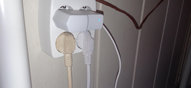

Robain schreef op zondag 17 november 2024 @ 20:11:
Ik gebruik iOS, maar dat is het probleem niet.
Het probleem is dat in de aircoheater niet in Wifi station mode krijg. Het toestel begint nooit een Wifi netwerk uit te stralen om op te verbinden en vervolgens dus via de app in te stellen…
Soms helpt het om ook eerst even het apparaat stroomloos te maken, dus stekker er uit, voordat je een wifi reset doet.
En de wifi module zit in de stalen kast waardoor de ontvangst erg slecht is. Je moet vlak bij de Innova gaan staan met de telefoon.
En misschien een overbodige opmerking, maar om het eerste contact te leggen moet je de telefoon naar een nieuw netwerk laten zoeken. Als die verbinding is gelegd dan kan je de app gebruiken om de rest in te stellen.

Verder kan een Innova 2.0 opgehangen in een houten schuur of tuinhuis best wat lawaai maken, door blaaslucht van de kanaalventilator, korte kanalen (dunne wanden) en resonerende houten wanden. Ik zou de Innova 2.0 ook zeker niet deels vrij laten hangen, maar er voor zorgen dat ie met zijn schuimplaat over de volle achterzijde, goed aansluit aan een stevige, zware, dempende wand. Bij een split kun je de buitenunit ergens opstellen, waar je hier minder last van hebt, buiten in de tuin op de dempende grond, op betontegels met rubber isolatie zetten. De binnenuit van een compacte single split is kleiner, lichter en maakt nauwelijks lawaai, dus ook niet in een klein tuinhuis.
Tel hierbij op dat een kleine split airco, inclusief installatie, niet duurder hoeft te zijn, dan een Innova 2.0, en ik snap eigenlijk niet waarom je in deze situatie een Innova 2.0 als verwarming kiest, die onder de 7 C buiten rendement verliest, bij vorst simpelweg slecht verwarmd, bij -10 C buiten stopt met verwarmen en zelfs uit gaat.
Wat de verschillen tussen de verschillende merken aan 2-duct monoblocks, zoals de Innova 2.0, betreft, daar zit veel verschil in bouwkwaliteit, veel plasic i.p.v. volledig metalen omkasting, goedkopere componenten binnenin, etc. Ook kom je bij die andere merken nog wel eens aan/uit gestuurde compressoren tegen i.p.v inverters, wat scheelt in geluid, inschakelstromen en rendement. Sommigen kunnen zelfs niet eens verwarmen. Geluid, demping en goede toerenregeling van de ventilatoren wil ook nog wel eens minder zijn. Al moet ik zeggen dat ik zelf deze apparaten niet bezit, anders dan 4 stuks Innova 2.0, en dus geen ervaring heb met andere merken.
Verder is de app van Innova wel handig, zeker bij een airco in een andere ruimte buitenshuis om temperatuur daar af te kunnen lezen, instellen en bedienen. Daar moet dan wel een goed Wifi-netwerk zijn. Daar zou ik dus ook op letten, ook bij aanschaf van een split, of die dus via een app te besturen valt. De meeste zullen dat tegenwoordig ook wel zijn, verwacht ik.
Condens ontstaat altijd op het deel wat koud gehouden wordt bij een warmtepomp, dat is dus de verdamper.
In aircobedrijf zit die verdamper binnen, dan moet condens dus van binnenuit afgevoerd worden. Bij een split zit meestal een slangetje naar buiten vanuit de binnenunit, of wordt er in een condenspompje verzameld en condens weggepompt ergens naar een afvoer. Er ontstaat bij een split in verwarmend bedrijf echter geen condens binnen. In de winter hoef je dus niet bang te zijn voor lekkage binnen bij een split. Condens ontstaat dan in de buitenunit. In verwarmend bedrijf zit de koude verdamper bij een split immers buiten.
Bij de Innova 2.0 zitten condensor en verdamper altijd binnen, zowel in aircobedrijf, als verwarmend. Alleen kan de Innova 2.0 in aircobedrijf het condenswater gebruiken om zijn warme condensor extra te koelen. Veel van dit condenswater verdampt daar dan en wordt door het uitblaaskanaal, met de warme lucht mee, naar buiten geblazen. In verwarmend bedrijf moet de Innova 2.0 echter altijd condens naar buiten af kunnen voeren en doet dit ook, continu druppelend. Daarbij ontstaat dus meer kans op bevriezing van het afvoerslangetje naar buiten en lekkage binnen. Al is de Innova 2,0 wel extra beveiligd tegen overstromen van zijn condenspan, hij gaat dan wel uit.

Allereerst bedankt voor je reactie, maar misschien dat mijn hele verhaal niet helemaal helder is/was, waardoor de indruk ontstaat dat ik vooral op zoek ben naar een verwarming, maar dat ben ik dus nadrukkelijk niet. Op dit moment is het tuinhuisje in gebruik (geweest) als een soort opslag, maar we willen het meer gaan gebruiken als een tijdelijke verblijfsruimte, om te kunnen werken af en of te hangen als het zonnetje lekker schijnt, maar het buiten nog te koud is om te zitten. Dus hoofdzakelijk in voor en najaar als de temperatuur er binnen al heel snel goed te doen is. Vandaag liep in de zon de temperatuur al zonder enige hulp op tot 16 graden. Het is dus nadrukkelijk niet het idee om het huisje altijd en constant op te stoken en ook op die manier te gebruiken als het echt koud is buiten. Het gaat er meer om dat ik me afvraag of zo'n apparaat het voor elkaar krijgt om die 1% goed koude dagen van het jaar de temperatuur enigszins boven 0 kan houden (eventueel met wat hulp). Neem bijvoorbeeld een dag/nacht als afgelopen zaterdag. In de nacht was het hier - 2,5 graden buiten. In het (nu niet verwarmde) tuinhuisje was het op z'n koudst +3 graden. Dat is dus nog steeds boven 0. Het aantal vorstdagen en ijsdagen in Nederland neemt alleen maar af en hier in het westen, even boven Amsterdam, zijn het er nog minder dan gemiddeld door de invloed van water. Laat staan dat het hier regelmatig ook maar in de buurt van 10 graden vorst komt.
Als we dan voor 99,9 procent van de tijd af kan met zo'n unit (en ingebouwde electrische verwarming) en voor de extreme situaties een keer een electrisch of petroleum kacheltje bij moeten plaatsen, dan ben ik tevreden. Het is niet dat ik er moet en zal zitten als het vriest, maar meer dat we redelijk consequent kunnen voorkomen dat het er binnen vriest, door een beetje (bij) te verwarmen overdag. En dat lukt nu ook prima met een convectorkacheltje 750 Watt, maar die heb ik liever niet permanent geïnstalleerd staan.
Voor de warmere dagen hebben we dan de airconditioning stand om het koeler en aangenaam te houden, want die ramen die voor de grote hoeveelheid zo'n en warmte binnen zorgen, zorgen er dus in het latere voorjaar tot het vroege najaar voor dat het binnen te warm of zelfs heet is. Dus daar zal het echt hoofdzakelijk voor gebruikt worden. En een beetje bijverwarming in na- en voorjaar.
We hebben gekeken naar de mogelijkheden van een split airconditioning, maar we zijn tot de conclusie gekomen dat we gewoon geen (goede) plek hebben om de buitenunit te plaatsen op de grond. Dan staat dat ding namelijk midden in de wereld (door de plaats van de vaste wanden van het huisje) of hij staat op het terras waar we in de zomer het liefste zitten, waardoor we daar niet meer kunnen zitten. Mijn lieftallige wederhelft breekt nog liever dat tuinhuis af dan dat ze die plek opgeeft :+
Op het dak is ook geen optie, want er loopt rondom een zwevend afdak, behalve aan 1 zijde, maar dat is de tuin van de buren. Een heel traject van kanalen, buizen en leidingen om de luifel bouwen is ook een gevalletje nee, dankjewel, want we hebben juist veel moeite gedaan om het strak en afgewerkt te maken, met inbegrip van het wegwerken van de HWA uit het zicht. Leidingen en buizen door het plafond en dak gaan we niet aan beginnen, omdat anderen daar grote problemen en slechte ervaringen mee hebben gehad. Daarnaast hebben we ook geen plaatst voor de binnenunit van een mini split, want die komen nagenoeg allemaal groter uit :| dus geen wand die lang genoeg is om die aan op te kunnen hangen. En tenslotte moeten we voor een mini split een hele nieuwe grondkabel laten trekken met een eigen groep en dat wordt echt te gortig.
Overigens bedoel ik dus met houtskeletbouw geen blokhut van de bouwmarkt. De muren zijn zo'n 8 cm dik en de steensmuur is ongeveer 15 cm dik. Het is dus echt wel een huisje en niet een schuurtje met planken van een cm dik ;)

Interessant Tegen Bevriezing Condenswater in de afvoerslang naar buiten.
Voor alle horizontale Innova 2.0 12HP + ELEC Monoblock toestellen vanaf modeljaar 2018 !!!!!
Warmtedraad met krachtige ontdooiende werking voor betrouwbare afvoer van condenswater, ook bij zeer lage buitentemperaturen. Voor alle horizontale Innova 2.0 Monoblock toestellen vanaf modeljaar 2018 !!!!!
Deze warmtedraad is eenvoudig toe te passen bij alle horizontale Innova 2.0 Monoblock toestellen vanaf modeljaar 2018 waarbij de afvoerslang door de muur naar buiten loopt.
De draad is aan te brengen via de standaard aftapplug onder aan iedere airco, hier is geen gereedschap voor nodig.
De antivriesdraad wordt geleverd met een adapter voor in het stopcontact, met het oog op de veiligheid is het voltage 12 Volt, het stroomverbruik is slechts 6 Watt.
De draad is geschikt voor Innova 2.0 toestellen vanaf 2018, dit zijn de toestellen met een vierkant bedieningspaneel. Voor de oudere toestellen met ovaal bedieningspaneel is deze draad niet geschikt.
https://www.monoblockspec...2_Innova-warmte-lint.html
Voor NIEUWE Innova 2.0 12HP + ELEC vanaf levering mei 2024
Voorkomt bevriezing van de condenswater afvoer als de Innova 2.0 (vanaf model: levering mei 2024) als de verwarming wordt gebruikt.
Gebruik van deze draad voorkomt bevriezing van de condenswaterafvoer van een Innova 2.0 monoblock warmtepomp. (vanaf model: levering mei 2024)
https://www.monoblockspec...2.0-Warmtedraad-230V.html
