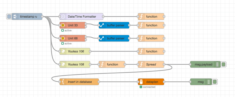

  • ericplan
  • Laatst online: 14:57
ericplan
5180 Wp PV
@Chris_147 Als alternatief voor een join node zou je ook een spread-functie kunnen gebruiken. Elke meting schrijf je naar een flow-variabele en in de spread node combineer je alles:
[{"id":"7d781726.65ce38","type":"function","z":"5bf1bc11.cc90c4","name":"","func":"var tmp2 = { datum: msg.payload };\nmsg.payload = tmp2;\nflow.set(\"fifth\", msg.payload);\nreturn msg;","outputs":1,"noerr":0,"initialize":"","finalize":"","x":700,"y":120,"wires":[[]]},{"id":"4727ab2d.c8e8ac","type":"moment","z":"5bf1bc11.cc90c4","name":"","topic":"","input":"","inputType":"msg","inTz":"ETC/utc","adjAmount":0,"adjType":"days","adjDir":"add","format":"YYYY-MM-DD HH:mm:ss","locale":"C","output":"","outputType":"msg","outTz":"ETC/utc","x":380,"y":120,"wires":[["7d781726.65ce38"]]},{"id":"130ca282.6940bd","type":"inject","z":"5bf1bc11.cc90c4","name":"","props":[{"p":"payload"}],"repeat":"300","crontab":"","once":false,"onceDelay":0.1,"topic":"","payload":"","payloadType":"date","x":130,"y":120,"wires":[["14bc28f6.46074f","7d42346d.13828c","ffa0fb42.d3bb2","957a8de7.2ba6","4727ab2d.c8e8ac"]]},{"id":"14bc28f6.46074f","type":"modbus-getter","z":"5bf1bc11.cc90c4","name":"Unit 33","showStatusActivities":false,"showErrors":false,"logIOActivities":false,"unitid":"33","dataType":"HoldingRegister","adr":"27","quantity":"8","server":"40f20c7f.13a934","useIOFile":false,"ioFile":"","useIOForPayload":false,"emptyMsgOnFail":false,"keepMsgProperties":false,"x":340,"y":160,"wires":[["8c081b87.3b1fe8"],[]]},{"id":"7d42346d.13828c","type":"modbus-getter","z":"5bf1bc11.cc90c4","name":"Unit 66","showStatusActivities":false,"showErrors":false,"logIOActivities":false,"unitid":"66","dataType":"HoldingRegister","adr":"27","quantity":"8","server":"40f20c7f.13a934","useIOFile":false,"ioFile":"","useIOForPayload":false,"emptyMsgOnFail":false,"keepMsgProperties":false,"x":340,"y":220,"wires":[["93e40ad6.2f2f1"],[]]},{"id":"ffa0fb42.d3bb2","type":"http request","z":"5bf1bc11.cc90c4","name":"Youless 106","method":"GET","ret":"obj","paytoqs":"ignore","url":"http://192.168.178.175/e","tls":"","persist":false,"proxy":"","authType":"","x":350,"y":280,"wires":[["1f81a596.62d152"]]},{"id":"957a8de7.2ba6","type":"http request","z":"5bf1bc11.cc90c4","name":"Youless 108","method":"GET","ret":"obj","paytoqs":"ignore","url":"http://192.168.178.176/e?f=j","tls":"","persist":false,"proxy":"","authType":"","x":350,"y":340,"wires":[["a7e40dd7.c7c7e"]]},{"id":"8c081b87.3b1fe8","type":"buffer-parser","z":"5bf1bc11.cc90c4","name":"","data":"payload","dataType":"msg","specification":"spec","specificationType":"ui","items":[{"type":"uint32be","name":"U33_5","offset":0,"length":1,"offsetbit":0,"scale":"/2000","mask":""},{"type":"uint32be","name":"U33_6","offset":4,"length":1,"offsetbit":0,"scale":"/2000","mask":""},{"type":"uint32be","name":"U33_7","offset":8,"length":1,"offsetbit":0,"scale":"/2000","mask":""},{"type":"uint32be","name":"U33_8","offset":12,"length":1,"offsetbit":0,"scale":"/2000","mask":""}],"swap1":"","swap2":"","swap3":"","swap1Type":"swap","swap2Type":"swap","swap3Type":"swap","msgProperty":"payload","msgPropertyType":"str","resultType":"keyvalue","resultTypeType":"output","multipleResult":false,"fanOutMultipleResult":true,"setTopic":false,"outputs":1,"x":530,"y":160,"wires":[["e5eda30d.79d1e8"]]},{"id":"93e40ad6.2f2f1","type":"buffer-parser","z":"5bf1bc11.cc90c4","name":"","data":"payload","dataType":"msg","specification":"spec","specificationType":"ui","items":[{"type":"uint32be","name":"U66_1","offset":0,"length":1,"offsetbit":0,"scale":"/1000","mask":""},{"type":"uint32be","name":"U66_4","offset":4,"length":1,"offsetbit":0,"scale":"/1000","mask":""},{"type":"uint32be","name":"U66_6","offset":8,"length":1,"offsetbit":0,"scale":"/1000","mask":""},{"type":"uint32be","name":"U66_x","offset":12,"length":1,"offsetbit":0,"scale":"/1000","mask":""}],"swap1":"","swap2":"","swap3":"","swap1Type":"swap","swap2Type":"swap","swap3Type":"swap","msgProperty":"payload","msgPropertyType":"str","resultType":"keyvalue","resultTypeType":"output","multipleResult":false,"fanOutMultipleResult":true,"setTopic":false,"outputs":1,"x":530,"y":220,"wires":[["f5904e5a.b551c8"]]},{"id":"1f81a596.62d152","type":"function","z":"5bf1bc11.cc90c4","name":"","func":"var tmp1 = { p106: Math.round((msg.payload[0].p1 + msg.payload[0].p2) * 1e3) / 1e3 , n106: Math.round((msg.payload[0].n1 + msg.payload[0].n2) * 1e3) / 1e3 , cs106: msg.payload[0].cs0 };\nmsg.payload = tmp1;\nflow.set(\"first\", msg.payload);\nreturn msg;","outputs":1,"noerr":0,"initialize":"","finalize":"","x":700,"y":280,"wires":[[]]},{"id":"a7e40dd7.c7c7e","type":"function","z":"5bf1bc11.cc90c4","name":"","func":"var tmp2 = { p108: Math.round((msg.payload[0].p1 + msg.payload[0].p2) * 1e3) / 1e3 , n108: Math.round((msg.payload[0].n1 + msg.payload[0].n2) * 1e3) / 1e3 , cs108: msg.payload[0].cs0 };\nmsg.payload = tmp2;\nflow.set(\"second\", msg.payload);\nreturn msg;","outputs":1,"noerr":0,"initialize":"","finalize":"","x":520,"y":340,"wires":[["4353c8af.23246"]]},{"id":"e5eda30d.79d1e8","type":"function","z":"5bf1bc11.cc90c4","name":"","func":"var tmp4 =  msg.payload ;\nmsg.payload = tmp4;\nflow.set(\"third\", msg.payload);\nreturn msg;","outputs":1,"noerr":0,"initialize":"","finalize":"","x":700,"y":160,"wires":[[]]},{"id":"f5904e5a.b551c8","type":"function","z":"5bf1bc11.cc90c4","name":"","func":"var tmp5 =  msg.payload ;\nmsg.payload = tmp5;\nflow.set(\"fourth\", msg.payload);\nreturn msg;","outputs":1,"noerr":0,"initialize":"","finalize":"","x":700,"y":220,"wires":[[]]},{"id":"4353c8af.23246","type":"function","z":"5bf1bc11.cc90c4","name":"Spread","func":"const first = flow.get(\"first\");\nconst second = flow.get(\"second\");\nconst third = flow.get(\"third\");\nconst fourth = flow.get(\"fourth\");\nconst fifth = flow.get(\"fifth\");\nconst spread = { ...fifth, ...first, ...second, ...third, ...fourth }  \nmsg.payload = spread;\nreturn msg;","outputs":1,"noerr":0,"initialize":"","finalize":"","x":700,"y":340,"wires":[["1a621a56.11b106","40e3869a.1fe948"]]},{"id":"1a621a56.11b106","type":"template","z":"5bf1bc11.cc90c4","name":"Insert in database","field":"topic","fieldType":"msg","format":"handlebars","syntax":"mustache","template":"INSERT INTO totaal (\n    datum,\n    U33_5, U33_6, U33_7, U33_8,\n    U66_1, U66_4, U66_6, U66_x,\n    p106, n106, cs106,\n    p108, n108, cs108\n    ) \nVALUES (\n\"{{payload.datum}}\", \n{{payload.U33_5}}, {{payload.U33_6}}, {{payload.U33_7}}, {{payload.U33_8}},\n{{payload.U66_1}}, {{payload.U66_4}}, {{payload.U66_6}}, {{payload.U66_x}},\n{{payload.p106}}, {{payload.n106}}, {{payload.cs106}},\n{{payload.p108}}, {{payload.n108}}, {{payload.cs108}}\n)","output":"str","x":370,"y":420,"wires":[["9258b6c0.17199"]]},{"id":"40e3869a.1fe948","type":"debug","z":"5bf1bc11.cc90c4","name":"","active":true,"tosidebar":true,"console":false,"tostatus":false,"complete":"false","statusVal":"","statusType":"auto","x":950,"y":340,"wires":[]},{"id":"9258b6c0.17199","type":"mysql","z":"5bf1bc11.cc90c4","mydb":"2b2500f0.6a095","name":"","x":700,"y":420,"wires":[["a93e80eb.961318"]]},{"id":"a93e80eb.961318","type":"debug","z":"5bf1bc11.cc90c4","name":"","active":true,"tosidebar":true,"console":false,"tostatus":false,"complete":"true","targetType":"full","statusVal":"","statusType":"auto","x":930,"y":420,"wires":[]},{"id":"40f20c7f.13a934","type":"modbus-client","name":"RS 485 dongle","clienttype":"serial","bufferCommands":true,"stateLogEnabled":true,"queueLogEnabled":false,"tcpHost":"127.0.0.1","tcpPort":"502","tcpType":"DEFAULT","serialPort":"/dev/ttyUSB0","serialType":"RTU","serialBaudrate":"19200","serialDatabits":"8","serialStopbits":"1","serialParity":"even","serialConnectionDelay":"500","unit_id":"","commandDelay":"30","clientTimeout":"2000","reconnectOnTimeout":false,"reconnectTimeout":"5000","parallelUnitIdsAllowed":false},{"id":"2b2500f0.6a095","type":"MySQLdatabase","name":"","host":"192.168.178.200","port":"3307","db":"dataplan","tz":"etc","charset":"UTF8"}]
Je krijgt daarmee een eendimensionaal object.
Afbeeldingslocatie: https://tweakers.net/i/cOW8DHYpZvl6TsSTYGLfWFDD1YY=/x800/filters:strip_exif()/f/image/ulpw2XtWHs0FYOkh9dagGrDg.png?f=fotoalbum_large
Een tip die ik verder tegenkwam was het gebruik van de template-node om de msg.topic te maken voor de INSERT INTO. Dat wordt inderdaad een stuk overzichtelijker.
Afbeeldingslocatie: https://tweakers.net/i/Hhi9tHnqAALZ8Tmc3xyoRAoorSk=/800x/filters:strip_exif()/f/image/gJYqdnSOqUF42ZOsSk3nmkbK.png?f=fotoalbum_large
Afbeeldingslocatie: https://tweakers.net/i/Pws52ESLjwY77yRumq35nmmo5B0=/800x/filters:strip_exif()/f/image/DfmhWCvoaZLyNziqAwFRxwbq.png?f=fotoalbum_large

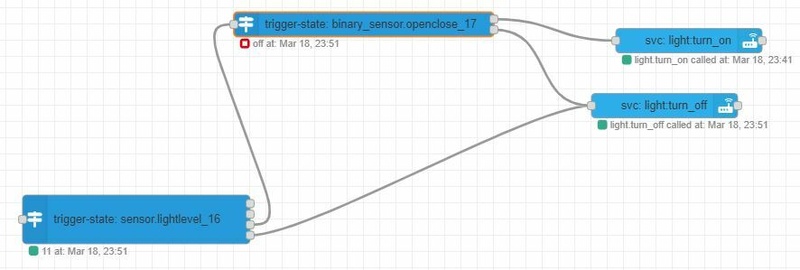

Ik ben in Home Assistant een beetje aan het rommelen met een message inject, maar ik krijg het niet voor elkaar dat de trigger state node reageert op mijn injected message:
Afbeeldingslocatie: https://tweakers.net/i/EcumVUxYFwi4RenwboBOuw5-G7c=/full-fit-in/4000x4000/filters:no_upscale():fill(white):strip_exif()/f/image/kkPbexhiMWdilddL055TOloC.png?f=user_large
Mijn code:
[{"id":"de42bddb.206b1","type":"trigger-state","z":"12b10ae6.113255","name":"Badkamer RH > 75%","server":"6c1ec26d.9d28fc","exposeToHomeAssistant":false,"haConfig":[{"property":"name","value":""},{"property":"icon","value":""}],"entityid":"sensor.badkamer_humidity_debug","entityidfiltertype":"exact","debugenabled":true,"constraints":[{"targetType":"this_entity","targetValue":"","propertyType":"current_state","comparatorType":">","comparatorValueDatatype":"str","comparatorValue":"75.0","propertyValue":"new_state.state"},{"targetType":"this_entity","targetValue":"","propertyType":"previous_state","comparatorType":"<=","comparatorValueDatatype":"str","comparatorValue":"75.0","propertyValue":"old_state.state"}],"outputs":2,"customoutputs":[],"outputinitially":false,"state_type":"str","x":340,"y":1100,"wires":[["5d947db5.b79664"],["2bd17efe.6fbe42"]]},{"id":"fd6dafcd.8a706","type":"inject","z":"12b10ae6.113255","name":"","props":[{"p":"topic","vt":"str"},{"p":"data","v":"{\"entity_id\":\"sensor.badkamer_humidity_debug\",\"old_state\":{\"state\":\"55.5\"},\"new_state\":{\"state\":\"90.0\"}}","vt":"json"},{"p":"payload"}],"repeat":"","crontab":"","once":false,"onceDelay":0.1,"topic":"sensor.badkamer_humidity_debug","payload":"90.0","payloadType":"str","x":130,"y":1120,"wires":[["de42bddb.206b1"]]},{"id":"2bd17efe.6fbe42","type":"api-call-service","z":"12b10ae6.113255","name":"Schakel lamp uit","server":"6c1ec26d.9d28fc","version":1,"debugenabled":false,"service_domain":"light","service":"turn_off","entityId":"light.hal_spotjes_lamp","data":"","dataType":"jsonata","mergecontext":"","output_location":"","output_location_type":"none","mustacheAltTags":false,"x":560,"y":1120,"wires":[[]]},{"id":"5d947db5.b79664","type":"api-call-service","z":"12b10ae6.113255","name":"Schakel lamp aan","server":"6c1ec26d.9d28fc","version":1,"debugenabled":false,"service_domain":"light","service":"turn_on","entityId":"light.hal_spotjes_lamp","data":"","dataType":"jsonata","mergecontext":"","output_location":"","output_location_type":"none","mustacheAltTags":false,"x":570,"y":1060,"wires":[[]]},{"id":"8394b547.3f1f48","type":"inject","z":"12b10ae6.113255","name":"","props":[{"p":"topic","vt":"str"},{"p":"data","v":"{\"entity_id\":\"sensor.badkamer_humidity_debug\",\"old_state\":{\"state\":\"90.0\"},\"new_state\":{\"state\":\"50.0\"}}","vt":"json"},{"p":"payload"}],"repeat":"","crontab":"","once":false,"onceDelay":0.1,"topic":"sensor.badkamer_humidity_debug","payload":"50.0","payloadType":"str","x":130,"y":1060,"wires":[["de42bddb.206b1"]]},{"id":"6c1ec26d.9d28fc","type":"server","name":"Home Assistant","addon":true}]
Wat doe ik verkeerd? 8)7

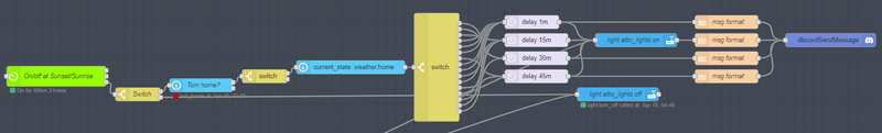

Ik ben bang dat ik het antwoord al weet :) maar is er een eenvoudige manier om mijn lightsequences in 1x aan te passen?
Wat heb ik:
- Lampen keuken op Big Timer aan/uit
- Lampen kamer op andere tijd aan/uit + 30 minuten vertragen + lampen bank aan/uit
- Lampen aanrecht op andere timer aan/uit
Wat wil ik:
Al deze sequences voorzien van een check op (dezelfde) input_select. Staat die op Thuis --> sequence aftrappen. Staat deze op Afwezig --> ANDERE sequence. Nu snap ik dat daar nu 1x deze check wellicht voor kan, die alle sequences aanstuurt, maar hebben jullie hier wellicht een slimme oplossing voor? Liefst wil ik bij dit soort wijzigingen zo min mogelijk aanpassen :)
Ik heb nu dus een Events: State Node, output gaat door een switch met de 4 statussen die Huis kan hebben, daar volgt dan weer: De gebruikelijke sequence, een random sequence uit.Maar kan dit handiger?

tjanssen schreef op vrijdag 19 februari 2021 @ 12:52:
Mijn code:
als ik de help zo lees, moet je wat je bij msg.data hebt staan, bij msg.payload zetten (en je hoeft alleen payload te sturen)
  • tjanssen
Step5 schreef op vrijdag 19 februari 2021 @ 21:32:
Bedankt voor het mee denken.... Maar dit werkt helaas ook niet.

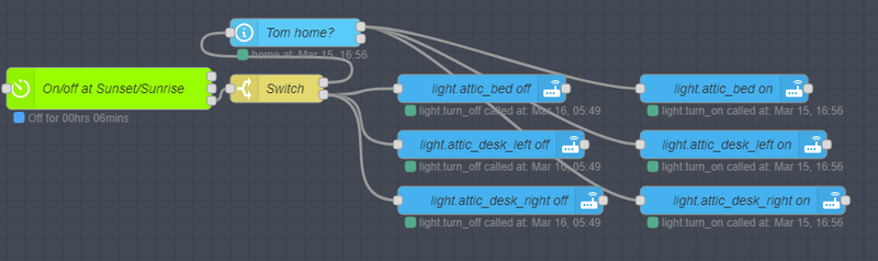

Hoe checkt men of een scene actief is? Het lijkt er op dat vanuit HomeAssistant een scene ALTIJD 'scening' geeft als status.
Ik heb namelijk een bewegingssensor aan mijn spotlampen gekoppeld met node-red, maar ik wil eigenlijk dat deze niet reageren als de filmmodus-scene actief is, maar dat lijkt helaas niet te kunnen?
  • denuz
  • Laatst online: 11:15
denuz
MsG schreef op dinsdag 23 februari 2021 @ 19:52:
Een scene is nooit actief. Een scene voert een bepaalde actie uit. Je kunt een scene ook niet uitschakelen. Je zult gebruik moeten maken van een variabele in node-red(flow/global), of een input.boolean in HA of traffic node.
  • Step5
  • Laatst online: 14:19
tjanssen schreef op maandag 22 februari 2021 @ 10:20:
Afbeeldingslocatie: https://tweakers.net/i/tzn792nSE5SokjJtVrRfe2V1K6o=/full-fit-in/4000x4000/filters:no_upscale():fill(white):strip_exif()/f/image/Df7T1m3mKypelBgkCJOSCtxF.png?f=user_large
[{"id":"de42bddb.206b1","type":"trigger-state","z":"f3132bbe.4c31b","name":"Badkamer RH > 75%","server":"1c3dc1f6.321306","exposeToHomeAssistant":false,"haConfig":[{"property":"name","value":""},{"property":"icon","value":""}],"entityid":"sensor.badkamer_humidity_debug","entityidfiltertype":"exact","debugenabled":true,"constraints":[{"targetType":"this_entity","targetValue":"","propertyType":"current_state","comparatorType":">","comparatorValueDatatype":"str","comparatorValue":"75.0","propertyValue":"new_state.state"},{"targetType":"this_entity","targetValue":"","propertyType":"previous_state","comparatorType":"<=","comparatorValueDatatype":"str","comparatorValue":"75.0","propertyValue":"old_state.state"}],"outputs":2,"customoutputs":[],"outputinitially":false,"state_type":"str","x":440,"y":1680,"wires":[["5d947db5.b79664"],["2bd17efe.6fbe42"]]},{"id":"fd6dafcd.8a706","type":"inject","z":"f3132bbe.4c31b","name":"90.0","props":[{"p":"payload"}],"repeat":"","crontab":"","once":false,"onceDelay":0.1,"topic":"","payload":"{\"entity_id\":\"sensor.badkamer_humidity_debug\",\"old_state\":{\"state\":\"55.5\"},\"new_state\":{\"state\":\"90.0\"}}","payloadType":"json","x":230,"y":1700,"wires":[["de42bddb.206b1"]]},{"id":"2bd17efe.6fbe42","type":"api-call-service","z":"f3132bbe.4c31b","name":"Schakel lamp uit","server":"1c3dc1f6.321306","version":1,"debugenabled":false,"service_domain":"light","service":"turn_off","entityId":"light.hal_spotjes_lamp","data":"","dataType":"jsonata","mergecontext":"","output_location":"","output_location_type":"none","mustacheAltTags":false,"x":660,"y":1700,"wires":[[]]},{"id":"5d947db5.b79664","type":"api-call-service","z":"f3132bbe.4c31b","name":"Schakel lamp aan","server":"1c3dc1f6.321306","version":1,"debugenabled":false,"service_domain":"light","service":"turn_on","entityId":"light.hal_spotjes_lamp","data":"","dataType":"jsonata","mergecontext":"","output_location":"","output_location_type":"none","mustacheAltTags":false,"x":670,"y":1640,"wires":[[]]},{"id":"8394b547.3f1f48","type":"inject","z":"f3132bbe.4c31b","name":"50.0","props":[{"p":"payload"}],"repeat":"","crontab":"","once":false,"onceDelay":0.1,"topic":"","payload":"{\"entity_id\":\"sensor.badkamer_humidity_debug\",\"old_state\":{\"state\":\"90.0\"},\"new_state\":{\"state\":\"50.0\"}}","payloadType":"json","x":230,"y":1640,"wires":[["de42bddb.206b1"]]},{"id":"1c3dc1f6.321306","type":"server","name":"Home Assistant","legacy":false,"addon":false,"rejectUnauthorizedCerts":true,"ha_boolean":"y|yes|true|on|home|open","connectionDelay":true,"cacheJson":true}]
Dit doet bij mij toch wat ik denk dat het moet doen, de waardes van de echte sensor overrulen om de trigger:state node te testen

  • Japie.G
Japie.G
Colour Classic
Hallo!
Ik ben nieuw in NodeRED en heb weinig (tot geen) programmeer/scripting kennis. Ik kan het vaak wel volgen als ik voorbeelden zie, en ben dus van het niveau volg een tutorial en met een beetje zoeken kom ik er wel uit.
Nu ben ik bezig een nieuwe home automation server te bouwen en wil het graag volgens best practice inrichten en heb daarom een vraag.
Ik krijg via MQTT een stuk JSON data binnen met daarin een hele shitload aan waardes behorende bij mijn warmtepomp. Ik maak nu voor elke afzonderlijke waarde een 'function' die de betreffende waarde uit de MQTT payload haalt, in een VAR stopt en die weer uitspuugt als een message. Zo'n function ziet er dan uit als dit:
//Lees specifiek stuk van payload
var tKeuken = Number(msg.payload["RT Temp."]);
msg.payload = tKeuken;
return msg;
Deze message kan ik dan gebruiken om naar InfluxDB de schrijven.
Mijn vraag is of dit niet handiger aangepakt kan worden. Kan ik niet 1 function maken die al mijn gewenste waardes bevat en dat in 1 batch naar influx schrijft? Mijn gevoel zegt dat wat ik aan het doen ben niet zo handig is.. Kan iemand me op weg helpen?
Renault Scenic E-Tech EV - PV-Output - 48kWh LiFePo4 op 15kVa Victron systeem
  • ThinkPad
  • Laatst online: 15:06
ThinkPad
@Japie.G Ja dat kan zeker. Zie de documentatie: https://flows.nodered.org/node/node-red-contrib-influxdb (zoek even op ‘multiple’).

  • TomR
  • Registratie: Mei 2001
  • Laatst online: 01-11 15:08
Afbeeldingslocatie: https://tweakers.net/i/qXdqHf0nOJ7TcAgdfgNroJ4KXQ8=/800x/filters:strip_exif()/f/image/OmagCmR0VEBycDsPByon6iWG.png?f=fotoalbum_largeIk heb de volgende set-up voor de lampen wanneer de lampen aangaan wanneer de zon ondergaat. Nu zag ik laatst in de history dat home assistant ziet wat voor een weer het is via weather.home. Heeft iemand een idee hoe ik mijn structuur het beste zou kunnen maken zodat de lampen eerder aan gaan wanneer de status cloudy, fog, hail, lightning, lightning-rainy, pouring of rainy is?
json:
[{"id":"962a75a6.2192b8","type":"api-call-service","z":"96c402e2.b2ae5","name":"light.attic_desk_left on","server":"f3ee3177.feac8","version":1,"debugenabled":false,"service_domain":"light","service":"turn_on","entityId":"light.attic_desk_left","data":"{\"brightness_pct\":30,\"transition\":240}","dataType":"json","mergecontext":"","output_location":"","output_location_type":"none","mustacheAltTags":false,"x":800,"y":260,"wires":[[]]},{"id":"7503886f.652838","type":"api-call-service","z":"96c402e2.b2ae5","name":"light.attic_desk_right on","server":"f3ee3177.feac8","version":1,"debugenabled":false,"service_domain":"light","service":"turn_on","entityId":"light.attic_desk_right","data":"{\"brightness_pct\":30,\"transition\":240}","dataType":"json","mergecontext":"","output_location":"","output_location_type":"none","mustacheAltTags":false,"x":810,"y":320,"wires":[[]]},{"id":"a642268b.311368","type":"switch","z":"96c402e2.b2ae5","name":"Switch","property":"payload","propertyType":"msg","rules":[{"t":"eq","v":"on","vt":"str"},{"t":"eq","v":"off","vt":"str"}],"checkall":"false","repair":false,"outputs":2,"x":310,"y":200,"wires":[["3488a7d0.5e3898"],["1bb590b2.faca7f","8ee0fc3e.bb4d3","cc5e0df9.08edf"]]},{"id":"3488a7d0.5e3898","type":"api-current-state","z":"96c402e2.b2ae5","name":"Tom home?","server":"f3ee3177.feac8","version":1,"outputs":2,"halt_if":"home","halt_if_type":"str","halt_if_compare":"is","override_topic":false,"entity_id":"person.tom","state_type":"str","state_location":"payload","override_payload":"msg","entity_location":"data","override_data":"msg","blockInputOverrides":false,"x":330,"y":140,"wires":[["7503886f.652838","962a75a6.2192b8","6daf1dff.5dfc84"],[]]},{"id":"6daf1dff.5dfc84","type":"api-call-service","z":"96c402e2.b2ae5","name":"light.attic_bed on","server":"f3ee3177.feac8","version":1,"debugenabled":false,"service_domain":"light","service":"turn_on","entityId":"light.attic_bed","data":"{\"brightness_pct\":30,\"transition\":240}","dataType":"json","mergecontext":"","output_location":"","output_location_type":"none","mustacheAltTags":false,"x":790,"y":200,"wires":[[]]},{"id":"5d9bae0a.1ad5b","type":"bigtimer","z":"96c402e2.b2ae5","outtopic":"","outpayload1":"","outpayload2":"","name":"On/off at Sunset/Sunrise","comment":"","lat":"51.94797153313037","lon":"5.873752058675393","starttime":"5004","endtime":"5003","startoff":"-45","endoff":"0","startoff2":"","endoff2":"","offs":0,"outtext1":"on","outtext2":"off","timeout":1440,"sun":true,"mon":true,"tue":true,"wed":true,"thu":true,"fri":true,"sat":true,"jan":true,"feb":true,"mar":true,"apr":true,"may":true,"jun":true,"jul":true,"aug":true,"sep":true,"oct":true,"nov":true,"dec":true,"day1":0,"month1":0,"day2":0,"month2":0,"day3":0,"month3":0,"day4":0,"month4":0,"day5":0,"month5":0,"day6":"","month6":"","day7":"","month7":"","day8":"","month8":"","day9":"","month9":"","day10":"","month10":"","day11":"","month11":"","day12":"","month12":"","d1":0,"w1":0,"d2":0,"w2":0,"d3":0,"w3":0,"d4":0,"w4":0,"d5":0,"w5":0,"d6":"","w6":"","xday1":"","xmonth1":"","xday2":"","xmonth2":"","xday3":"","xmonth3":"","xday4":"","xmonth4":"","xday5":"","xmonth5":"","xday6":"","xmonth6":"","xday7":"","xmonth7":"","xday8":"","xmonth8":"","xday9":"","xmonth9":"","xday10":"","xmonth10":"","xday11":"","xmonth11":"","xday12":"","xmonth12":"","xd1":"","xw1":"","xd2":"","xw2":"","xd3":"","xw3":"","xd4":"","xw4":"","xd5":"","xw5":"","xd6":"","xw6":"","suspend":false,"random":false,"randon1":false,"randoff1":false,"randon2":false,"randoff2":false,"repeat":true,"atstart":true,"odd":false,"even":false,"x":130,"y":200,"wires":[[],[],["a642268b.311368"]]},{"id":"cc5e0df9.08edf","type":"api-call-service","z":"96c402e2.b2ae5","name":"light.attic_desk_right off","server":"f3ee3177.feac8","version":1,"debugenabled":false,"service_domain":"light","service":"turn_off","entityId":"light.attic_desk_right","data":"","dataType":"json","mergecontext":"","output_location":"","output_location_type":"none","mustacheAltTags":false,"x":550,"y":320,"wires":[[]]},{"id":"8ee0fc3e.bb4d3","type":"api-call-service","z":"96c402e2.b2ae5","name":"light.attic_desk_left off","server":"f3ee3177.feac8","version":1,"debugenabled":false,"service_domain":"light","service":"turn_off","entityId":"light.attic_desk_left","data":"","dataType":"json","mergecontext":"","output_location":"","output_location_type":"none","mustacheAltTags":false,"x":540,"y":260,"wires":[[]]},{"id":"1bb590b2.faca7f","type":"api-call-service","z":"96c402e2.b2ae5","name":"light.attic_bed off","server":"f3ee3177.feac8","version":1,"debugenabled":false,"service_domain":"light","service":"turn_off","entityId":"light.attic_bed","data":"","dataType":"json","mergecontext":"","output_location":"","output_location_type":"none","mustacheAltTags":false,"x":530,"y":200,"wires":[[]]},{"id":"f3ee3177.feac8","type":"server","name":"Home Assistant","addon":true}]
  • etienne001
  • Laatst online: 13:00
Ben een beetje aan het stoeien in HA met node-red.
Ik heb een Xiaomi deurcontact verbonden aan een relais, dit relais is weer gekoppeld aan mijn alarmsysteem.
Ik heb een Xiaomi lux sensor
En ik heb verlichting
Nu zou ik het graag zo willen hebben dat mijn verlichting automatisch wordt geregeld met de lux sensor en het alarmsysteem.
Bij minder dan bijvoorbeeld 4 lux verlichting aan, bij meer dan 4 lux verlichting uit.
Wordt het alarmsysteem in de tussentijd geschakeld dan dient de verlichting hier mee gestuurd te worden.
Dus lampen aan, alles uit als het alarm aangaat.
Lampen uit en het alarm gaat uit en het is donker genoeg dan lampen aan.
Afbeeldingslocatie: https://tweakers.net/i/n8pc9q5Ogri4L3uz5FzDOkrMHKI=/800x/filters:strip_icc():strip_exif()/f/image/DKFbrXPoxc6cKAm678NvXZdF.jpg?f=fotoalbum_large
Ik dacht dit met onderstaande schakeling te doen, echter komt er geen enkele trigger richting de lampen.
Iemand toevallig een schopje in de goede richting?

TomR schreef op dinsdag 16 maart 2021 @ 18:00:
[Afbeelding]Ik heb de volgende set-up voor de lampen wanneer de lampen aangaan wanneer de zon ondergaat. Nu zag ik laatst in de history dat home assistant ziet wat voor een weer het is via weather.home. Heeft iemand een idee hoe ik mijn structuur het beste zou kunnen maken zodat de lampen eerder aan gaan wanneer de status cloudy, fog, hail, lightning, lightning-rainy, pouring of rainy is?

etienne001 schreef op vrijdag 19 maart 2021 @ 00:00:
[mbr]Verplaatst naar NodeRed aangezien het over de flow zelf gaat.[/mbr]
Hoi, Je kunt een trigger-state niet zo in je flow "hangen". je kunt de input daarvan volgens mij alleen gebruiken om test-data te sturen. Met een een current-state node kun je wel een huidige waarde opvragen
Misschien is dit (voorbeeld) een idee?

Ik ben nogal een beginner als het gaat om Node Red maar helaas lukt het mij niet om iets simpels voor elkaar te krijgen.
Via node red lees ik een waarde uit welke wordt aangeleverd uit Home Assistant. Deze waarde is als payload beschikbaar. Nu heb ik al verschillende flows die berichten sturen naar mijn Telegram. Nu wil ik ook deze payload waarde doorsturen echter krijgt ik het niet via een function node voor elkaar. Kan iemand mij op weg helpen/ een duwtje geven :)

Welke telegram node gebruik je?
Maar je kan zoiets proberen:
var bericht = "Morgen wordt "+msg.payload + " opgehaald";
msg.payload = {chatId : #####CHATID, type : 'message', content : bericht};
return msg;
json:
Een "State Node" met entity "weather.home"
Krijg je dit als output:
24
25
26
27
28
29
30
31
32
33
34
35
36
37
38
39
40
41
42
43

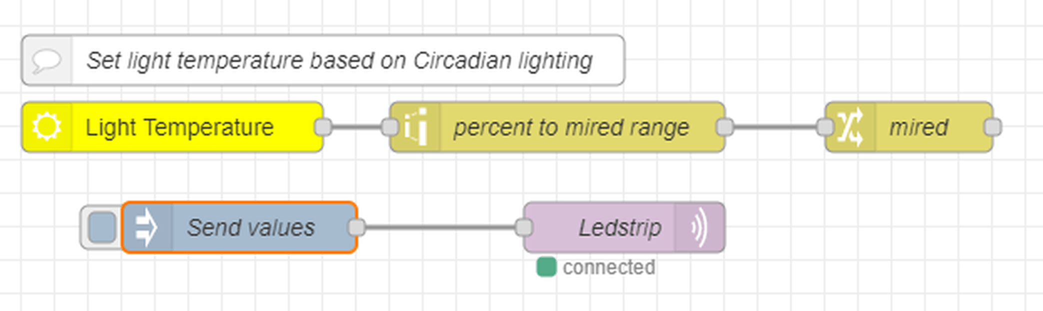

Klein stukje achtergrond:
Ben bezig om mijn bestaande zigbee (conbee) installatie te migreren naar zigbee2mqtt (zig-a-zig-ah). Dit om alles iets meer te standaardiseren, door zoveel mogelijk via mqtt te gaan aansturen.
Echter loop ik tegen het volgende aan…. Hoe gebruik ik een flow variable binnen een msg.payload? Ik zet bijv mijn licht temperatuur op basis van Circadian lighting als variable waarde, deze gebruikte ik dan weer in de JSON data door “{{{flow.Kelvin}}}” te gebruiken. Dit werkt niet meer in een payload, hoe moet ik nu een variable gebruiken?
Even ter test de volgende simpele flow
Afbeeldingslocatie: https://tweakers.net/i/Dx8t7Fl7SdPm64Y8YomXInCalt8=/full-fit-in/4000x4000/filters:no_upscale():fill(white):strip_exif()/f/image/6ZJNYgZ2oe8E1juGrWZ1XM4s.png?f=user_large
[{"id":"41b317f4.cf3688","type":"inject","z":"21ad7e8c.76d8e2","name":"Send values","props":[{"p":"payload"},{"p":"topic","vt":"str"}],"repeat":"","crontab":"","once":false,"onceDelay":0.1,"topic":"","payload":"{\"state\":\"ON\",\"brightness\":100,\"color_temp\":153}","payloadType":"json","x":170,"y":340,"wires":[["8edb4b27.464558"]]},{"id":"8edb4b27.464558","type":"mqtt out","z":"21ad7e8c.76d8e2","name":"Ledstrip","topic":"zigbee2mqtt/Test HUE Color LEDStrip/set","qos":"","retain":"","broker":"a60260e3.e3f4d","x":400,"y":340,"wires":[]},{"id":"32e327fb.e35648","type":"Circadian Light","z":"21ad7e8c.76d8e2","lat":"52.370216","lon":"4.895168","period":"1","topic":"","name":"Light Temperature","x":130,"y":280,"wires":[["7ffc2988.083a68"]]},{"id":"7ffc2988.083a68","type":"range","z":"21ad7e8c.76d8e2","minin":"0","maxin":"100","minout":"500","maxout":"153","action":"scale","round":true,"property":"payload.percent","name":"percent to mired range","x":360,"y":280,"wires":[["c7fa5116.02f9a"]]},{"id":"c7fa5116.02f9a","type":"change","z":"21ad7e8c.76d8e2","name":"mired","rules":[{"t":"set","p":"mired","pt":"flow","to":"payload.percent","tot":"msg"}],"action":"","property":"","from":"","to":"","reg":false,"x":570,"y":280,"wires":[[]]},{"id":"b527241a.8cda48","type":"comment","z":"21ad7e8c.76d8e2","name":"Set light temperature based on Circadian lighting","info":"","x":220,"y":240,"wires":[]},{"id":"a60260e3.e3f4d","type":"mqtt-broker","name":"mqtt-server","broker":"192.168.1.51","port":"1883","clientid":"","usetls":false,"compatmode":false,"keepalive":"60","cleansession":true,"birthTopic":"","birthQos":"0","birthPayload":"","closeTopic":"","closeQos":"0","closePayload":"","willTopic":"","willQos":"0","willPayload":""}]
JSON:
    "state": "ON",
    "brightness": 100,
    "color_temp": 153
Hoe vervangen ik de waarde bij color_temp voor een waarde die uit de flow mired komt?

Volgens mij kan je met een change node achter de "Send values" de msg.payload.color_temp gelijk stellen aan flow.mired
[{"id":"41b317f4.cf3688","type":"inject","z":"71a21150.78882","name":"Send values","props":[{"p":"payload"},{"p":"topic","vt":"str"}],"repeat":"","crontab":"","once":false,"onceDelay":0.1,"topic":"","payload":"{\"state\":\"ON\",\"brightness\":100,\"color_temp\":153}","payloadType":"json","x":250,"y":700,"wires":[["4741959e.d644dc"]]},{"id":"8edb4b27.464558","type":"mqtt out","z":"71a21150.78882","name":"Ledstrip","topic":"zigbee2mqtt/Test HUE Color LEDStrip/set","qos":"","retain":"","broker":"a60260e3.e3f4d","x":700,"y":700,"wires":[]},{"id":"4741959e.d644dc","type":"change","z":"71a21150.78882","name":"","rules":[{"t":"set","p":"payload.color_temp","pt":"msg","to":"mired","tot":"flow"}],"action":"","property":"","from":"","to":"","reg":false,"x":480,"y":700,"wires":[["8edb4b27.464558"]]},{"id":"a60260e3.e3f4d","type":"mqtt-broker","name":"mqtt-server","broker":"192.168.1.51","port":"1883","clientid":"","usetls":false,"compatmode":false,"keepalive":"60","cleansession":true,"birthTopic":"","birthQos":"0","birthPayload":"","closeTopic":"","closeQos":"0","closePayload":"","willTopic":"","willQos":"0","willPayload":""}]
[ Voor 82% gewijzigd door GORby op 19-04-2021 13:20 . Reden: json toegevoegd ]
  • kweetnie
  • Laatst online: 20-08 09:49
@GORby Helaas dat werkt niet.
  • GORby
  • Laatst online: 13:15
Vreemd, Wanneer ik deze code probeer en eerst de inject doe die de waarde van flow.mired zet, dan wordt de payload mooi aangepast bij de andere inject.
Wordt flow.mired bij jou wel gezet in dezelfde flow (tabblad)? Anders gaat het natuurlijk niet werken en moet je global.mired gebruiken bijvoorbeeld. Als je de ontext data bekijkt, zie je daar dan de waarde die je verwacht?

@GORby Helemaal top!, dank je wel. Was inderdaad slordig geweest, zat op 3 verschillende tabs(flows) te werken en heb niet geod opgelet dat ik die mired ook op mijn test pagina actief had.
Nogmaals naar gekeken en idd daar zat de fout.
Dank je nu werkt het.
