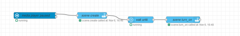

Je hoeft zeker niet te programmeren. Ik kan ook niet programmeren, maar red mezelf wel aardig in Node-Red.
In jouw geval kun je gebruik maken van de mogelijkheden die home assistant biedt, scene create in dit geval.
Iets als het volgende;
Afbeeldingslocatie: https://tweakers.net/i/2SJsHIHlZj_DJXxyZQgFkIdOoCI=/800x/filters:strip_exif()/f/image/47Dbg7r7uR58WUbV6TLPC8d1.png?f=fotoalbum_large
[{"id":"75fced06.b67174","type":"server-state-changed","z":"d6a3a911.20d4b8","name":"media player paused","server":"224924bb.3d06dc","version":1,"exposeToHomeAssistant":false,"haConfig":[{"property":"name","value":""},{"property":"icon","value":""}],"entityidfilter":"media_player.mibox4","entityidfiltertype":"exact","outputinitially":false,"state_type":"str","haltifstate":"paused","halt_if_type":"str","halt_if_compare":"is","outputs":2,"output_only_on_state_change":true,"for":0,"forType":"num","forUnits":"minutes","ignorePrevStateNull":false,"ignorePrevStateUnknown":false,"ignorePrevStateUnavailable":false,"ignoreCurrentStateUnknown":false,"ignoreCurrentStateUnavailable":false,"x":240,"y":160,"wires":[["6bbf44f3.c374cc"],[]]},{"id":"6bbf44f3.c374cc","type":"api-call-service","z":"d6a3a911.20d4b8","name":"scene create","server":"224924bb.3d06dc","version":1,"debugenabled":false,"service_domain":"scene","service":"create","entityId":"","data":"{\"scene_id\":\"mediapplayer_paused\",\"snapshot_entities\":\"light.ledstrip_tv,light.3_spotjes,light.stalamp\"}","dataType":"json","mergecontext":"","output_location":"","output_location_type":"none","mustacheAltTags":false,"x":510,"y":160,"wires":[["4d291cd7.4eddec"]]},{"id":"2288459e.8ac87a","type":"api-call-service","z":"d6a3a911.20d4b8","name":"scene turn_on","server":"224924bb.3d06dc","version":1,"debugenabled":false,"service_domain":"scene","service":"turn_on","entityId":"","data":"{\"entity_id\":\"scene.mediapplayer_paused\"}","dataType":"json","mergecontext":"","output_location":"","output_location_type":"none","mustacheAltTags":false,"x":940,"y":180,"wires":[[]]},{"id":"4d291cd7.4eddec","type":"ha-wait-until","z":"d6a3a911.20d4b8","name":"","server":"224924bb.3d06dc","outputs":1,"entityId":"media_player.mibox4","entityIdFilterType":"exact","property":"","comparator":"is","value":"playing","valueType":"str","timeout":0,"timeoutType":"num","timeoutUnits":"seconds","entityLocation":"","entityLocationType":"none","checkCurrentState":true,"blockInputOverrides":true,"x":740,"y":180,"wires":[["2288459e.8ac87a"]]},{"id":"224924bb.3d06dc","type":"server","name":"Home Assistant","legacy":false,"addon":true,"rejectUnauthorizedCerts":true,"ha_boolean":"y|yes|true|on|home|open","connectionDelay":false,"cacheJson":false}]
Check goed even de instellingen van de wait until node... en gebruik vooral de inject & debug node :)

denuz schreef op vrijdag 6 november 2020 @ 16:52:

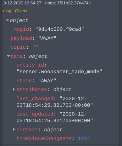

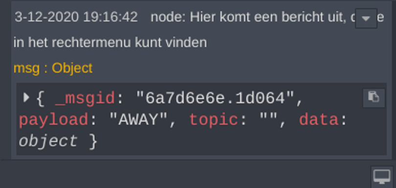

Zorg dat je tado op away mode staat. Pas de blauwe node aan met de entity van jouw Tado.
Klik op Deploy rechts bovenin, en klik vervolgens op het grijze vakje links van de inject node.
Vervolgens krijg je dan een debug bericht aan de rechterkant (dat soort tor/spin symbooltje) zie foto hieronder. Dan kun je daar de state zien, en de state die je daar ziet, die moet je dan gebruiken als switch, Maar geef eerst eens door wat voor state bericht je daar krijgt

@denuz
Ik blijf er maar niet uit komen, wat ik ook probeer of welk scenario ik ook bedenk met input booleans. Ik kan maar geen scenario bedenken dat mijn flow goed werkt.
Zoals eerder gezegd werkt onderstaande flow opzich wel. Dus ik loop van boven (overloop) naar beneden (gang) hij ziet door de wait untill node dat dit binnen de 20 seconden gebeurt, en hij activeert de keukenlamp.
Nou is het alleen zo dat vanwege polling (in mijn geval 15 seconden) de wait untill en de event node voor 15 seconden aan blijven staan. Loop ik dus van beneden (gang) naar boven (overloop) dan staan beide ook op aan, en wordt de automation dus ook getriggerd.
Zoals op het plaatje, wil ik echt enkel dat de flow van links naar rechts werkt. De wait untill node zou dus eigenlijk pas een status moeten vragen NADAT de eerste event: state is getriggerd en niet tussendoor moeten veranderen.
Ik heb echt het gevoel dat ik iets heel simpels over het hoofd zie!

Ik weet niet precies welke modes je bij de laaste node in moet vullen, maar ik denk dat deze onder climate valt en dan hvac_mode: Maar ik durf het niet met 100 procent zekerheid te zeggen.
Misschien kun je terug zien in de dubug (alles even uitklappen) onder wat voor modes dit valt?
Anders kun je trouwens ook nog kiezen voor climate, dan turn_off en dan de entity van jouw tado. Ik weet niet of dit onder hetzelfde valt, maar je snapt denk ik wel het idee dat de laatste node dus een UIT of AWAY status moet geven. Als je overigens de turn_off probeert, dan moet je de regel bij data even weghalen {"hvac_mode":"away"}

@denuz
Current state er tussen?
Dus eerst; Beweging overloop ? dan beweging gang=off; dan wait untill beweging gang=on.
Maar wil je dat deze flow enkel 1x per dag wordt getriggered? Of elke keer als je van boven naar beneden loopt?

@denuz
Ik heb het ondertussen opgelost, echter weet ik nog niet waarom het nu wel werkt.
Je hebt de optie Check against current state Zodra ik deze uitzet bij de wait untill node, dan doet hij het wel goed. Heb jij enig idee wat deze optie doet, en waarom de automation wel goed werkt als ik deze uit zet?
Met een current state node ging het trouwens ook niet werken, want nog steeds blijft gang beneden dan op ON staan vanwege de 15 seconden polling. Dat was/is heel het probleem.

Met een current state werkt het denk ik wel hoor.. maar dan wel zo.
Afbeeldingslocatie: https://tweakers.net/i/kXK2_H0nOBiBqifH5x2ZCZ4JlxM=/800x/filters:strip_exif()/f/image/WkEA6CXn6B9insVO3HEwLPq5.png?f=fotoalbum_large
Als gang beneden op off staat gaat de flow door. Anders stopt ie
En wat de check against doet staat in de docs :)
