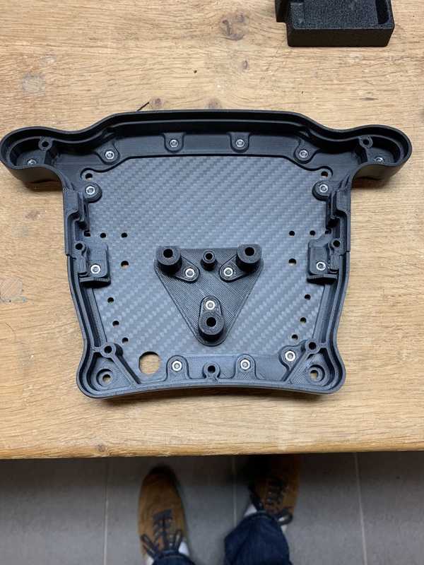

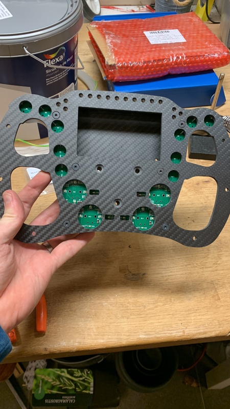

  • Hoogie2004
  • Laatst online: 13-11 08:46
Hoogie2004
Whohooooo
Er begint langzaam maar zeker schot in te komen. Eerste test fitting van de losse onderdelen:
Afbeeldingslocatie: https://tweakers.net/i/rPExofdBnwxJkzqrMT8cw0SukRg=/x800/filters:strip_icc():strip_exif()/f/image/uU6k771lGLK0Xcfu6YQ2z7jY.jpg?f=fotoalbum_large
Afbeeldingslocatie: https://tweakers.net/i/au82AlJ31RJ9m0NOrRYTkg1kwD8=/x800/filters:strip_icc():strip_exif()/f/image/vmedn7fucvtqnsfSv9Do9AFr.jpg?f=fotoalbum_large
Chad: Private Cycling Coach | Strava

Heb toch even contact opgenomen:
Thanks for your inquiry. I'm sorry to see that you were having some issues with your F1 steering wheel being detected properly. I'm glad to see that you managed to solve the issue, but to be honest I'm not sure why your solution worked as this isn't something we've come across before.
If it's not too much trouble, could you send me a picture of the pins in the steering wheel, as well as of the hub of the wheelbase so we can take a better look at it? If needed, we can also call your steering wheel in for an inspection.
