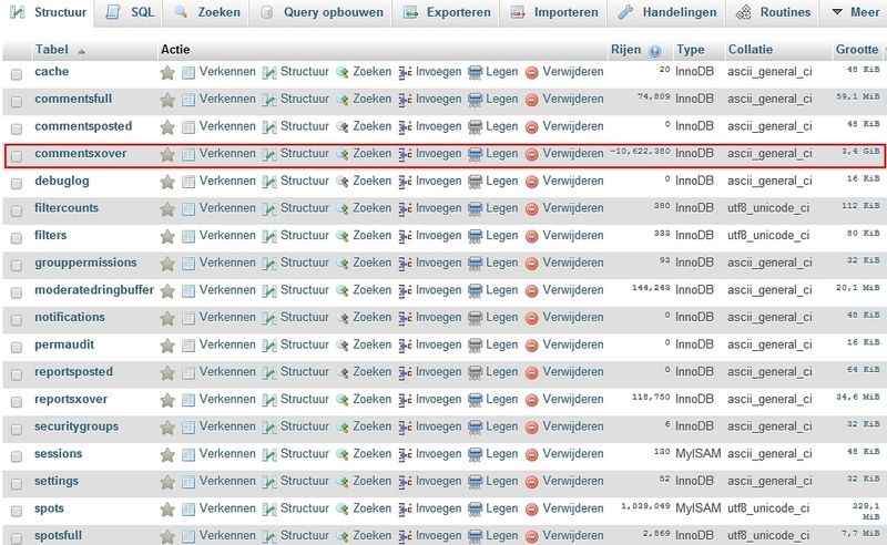

  • Workaholic
Weet iemand hoe je dit kunt fixen? Ik dacht zo slim te zijn om mijn commentsxover table is te verwijderen omdat deze 3gb was en ik deze opnieuw wou aanmaken met php upgfrade-db.php.
user@webserver:~/domains/mijndomein.nl/private_html/spotweb$ php upgrade-db.php
Updating schema..(mysql)
Validating spots(messageid)
Validating spots(poster)
Validating spots(title)
Validating spots(tag)
Validating spots(category)
Validating spots(subcata)
Validating spots(subcatb)
Validating spots(subcatc)
Validating spots(subcatd)
Validating spots(subcatz)
Validating spots(stamp)
Validating spots(reversestamp)
Validating spots(filesize)
Validating spots(moderated)
Validating spots(commentcount)
Validating spots(spotrating)
Validating spots(reportcount)
Validating spots(spotterid)
Validating spots(editstamp)
Validating spots(editor)
Validating spots(collectionid)
Validating spotsfull(messageid)
Validating spotsfull(verified)
Validating spotsfull(usersignature)
Validating spotsfull(userkey)
Validating spotsfull(xmlsignature)
Validating spotsfull(fullxml)
Validating usenetstate(infotype)
Validating usenetstate(curarticlenr)
Validating usenetstate(curmessageid)
Validating usenetstate(lastretrieved)
Validating usenetstate(nowrunning)
Database schema or settings upgrade failed:
HY000: 1005: Can't create table 'spotweb.commentsxover' (errno: 150)50)
#0 /home/user/domains/mijndomein.nl/private_html/spotweb/lib/dbstruct/SpotStruct_mysql.php(254): dbeng_pdo->rawExec('CREATE TABLE co...')
#1 /home/user/domains/mijndomein.nl/private_html/spotweb/lib/dbstruct/SpotStruct_abs.php(387): SpotStruct_mysql->createTable('commentsxover', 'ascii')
#2 /home/user/domains/mijndomein.nl/private_html/spotweb/lib/services/Upgrade/Services_Upgrade_Base.php(42): SpotStruct_abs->updateSchema()
#3 /home/user/domains/mijndomein.nl/private_html/spotweb/upgrade-db.php(44): Services_Upgrade_Base->database()
#4 {main}user@webserver:~/domains/mijndomein.nl/private_html/spotweb$
Lijkt me geen rechten issue omdat dit commando recent nog is gebruikt om nieuwe zaken aan te maken met de laatste git pull + database wijzigingen.
[ Voor 6% gewijzigd door Workaholic op 12-02-2015 11:11 ]

Workaholic schreef op donderdag 12 februari 2015 @ 11:06:
Ik zou met bv PHP Admin de tabel spotweb.commentsxover handmatig weer aanmaken.
Mogelijk dat je dan de upgrade weer kunt draaien.
Normaal gesproken legt upgrade-db.php je database aan en herbouwd deze als er dingen zijn die niet kloppen.
Tip voor de volgende keer ipv de complete tabel te verwijderen; lekker truncaten, oftewel leeggooien. Blijft de structuur ook gewoon behouden, maar de inhoud verwijderd.

CptChaos schreef op vrijdag 13 februari 2015 @ 17:42:
Goede voor de volgende keer.. heb het probleem uiteindelijk opgelost door meerdere tabellen te verwijderen (zat blijkbaar een koppeling met een bepaalde tabel ofzo?) en toen deed php upgrade het wel. Nadeel is dat ik ook de spots tabel heb moeten verwijderen.. dus het binnenhalen van alles gaat wel even duren :X
Voordeel is dat ik meteen weer een opgeruimde database heb haha

  • Workaholic
Workaholic schreef op vrijdag 13 februari 2015 @ 20:25:
Zo na bijna 24 uren updaten (php retrieve.php) is mijn spotweb database weer compleet :D. Wellicht ter informatie/vergelijking is dit mijn database nu 1,6GiB:
Afbeeldingslocatie: http://imgup.nl/images/2015/02/16/spotwebdatabase.png
Dit is met full spots, GEEN full comments en retentie van 397 dagen in het settings panel van Spotweb.
Vreemd genoeg is de grootste tabel toch commentsxover en dat verbaast me... Zou dit niet kleiner moeten zijn? Ik heb mijn database juist opnieuw opgebouwd, dus ik zou niet verwachten dat deze comments tabel veel informatie zou bevatten (comments haalt hij dan toch pas op bij het openen van een post??). Of is dit onderdeel van de full spots?

Workaholic schreef op maandag 16 februari 2015 @ 12:12:
Comments kun je instellen of hij deze direct ophaalt of pas bij het openen.
Spotweb --> Instellingen --> Tabblad Ophalen --> Comments volledig ophalen
Vinkje uit = Ophalen als post wordt geopend.
Vinkje aan = Direct alle comments ophalen en dan is je table dus ook groter.
  • Workaholic
Dat heb ik juist uitstaan.. daarom begrijp ik het ook niet. Dus retrieve comments AAN en retrieve full comments UIT (heb alles in het engels)
Mijn V&A
  • MikeOO
  • Laatst online: 06:53
Workaholic schreef op dinsdag 17 februari 2015 @ 08:02:
Ik heb bij mij even gekekeken en die database draait al vrij lang en daar is deze ook het grootste en momenteel zit ik op 2,3GiB.
Dit is maar een klein verschil tov van die van jouw en die DB is nieuw. Mogelijk toch een paar dagen aankijken hoe snel deze groeit of dat hij redelijk gelijk blijft met wat je nu hebt.
Misschien dat er standaard wel een bepaalde grote wordt gereserveerd voor dit veld.

Dat maakt niet uit, commentsxover zijn níet de full comments, die staan namelijk in tabel commentsfull. Commentsxover wordt áltijd gevuld en is áltijd heel groot. Wat deze tabel wél doet is mij echter niet helemaal duidelijk.
In het verleden heb ik wel eens verzocht om een mogelijkheid in te bouwen om comments ouder dan X tijd te kunnen verwijderen, zodat ook die tabel kleiner wordt, maar is niet echt op gereageerd en paar maanden later was de github repo weg, dus de issues die open stonden, zijn daarbij ook verdwenen, waarbij ik geen zin had om deze opnieuw aan te vragen.

  • Enforcer
CptChaos schreef op woensdag 25 februari 2015 @ 12:17:
Script zie: Mr_Blobby in "SpotWeb - Webbased Spotnet - deel 2"
Ergens verderop in één van de postings rond die tijd staat wat commentsxover table doet, volgens mij was het iets van een soort header informatie zodat Spotweb weet welke comments bij welke spot hoort e.d.
Gebruik het script zelf ook (her en der wat aangepast) ... Ik hoef namelijk geen comments te zien van een +1 jaar geleden. Script draait elke nacht en houdt de table meestal onder de 850MB met een spotretentie van 1100 ingesteld. Momenteel is de table:
commentsxover  - 2.612.089 records - 810,8 MB

Ik kreeg vandaag een berichtje van een kennis van mij waar ik een Spotweb installatie op zijn VPS heb staan.
Hij was bezig met een backup aan het terugzetten en ondervind flinke hinder van mijn database.
Volgens hem heeft hij een database van een forum van 6,7GB 10 min nodig om te herstellen en mijn database ruim een uur waardoor alles traag is. Ik krijg dit gratis van hem dus wil hem niet teveel voor de voeten lopen.
Mijn database is 3,8GiB groot zie ik in phpMyAdmin, de commentsxover tabel is het grootste:
Afbeeldingslocatie: http://i204.photobucket.com/albums/bb128/Binnetie/spotweb_db_zps75jd1x6w.jpg
Volgens mij had ik ingesteld dat dat hij alleen bij het openen van een spot de comments op mag halen, maar kan dit nu niet nagaan omdat de server even in onderhoud is.
Indien de functie 'comments volledig ophalen' afgevinkt staan, wat kan dan verklaren dat die tabel zo groot is? En kan ik deze tabel leeggooien indien ik niet wil dat alle comments worden opgeslagen?
Zijn er eventuele nog meer opties om de database wat kleiner te maken? Ik heb afgelopen week toevallig het aantal spot wat hij op moet halen van 1800 naar 1200 dagen gedaan, maar de database lijkt niet kleiner. Gooit hij de oude spots niet automatisch weg?

Binnetie schreef op zaterdag 14 maart 2015 @ 18:13:
Je haalt niet de volledige comments op want anders was je "commentsfull" tabel veeeeeel groter geweest. De "commentsxover" tabel bevat alleen verwijzingen naar de comments die bij een spot geplaatst zijn, maar desondanks neemt deze inderdaad verreweg de meeste ruimte in. Kijk even hier naar een manier om deze tabel te verkleinen door alle comments te verwijderen die ouder zijn dan een jaar. Dezelfde manier kan je ook gebruiken om alle spots te verwijderen die ouder dan 1200 dagen zijn.

Bedankt! Ik heb je script gevonden:
PHP:
<?php
$con=mysqli_connect("localhost","username","password","dbname");
if (mysqli_connect_errno($con)) {
    echo "Failed to connect to MySQL: " . mysqli_connect_error();
} else {
    $yearago = mktime(0,0,0,date(n),date(j),date(Y)-1);
    $query = "SELECT COUNT(*) FROM `commentsxover` WHERE `stamp` < " . $yearago;
    $result = mysqli_query($con,$query);
    $row = $result->fetch_row();
    echo "Current number of records older than " . date(j) . "-" . date(n) . "-" . (date(Y)-1) . ": " . $row[0] . "\n";
    echo "Deleting records (maximum 30000) ...";
    $query = "DELETE FROM `commentsxover` WHERE `stamp` < " . $yearago . " LIMIT 30000";
    echo " done\n";
    mysqli_close($con);
Ik hoef alleen maar de 2e regel in te vullen met mijn inloggegevens en meer niet? Mijn PHP kennis is niet zo heel erg groot namelijk :-(
