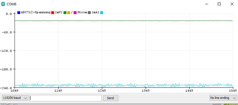

Toevoeging...
Heb de loadkabels weer andersom gezet (zoal ik al dacht dat het hoorde).
Krijg ik dit zonder load:
15:55:55.626 -> ADC712-Spannung [mV]: -22.67 / Strom [mA]: -226.72
15:55:56.110 -> ADC712-Spannung [mV]: -21.93 / Strom [mA]: -219.30
15:55:56.644 -> ADC712-Spannung [mV]: -21.23 / Strom [mA]: -212.27
15:55:57.127 -> ADC712-Spannung [mV]: -20.70 / Strom [mA]: -207.03
15:55:57.623 -> ADC712-Spannung [mV]: -20.53 / Strom [mA]: -205.31
15:55:58.127 -> ADC712-Spannung [mV]: -20.88 / Strom [mA]: -208.83
15:55:58.644 -> ADC712-Spannung [mV]: -21.80 / Strom [mA]: -218.05
15:55:59.158 -> ADC712-Spannung [mV]: -22.61 / Strom [mA]: -226.09
15:55:59.627 -> ADC712-Spannung [mV]: -22.96 / Strom [mA]: -229.61
15:56:00.155 -> ADC712-Spannung [mV]: -23.16 / Strom [mA]: -231.56
15:56:00.644 -> ADC712-Spannung [mV]: -22.67 / Strom [mA]: -226.72
15:56:01.144 -> ADC712-Spannung [mV]: -21.88 / Strom [mA]: -218.75
15:56:01.627 -> ADC712-Spannung [mV]: -21.31 / Strom [mA]: -213.13
15:56:02.144 -> ADC712-Spannung [mV]: -20.74 / Strom [mA]: -207.42
15:56:02.661 -> ADC712-Spannung [mV]: -20.56 / Strom [mA]: -205.63
15:56:03.142 -> ADC712-Spannung [mV]: -21.16 / Strom [mA]: -211.64
15:56:03.657 -> ADC712-Spannung [mV]: -21.92 / Strom [mA]: -219.22
En dit met de telefoonlader:
15:56:10.677 -> ADC712-Spannung [mV]: -25.40 / Strom [mA]: -253.98
15:56:11.160 -> ADC712-Spannung [mV]: -24.34 / Strom [mA]: -243.36
15:56:11.677 -> ADC712-Spannung [mV]: -26.29 / Strom [mA]: -262.89
15:56:12.177 -> ADC712-Spannung [mV]: -25.95 / Strom [mA]: -259.53
15:56:12.694 -> ADC712-Spannung [mV]: -20.67 / Strom [mA]: -206.72
15:56:13.175 -> ADC712-Spannung [mV]: -15.96 / Strom [mA]: -159.61
15:56:13.675 -> ADC712-Spannung [mV]: -16.74 / Strom [mA]: -167.42
15:56:14.177 -> ADC712-Spannung [mV]: -22.36 / Strom [mA]: -223.59
15:56:14.695 -> ADC712-Spannung [mV]: -19.06 / Strom [mA]: -190.63
15:56:15.193 -> ADC712-Spannung [mV]: -22.57 / Strom [mA]: -225.70
15:56:15.677 -> ADC712-Spannung [mV]: -28.23 / Strom [mA]: -282.34
15:56:16.210 -> ADC712-Spannung [mV]: -30.18 / Strom [mA]: -301.80
15:56:16.694 -> ADC712-Spannung [mV]: -31.59 / Strom [mA]: -315.94
15:56:17.210 -> ADC712-Spannung [mV]: -32.82 / Strom [mA]: -328.20
15:56:17.725 -> ADC712-Spannung [mV]: -20.71 / Strom [mA]: -207.11
15:56:18.210 -> ADC712-Spannung [mV]: -6.20 / Strom [mA]: -62.03
15:56:18.694 -> ADC712-Spannung [mV]: -2.05 / Strom [mA]: -20.47
15:56:19.210 -> ADC712-Spannung [mV]: -0.81 / Strom [mA]: -8.13
15:56:19.711 -> ADC712-Spannung [mV]: 0.02 / Strom [mA]: 0.23
15:56:20.210 -> ADC712-Spannung [mV]: -21.94 / Strom [mA]: -219.38
15:56:20.727 -> ADC712-Spannung [mV]: -44.68 / Strom [mA]: -446.80
15:56:21.205 -> ADC712-Spannung [mV]: -51.16 / Strom [mA]: -511.64
15:56:21.744 -> ADC712-Spannung [mV]: -49.66 / Strom [mA]: -496.64
15:56:22.210 -> ADC712-Spannung [mV]: -49.84 / Strom [mA]: -498.44
15:56:22.710 -> ADC712-Spannung [mV]: -24.84 / Strom [mA]: -248.44
15:56:23.224 -> ADC712-Spannung [mV]: -2.46 / Strom [mA]: -24.61
15:56:23.710 -> ADC712-Spannung [mV]: 7.53 / Strom [mA]: 75.31
15:56:24.224 -> ADC712-Spannung [mV]: 5.97 / Strom [mA]: 59.69
15:56:24.710 -> ADC712-Spannung [mV]: 6.07 / Strom [mA]: 60.70
15:56:25.224 -> ADC712-Spannung [mV]: -16.23 / Strom [mA]: -162.27
15:56:25.727 -> ADC712-Spannung [mV]: -38.05 / Strom [mA]: -380.47
15:56:26.240 -> ADC712-Spannung [mV]: -51.48 / Strom [mA]: -514.84
15:56:26.727 -> ADC712-Spannung [mV]: -49.70 / Strom [mA]: -497.03
15:56:27.244 -> ADC712-Spannung [mV]: -49.98 / Strom [mA]: -499.84
15:56:27.744 -> ADC712-Spannung [mV]: -32.38 / Strom [mA]: -323.83
15:56:28.244 -> ADC712-Spannung [mV]: -13.70 / Strom [mA]: -137.03
15:56:28.744 -> ADC712-Spannung [mV]: 7.95 / Strom [mA]: 79.45
15:56:29.243 -> ADC712-Spannung [mV]: 5.88 / Strom [mA]: 58.75
15:56:29.760 -> ADC712-Spannung [mV]: 6.55 / Strom [mA]: 65.55
15:56:30.277 -> ADC712-Spannung [mV]: -5.12 / Strom [mA]: -51.17
15:56:30.760 -> ADC712-Spannung [mV]: -24.23 / Strom [mA]: -242.27
15:56:31.243 -> ADC712-Spannung [mV]: -49.92 / Strom [mA]: -499.22
15:56:31.744 -> ADC712-Spannung [mV]: -50.41 / Strom [mA]: -504.14
15:56:32.243 -> ADC712-Spannung [mV]: -50.28 / Strom [mA]: -502.81
15:56:32.775 -> ADC712-Spannung [mV]: -45.84 / Strom [mA]: -458.44
15:56:33.275 -> ADC712-Spannung [mV]: -21.80 / Strom [mA]: -218.05
15:56:33.777 -> ADC712-Spannung [mV]: 1.98 / Strom [mA]: 19.84
15:56:34.260 -> ADC712-Spannung [mV]: 7.53 / Strom [mA]: 75.31
15:56:34.777 -> ADC712-Spannung [mV]: 6.20 / Strom [mA]: 61.95
15:56:35.261 -> ADC712-Spannung [mV]: 4.82 / Strom [mA]: 48.20
15:56:35.777 -> ADC712-Spannung [mV]: -16.92 / Strom [mA]: -169.22
15:56:36.293 -> ADC712-Spannung [mV]: -35.56 / Strom [mA]: -355.63
15:56:36.794 -> ADC712-Spannung [mV]: -22.77 / Strom [mA]: -227.66
15:56:37.260 -> ADC712-Spannung [mV]: -22.45 / Strom [mA]: -224.45
15:56:37.760 -> ADC712-Spannung [mV]: -21.53 / Strom [mA]: -215.31
15:56:38.294 -> ADC712-Spannung [mV]: -21.18 / Strom [mA]: -211.80
Lijkt erop alsof we ergens komen nu.

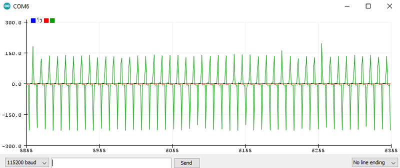

Zonder load:
Afbeeldingslocatie: https://tweakers.net/i/W-2JoOmdv0MIwa8Y3da3dH2JEPk=/800x/filters:strip_exif()/f/image/MJo8NkBje3aos6Dy2zvOCjuc.png?f=fotoalbum_large
Met load:
Afbeeldingslocatie: https://tweakers.net/i/fK5IFFT8yUZVh53qPoYBaYgR0Co=/800x/filters:strip_exif()/f/image/sFwCLUf4swG23bzYfFrJIZCp.png?f=fotoalbum_large

Zonder load kreeg ik nu dit:
Afbeeldingslocatie: https://tweakers.net/i/CvCdsId_a3kW58q-f_NjeI6iGxk=/800x/filters:strip_exif()/f/image/Wh937IV0oW0Hm4vM7xMMZPpj.png?f=fotoalbum_large
Met waterkoker load:
Afbeeldingslocatie: https://tweakers.net/i/dmuzRFOZkf1H0aK9vT7EFsn_p-E=/800x/filters:strip_exif()/f/image/P5m8dZKQT5VoKe0sbcv6d84w.png?f=fotoalbum_large
En in de monitor zag er dat zo uit (even gedeelte gepakt):

16:14:03.863 -> ADC712-Spannung [mV]: -531.75 / Strom [mA]: -5317.50
16:14:03.863 -> ADC712-Spannung [mV]: 471.19 / Strom [mA]: 4711.88
16:14:03.863 -> ADC712-Spannung [mV]: -292.38 / Strom [mA]: -2923.75
16:14:03.863 -> ADC712-Spannung [mV]: 56.38 / Strom [mA]: 563.75
16:14:03.863 -> ADC712-Spannung [mV]: 27.06 / Strom [mA]: 270.63
16:14:03.863 -> ADC712-Spannung [mV]: -368.13 / Strom [mA]: -3681.25
16:14:03.913 -> ADC712-Spannung [mV]: -368.13 / Strom [mA]: -3681.25
16:14:03.913 -> ADC712-Spannung [mV]: 604.13 / Strom [mA]: 6041.25
16:14:03.913 -> ADC712-Spannung [mV]: -708.19 / Strom [mA]: -7081.88
16:14:03.913 -> ADC712-Spannung [mV]: 797.69 / Strom [mA]: 7976.88
16:14:03.913 -> ADC712-Spannung [mV]: -892.25 / Strom [mA]: -8922.50
16:14:03.913 -> ADC712-Spannung [mV]: 935.81 / Strom [mA]: 9358.13
16:14:03.947 -> ADC712-Spannung [mV]: -998.13 / Strom [mA]: -9981.25
16:14:03.947 -> ADC712-Spannung [mV]: 992.50 / Strom [mA]: 9925.00
16:14:03.947 -> ADC712-Spannung [mV]: -1031.50 / Strom [mA]: -10315.00
16:14:03.947 -> ADC712-Spannung [mV]: 965.88 / Strom [mA]: 9658.75
16:14:03.980 -> ADC712-Spannung [mV]: 965.88 / Strom [mA]: 9658.75
16:14:03.980 -> ADC712-Spannung [mV]: -1006.75 / Strom [mA]: -10067.50
16:14:03.980 -> ADC712-Spannung [mV]: 906.25 / Strom [mA]: 9062.50
16:14:03.980 -> ADC712-Spannung [mV]: -948.56 / Strom [mA]: -9485.63
16:14:04.027 -> ADC712-Spannung [mV]: 801.94 / Strom [mA]: 8019.38
16:14:04.027 -> ADC712-Spannung [mV]: -797.81 / Strom [mA]: -7978.13
16:14:04.027 -> ADC712-Spannung [mV]: 596.06 / Strom [mA]: 5960.63
16:14:04.027 -> ADC712-Spannung [mV]: -558.25 / Strom [mA]: -5582.50
16:14:04.027 -> ADC712-Spannung [mV]: 352.31 / Strom [mA]: 3523.13
16:14:04.061 -> ADC712-Spannung [mV]: 352.31 / Strom [mA]: 3523.13
16:14:04.061 -> ADC712-Spannung [mV]: -305.63 / Strom [mA]: -3056.25
16:14:04.061 -> ADC712-Spannung [mV]: 88.44 / Strom [mA]: 884.38
16:14:04.061 -> ADC712-Spannung [mV]: -4.94 / Strom [mA]: -49.38
16:14:04.061 -> ADC712-Spannung [mV]: -338.56 / Strom [mA]: -3385.63
16:14:04.106 -> ADC712-Spannung [mV]: -338.56 / Strom [mA]: -3385.63
16:14:04.106 -> ADC712-Spannung [mV]: 577.63 / Strom [mA]: 5776.25
16:14:04.106 -> ADC712-Spannung [mV]: -687.81 / Strom [mA]: -6878.13
16:14:04.106 -> ADC712-Spannung [mV]: 767.63 / Strom [mA]: 7676.25
16:14:04.106 -> ADC712-Spannung [mV]: -876.88 / Strom [mA]: -8768.75
16:14:04.106 -> ADC712-Spannung [mV]: 925.88 / Strom [mA]: 9258.75
16:14:04.146 -> ADC712-Spannung [mV]: 925.88 / Strom [mA]: 9258.75
16:14:04.146 -> ADC712-Spannung [mV]: -990.00 / Strom [mA]: -9900.00
16:14:04.146 -> ADC712-Spannung [mV]: 969.44 / Strom [mA]: 9694.38
16:14:04.146 -> ADC712-Spannung [mV]: -1031.00 / Strom [mA]: -10310.00
16:14:04.146 -> ADC712-Spannung [mV]: 972.50 / Strom [mA]: 9725.00
16:14:04.196 -> ADC712-Spannung [mV]: 972.50 / Strom [mA]: 9725.00
16:14:04.196 -> ADC712-Spannung [mV]: -1013.31 / Strom [mA]: -10133.13
16:14:04.196 -> ADC712-Spannung [mV]: 919.06 / Strom [mA]: 9190.63
16:14:04.196 -> ADC712-Spannung [mV]: -960.56 / Strom [mA]: -9605.63
16:14:04.196 -> ADC712-Spannung [mV]: 826.25 / Strom [mA]: 8262.50
16:14:04.196 -> ADC712-Spannung [mV]: -825.44 / Strom [mA]: -8254.38
16:14:04.230 -> ADC712-Spannung [mV]: -825.44 / Strom [mA]: -8254.38
16:14:04.230 -> ADC712-Spannung [mV]: 619.00 / Strom [mA]: 6190.00
16:14:04.230 -> ADC712-Spannung [mV]: -582.44 / Strom [mA]: -5824.38
16:14:04.230 -> ADC712-Spannung [mV]: 374.19 / Strom [mA]: 3741.88
16:14:04.263 -> ADC712-Spannung [mV]: -425.94 / Strom [mA]: -4259.38
16:14:04.263 -> ADC712-Spannung [mV]: 136.50 / Strom [mA]: 1365.00
16:14:04.263 -> ADC712-Spannung [mV]: -35.06 / Strom [mA]: -350.63
16:14:04.263 -> ADC712-Spannung [mV]: -205.50 / Strom [mA]: -2055.00
16:14:04.296 -> ADC712-Spannung [mV]: -205.50 / Strom [mA]: -2055.00
16:14:04.296 -> ADC712-Spannung [mV]: 359.06 / Strom [mA]: 3590.63
16:14:04.296 -> ADC712-Spannung [mV]: -480.25 / Strom [mA]: -4802.50
16:14:04.296 -> ADC712-Spannung [mV]: 611.56 / Strom [mA]: 6115.63
16:14:04.346 -> ADC712-Spannung [mV]: -711.50 / Strom [mA]: -7115.00
16:14:04.346 -> ADC712-Spannung [mV]: 815.88 / Strom [mA]: 8158.75
16:14:04.346 -> ADC712-Spannung [mV]: -897.63 / Strom [mA]: -8976.25
16:14:04.346 -> ADC712-Spannung [mV]: 939.25 / Strom [mA]: 9392.50
16:14:04.346 -> ADC712-Spannung [mV]: -1001.38 / Strom [mA]: -10013.75
16:14:04.380 -> ADC712-Spannung [mV]: 994.69 / Strom [mA]: 9946.88
16:14:04.380 -> ADC712-Spannung [mV]: -1030.06 / Strom [mA]: -10300.63
16:14:04.380 -> ADC712-Spannung [mV]: 986.25 / Strom [mA]: 9862.50
16:14:04.380 -> ADC712-Spannung [mV]: -1024.31 / Strom [mA]: -10243.13
16:14:04.414 -> ADC712-Spannung [mV]: -1024.31 / Strom [mA]: -10243.13
16:14:04.414 -> ADC712-Spannung [mV]: 942.13 / Strom [mA]: 9421.25
16:14:04.414 -> ADC712-Spannung [mV]: -994.00 / Strom [mA]: -9940.00
16:14:04.414 -> ADC712-Spannung [mV]: 864.06 / Strom [mA]: 8640.63
16:14:04.414 -> ADC712-Spannung [mV]: -852.00 / Strom [mA]: -8520.00
16:14:04.463 -> ADC712-Spannung [mV]: -852.00 / Strom [mA]: -8520.00
16:14:04.463 -> ADC712-Spannung [mV]: 671.38 / Strom [mA]: 6713.75
16:14:04.463 -> ADC712-Spannung [mV]: -756.88 / Strom [mA]: -7568.75
16:14:04.463 -> ADC712-Spannung [mV]: 473.81 / Strom [mA]: 4738.13
16:14:04.463 -> ADC712-Spannung [mV]: -389.44 / Strom [mA]: -3894.38
16:14:04.463 -> ADC712-Spannung [mV]: 160.56 / Strom [mA]: 1605.63
16:14:04.496 -> ADC712-Spannung [mV]: 160.56 / Strom [mA]: 1605.63
16:14:04.496 -> ADC712-Spannung [mV]: -104.00 / Strom [mA]: -1040.00
16:14:04.496 -> ADC712-Spannung [mV]: -138.44 / Strom [mA]: -1384.38
16:14:04.496 -> ADC712-Spannung [mV]: 188.69 / Strom [mA]: 1886.88
16:14:04.546 -> ADC712-Spannung [mV]: -290.19 / Strom [mA]: -2901.88
16:14:04.546 -> ADC712-Spannung [mV]: 464.31 / Strom [mA]: 4643.13
16:14:04.546 -> ADC712-Spannung [mV]: -581.69 / Strom [mA]: -5816.88
16:14:04.546 -> ADC712-Spannung [mV]: 702.13 / Strom [mA]: 7021.25
16:14:04.546 -> ADC712-Spannung [mV]: -726.81 / Strom [mA]: -7268.13
16:14:04.592 -> ADC712-Spannung [mV]: 873.06 / Strom [mA]: 8730.63
16:14:04.592 -> ADC712-Spannung [mV]: -947.38 / Strom [mA]: -9473.75
16:14:04.592 -> ADC712-Spannung [mV]: 969.69 / Strom [mA]: 9696.88
16:14:04.592 -> ADC712-Spannung [mV]: -1022.25 / Strom [mA]: -10222.50
16:14:04.592 -> ADC712-Spannung [mV]: 992.44 / Strom [mA]: 9924.38
16:14:04.630 -> ADC712-Spannung [mV]: -1023.00 / Strom [mA]: -10230.00
16:14:04.630 -> ADC712-Spannung [mV]: 965.31 / Strom [mA]: 9653.13
16:14:04.630 -> ADC712-Spannung [mV]: -1004.50 / Strom [mA]: -10045.00
16:14:04.630 -> ADC712-Spannung [mV]: 897.69 / Strom [mA]: 8976.88
16:14:04.663 -> ADC712-Spannung [mV]: 897.69 / Strom [mA]: 8976.88
16:14:04.663 -> ADC712-Spannung [mV]: -941.69 / Strom [mA]: -9416.88
16:14:04.663 -> ADC712-Spannung [mV]: 810.69 / Strom [mA]: 8106.88
16:14:04.663 -> ADC712-Spannung [mV]: -771.19 / Strom [mA]: -7711.88
16:14:04.697 -> ADC712-Spannung [mV]: 582.63 / Strom [mA]: 5826.25
16:14:04.697 -> ADC712-Spannung [mV]: -543.38 / Strom [mA]: -5433.75
16:14:04.697 -> ADC712-Spannung [mV]: 331.38 / Strom [mA]: 3313.75
16:14:04.697 -> ADC712-Spannung [mV]: -285.50 / Strom [mA]: -2855.00
16:14:04.730 -> ADC712-Spannung [mV]: -285.50 / Strom [mA]: -2855.00
16:14:04.730 -> ADC712-Spannung [mV]: 40.75 / Strom [mA]: 407.50
16:14:04.730 -> ADC712-Spannung [mV]: -0.94 / Strom [mA]: -9.38
16:14:04.730 -> ADC712-Spannung [mV]: -356.25 / Strom [mA]: -3562.50
16:14:04.763 -> ADC712-Spannung [mV]: 637.00 / Strom [mA]: 6370.00
16:14:04.763 -> ADC712-Spannung [mV]: -738.69 / Strom [mA]: -7386.88
16:14:04.763 -> ADC712-Spannung [mV]: 819.75 / Strom [mA]: 8197.50
16:14:04.763 -> ADC712-Spannung [mV]: -912.06 / Strom [mA]: -9120.63
16:14:04.796 -> ADC712-Spannung [mV]: -912.06 / Strom [mA]: -9120.63
16:14:04.796 -> ADC712-Spannung [mV]: 947.50 / Strom [mA]: 9475.00
16:14:04.796 -> ADC712-Spannung [mV]: -1008.00 / Strom [mA]: -10080.00
16:14:04.796 -> ADC712-Spannung [mV]: 995.50 / Strom [mA]: 9955.00
16:14:04.830 -> ADC712-Spannung [mV]: -1030.50 / Strom [mA]: -10305.00
16:14:04.830 -> ADC712-Spannung [mV]: 983.81 / Strom [mA]: 9838.13
16:14:04.830 -> ADC712-Spannung [mV]: -1020.38 / Strom [mA]: -10203.75
16:14:04.830 -> ADC712-Spannung [mV]: 930.75 / Strom [mA]: 9307.50
16:14:04.863 -> ADC712-Spannung [mV]: -972.81 / Strom [mA]: -9728.13
16:14:04.863 -> ADC712-Spannung [mV]: 929.00 / Strom [mA]: 9290.00
16:14:04.863 -> ADC712-Spannung [mV]: -830.06 / Strom [mA]: -8300.63
16:14:04.897 -> ADC712-Spannung [mV]: 650.00 / Strom [mA]: 6500.00
16:14:04.897 -> ADC712-Spannung [mV]: -613.44 / Strom [mA]: -6134.38
16:14:04.897 -> ADC712-Spannung [mV]: 408.50 / Strom [mA]: 4085.00
16:14:04.897 -> ADC712-Spannung [mV]: -365.94 / Strom [mA]: -3659.38
16:14:04.930 -> ADC712-Spannung [mV]: -365.94 / Strom [mA]: -3659.38
16:14:04.930 -> ADC712-Spannung [mV]: 131.31 / Strom [mA]: 1313.13
16:14:04.930 -> ADC712-Spannung [mV]: -115.38 / Strom [mA]: -1153.75
16:14:04.930 -> ADC712-Spannung [mV]: -168.50 / Strom [mA]: -1685.00
16:14:04.963 -> ADC712-Spannung [mV]: 220.88 / Strom [mA]: 2208.75
16:14:04.963 -> ADC712-Spannung [mV]: -324.13 / Strom [mA]: -3241.25
16:14:04.963 -> ADC712-Spannung [mV]: 469.88 / Strom [mA]: 4698.75
16:14:04.963 -> ADC712-Spannung [mV]: -605.50 / Strom [mA]: -6055.00
16:14:05.013 -> ADC712-Spannung [mV]: 723.50 / Strom [mA]: 7235.00
16:14:05.013 -> ADC712-Spannung [mV]: -820.00 / Strom [mA]: -8200.00
16:14:05.013 -> ADC712-Spannung [mV]: 887.13 / Strom [mA]: 8871.25
16:14:05.013 -> ADC712-Spannung [mV]: -959.44 / Strom [mA]: -9594.38
16:14:05.013 -> ADC712-Spannung [mV]: 970.13 / Strom [mA]: 9701.25
16:14:05.063 -> ADC712-Spannung [mV]: -1024.56 / Strom [mA]: -10245.63
16:14:05.063 -> ADC712-Spannung [mV]: 990.13 / Strom [mA]: 9901.25
16:14:05.063 -> ADC712-Spannung [mV]: -1028.88 / Strom [mA]: -10288.75
16:14:05.063 -> ADC712-Spannung [mV]: 955.25 / Strom [mA]: 9552.50
16:14:05.063 -> ADC712-Spannung [mV]: -996.94 / Strom [mA]: -9969.38
16:14:05.113 -> ADC712-Spannung [mV]: 887.25 / Strom [mA]: 8872.50
16:14:05.113 -> ADC712-Spannung [mV]: -872.50 / Strom [mA]: -8725.00
16:14:05.113 -> ADC712-Spannung [mV]: 701.06 / Strom [mA]: 7010.63
16:14:05.113 -> ADC712-Spannung [mV]: -668.38 / Strom [mA]: -6683.75
16:14:05.113 -> ADC712-Spannung [mV]: 467.25 / Strom [mA]: 4672.50
16:14:05.146 -> ADC712-Spannung [mV]: -448.75 / Strom [mA]: -4487.50
16:14:05.146 -> ADC712-Spannung [mV]: 200.00 / Strom [mA]: 2000.00
16:14:05.146 -> ADC712-Spannung [mV]: -145.75 / Strom [mA]: -1457.50
16:14:05.146 -> ADC712-Spannung [mV]: -63.94 / Strom [mA]: -639.38
16:14:05.180 -> ADC712-Spannung [mV]: -63.94 / Strom [mA]: -639.38
16:14:05.180 -> ADC712-Spannung [mV]: 30.50 / Strom [mA]: 305.00
16:14:05.180 -> ADC712-Spannung [mV]: -382.06 / Strom [mA]: -3820.63
16:14:05.180 -> ADC712-Spannung [mV]: 616.44 / Strom [mA]: 6164.38
16:14:05.180 -> ADC712-Spannung [mV]: -723.69 / Strom [mA]: -7236.88
16:14:05.230 -> ADC712-Spannung [mV]: -723.69 / Strom [mA]: -7236.88
16:14:05.230 -> ADC712-Spannung [mV]: 816.44 / Strom [mA]: 8164.38
16:14:05.230 -> ADC712-Spannung [mV]: -900.88 / Strom [mA]: -9008.75
16:14:05.230 -> ADC712-Spannung [mV]: 942.00 / Strom [mA]: 9420.00
16:14:05.230 -> ADC712-Spannung [mV]: -993.88 / Strom [mA]: -9938.75
16:14:05.230 -> ADC712-Spannung [mV]: 993.50 / Strom [mA]: 9935.00
16:14:05.263 -> ADC712-Spannung [mV]: 993.50 / Strom [mA]: 9935.00
16:14:05.263 -> ADC712-Spannung [mV]: -1030.19 / Strom [mA]: -10301.88
16:14:05.263 -> ADC712-Spannung [mV]: 960.19 / Strom [mA]: 9601.88
16:14:05.263 -> ADC712-Spannung [mV]: -1029.63 / Strom [mA]: -10296.25
16:14:05.296 -> ADC712-Spannung [mV]: 900.94 / Strom [mA]: 9009.38
16:14:05.296 -> ADC712-Spannung [mV]: -942.75 / Strom [mA]: -9427.50
16:14:05.296 -> ADC712-Spannung [mV]: 798.88 / Strom [mA]: 7988.75
16:14:05.296 -> ADC712-Spannung [mV]: -773.88 / Strom [mA]: -7738.75
16:14:05.330 -> ADC712-Spannung [mV]: -773.88 / Strom [mA]: -7738.75
16:14:05.330 -> ADC712-Spannung [mV]: 584.56 / Strom [mA]: 5845.63
16:14:05.330 -> ADC712-Spannung [mV]: -542.94 / Strom [mA]: -5429.38
16:14:05.330 -> ADC712-Spannung [mV]: 352.13 / Strom [mA]: 3521.25
16:14:05.363 -> ADC712-Spannung [mV]: -286.63 / Strom [mA]: -2866.25
16:14:05.363 -> ADC712-Spannung [mV]: 72.75 / Strom [mA]: 727.50
16:14:05.363 -> ADC712-Spannung [mV]: 8.63 / Strom [mA]: 86.25
16:14:05.363 -> ADC712-Spannung [mV]: -346.50 / Strom [mA]: -3465.00
16:14:05.396 -> ADC712-Spannung [mV]: 675.38 / Strom [mA]: 6753.75
16:14:05.396 -> ADC712-Spannung [mV]: -777.25 / Strom [mA]: -7772.50
16:14:05.396 -> ADC712-Spannung [mV]: 856.06 / Strom [mA]: 8560.63
16:14:05.396 -> ADC712-Spannung [mV]: -933.94 / Strom [mA]: -9339.38
16:14:05.430 -> ADC712-Spannung [mV]: -933.94 / Strom [mA]: -9339.38
16:14:05.430 -> ADC712-Spannung [mV]: 962.69 / Strom [mA]: 9626.88
16:14:05.430 -> ADC712-Spannung [mV]: -1010.06 / Strom [mA]: -10100.63
16:14:05.430 -> ADC712-Spannung [mV]: 995.44 / Strom [mA]: 9954.38
16:14:05.480 -> ADC712-Spannung [mV]: 995.44 / Strom [mA]: 9954.38
16:14:05.480 -> ADC712-Spannung [mV]: -1032.13 / Strom [mA]: -10321.25
16:14:05.480 -> ADC712-Spannung [mV]: 971.25 / Strom [mA]: 9712.50
16:14:05.480 -> ADC712-Spannung [mV]: -1028.44 / Strom [mA]: -10284.38
16:14:05.480 -> ADC712-Spannung [mV]: 916.06 / Strom [mA]: 9160.63
16:14:05.480 -> ADC712-Spannung [mV]: -957.13 / Strom [mA]: -9571.25
16:14:05.513 -> ADC712-Spannung [mV]: -957.13 / Strom [mA]: -9571.25
16:14:05.513 -> ADC712-Spannung [mV]: 820.50 / Strom [mA]: 8205.00
16:14:05.513 -> ADC712-Spannung [mV]: -797.56 / Strom [mA]: -7975.63
16:14:05.513 -> ADC712-Spannung [mV]: 610.94 / Strom [mA]: 6109.38
16:14:05.513 -> ADC712-Spannung [mV]: -575.00 / Strom [mA]: -5750.00
16:14:05.563 -> ADC712-Spannung [mV]: -575.00 / Strom [mA]: -5750.00
16:14:05.563 -> ADC712-Spannung [mV]: 388.19 / Strom [mA]: 3881.88
16:14:05.563 -> ADC712-Spannung [mV]: -318.38 / Strom [mA]: -3183.75
16:14:05.563 -> ADC712-Spannung [mV]: 108.44 / Strom [mA]: 1084.38
16:14:05.563 -> ADC712-Spannung [mV]: -25.25 / Strom [mA]: -252.50
16:14:05.563 -> ADC712-Spannung [mV]: -91.31 / Strom [mA]: -913.13
16:14:05.614 -> ADC712-Spannung [mV]: -91.31 / Strom [mA]: -913.13
16:14:05.614 -> ADC712-Spannung [mV]: 367.19 / Strom [mA]: 3671.88
16:14:05.614 -> ADC712-Spannung [mV]: -581.69 / Strom [mA]: -5816.88
16:14:05.614 -> ADC712-Spannung [mV]: 699.94 / Strom [mA]: 6999.38
16:14:05.614 -> ADC712-Spannung [mV]: -801.63 / Strom [mA]: -8016.25
16:14:05.614 -> ADC712-Spannung [mV]: 873.13 / Strom [mA]: 8731.25
16:14:05.646 -> ADC712-Spannung [mV]: -947.06 / Strom [mA]: -9470.63
16:14:05.646 -> ADC712-Spannung [mV]: 963.69 / Strom [mA]: 9636.88
16:14:05.646 -> ADC712-Spannung [mV]: -1024.00 / Strom [mA]: -10240.00
16:14:05.646 -> ADC712-Spannung [mV]: 992.44 / Strom [mA]: 9924.38
16:14:05.680 -> ADC712-Spannung [mV]: 992.44 / Strom [mA]: 9924.38
16:14:05.680 -> ADC712-Spannung [mV]: -1030.81 / Strom [mA]: -10308.13
16:14:05.680 -> ADC712-Spannung [mV]: 964.56 / Strom [mA]: 9645.63
16:14:05.680 -> ADC712-Spannung [mV]: -1002.69 / Strom [mA]: -10026.88

Tja vanalles

float voltage = 0.0;
Zet deze is buiten de loop onder de constante bovenin bijvoorbeeld

  • Plenkske
  • Laatst online: 12:00
vso schreef op dinsdag 1 juni 2021 @ 16:18:
@Plenkske ja tuurlijk ongeduldig ik hoopte dat je het gevonden had .. :) geeft altijd veel zelfvoldoending (hoewel het vaak iets simpels is en je liefst met je hoofd tegen de muur bonkt ;) )
en ik gun het je gewoon .. dit suc6 gevoel
Haha dankje. Ik snap wat je bedoelt.
Dit hele gedoe rondom de ACS / ADS heeft me al meer tijd gekost denk ik dan alle andere sensoren/soldeerwerk etc. bij elkaar ;)
Maargoed, we komen nu wel weer iets verder. Het zal nu nog naar bruikbare uitkomsten uit de code moeten komen.
  • Plenkske
Tinusvolkel schreef op dinsdag 1 juni 2021 @ 16:20:
Maar dan ga je alle metingen die je doet optellen ? Dan ga je automatisch steeds meer verbruiken...
  • Tinusvolkel
  • Laatst online: 13-11 15:01
Oja dan moet je die =+ even aanpassen naar =
Strava | 8600 Wp zzo | 1600 Wp nnw
  • Plenkske
Tinusvolkel schreef op dinsdag 1 juni 2021 @ 16:24:
Ja oké, ik dacht je wil het echt optellen dus vond het al vreemd.
Ben benieuwd of er verschil te zien zal zijn.
Ik heb hetzelfde bij current gedaan. Al is die nu nog niet zo interessant.
Getest, grafieken zien er hetzelfde uit.
Output op het oog ook wel:

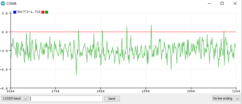

Hmm is de sample frequentie niet te laag om het 50hz signaal goed te kunnen meten
  • Plenkske
Tinusvolkel schreef op dinsdag 1 juni 2021 @ 16:44:
Ja, daar dacht ik ook aan.
Toen herinnerde ik me deze library: https://github.com/RobTillaart/ADS1X15
Ben ik nu aan het testen op hoogste snelheid en ook de I2C wireclock verhoogd.

#include "ADS1X15.h"
// choose you sensor
// ADS1013 ADS(0x48);
// ADS1014 ADS(0x48);
// ADS1015 ADS(0x48);
// ADS1113 ADS(0x48);
// ADS1114 ADS(0x48);
ADS1115 ADS(0x48);
float zeroPoint = 300;
int16_t totalVolts;
float Voltage;
float Current;
float Power;
void setup()
  Serial.begin(115200);
  Serial.println(__FILE__);
  Serial.print("ADS1X15_LIB_VERSION: ");
  Serial.println(ADS1X15_LIB_VERSION);
  ADS.begin();
  ADS.setWireClock(400000);
  ADS.setGain(2);      // 2.048 volt
  ADS.setDataRate(7);  // fast = 7
//  ADS.setMode(0);      // continuous mode
//  ADS.readADC(0);      // first read to trigger
void loop()
  MeasurePower();
  PrintSerial();
  //delay(1000);
void MeasurePower()
// totalVolts = ADS.getValue();
// float f = ADS.toVoltage(1);  // voltage factor
 totalVolts = ADS.readADC_Differential_0_1();
 Voltage = ADS.toVoltage(totalVolts+zeroPoint);
 //Converts the raw data to mV (* 0.1875), then to V (/1000)
 //Voltage =  totalVolts * f;
 Current = Voltage / 0.1;
 //Watt = U * I
 Power = 230 * Current;
void PrintSerial()
 //Serial.print(totalVolts); //print time in seconds
 // Serial.print("\t"); //space as delimiter
  Serial.print(Voltage,3);
  Serial.print("\t");
  Serial.print(Current,3);
  Serial.print("\t");
  Serial.println(Power,3);   //we do a linebreak together with the last print
(zeropoint 300 kwam ik op uit toen ik die nog op 0 had staan)
Zonder load (groen is power in watts)
Afbeeldingslocatie: https://tweakers.net/i/qBIheVPFgeqU136fcNNVaXT0wdA=/800x/filters:strip_exif()/f/image/Xmrt4XwgZVO9jeG7K2CaoqiJ.png?f=fotoalbum_large

En zo ziet een telefoonlader(60W) er dan uit:
Afbeeldingslocatie: https://tweakers.net/i/u2rcbjGjrAlcxj_DbaahiD_oZX0=/800x/filters:strip_exif()/f/image/B6R5t6aUevzaqgUZztG9FtTC.png?f=fotoalbum_large
16:58:36.364 -> 0.001 0.011 2.588

[ Voor 18% gewijzigd door Plenkske op 01-06-2021 16:59 ]
  • Plenkske
Als ik het goed begrijp is het nu zaak om de RMS uit te rekenen.
Zal dat later eens proberen.

Plenkske schreef op dinsdag 1 juni 2021 @ 16:54:
C:
24
25
26
27
28
29
30
31
32
33
34
35
36
37
38
39
40
41
42
43
44
45
46
47
48
49
50
51
52
53
54
55
56
57
58
59
60
61
62
63
64
65
66
67
68
69
70
ADS1115 ADS(0x48);
int16_t totalVolts;
float Voltage;
float Current;
float Power;
void setup()
  ADS.begin();
void loop()
  MeasurePower();
  PrintSerial();
  //delay(1000);
void MeasurePower()
 //Watt = U * I
void PrintSerial()
  Serial.print("\t");
  Serial.print("\t");
Met load waterkoker
dit ziet teminste uit als een uitlezing oOo
Tja vanalles

Plenkske schreef op dinsdag 1 juni 2021 @ 17:27:
Yep, met die berekeningen die je laatst stuurde moet je denk ik een heel eind komen

Tinusvolkel schreef op dinsdag 1 juni 2021 @ 17:38:
Ja, die berekening werkt heel aardig !
Ik kom nu op een aardig accurate current in ampere. Komt goed overeen met wat ik uitlees met de tussenstekker.
Als ik dan simpelweg volt * ampere doe voor de watts kom ik echter nog te hoog uit. Dat zal te maken hebben met die power factor. Kan ik daar nog iets mee ?
Bij de telefoonlader moet er bv. 1/3 af
Bij de waterkoker valt het mee. Daar meet ik bijna 9 A en bijna 2000W via tussenstekker, en zie hieronder de output van de code.
De vraag is dan vooral wat ik kan verwachten bij een filterpomp en warmtepomp...

Uitgecomment was de code vanmiddag, zonder rms berekening.
Resolutie hier vandaan: https://www.best-microcontroller-projects.com/ads1115.html
Zero value op basis van wat ik voorbij zag komen ingesteld. die Q ook. Ben daar eigenlijk nog niet tevreden over want dit wil nog wel eens veranderen merkte ik...
Output van telefoonlader:

  • vso
vso
tja...
Plenkske schreef op dinsdag 1 juni 2021 @ 21:08:
Heb je niet iets stabiel(ers) .. ventilator / lamp oid .. ? er zijn ook diverse librairies zag ik voor de RMS berekening(en) ..
Tja vanalles
  • Plenkske
vso schreef op dinsdag 1 juni 2021 @ 21:46:
Ah ventilator kan ik morgen wel eens proberen. Lampen heb ik alleen in led dus dat schiet niet op.
Waterkoker was overigens ook wel aardig stabiel hoor.
En de Ampere die ik er nu uit krijg klopt al aardig *O* eindelijk :)
Nu was mijn vraag dus nog of ik de omzetting naar Watts nog kan verbeteren.
  • vso
vso
tja...
Plenkske schreef op dinsdag 1 juni 2021 @ 21:53:
Voor een tijds test is de verbruiker imho minder relevant 3w of 1 v.d 3 standen van een ventilator ..
Gewoon aanzetten en weglopen .. wat je wilt zien is een constante meting toch ?
maaruh :9B u don it ..
Beetje het zelfde met de tempsensors "droog" laten draaien zolang ik geen gekke pieken zag vertelde me dat de sensor "stabiel" was het accuraat zijn tja .. dat vind ik een ander punt . (zeker iets om te doen maar minder haast imho) ben nog met tasmota aan het spelen en node-red code .
Of ik ga naar espeasy oid .. eens zoeken voor flowmeter .. en npn sensor(s) .. gelukkig kan je via tasmota een "firmware" update doen naar espeasy via hun OTA mechanisme
[ Voor 15% gewijzigd door vso op 01-06-2021 22:18 ]
Tja vanalles
  • Plenkske
Bij de telefoonlader moet er bv. ~1/3 af
@Tinusvolkel enig idee of ik nog iets met die power factor kan ?
Verder was ik aan het bekijken hoe ik het aangesloten krijg in mijn complete systeem.
Mijn idee is als volgt:
- weerstand 1 aan GND solderen
- weerstand 2 aan + (5V) solderen
- weerstanden aan andere kant aan elkaar solderen
- vanuit dat middenpunt een draad solderen, die ik dan aansluit op de A1 van de ADS
De rest van de ACS en ADS kan ik gewoon met bestaande aansluitingen zonder problemen aansluiten.
Mijn vraag is nu eigenlijk: gaan die weerstanden ook invloed hebben op andere dingen die ik aansluit op de + en GND ? Dacht het niet toch ?
  • Tinusvolkel
Plenkske schreef op woensdag 2 juni 2021 @ 14:19:
230V meten of de nuldoorgang meten, (circuit kan je denk ik wel kopiëren uit een dimmer circuit)
Als je de nuldoorgang hebt dan weet je ongeveer op welk moment je welke wisselspanning hebt.
Nope die 4k bij elkaar of 40k heeft geen impact op je 5v voeding.
  • Plenkske
Tinusvolkel schreef op woensdag 2 juni 2021 @ 14:23:

  • Plenkske
Ik heb trouwens besloten om de ACS en ADS wel aan te gaan sluiten, maar om hem alleen de current in Ampere door te laten sturen. Dan kan ik met die data eens bekijken hoe ik het goed naar Watts kan krijgen, door in Domoticz bv. wat berekeningen te doen. Ik ga die dan vergelijken met een zigbee tussenstekker die alles output: power, current, voltage en "energy" (= som in kwh).

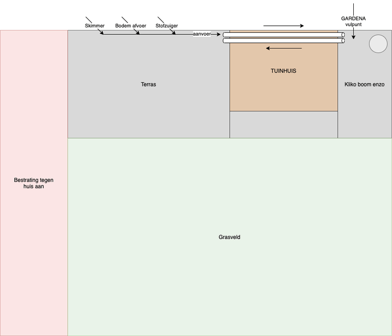

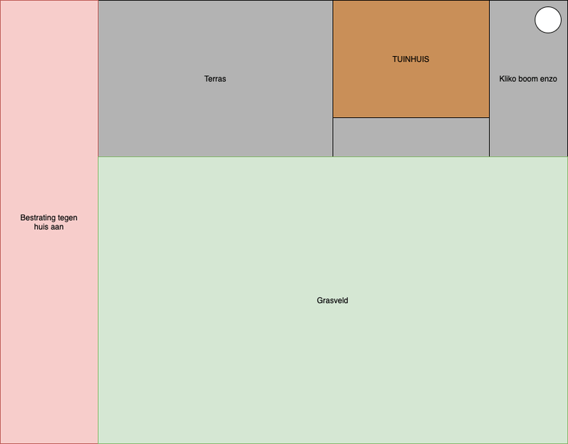

Even trouwens wat context waarom ik ineens in dit topic zit te blaten;
Momenteel heb ik een Intex van 2x3x80cm hoog; kansloos qua formaat en ik denk een kleine 3000l maar kleine kinderen dus je moet iets. Ooit komt er waarschijnlijk een 400 x 200 x 122 of groter; ik kan op mijn terras ook 503x274x122 kwijt, maar dan moeten de kinderen wel een A diploma hebben (jongste is 2 en moet nog beginnen) dus dat is lange termijn denken.
De zandfilter had ik ooit bij Cranendonck gekocht met een pomp die veel ste veel stroom verbruikte en daarnaast vrijwel 0 flow had. Toen vorig jaar de zandfilter lek was had ik al een nieuwe pomp op de zandfilter staan, namelijk een Aqua Vario Plus welke 14 m³/uur pompt en geschikt is voor zwembaden tot 56 kuub }). Uiteraard heb ik geen 14 m³/uur door mijn zandfilter gepompt (daar zat toen nog glas in) maar hij was lek en er moest daarom toch een nieuwe zandfilter komen. De nieuwe jongen is een MFV24 geworden wat helemaal matched met de pomp capaciteit en de grootte van het zwembad.
Aangezien er 120kg zand in kan lijkt het mij niet slim om dat ieder jaar opnieuw op te gaan bouwen, dus is het plan dat ik mijn 'technische' ruimte achter mijn schuur ga maken waar het uit het zicht staat + uit het spetter geweld van de kinderen.
Daarnaast heb ik nu nog als verwarming een EPDM solar mat liggen die heel de dag in de schaduw ligt en dus niet heel efficient werkt (circuit draait op een losse pomp overigens)
Afbeeldingslocatie: https://tweakers.net/i/iZMtNabkvSF7pasrU7C5qKP8nDE=/full-fit-in/4920x3264/filters:max_bytes(3145728):no_upscale():strip_icc():fill(white):strip_exif()/f/image/bbSSCt7nPA21GP9ORk71kBSs.jpg?f=user_large
Ik heb dus ook al 2 temperatuur sensoren gekocht;
Afbeeldingslocatie: https://tweakers.net/i/u9NgKfD_SG08cCmOb7PRw_tuADM=/full-fit-in/4920x3264/filters:max_bytes(3145728):no_upscale():strip_icc():fill(white):strip_exif()/f/image/kJaf6dgNAUkmIw2QS4AB08JP.jpg?f=user_large
Ik draai nu nog op chloor en zit te overwegen om een W'eau Full Inverter 7,6kW zwembad warmtepomp aan te schaffen omdat dit beest alsnog voor zwembaden tot (geadviseerd) 21m3 is, en ik nooit hierboven ga komen. Tenzij jullie enorm goede redenen zouden hebben om een model hoger aan te schaffen natuurlijk.
Omdat het idee was dat ik mijn eigen 'poolboy' wil ga maken (zo noem ik mijn zwembad computer project) dacht ik dat ik maar eens hier aan ga haken :-) Vooralsnog zou ik alleen vragen hebben hoe je de chemicalien veilig aan je zwembad zou toevoegen, d.w.z. sluit je de doseerpomp aan op een stuk PVC en laat je het zo in de pijp druppelen of laat je het puur in je zwembad druppelen (ik mag hopen het eerste); daarnaast heb ik me er vorig jaar ook ooit in gelezen dat je bijv. eerst chloor moet doen en dan dat andere spul (of net andersom) en zoiezo na de meetpennen pas, toch?
Enfin; ik heb zelf in het verleden al een aantal ESP projectjes gemaakt, heb een Zigbee netwerk, home assistant, node-red en mqtt draaien op mijn eigen home automation server en stuur bijv. mijn rolluiken aan via node-red als de zon op het huis staat en het warmer word dan 25 graden. De airco moet ook nog geautomatiseerd worden en zo zijn er nog 100-en andere home automation projecten maar de vrouw verwacht dat ik me nu op het zwembad richt.
Zo ziet mijn tuin er nu uit van boven (grofweg, om je een beeld te geven)
Afbeeldingslocatie: https://tweakers.net/i/xh3Z7TDjUNj56tl2D-LWuy0CSyo=/800x/filters:strip_exif()/f/image/vCy5fgLaaL5g7Mue0nKIYoiE.png?f=fotoalbum_large
Vanuit het tuinhuis ligt er een mantelbuis richting de meterkast, dus ik zou in theorie het tuinhuis op de fase kunnen zetten die het minste belast is qua stroom. Er is nu stroom via een grondkabel aangesloten dus de mantelbuis is 'extra' voor de toekomst; als de boom ooit weggaat en ik bijv. zonnepanelen op mijn tuinhuis leg. Ik zit vol op het zuiden dus heb maximale opbrengst dan. Boven het terras komt ooit nog een overkapping waar dan het zwembad gewoon onder komt te staan en misschien zelfs langer kan blijven staan.
Ik ben een sucker voor local control; dus het systeem moet bedienbaar zijn en ook bedienbaar zijn als het internet eruit ligt of docker plat ligt zeg maar. Ik vind dat home automation een toevoeging moet zijn, geen basis behoefte.
Genoeg details denk ik zo :)
Nu wil ik dus mijn pomp en zandfilter rechts bij de boom plaatsen, daarvoor moet een (50mm) buis door mijn tuinhuis gelegd worden wat ook niet het probleem is, maar wat wel het probleem is of waar de vraag over gaat is hoe ik het ga aansluiten met het oog op automation.
Ik wil dus graag kunnen meten:
- Buitentemperatuur (want ik kan je vertellen dat een Hue motion sensor geen accurate waarde geeft als de zon erop schijnt - en zelfs de temperatuur uit Home Assistant er vanmorgen 6 graden naast zat)
- Temperatuur dmv sensoren welke ik hierboven al getoond heb; ik denk aan zwembad aanvoer en inverter uitvoer evt?
- pH (toekomst) + Automatise sturing hiervan dmv injectie
- ORP (toekomst) + Automatise sturing hiervan dmv injectie
- Stroom meting en sturing pomp (kan dmv een zigbee plug, ik heb de pomp zelf nog niet opengemaakt om te kijken of ik hem ook met een ESP zou kunnen automatiseren) dit is eigenlijk puur om te kijken of het systeem werkt, en zou ook met een tweetal tasmota's geregeld kunnen worden.
- "Stretch goal" :p Ik zit erover te denken om bijv. 1 of 2 extra circuits dmv een kogelkraan te kunnen sturen; denk dan aan een DIY tipping bucket of een Laminar flow nozzle.
- Flow meting (wat is het nut hiervan eigenlijk?)
Voor de pH en ORP heb ik al vorig jaar onderzoek gedaan, zal de linkjes hier eens plaatsen ter lering en vermaak;
- Aanboorzadel met electrodehouder en injectie aansluiting
- Arduino pH and ORP/chlorine data logger
- Measuring pH and ORP with Arduino (helaas zijn hier de plaatjes inmiddels verdwenen, maar videotje van het project is er nog wel)
- ORP / PH / Temperature Data Logger
- Contrôle et supervision de la piscine (Google translate is your friend)
- losse unit als injector
Ik wil dus voornamelijk weten hoe ik mijn PVC NU moet leggen zonder dat ik bijv. al een warmtepomp heb maar er toch al op voorbereid wil zijn; moet ik die al bijv. uitvoeren met een bepaalde kogelkraan zodat ik hem later kan automatiseren?

Qua aanvoer richting pomp zat ik nu op zoiets te denken:
Afbeeldingslocatie: https://tweakers.net/i/gCRDVZdrOJIdJITmXzDucGyKKAA=/800x/filters:strip_exif()/f/image/Im69RGEPK6CGcERKelIfgj8W.png?f=fotoalbum_large
Onder het tuinhuis liggen slechts 2 leidingen met aan weerszijde snelkoppelingen, zodat ik alles ook gewoon los kan halen als het seizoen voorbij is.
Rechts bij de pomp komt een gardena kraantje IN de aanvoerbuis richting pomp. Hier kan ik dan een gardena slang op aankoppelen om het pijp systeem te VULLEN / op te starten. Scheelt een hoop gedoe met emmers lopen en dop van pomp losdraaien. Tip had ik ergens op een youtube filmpje gezien vond ik wel een goeie.
Links van het tuinhuis komt dan op de aanvoerbuis 3 aftakkingen die ik allemaal met kogelkranen kan finetunen;
1. Skimmer aansluiting
2. Bodemafvoer aansluiting
3. Aansluiting stofzuiger
Hierdoor heb ik geen gedoe met PVC aftakkingen dicht bij de pomp en kan ik het later nog wijzigen als er een ander zwembad komt.

Ziet er goed uit. Je PVC idee etc. is helemaal goed volgens mij.
Die flow sensor is inderdaad de goede. Dat is 2 inch dus 50mm.
Je moet alleen even kijken naar de max flow die de flow sensor aan kan, vs wat je pomp doet (of wat je als range bij de pomp gaat gebruiken).

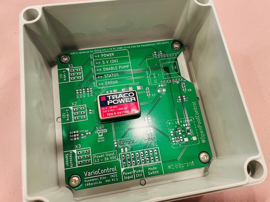

Ik heb het verkeerde PCB op mijn Aqua Vario plus momenteel, namelijk deze:
Afbeeldingslocatie: https://tweakers.net/i/kt-pFM8h_ed3vBlPCgPb7VLpmtw=/x800/filters:strip_icc():strip_exif()/f/image/CNNeOlw2P7sG0liD125jx69D.jpg?f=fotoalbum_large
... maar er zijn dus versies in omloop die wel een 0-10v ingang hebben en daarmee dus extern bestuurbaar zijn..
Afbeeldingslocatie: https://tweakers.net/i/KuXZQZ0z1hGyIhgN8vQOrbhHh_g=/full-fit-in/4920x3264/filters:max_bytes(3145728):no_upscale():strip_icc():fill(white):strip_exif()/f/image/RQK3jpldS3CfZ5grAqL0W3qX.jpg?f=user_large
Blijkt dat die persoon ook een heel project aan het opzetten is op Github :-)
bron: https://github.com/100prznt/VarioControl

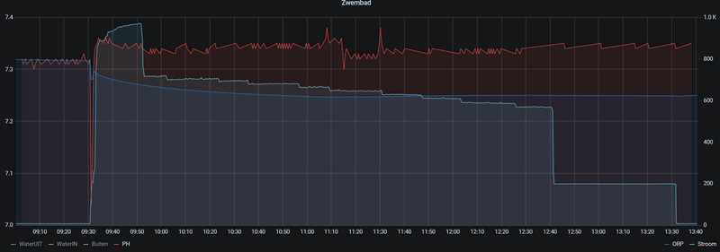

Afbeeldingslocatie: https://tweakers.net/i/PmbRLGdjmX0pdUxhPU_bnjEp9no=/800x/filters:strip_exif()/f/image/hlQv81sQnrh1UaWXCIxyFfxI.png?f=fotoalbum_large
Rood PH, Donkerblauw ORP en stroom zodat je ziet wanneer de pomp en warmtepomp aan gaan. Het zwembad is netjes 28 graden na een tijdje dus gaat de WP aftoeren en uiteindelijk helemaal uit.
Helaas zijn de grafiekjes van een maand erg vertekend doordat de pomp snachts uit staat en de orp erg omhoog gaat.
Afbeeldingslocatie: https://tweakers.net/i/g4clbh5-5eO5zKgfY-V9p5t3exk=/800x/filters:strip_exif()/f/image/doXmDWClhdTQg4K1CBK5u81Y.png?f=fotoalbum_large
Ph is wat stabieler als de pomp uit is. Op 3-juni kwam ik er achter dat er iets niet klopte met de PH, er was een slangetje van de peristaltische pomp ( 2,50 op ali) kapot gegaan. De volgende dag zakte die weer meteen.
