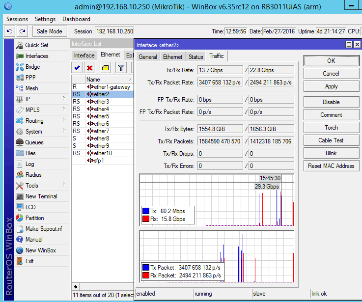

Whoops..
Sinds enkele uren valt me het volgende op,
Afbeeldingslocatie: http://tweakers.net/ext/f/v1OzN7nP4i2PZXreG6tvgoLa/full.png
Heeft iemand hier enige verklaring voor?
  • Stephanoid
  • Laatst online: 15-01 07:32
MvZeeland schreef op zaterdag 27 februari 2016 @ 15:49:
Whoops..
Misschien moet je deze screenshot en een supout file naar support@mikrotik.com sturen, ik denk dat ze dit ook wel interessant vinden :)

  • hendymen
  • Laatst online: 25-11 21:55
Stephanoid schreef op zaterdag 27 februari 2016 @ 16:57:
Gedaan, inmiddels is dit de mailwisseling voor wie het intressant vindt..
Dear Mikrotik,
Recently i've upgraded from an RB2011 to an RB3011 because i upgraded from an 100/100 to a 500/500 Mbit FTTH line. Because of the throughput. But now on the RB3011, i'm not getting any higher throughput than before with the RB2011.
My question is regarding fasttrack and PPPOE. I've noticed that the RB2011 has now support on PPPOE and fasttrack with 6.35rc12. However the RB3011 has not got this support yet.
When is this planned for the RB3011?
Thanks in advance,
Hello,
not true, RB3011 have full fastpath support so pppoe-client fastpath also works there.
Please, send supout.rif file, so we can check why your fastpath is not working.
Regards,
Janis M.
Dear Mikrotik,
I'm having this strange thing right now, this just catched my glimps.
Kind regards,
Hello,
Please, check these:
feb/22 18:36:37 interface,warning ether2 excessive or late collision, link duplex
mismatch?
feb/22 18:36:37 interface,warning ether2 excessive broadcasts/multicasts, probably a
loop
feb/22 18:38:07 interface,warning ether7 excessive broadcasts/multicasts, probably a
loop
As far as i can see interface Fastpath counters are working fine.
Last screenshot looks like result of the crash, sent new supout.rif file.
Also next RC version is available, use it.
Regards,
Janis M.
Dear Janis,
Thanks again!
Ok, i've fixed the crash. It was the Ether2 and a Rasberry PI giving issues. I've unplugged it now and installed the newest rc version but the speed hasn't increased.
Please see supout.rif attached.
Kind regards,
Hello,
as far as i can see all is in order:
ipv4-fasttrack-active: yes
ipv4-fasttrack-packets: 541525
ipv4-fasttrack-bytes: 39456066
Please, describe your testing method.
Regards,
Janis M.
Janis,
Thanks again for the fast reply!
I'm testing it by downloading regular 1gb.bin files from several ISP's here in The Netherlands via TCP HTTP.
Is there an possibility to do an /bandwidth-test with an external mikrotik server? Also i've plugged the original router which was provided by the ISP in and it's giving me full bandwidth, 500/500.
I've managed to get my hands on an RB2011 again, i'll try the RB3011 config on the RB2011 and will compare them.
Kind regards,
Update 03-03-2016 19:00
Dear Janis,
Did some testing again and didn't manage to get higher speeds than 250/300Mbit on the rb2011 with the same config. However I also didn't manage to get higher speeds on the ISP router. So i've called the ISP and they did some line-testing and didn't get any higher speeds either. So they are sending an mechanic tomorrow to have an look. I'll keep you updated!
Thanks for the effort.
Kind regards,
Ik zal de mailwisseling bij blijven werken.
[ Voor 28% gewijzigd door hendymen op 03-03-2016 19:11 ]

  • Aesculapius
  • Laatst online: 28-11 08:02
Aesculapius schreef op maandag 25 april 2016 @ 11:39:
Sinds de laatste RouterOS versie 6.35 valt het mij op dat het traffic om de 2 a 3 seconden terugvalt naar 0kb/s, op alle interfaces behalve de bridge:
Mogelijk dat dit ook al eerder zo was maar ik het toen niet gezien heb.... het ziet er in ieder geval niet heel normaal uit... weet iemand waar dit door kan komen?
Zo normaal:
en zo om de 3 sec.:
Schaamteloze bump: Niemand die dit herkent of een idee heeft?
Zeg wat je doet en doe wat je zegt, dan wordt de hele wereld een stukje leuker
  • chaoscontrol
  • Laatst online: 00:20
Aesculapius schreef op maandag 16 mei 2016 @ 15:14:
Hier geen last van. Heb je het met een schone config ook?
Inventaris - Koop mijn meuk!
  • Thralas
  • Laatst online: 00:21
Thralas
Even Occam's razor toepassen: je veroorzaakt gewoon traffic met een interval?
Je hebt neem ik aan ook al vastgesteld wat voor verkeer het is?
  • Aesculapius
Het gold voor elk verkeer dat er overheen ging, van ftp, http tot gewoon rdp verkeer. Maar zojuist zag ik dat er een routerboard firmware upgrade was dus die gedaan (3.33) en RouterOS naar 6.35.2 en waarempel loopt alles nu weer in de pas zoals verwacht.
Afbeeldingslocatie: https://arc.int32.nl/index.php/s/72Pms5cOihniHLv/download
Alleen nu nog een bandwidth issue op de WAN interface, maar daar sleutel ik eerst wel eens wat aan.
