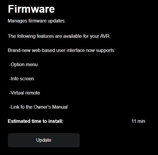

  • tdn135
tdn135 schreef op donderdag 18 december 2025 @ 21:00:
Sinds de laatste update bij mijn Denon AVR-S660H werkt de information pagina van de webinterface niet meer. Het laat een leeg “frame” zien. Het menu werkt wel gewoon. Dit op meerdere devices. Ik vermoed dat het een bug is door de laatste firmware update. Herkent iemand dit?
Deze week is bovenstaande bug opgelost met een firmware update. De releasenotes zijn nog niet bekend. Zie https://support-eu.denon....firmware-update-available

Update History
■ 2026/7/22 - 2026/8/5 (Ver.40U)
Note: To ensure the stable operation of the update server , the update will be rolled out sequentially during the period specified above.
1. Enhanced Web interface functionality.
2. Fixed an issue where the same section of content was occasionally repeated during playback on specific TuneIn stations.
3. Fixed an issue where Qobuz playback stopped mid-track when using Qobuz Connect.
4. Fixed an issue where an unknown error message appeared on the front panel or TV menu during Qobuz playback.
5. Fixed an issue where volume levels changed upon connecting the HEOS app due to unsynchronized volume levels between the main AVR unit and the HEOS app.
6. Fixed an issue where the sampling rate of playing content was not displayed correctly in the AVR Remote app.
7. Fixed an issue where Spotify could not be saved to or recalled from Quick Select.
8. Fixed an issue where pop noise occurred from the speakers when the refresh rate output from an HDMI source device changed.
9. Fixed an issue where crossover frequency settings in the 2-channel playback settings were not reflected in the Web UI.
10. Fixed an issue where crossover settings in the 2-channel playback settings were not applied correctly.
11. Fixed an issue where Qobuz Connect failed to connect, preventing playback.
12. Fixed an issue where speaker icons on the room screen were not displayed correctly when channel playback settings were set to Manual.
