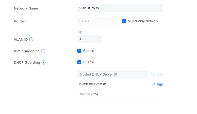

No FW rules. And a port profile for the port on which the STB is connected so your Stb gets an ip address from the dhcp pool of your vlan

bvk007 schreef op maandag 21 februari 2022 @ 13:26:
OK, so assigned a network (not profile) which was created with property data from ISP.
What about power on STB. I know maybe this sounds funny but should i run it after udm pro is fully launched?

maziboss schreef op maandag 21 februari 2022 @ 13:59:
You could always restart your STB...I do not get what your ISP has to do with devices on YOUR network. So wait until your ISP replies with answers to the questions you have.
Is this you : https://www.reddit.com/r/...ow_to_configure_vlan_for/ :?
I think the answers there are pretty clear :?
The issue is however that the UniFi Controller webGUI and/or the UDR/UDM models do not support such a config without a lot of modding of the device/hacking some kind of config together... :| :/
I think a device like one of the EdgeRouters or even the old USG with some config.JSON editing can do it a lot easier! :)

nero355 schreef op maandag 21 februari 2022 @ 17:30:
Yes.
I spoke with my ISP Provider and he told me:
- we use hybrid solution: untagged Internet and tagged vlan 505 for IPTV
- you should get IP from vlan 505 not from UDM Pro
- we cannot see stb device (when i set on UDM Pro a network with properly DHCP address on port #1).
It is frustrating that the old asus router gets overwhelmed with the settings right away. 2 mins of setup.

maziboss schreef op maandag 21 februari 2022 @ 18:21:
Yes.
This is exactly what i told you on fabians GitHub. You need a bridged config. The tv receivers are directly connected to the wan interface. I’m not sure of this can be arranged with only a UDM of you have a spare managed switch this is possible. Tmobile in the Netherlands use a compareble Solution. There are english written solutions with extra switch on the unifi community forum..
Yes.
Sounds like :
rjhilbrink schreef op maandag 21 februari 2022 @ 22:06:
Indeed! :)
In other words : Your Managed Switch does all the work instead of your Router ;)

Ik heb KPN en ik heb een UDM SE en ik krijg het niet voor elkaar om het TV gedeelte werkend te krijgen. Ik doe vast iets fout. Is er ergens een guide die stap voor stap uitlegt hoe het geheel voor deze combi werkend te krijgen?
Heb je https://github.com/fabianishere/udm-iptv hier al eens gekeken.. dan heb je het mbv een udm-Se binnen 5 minuten werkend. Wel ervanuitgaand dat de udm-Se rechtstreeks op de glasvezel zit. Heb je er nog een andere router voor hangen dan moet je helaas afwijken van de default config.
Ik heb die bekeken en ook gevolgd voor zover mogelijk was, ik kwam in die beschrijving wat opties tegen die ik niet in de software kon instellen.
Mijn UDM-SE is inderdaad rechtstreeks gekoppeld aan de NTU.
Als ik alle stappen volg dan krijg ik internet werkend zonder problemen. Ik heb een vlan (op id 4) aangemaakt voor IPTV zoals in de stappen beschreven. IGMP Snooping en Multicast routing is beschikbaar in mijn firmware (v2.3.15) en die staat ook aan. Ik heb de udm-iptv package geinstalleerd en de configuratie gedaan zoals beschreven. Incl de optie om alles te behouden na updates.
Als ik de "dpkg-reconfigure -p medium udm-iptv" gebruik dan mis ik echter een aantal opties, ik kan nergens de IPTV_WAN_RANGES, IPTV_WAN_DHCP_OPTIONS en IPTV_WAN_VLAN instellen. Ik krijg wel de IPTV_LAN_INTERFACES optie waar ik de eerder aangemaakte IPTV vlan kan selecteren.

  • Pimmetje651
  • Laatst online: 28-11 22:18
Pimmetje651 schreef op woensdag 9 maart 2022 @ 21:58:
Ik hoop dat iemand me hier verder kan helpen. We zijn sinds feb. in het bezit van een KPN glasvezel verbinding waarop we een 200/200 internetverbinding en interactieve TV hebben afgenomen.
Als hardware maken we gebruik van een EdgeRouter X, een US-16-150W, 2 stuks US-8, en 2 AC-PRO AP's. De controller software draai ik via een Windows 2019 Server VM
De Edgerouter is ingericht met de scripts vanuit het KPN forum .
Nu heb ik voor de rest binnen de Ubiquiti Unifi alleen IGMP snooping aangezet, wat volgens vele fora's toch genoeg zal moeten zijn.
Nu is het alleen zo dat bijna dagelijks de Arris TV "tuner" toch komt met de zo gehate STB-NMC-400 naar voren komt. Zoals door ook @Heijmenberg99 aangegeven is het door een keer "zappen" opgelost en gaat de TV weer verder
De configuratie naar dit Arris kastje is als volgt : KPN GPON -> EdgeRouter X -> US-16-150W -> US-8 -> Arris
Wie heeft nog tips wat ik kan verbeteren / aanpassen
Heeelp :)
Heb sinds vandaag mijn EcgeRouter X vervangen door een EdgeRouter 4, en hierin de nieuwste scripts van het KPN forum geladen https://forum.kpn.com/thu...p-v-de-experia-box-458609 en dan dus de Vlan4 versie van 10 maart zonder telefonie.
Nu is de andere hardware zoals in de vorige post en de setup ervan niet veranderd ( KPN GPON -> EdgeRouter X -> US-16-150W -> US-8 -> Arris VIP)
De beschikbare interfaces worden dan:
Afbeeldingslocatie: https://tweakers.net/i/ERYvGKBrtDH3qzFiX7X7STlgNn0=/800x/filters:strip_exif()/f/image/3QjF7ozkNk7VRAtlaFlLfDIX.png?f=fotoalbum_large
Nu moet ik dus en Vlan4 gaan aanmaken in/op de US-16 en de US-8, en heb dit op verschillende manieren gedacht te doen:
Afbeeldingslocatie: https://tweakers.net/i/c9W54pte-4bHsupqnzfPYka0Oc8=/800x/filters:strip_exif()/f/image/bAi5TwKTnR0m0ZLMBrfXdc6o.png?f=fotoalbum_large
of
Afbeeldingslocatie: https://tweakers.net/i/mf2Uh0oYgN_B3jKd-uZgtjBrBAI=/800x/filters:strip_exif()/f/image/4OiaDatDmuw5gcvmdDfkiiwx.png?f=fotoalbum_large
en dan op de US-16 de uplink poort naar de US-8 het "all" port profile geven, en dan op de US-8 zelf de poort waarop de Arris staat het "Vlan KPN tv" profiel geven.
Helaas bij beide van de bovenstaande 2 ideeen start de arris op tot 85% en geeft daarna : fout 561
De uplink port vanuit de US-16 naar de US-8 heeft het "all" profiel
Afbeeldingslocatie: https://tweakers.net/i/Htp6aFCeNEqDKU05oWq25bG5Pos=/full-fit-in/4000x4000/filters:no_upscale():fill(white):strip_exif()/f/image/xYR2DfB4HyjkSlyegvRzX979.png?f=user_large
Wat doe ik fout 8)7
[ Voor 8% gewijzigd door Pimmetje651 op 21-03-2022 22:45 . Reden: typo aangepast en uplink toegevoegd ]

  • Dutch-gabber
  • Laatst online: 28-10 21:59
Hallo,
Ik krijg mijn IPTV nog steeds niet aan het werken.
Mijn config.json ziet er als volgt uit:

    "system": {
        "offload": {
            "ipv4": {
                     "forwarding": "enable",
                     "gre": "enable",
                     "pppoe": "enable",
                     "vlan": "enable"
            "ipv6": {
                    "pppoe": "enable",
                    "vlan": "disable"
    "firewall": {
        "ipv6-name": {
            "WANv6_LOCAL" : {
                "rule": {
                    "1": {
                        "action": "accept",
                        "description": "Allow ICMPv6",
                        "log": "enable",
                        "protocol": "icmpv6"
                    "2": {
                        "action": "accept",
                        "description": "DHCPv6",
                        "destination": {
                                "port": "546"
                        "protocol": "udp",
                        "source": {
                                "port": "547"
            "WANv6_IN" : {
                "rule": {
                    "1": {
                            "action": "accept",
                            "log": "enable",
    "interfaces": {
        "ethernet": {
            "eth2": {
                "dhcp-options": {
                    "default-route": "no-update",
                    "default-route-distance": "1",
                    "name-server": "no-update"
                "description": "WAN",
                "vif": {
                    "4": {
                        "address": [
                            "dhcp"
                        "description": "IPTV",
                        "dhcp-options": {
                            "client-option": [
                                "send vendor-class-identifier &quot;IPTV_RG&quot;;",
                                "request subnet-mask, routers, rfc3442-classless-static-routes;"
                            "default-route-distance": "210",
                        "ip": {
                            "source-validation": "loose"
                        "mtu": "1500"
                    "6": {
                        "firewall": {
                            "in": {
                                "ipv6-name": "WANv6_IN",
                                "name": "WAN_IN"
                            "local": {
                                "ipv6-name": "WANv6_LOCAL",
                                "name": "WAN_LOCAL"
                            "out": {
                                "ipv6-name": "WANv6_OUT",
                                "name": "WAN_OUT"
                        "pppoe": {
                            "2": {
                                "dhcpv6-pd": {
                                    "no-dns": "''",
                                    "pd": {
                                        "0": {
                                            "interface": {
                                                "eth0": {
                                                    "host-address": "::1",
                                                    "prefix-id": ":1",
                                                    "service": "slaac"
                                            "prefix-length": "/48"
                                    "rapid-commit": "disable"
                                "firewall": {
                                    "in": {
                                        "name": "WAN_IN"
                                    "local": {
                                        "name": "WAN_LOCAL"
                                    "out": {
                                        "name": "WAN_OUT"
                                "ipv6": {
                                    "address": {
                                        "autoconf": "''"
                                    "dup-addr-detect-transmits": "1",
