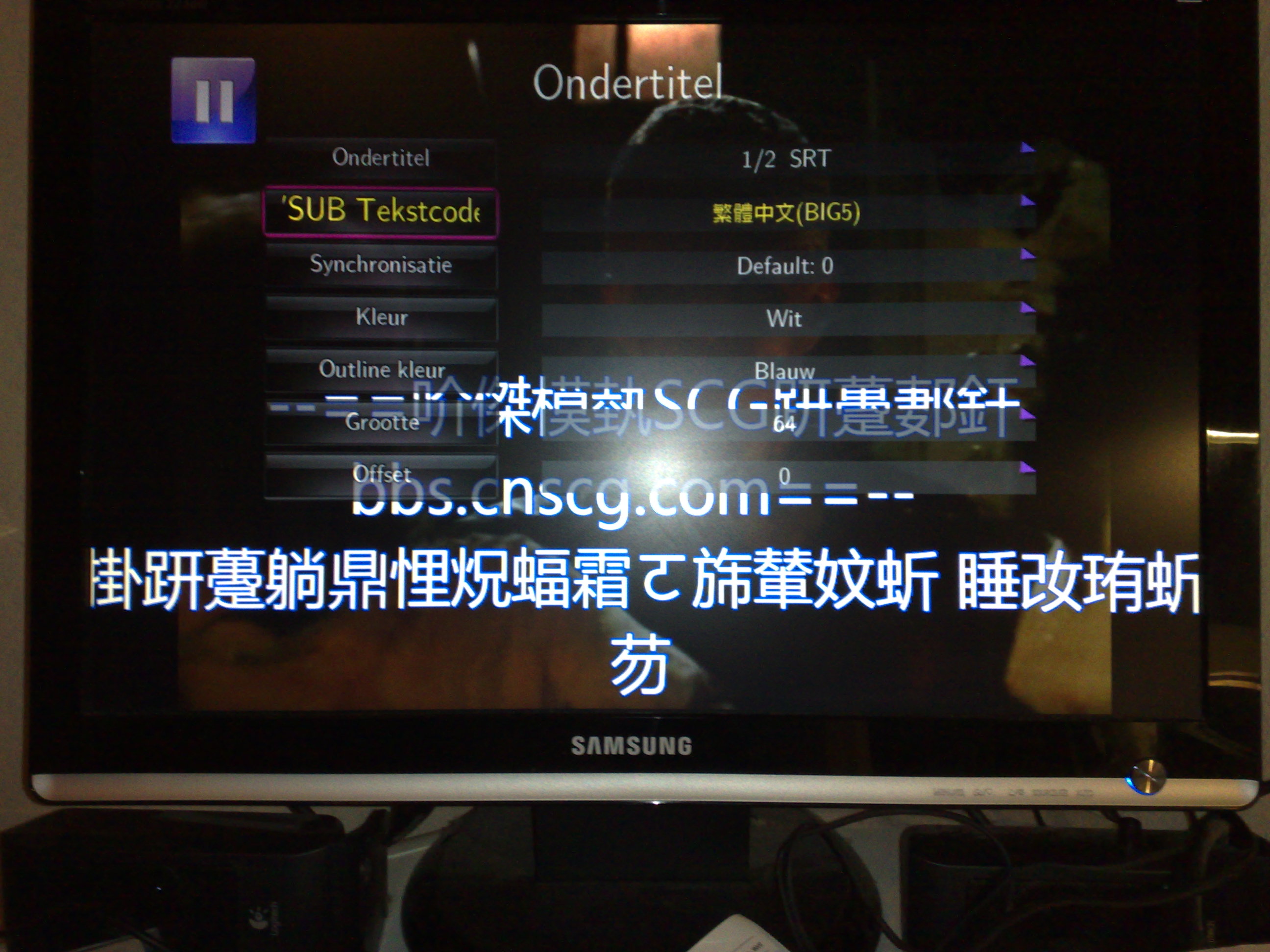

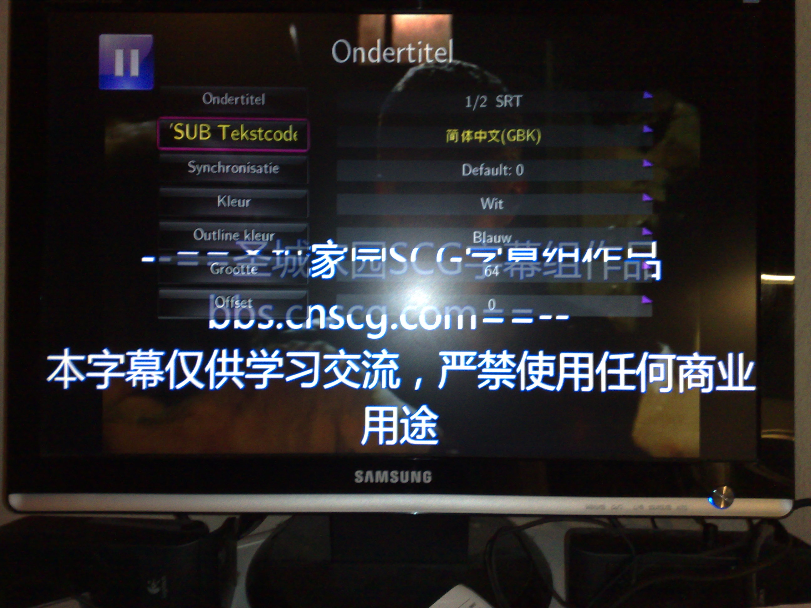

I've taken the CHS sub and put it under another movie. I can select several encoding options, Big5 and GBK looking the most logical. I took two screenshots, please see if this suits your needs.
http://downloads.eminent-online.com/7080-big5.jpg
http://downloads.eminent-online.com/7080-gbk.jpg
Again, this is with the CHS subtitle, that i don't know if it contains big5 or traditional encoding. Note, the subs are very big, i did that on purpose..
Thanks for the quick response!
CHS means Chinese simplified
ChT means Chinese traditional
big5 is for tradtional and Gbk is for simplified.
I really hope it's working.
BTW, i can't open your links.
