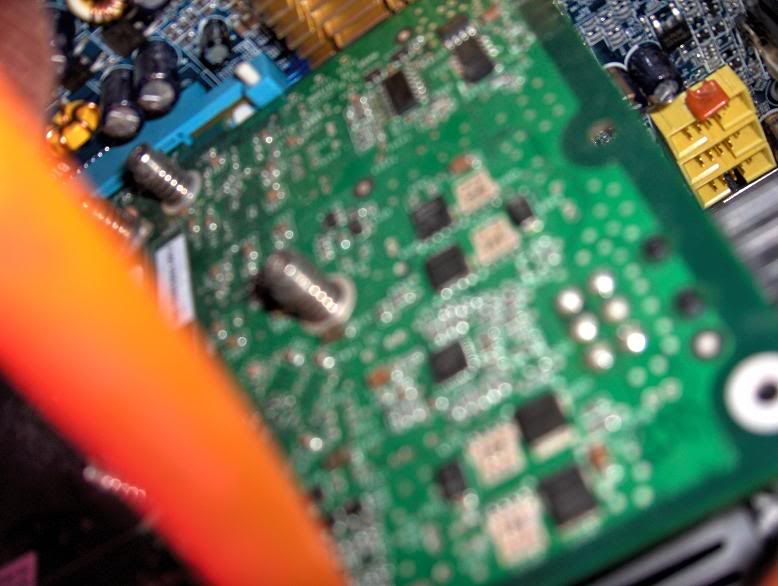

HardOCP heeft een artikel geplaatst over de fabrieksovergeklokte GeForce 7900s waar veel problemen mee kunnen ontstaan genaamd:
GeForce Inferno - Burn Baby Burn!
There are some “bad” 7900 video cards out there right now if you are going to shop for the overclocked variety. Again, it seems to me BFGTech is catching less flack than EVGA and XFX, but that is not a scientific observation. Keep in mind that BFGTech does not overclock their cards as high as EVGA or XFX. If I were buying an overclocked 7900 card right now, I would be leaning towards BFGTech or EVGA simply because they have a much better reputation when it comes to warranty, support, and service.
If you have a card to RMA, return it to the card builder, not the retailer. Given the awareness level of this problem at this time I would suggest that you have a much better chance of getting a solid 7900 directly from the card builder.
Lastly, I would not let this scare me away from buying an overclocked GeForce 7900 series video card as all the players are very aware something is going on with the cards and trying their best to make sure the problem is solved. Then again, there does seem to be certain level of risk with buying an overclocked card so a non-overclocked 7900 from a reputable builder might be a smart option. Just remember that when you are buying a video card that you are paying for service, support, and warranty as well as the hardware.
http://enthusiast.hardocp...TA2OSwxLCxoZW50aHVzaWFzdA
Technical PR Officer @ MSI Europe. My thoughts and opinions may not reflect the ones of my employer.
  • Demon_Eyez
  • Laatst online: 01-11 02:22
Ik heb het gister zitten lezen. Word je niet gelukkig van als je zo'n kaart te pakken hebt.Interessant om te lezen hoe de diverse fabrikanten omgaan met het hele RMA proces.
Ik heb zelf een XFX UCE, da's een zwarte UDE versie (520/1500) maar dan met ViVo op zwart PCB en vooralsnog geen problemen. De meeste kaarten komen uit China, gefabriceerd door Flextronics. Volgens mij komt mijn kaart nu net niet daar vandaan (volgens het artikel komen de XFX ViVo kaarten ergens anders vandaan, dus wie weet heb je met een zwarte UCE net geluk).
Uit voorzorg alle warme chips alvast voorzien van heatsinks, het schijnt een oplossing te kunnen zijn voor kaarten die artifacts vertonen( gelezen op andere fora).
Volgens berichten op het eVGA forum, komt eVGA met een revisie uit waar de stroomvoorziening anders geregeld is.
.... - in case you haven't noticed yet, eVGA has put out a new PCB/hardware revision on the "slightly modified" cards..Read: put (I believe) 13 new resistors in the general area where people do the paint mods, and vGPU gopne up to 1.45v @ 3d (at least for CO SC cards maybe others though) <-- check the 7900gt editorial thread @ http://www.hardforum.com/...ad.php?t=1059136&page=4.. Perhaps other mods that haven't been seen yet, I'm not sure.

As you can see there seems to be some added components in what I call the 'voltmod' area, and there are subtle differences elsewhere on the card.
The card has a sticker on the backside that says it has BIOS version 5.71.22.14.49 but in fact it has 5.71.22.14.45. (according to the nVidia control panel anyway)
eVGA said in an earlier email that they would be sending out 'slightly modified' and tested replacement cards so this looks like the end result.
Now as to wether they are really 7900GT CO SC cards that have been modified after the fact or not? Who knows. They look strikingly like the KO version of eVGA's 7900GT and I have heard from a few people that the KO versions of the 7900GT actually have these additional components in the voltmod area. So it may be that eVGA sent us all rebadged 7900GT KO SuperClocked cards. I have absolutely no complaints for sure, I'm just happy to have a (hopefully) working card.

In een ander forum, ik dacht op Xtreme , is er een user die post dat hij nagenoeg geen artifacts meer heeft na het gebruiken van de nieuwe 91.xx drivers tov de 8x.xx drivers.
Die infrarood foto's die een user van ons eigen GoT heeft gepost gaan ook de heel wereld over, ik heb die foto's al in 8 verschillende fora zien opduiken.
Voor mensen die meer willen lezen over de problemen of een (tijdelijke) oplossing zoeken:

Demon_Eyez schreef op dinsdag 30 mei 2006 @ 10:35:
Knip.....
Interesant stukje. Maar goed dat ik dus al wat heatsinks op die chips heb gedrukt.
Die worden chips erg warm ik raakte hem aan met me vinger en dat ding stond zowat te koken. Ik zou dus iedereen aanraden - al is het maar uit voorzorg - deze chips te koelen met een heatsinkje.
en zorgen dat je een goede airflow erover hebt zodat ze ook onder de gestelde temperatuur blijven van onder de 70 graden ipv van de 80 graden wat ze kunnen worden!

Inderdaad, kijk even 'n paar pagina's terug naar mijn active cooled heatsink (van 'n kapot asus p4p800 se mobo gesloopt.. NB heatsink).
Ik ga m'n 7900GT maar voltmodden, de kaart kan nu niet hoger komen dan 595 / 1850 ofzo, best wel balen want op deze clockspeeds is m'n kaart zo stabiel als maar zijn kan .. :/
btw 'n 3dmark06 score van 6355 met cpu op stock en ram op CPU/14 ongeveer ..
maar goed, ik heb trouwens 'n XFX UDE dacht ik, en hier kun je dus ook problemen mee krijgen .. :/ jammer genoeg (maar je kunt ze ook retever en stabiel overclocken).
Ik ga de voltmod es uitvogelen ;)

Het is volgens mij ook echt gewoon 'n design fout op het referentiemodel kaart. Die chippies op de achterkant hebben gewoon boven gemiddeld veel koeling nodig... 'n echte tweaker hangt er gewoon 'n heatsinkje op + 'n optionele extra fan .. :P (zoals ik gedaan heb)
Clocked nou als de tering, en daar haal ik ook m'n vertrouwen in de 7 serie uit. Deze kaarten komen ver zolang je er genoeg koeling op hangt.. maar goed, een k*tervaring met 'n merk is genoeg om al je vertrouwen erin te verliezen dat weet ik zelf ook ;)
Wat je erover leest rappie, heeft betrekking op de eerste lading overgeclockte kaarten. Later zijn er ook nog problemen met het referentie model ontdekt. Dit was alleen de eerste lading GTX-en. Als je je kaart RMA doet en erbij vraagt of ze een kaart van de 2 lading GTX-en aan je willen sturen heb je nooit meet ergens last van. En club3d, tja, volgens mij gebruikt tie niet de allerbeste componenten die er zijn om de prijs wat te drukken.

Vandaag DeepFreeze gebenchd en ja hoor.... artifacts! :'( :r :r
Het komt waarchijnklijk door het ram.
Artifacts op 520/1550!
Geen artifacts op 520/1500
Geen artifacts op 690/1500
Ik zit er serieus over te denken om een X1900 XT te nemen zodra de artifacts ook bij 520/1500 optreden.

Er zitten al heatsinks op de warme chips, ook getest met de 84.xx en met de 91.xx beta drivers maar geen verschil, toch artifacts :'(
Mijn 7900GT geeft ook artifact bij een hogere memspeed. Alles boven de 700 MHz (of 1400 als je graag alles keer twee doet) geeft artifacts. Maar goed, zoals je weet boeit de geheugensnelheid toch nauwelijk dus ik kan er prima mee leven :).
Maar waarom wil je nu eigenlijk een andere videokaart kopen? De x1900xt is een stuk duurder en het verkopen van je 7900gt zal je ook verlies geven. Samen zal dit volgens mij nooit de extra prestatiewinst rechtvaardigen die je hiermee koopt.

Ik heb eventjes een vraagje, zou iemand een duidelijke foto van de voon cq. achterkant van de 7900GT(x) kunnen maken, zodat ik duidelijk kan zien waar die mosfets zitten ?
Daarnaast zou ik op die foto graag ook de typenummers van de betrokken onderdelen kunnen onderscheiden.
Ik heb namelijk een 7800GS GS+ (een 7900GT(x) in AGP vermomming), waarop een cusom koeler zit. Ik heb het vermoden dat er hier en daar wat onderdelen op een andere plaats zitten. Met behulp van die foto kan ik dan gericht op zoek naar de probleemgebieden op mijn (en de andere 7800GS GS+) kaarten.
Overigens staat er een fan gericht op mijn graka, die lucht in de lengte-richting lucht langs de kaart blaast (zowel boven,- als onderkant). Dus een extra koeler aanbrengen zou bij mij redelijk veel nu kunnen hebben .... maar dan moet ik wel de juiste onderdelen vinden natuurlijk ;)

Bedoel je nu de MosFet of de voltage regulator. Van de laatste is het inmiddels bekent dat er een fail safe device zou zijn inbouwd, wanneer dat ding te heet wordt schakelt die de boel uit om schade te voorkomen. Kan me voorstellen dat als dat ding wordt uitgeschakeld je kaart inderdaad gaat artifacten/onstabiel wordt. Maar de specs zeggen van de voltage regulator dat deze maximaal 160 graden mag worden.
Wat betreft de MosFets, op Xtreme hebben ze een mod voor de switching frequency, de zogenaamde k-mod. Die MosFets kunnen schakelen tot een bepaalde frequentie, laat ik even voor gemak 1500MHz zeggen. Als je ram op 1800Mhz draait zit je daarboven, wat betref de benodigde stroom die gelverd moet worden . Door de mod uit te voeren, verhoog je de switching frequency, die vervolgens voor meer juice zorgt. Volgens de berichten zorgt deze mod voor meer stabiliteit. Wel worden de MosFets warmer, dus je moet ze voorzien van een heatsink.
To make a long story short, it was not the overvoltage protection giving me problems, neither was it the overcurrent protection. It turned out to be that with the preset switching frequency, the convertor could not supply enough energy
One chip is the voltage regulator for the memory voltage and the other one is a Mosfet connected to this regulator.
Together with a third Mosfet they form a "switching regulator" to make 2Volt out of 12Volt with a relatively high conversion efficienty.
So the Vgpu modding you have done has no impact on the heat development of these components, but of course the memory overclocking to 900 has. Going from 650 to 900 let the current increase accordingly.
A heatsink is very good, and 60-70 degrees seems O.K..
Lijkt er dus op dat de voltage regulator gewoon stuk gaat doordat die niet de benodigde stroom kan leveren die het geheugen vraagt. Dat ding moet dus continu op vol vermogen draaien, denk dat 'ie dan erg snel slijt en stuk gaat.

Twix schreef op vrijdag 09 juni 2006 @ 10:22:
Dat het aan de kaarten bakkers ligt is misschien wel waar, maar waarom geeft de ene kaart wel problemen en de andere weer niet? Het geheugen is misschien niet het probleem maar de layout.
Ik heb bijvoorbeeld nog niets gehoord van een Sparkle of Galaxy?
Ik meende dat net iemand iets zij dat de probs door de mosfets komen op de achterkand van de kaart.....
nou ik heb is even aandachtig zitten kijken maar bij mijn Galaxy zitten er tog echt geen mosfets op de achterkand van de kaart :?
ook heb ik gezien dat de PCB van Galaxy er heel anders uit ziet dan bijv. XFX [zover ik heb kunnen zien] :X

Nano2009 schreef op vrijdag 09 juni 2006 @ 19:28:
Foto misschien :). Het gaat vooral op de chippies rechtsonder aan.
Post anders eens een paar pics :) Dus achter geen MosFets, dan zitten ze zeker aan de voorkant.:)

@Nano: gaarne wat foto`s posten van jouw kaartje? ben daar wel ff benieuwd naar.

  • Nano2009
Hier zijn dan was foto`s :)
http://i59.photobucket.co...NaNo_photo/tweakers/2.jpg
http://i59.photobucket.co...NaNo_photo/tweakers/1.jpg
btw
op een of andere manier wil mijn 7900 GT steets maar niet goed op de foto :P
zal het vanavond nog wel een keer proberen ;)

Nano2009 schreef op zaterdag 10 juni 2006 @ 17:33:
btw
hehe zet je camera op macro als je van zo dicht bij 'n foto wil :P (of gebruik je je telefoon ...)
