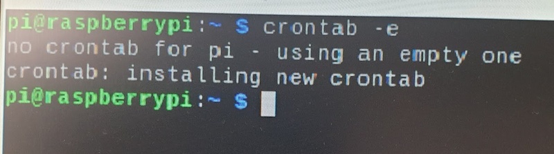

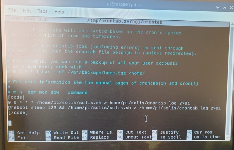

@ZuinigeRijder OK I found all went well with 4 files into solis directory at /home/pi/solis.
Now to write the crontab lines.
The changed wireless keyboard I used will not function in command mode, so I have to change keyboards again.
I type crontab -e
That gets me #green comments, I scroll down and using copy and paste I copy the 2 lines
0 0 * * * ~/solis/solis.sh >> ~/solis/crontab.log 2>&1 then enter key
then
@reboot sleep 123 && ~/solis/solis.sh >> ~/solis/crontab.log 2>&1 then enter key
Afbeeldingslocatie: https://tweakers.net/i/o28UlMg9vW6nBJfNZMS7c11dp_Q=/800x/filters:strip_icc():strip_exif()/f/image/h5ZKccV6G2n4fMPssUW80fIh.jpg?f=fotoalbum_large
I googled and found ctrl+c exits without changes
Also ctrl+k+x saves changes and exits
now I have many options and it tells me what it will save the lines as but I have no idea what to do other than save and exit.
I didn't get any of this happening yesterday after entering the crontab stuff so maybe it just didn't work at all yesterday.
Now it says, no crontab for pi - using an empty one.
Installing new crontab.

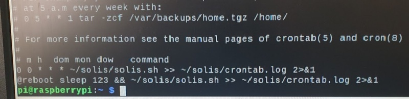

Afbeeldingslocatie: https://tweakers.net/i/dT8ntM2omSRVzVj4eAwLRgaG48I=/800x/filters:strip_icc():strip_exif()/f/image/MQKhFm9K9bxFvz0ZAuOlA69y.jpg?f=fotoalbum_large

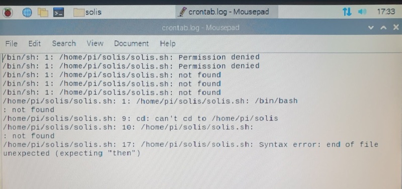

So after that I rebooted and I now have a crontab.log which says
/bin/sh: 1: /home/pi/solis/solis.sh: permission denied
The crontab command seems to be in place though as I used crontab -l to list the following.
Afbeeldingslocatie: https://tweakers.net/i/lMJSmiOcuYxJlKqwkPw6yLF3alY=/800x/filters:strip_icc():strip_exif()/f/image/Y8XoobkuJD7t1kpsiYWUBMcv.jpg?f=fotoalbum_large

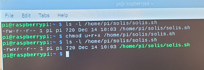

@oldman2uk You can list the crontab with command:
crontab -l
Looks like you did not make solis.sh executable. Did you do the command:
What are the permissions of solis/sh?
ls -l /home/pi/solis/solis.sh
These are mine permissions:
-rwxr-xr-x 1 rick rick   840 Aug 19  2022 solis.sh
chmod +x /home/pi/solis/solis.sh
But you also need read permission, so maybe that is the problem. This command will set this:
chmod u+r+x /home/pi/solis/solis.sh
[ Voor 17% gewijzigd door ZuinigeRijder op 14-12-2024 14:56 ]

@ZuinigeRijder
Here are my permissions before and after.
I have rebooted.

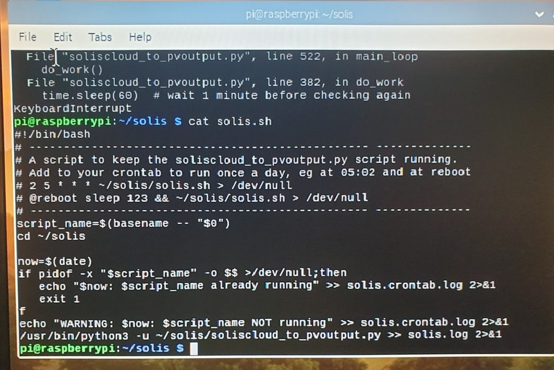

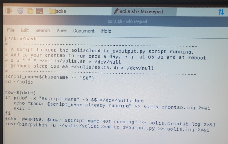

I now have a crontab.log which says /bin/sh: 1: /home/pi/solis/solis.sh: not found
Here also is my solis.sh file
Afbeeldingslocatie: https://tweakers.net/i/luH-RSFFXwRwfdSf6EkVHUxlcBs=/800x/filters:strip_icc():strip_exif()/f/image/taqv2dDuCKjqKbUfakUvIhZJ.jpg?f=fotoalbum_large
Afbeeldingslocatie: https://tweakers.net/i/kxNqPt2ZDDGP3NRK2SuJ1PVGw8I=/800x/filters:strip_icc():strip_exif()/f/image/n4hka7AykHI2Iz0blIoDUA3m.jpg?f=fotoalbum_large
  • ZuinigeRijder
@oldman2uk I think you need to set execute permission to all users, so:
chmod +r+x /home/pi/solis/solis.sh

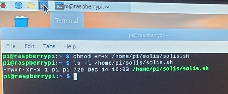

I did this chmod +r+x /home/pi/solis/solis.sh
result in picture. I rebooted and crontab.log is still saying /home/pi/solis/solis.sh: not found (2nd entry)
Thanks once more.
Afbeeldingslocatie: https://tweakers.net/i/Iwt13HBoxbwO5jqRTlPWkb6td-s=/800x/filters:strip_icc():strip_exif()/f/image/m7VNsTAMjz9mPeuFcUkXV3u3.jpg?f=fotoalbum_large

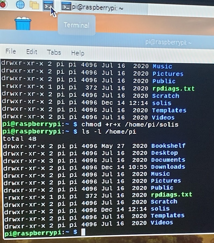

  • ZuinigeRijder
@oldman2uk I think the problem is the permissions of the solis directory above.
ls -l /home/pi
ls -l /home/pi
  • oldman2uk
  • Registratie: December 2024
  • Laatst online: 19-12-2025
@ZuinigeRijder
result in picture. I rebooted after and crontab.log is still saying /home/pi/solis/solis.sh: not found (3rd entry)
Afbeeldingslocatie: https://tweakers.net/i/te1SdYe7M-x_d4Wu1tyVD6hAV00=/x800/filters:strip_icc():strip_exif()/f/image/oGRZHUF3t15IBfhlDBba4q17.jpg?f=fotoalbum_large

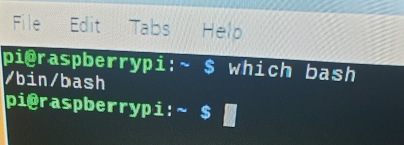

@oldman2uk something unexpected. On your OS bash is located elsewhere. What is the result of this command?
which bash
That returned full path needs to be in the first line in solis.sh
[ Voor 3% gewijzigd door ZuinigeRijder op 14-12-2024 17:50 ]

@ZuinigeRijder
which bash gave this photo.
Afbeeldingslocatie: https://tweakers.net/i/t1kXRRlDbXcOoLZr3w8bOMSYREs=/800x/filters:strip_icc():strip_exif()/f/image/q0t3JrC2tDxYeTqqm3TI9jY2.jpg?f=fotoalbum_large

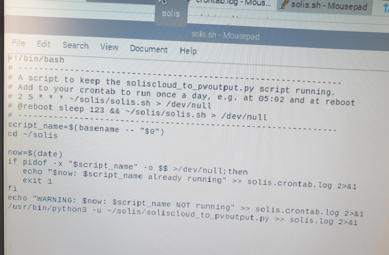

The 2nd photo is how my solis.sh looked.
Afbeeldingslocatie: https://tweakers.net/i/ZAWl15mcACv3Eb1_Yn1xKYAdNMw=/800x/filters:strip_icc():strip_exif()/f/image/1s2v5hg0XBXQ92fZaBGnCbPS.jpg?f=fotoalbum_large
I have edited the file to remove the #! from the first line.
Now on reboot I get this in crontab.log.
Afbeeldingslocatie: https://tweakers.net/i/0IjGn1-ei3vBmWgoqHMML8-FVTA=/800x/filters:strip_icc():strip_exif()/f/image/kHkOiwt4hPDkA0474s2WbUo5.jpg?f=fotoalbum_large
  • ZuinigeRijder
@oldman2uk No, the #! needs to be in front. I do not have a clue now, so still it is a Raspberry Pi problem, so probably ask for help in rhe other forum I mentioned once.

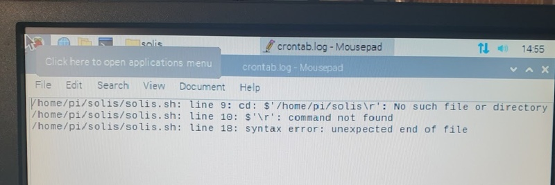

@oldman2uk And another possible problem, your script solis.sh has Windows line endings, not Unix endings.
You can fix this with the command:
dos2unix /home/pi/solis/solis.sh
My guess is that this is the real problem. Did you edit solis.sh on Windows?
[ Voor 16% gewijzigd door ZuinigeRijder op 14-12-2024 20:51 ]

As I didn't have a keyboard that would produce the right characters I got round this by copy and paste the 4 needed files from github into a folder on a memory stick called solis.
I then used the memory stick on a hub in the Pi to move the files and folder to home/Pi
I don't see any visible difference between the raw guthub file and one now in the Pi, but I take your word that they are not the same and I may have edited it in windows yes but I really don't remember now.
Should I use that dos2unix line on all four files I got from github (with the end part changed of course) ? in case I have contaminated them too with windows line ends, whatever they look like! Edit I have researched and now understand more about LF & CR's
I will delay the crontab adjustment until I have decontaminated ;) my file and rebooted to test.
I will be tomorrow now, but again I thank you for the extra mile.

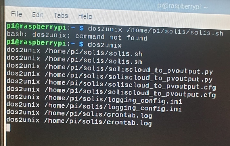

That started badly, bash: dos2unix: command not found.
I used add & remove software to find and install dos2unix. At least the command line didn't complain when I typed dos2unix.
I then used it on all the files in solis & rebooted 3 times in all.
The result is consistent, crontab.log says....not found.

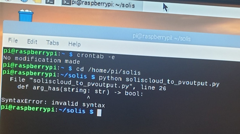

Afbeeldingslocatie: https://tweakers.net/i/AvP0s6PELAnTfnXoMuI5YU5zaoA=/800x/filters:strip_icc():strip_exif()/f/image/WHRrlH2U6N7pyvm2xtL52e9X.jpg?f=fotoalbum_large
Afbeeldingslocatie: https://tweakers.net/i/AY3Y4U8TWIWoarxlDlvSh_fKWkM=/800x/filters:strip_icc():strip_exif()/f/image/jyxYVxTP8d7cLKEOxSKqh7WN.jpg?f=fotoalbum_large
I've yet to try typing in the 2 lines into crontab. I'm not sure I remember how right now. Do I type one line then hit enter, then type the second line?
What happens to the other command we entered previously? does it need removing somehow?
In command line if I enter crontab -e that gives me the same 2 lines as your full path above ^ but without the ~ before the /
So do I attempt to edit the 2 lines there already to remove ~ or delete the lines (if thats possible) I didnt yet try.
Or will 2 new lines auto remove the existing? I have a row of edit choices at screen base.
[ Voor 28% gewijzigd door oldman2uk op 15-12-2024 10:47 ]
  • ZuinigeRijder
@oldman2uk With crontab -e existing entries keep there, unless you delete them in the editor. So you can change them or delete the lines. And yes, each command needs on a separate line, so enter after a command.
Note that you can also already try if soliscloud_to_pvoutput.py is working, without using crontab.

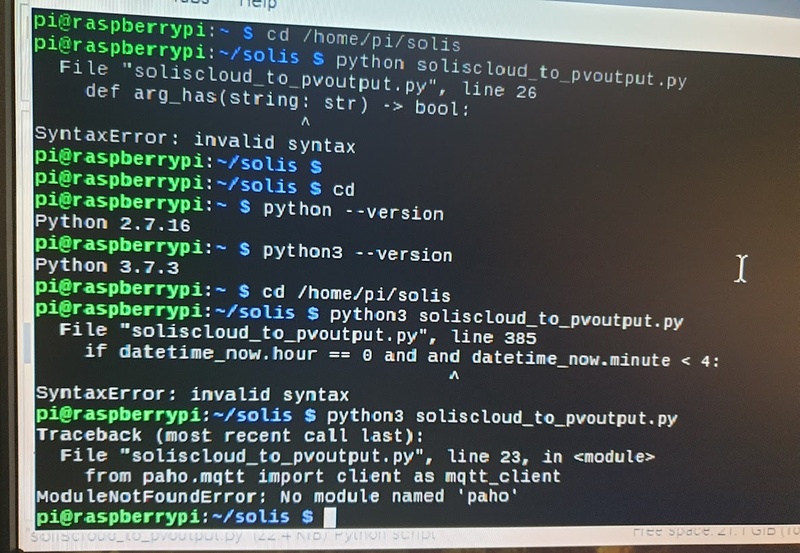

@ZuinigeRijder I will go back to crontab and edit as needed, I think I have the way to do that now thanks.

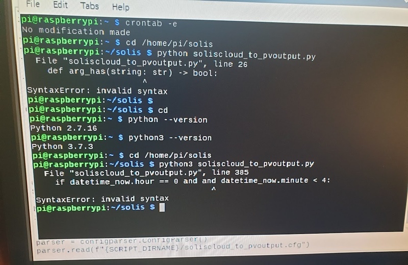

I did try to run python soliscloud_to_pvoutput.pv and got this.
Afbeeldingslocatie: https://tweakers.net/i/iNIOGrOEWfCQiEpjMt9qEmjjmNI=/800x/filters:strip_icc():strip_exif()/f/image/QXtnX7hpGqIdCOy0zj2OgTE6.jpg?f=fotoalbum_large
  • ZuinigeRijder
@oldman2uk Maybe you have an old version of python, you need at least python 3.9 or higher. Which version gives:
python --version
It is also possible that python3 is installed and python is the default 2.x version:
python3 --version
[ Voor 29% gewijzigd door ZuinigeRijder op 15-12-2024 11:21 ]

@ZuinigeRijder I have version 2.7.16
This is Pi os from may 2020 so thats why python is too old.
Am I able to upgrade this OS python or is that not possible?
  • ZuinigeRijder
@oldman2uk I edited my previous comment, which version gives python3 --version?
  • oldman2uk
@ZuinigeRijder Python version 3.7.3 is inside already.
  • ZuinigeRijder
@oldman2uk Ok, it is too old, it needs at least 3.9 I think.
However, first check if 3.7.3 is also running, without the need of installing a newer version of python.
cd /home/pi/solis
python3 soliscloud_to_pvoutput.py
If it is working, than you do not need to upgrade, but prepend the calls to soliscloud_to_pvoutput.py with python3. Otherwise you can upgrade to python 3.9.2 or later. Instructions here. Version 3.10.2 as specified in the example is also fine.
[ Voor 5% gewijzigd door ZuinigeRijder op 15-12-2024 11:35 ]
  • oldman2uk
@ZuinigeRijder error line 385
Afbeeldingslocatie: https://tweakers.net/i/ombdY_ycFG2EwttlWt9FGyHkLrc=/800x/filters:strip_icc():strip_exif()/f/image/96cttA4eb5NZyYoRohwe7dfg.jpg?f=fotoalbum_large
  • ZuinigeRijder
@oldman2uk There is an error in the line: "and and" should be one "and". I corrected my post where I did copy/paste it wrongly.
Good news is that it looks like your python3 version seems to work.

  • oldman2uk
  • ZuinigeRijder

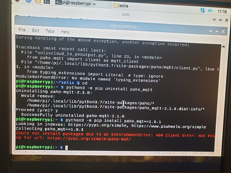

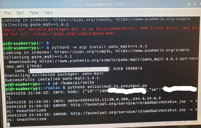

@oldman2uk Yeah, you need to install paho_mqtt. Probably something like:
python3 -m pip install paho_mqtt
  • oldman2uk

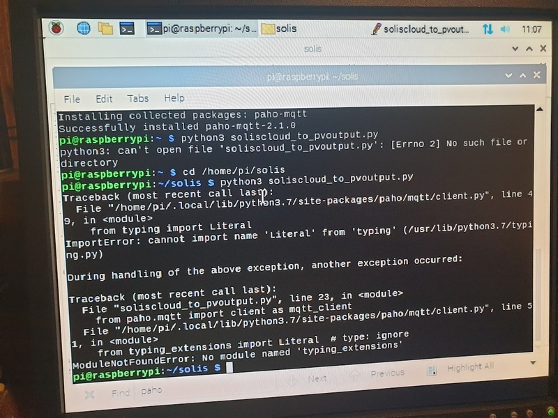

  • ZuinigeRijder
@oldman2uk Ah, the newer version of paho_mqtt is not compatible with python3. So you need to have an older version of paho_mqtt.
python3 -m pip uninstall paho_mqtt
python3 -m pip install paho_mqt==1.6.1
  • oldman2uk
  • ZuinigeRijder
@oldman2uk I made a typo, missing a t, should be:
python3 -m pip install paho_mqtt==1.6.1
  • oldman2uk
@ZuinigeRijder that fixed it so its sending data but maybe an error on pvoutput? Ive blanked out my pv id and serial in this picture.
Afbeeldingslocatie: https://tweakers.net/i/nmSmNuhLrh7uV0c6CeSRBsYnTaM=/800x/filters:strip_icc():strip_exif()/f/image/PlWIzcRCvHp7leTJAUQpGRTU.jpg?f=fotoalbum_large
  • ZuinigeRijder
@oldman2uk Looks like your pvoutput_api_key and/or pvoutput_system_id is not correct in soliscloud_to_pvoutput.cfg. Did you configure/enable pvoutput.org (Settings -> API Access enabled)?
  • oldman2uk
@ZuinigeRijder Sorry for the delay, I was checking pvoutput. I made an error in the ID. Corrected now and running but not long enough yet to see if its collecting data ;)
https://pvoutput.org/list.jsp?userid=124179
  • ZuinigeRijder

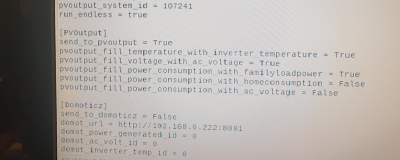

@oldman2uk Great. Now the crontab getting to work. Note that you need to edit solis.sh to change python intro python3.
I assume you also want to see battery information in the last column. Did you configure that?
pvoutput_fill_power_consumption_with_familyloadpower = False
pvoutput_fill_power_consumption_with_homeconsumption = False

@ZuinigeRijder crontab.log reports
  • oldman2uk
@ZuinigeRijder
here is solis.sh
Afbeeldingslocatie: https://tweakers.net/i/IZXIJ1m7f7qIyHQVm2yl55b7qfI=/800x/filters:strip_icc():strip_exif()/f/image/8nfoJ2fSteNMdFKuOzhcCPSL.jpg?f=fotoalbum_large
  • ZuinigeRijder
@oldman2uk Yeah, maybe you are looking at the error message the first time it was written. Because the command:
0 0 * * * /home/pi/solis/solis.sh >> /home/pi/solis/crontab.log 2>&1
@reboot sleep 123 && /home/pi/solis/solis.sh >> /home/pi/solis/crontab.log 2>&1
">>" in these 2 commands mean that messages are appended to /home/pi/solis/crontab.log.
If you change it into one > it will rewrite the log file:
0 0 * * * /home/pi/solis/solis.sh > /home/pi/solis/crontab.log 2>&1
@reboot sleep 123 && /home/pi/solis/solis.sh > /home/pi/solis/crontab.log 2>&1
So maybe it is now just running Ok. You can look into solis.log and (and remove prior the solis.log with command "rm solis.log").
[ Voor 9% gewijzigd door ZuinigeRijder op 15-12-2024 13:35 ]
  • oldman2uk
@ZuinigeRijder I edited the crontab but when I try to save it says I have errors?
Afbeeldingslocatie: https://tweakers.net/i/gF3gINqF8NGwyjfzQm2x56vTPfA=/800x/filters:strip_icc():strip_exif()/f/image/Dn8XrgC4qyAmNEJliYP41VJp.jpg?f=fotoalbum_large
  • oldman2uk
Hey, you just removed 2 lines ;)
  • oldman2uk
@ZuinigeRijder
Just 1 entry in the new crontab log /bin/sh: 1: /home/pi/solis/solis.sh: not found
  • oldman2uk
@ZuinigeRijder
Perhaps name the crontab directly in solis.sh?
Its reporting /tmp/crontab.TDBblF/crontab when I use crontab -e
  • ZuinigeRijder
@oldman2uk No, the tmp is normal. The only I can think of now is to add bash to the crontab (although that would not be needed).
0 0 * * * /bin/bash /home/pi/solis/solis.sh > /home/pi/solis/crontab.log 2>&1
@reboot sleep 123 && /bin/bash /home/pi/solis/solis.sh > /home/pi/solis/crontab.log 2>&1
And I assume you did the dos2unix solis.sh.
Otherwise I have no clue anymore, probably ask in the other forum for some help.

I did the bin/bash as you suggested and the result was.
Afbeeldingslocatie: https://tweakers.net/i/3vDHmMwBOy-Hfxk8HKvOeVE6TJk=/800x/filters:strip_icc():strip_exif()/f/image/0c8vkSvzFmNAObiwVlPU4cDP.jpg?f=fotoalbum_large
Have a nice afternoon. :)
[ Voor 30% gewijzigd door oldman2uk op 15-12-2024 15:58 ]
  • ZuinigeRijder
@oldman2uk I think definitely something is wrong with the solis.sh file in mixing CRLF. Especially because of the '\r' in the error messages. Also the first line will be wrong (with mixing CRLF), therefor /bin/bash was not found. So you might copy the original solis.sh once again to the Raspberry Pi, do dos2unix and change python into python3.
You can also try to copy/paste the following lines directly in an editor of solis.sh on the Raspberry Pi and after saving do an additional dos2unix and make sure the execute bit is set (chmod +r+x solis.sh)
#!/bin/bash
# A script to keep the soliscloud_to_pvoutput.py script running.
# Add to your crontab to run once a day, e.g. at 05:02 and at reboot
# 2 5 * * * ~/solis/solis.sh > /dev/null
# @reboot sleep 123 && ~/solis/solis.sh > /dev/null
script_name=$(basename -- "$0")
cd ~/solis
now=$(date)
if pidof -x "$script_name" -o $$ >/dev/null;then
   echo "$now: $script_name already running" >> solis.crontab.log 2>&1
   exit 1
fi
echo "WARNING: $now: $script_name NOT running" >> solis.crontab.log 2>&1
/usr/bin/python3 -u ~/solis/soliscloud_to_pvoutput.py >> solis.log 2>&1
Make sure the last line is an empty line.
  • oldman2uk

  • ZuinigeRijder

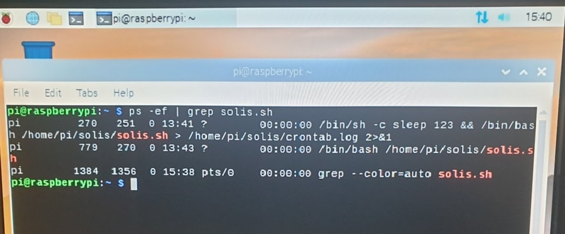

@oldman2uk I wonder if the python script is running in the background, despite the error message. You can check with
ps -ef | grep python
[ Voor 3% gewijzigd door ZuinigeRijder op 15-12-2024 18:35 ]
I've not tried to check but the script can be started in the command line and returns an output to pvoutput.org every 5 minutes.
If I reboot and wait longer than 5mins and have no output to pvoutput.org my thinking is that the script is not running.

  • ZuinigeRijder
@oldman2uk Yes, but the script needs to be run in the background, when you are logged out. solis.sh should also run from the command line, running the python script in the background.
There is still something wrong with solis.sh.
Can you post the output of the command
cat solis.sh
  • oldman2uk
OK thanks for your help.
Afbeeldingslocatie: https://tweakers.net/i/kiUntoumSbJadY44C08KLfUD8eI=/800x/filters:strip_icc():strip_exif()/f/image/JB9xvsM6sV31bnPmYWUko6cY.jpg?f=fotoalbum_large
[ Voor 4% gewijzigd door oldman2uk op 15-12-2024 20:34 ]
  • ZuinigeRijder
@oldman2uk I think I spotted the error. On line 15 I miss the i from the fi (which is the endif).
  • oldman2uk
ZuinigeRijder schreef op zondag 15 december 2024 @ 21:27:
Well done that man! I now have a solis.crontab.log and a solis.log that were not there before and it rebooted and started its task without action from the command line by me.

@oldman2uk If I summarize what were the real problems:
- you must make sure that there are no Windows style CRLF, which was the case in solis.sh and probably in the other files too
- the read+execute permission should be set on solis.sh
- you have a older python version where python 3.x is not the default, so you have to adapt solis.sh to change python into python3
- you had to install the package paho_mqtt==1.6.1
The other steps was learning and trying to find the problem. Some of the steps taken were not necessary, but were helpful in tracking down the problems.
I still hope you enjoyed the journey :9B :9B

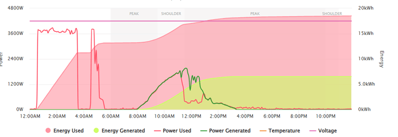

  • oldman2uk
@ZuinigeRijder
My journey continues ;)
I removed the keyboard/mouse & hdmi connects and it worked fine still. Until midnight or 12:00AM then no more outputs.
By 12:30AM it was obvious (headless) that it wasn't going to start the new day so a reboot by power removal got it moving again, Its now 12:45AM and its sending output fine since the reboot to pvoutput.
The only data showing is the temperature of the inverter and the mains voltage (in the wrong slot). Power generated when the sun shines is correct and in the right slot.
Power being used is near 4kWh now but nothing showing on the graph, its slot is taken by mains voltage.
Battery SOC is an extra slot that I am happy to exchange inverter temperature for.
So once you are refreshed I will be back to pick your brain if I may?
https://pvoutput.org/intraday.jsp?id=124179&sid=107241

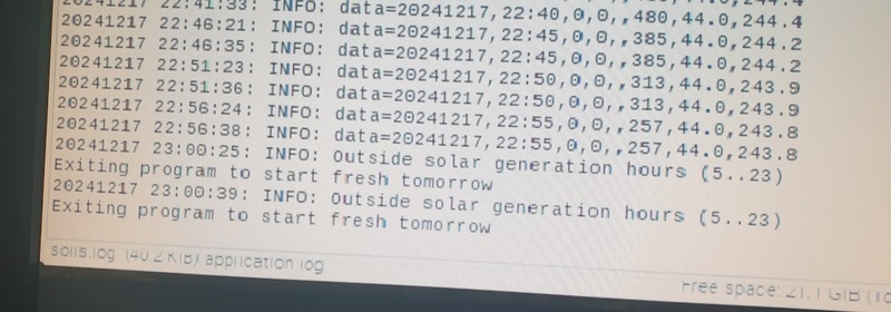

  • oldman2uk

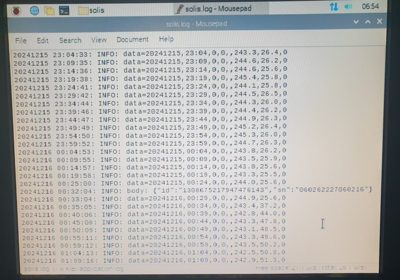

@ZuinigeRijder
Its a very big log at a line every 5mins. Here is the part dealing with midnight. looks like the data didnt stop, just failed to make a new day start on pvoutput. I will look at putty later, thank you.
Afbeeldingslocatie: https://tweakers.net/i/S4SXhJUNYYM6DISLCmtmBhuaG50=/800x/filters:strip_icc():strip_exif()/f/image/mV3fE0quVajPYa5Lb8PRUKJt.jpg?f=fotoalbum_large

  • ZuinigeRijder
oldman2uk schreef op maandag 16 december 2024 @ 20:40:
@ZuinigeRijder
I have renamed the 3 old ssh files in my pc and set ssh up on my Pi. I have logged in on my pc to the pi via cmd. I have also changed the password from the default. I still dont feel comfortable working in cmd line.
Ok, so you have another tool for remote logging in to the Raspberry Pi.
I didnt download putty yet as I saw it asked I put ssh in the boot or root of my Pi sd card.
I do not understand this, you do not need to install Putty on the Raspberry Pi, you can install this in your Windows PC. But apparently you do not need that, because you have another way to login on the Raspberry Pi. What did you use?
I am more concerned that my data to pvoutput will fail each night at midnight, I could put a digital timer to cut the Pi power at midnight and restart it at 12:02am but I would rather not as like you say, it may corrupt my sd card.
As far as I could see from the logging, there was no failure at midnight.
Also looking forward there is so far no usable data showing in pvoutput apart from the inverter temperature and system voltage, neither of which I really need. So unless I can get better usable data to work with then this exercise has been a little disappointing.

Are you able to tell me what data types are available from soliscloud api? I do need a minimum of Power used and power generated plus soc battery. I see power generated so far on pvoutput but it doesn't increase the total per day past 0.099kWh which is clearly incorrect, Its measuring the generated for the graph but I'm guessing solis doesnt total the day past 0.099kWh.
My brain is hurting again ;)

Once more the end of day came and went, after 11:55pm no more data appears to flow to Pvoutput.
At 1:00am I rebooted after checking the solis log did have data after midnight. At 1:05am pvoutput again got data. Very strange.
  • ZuinigeRijder
@oldman2uk As I did not test my changes to run it for always, I see that my instructions for the local changes were NOT complete. As you see in your post at 00:04:53 and subsequent data still the old date is send.
There are more changes needed to fix this, so I decided to make a configuration item to run it unendless and implemented this in soliscloud_to_pvoutput.py. Also added some more information to the README for the problems encountered. See this release.
- Add "run_unendless = True" to the [api_secrets] section in soliscloud_to_pvoutput.cfg
- copy the updated soliscloud_to_pvoutput.py to your Raspbery Pi (and run dos2unix on this one)

PVOutput fields are limited, so I am curious which settings you did change. Because there are not much settings to choose from/overrule.
The information in the script available is:
date
time
energy_generation
solar_power
battery_power
battery_soc
grid_power
family_load
home_consumption
inverter_temperature
dc_voltage
ac_voltage
Currently in PVOutput fields you can only override the power_consumption (default ac-voltage) with family_load or home_consumption for PVOutput. And voltage (default dc_voltage) with ac_voltage.
With Domoticz or MQTT (e.g. Home Assistant) all the settings above are available, but much much more complex and not suitable for your Raspberry Pi.

I put fill temp with inverter temp = true
fill voltage with ac voltage = true
fill power cons with homeconsumption = true
fill power cons with homeconsumption = false
fill power cons with ac voltage = false
date
time

So if I change the above to {battery_soc} instead of {temperature}
What exactly do I change the cfg line too?
[PVOutput]
send_to_pvoutput = True
pvoutput_fill_temperature_with_inverter_temperature = True
From above to below?
pvoutput_fill_temperature_with_battery_soc= True
Anywhere else I need to change ?
Finding the processs ID is confusing.
There are several numbers given, how do I know which is the right one to use? Is the ID always the same even after a reboot? Is there not a simple code if the ID constantly changes to use on the cmd line that tells a string to shut down the process. And maybe another to start it rather than have to go through a reboot?
Here is my list of ID's.
Afbeeldingslocatie: https://tweakers.net/i/vhiAjc0-jl9IVwySK3GP5pXdqmc=/800x/filters:strip_icc():strip_exif()/f/image/U9reXAacGQxwln9CwCKafLK8.jpg?f=fotoalbum_large

You do not need to change the cfg config file, because you programmatically overrule what is programmed in the settings for this item.

It is the oldest number you need to kill.
Another approach is to use:
pkill -9 solis.sh
nohup /home/pi/solis/solis.sh &
The first one kills the process with name solis.sh and the second one starts solis.sh in the background and it keeps running, also when logged out. I do not if pkill is installed on your Raspberry Pi, for me it is.

"It is the oldest number you need to kill."
There are 6 numbers in my picture which number is oldest?
pkill -9 solis.sh doesn't seem to do anything. pkill is installed though. help gets me a list of its options.
270
It kills the script silently, you can check with "ps -ef | grep solis.sh" if it is still running. Note that you should ignore the line with "grep" in it.

At 11pm the script stopped.
Afbeeldingslocatie: https://tweakers.net/i/Z_17J_WRxby9v3sAfUuQBejxvzA=/800x/filters:strip_icc():strip_exif()/f/image/ODc4kXc9Z8CYc6pfLUMuxWAx.jpg?f=fotoalbum_large
So I searched soliscloud_to_pvoutput.py for what could be wrong and of course found the False line.
69 RUN_UNENDLESS = get_bool(api_secrets, "run_unendless", False)
Changed to True and rebooted, now working again.
Did you not add "run_endless = True" to soliscloud_to_pvoutput.cfg 8)7 See here example config.
Because you did not need to change soliscloud_to_pvoutput.py for that.

I did add run_endless = true at the time of the original post telling me to do so, picture below.
A reboot last night left me with the same "come back tomorrow" message. Only after changing soliscloud_to_pvoutput.py did the script run again, started at 2:40am

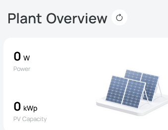

@ZuinigeRijder , ook ik zou graag een hint krijgen waar het script bij mij de mist in gaat. Ik ben met je script vandaag voor het eerst aan de slag gegaan. Mijn doel is de Solis inverter waarden in Domoticz. Ik heb daar 1 device aangemaakt, type Enery. het script draaien lukt, met tcpdump zie ik dat er verbinding is met de API URL, maar ik krijg onderstaande foutmelding. Idee wat er fout gaat?
(de ID en secrets hieronder zijn niet de correcte uiteraard)
20260529 13:42:45: ERROR: Exception: list index out of range, sleeping a minute
File "/home/otto/solis/soliscloud_to_pvoutput.py", line 528, in main_loop
do_work()
File "/home/otto/solis/soliscloud_to_pvoutput.py", line 365, in do_work
inverter_detail_body = get_inverter_list_body()
File "/home/otto/solis/soliscloud_to_pvoutput.py", line 342, in get_inverter_list_body
station_info = json.loads(content)["data"]["page"]["records"][
IndexError: list index out of range

  • ZuinigeRijder
@Packetloss Blijkbaar geeft soliscloud niet je inverter data terug. Dit is het eerste wat gebeurt en als dat niet lukt lijkt jouw jouw systeem niet goed toegevoegd aan soliscloud?
    content = get_solis_cloud_data(USER_STATION_LIST, body)
        SOLISCLOUD_STATION_INDEX
Ik neem aan dat je geconfigureerd hebt:
soliscloud_station_index = 0
soliscloud_inverter_index = 0
Je zou op regel 205 het hekje # kunnen weghalen, zodat er iets gelogd wordt:
        # log(SOLISCLOUD_API_URL+url_part + "->" + content)

Euh... Iets of iemand heeft opeens mijn plant verwijderd?! Kort nadat ik een API key heb gekregen. Nou.. eerst dat maar fixen dan. Dank

  • Packetloss
Packetloss
voor system specs, zie profiel
Nadat Solis de plant weer aan m'n account gekoppeld had, ging het scrippie netjes z'n werk doen. Dank!
