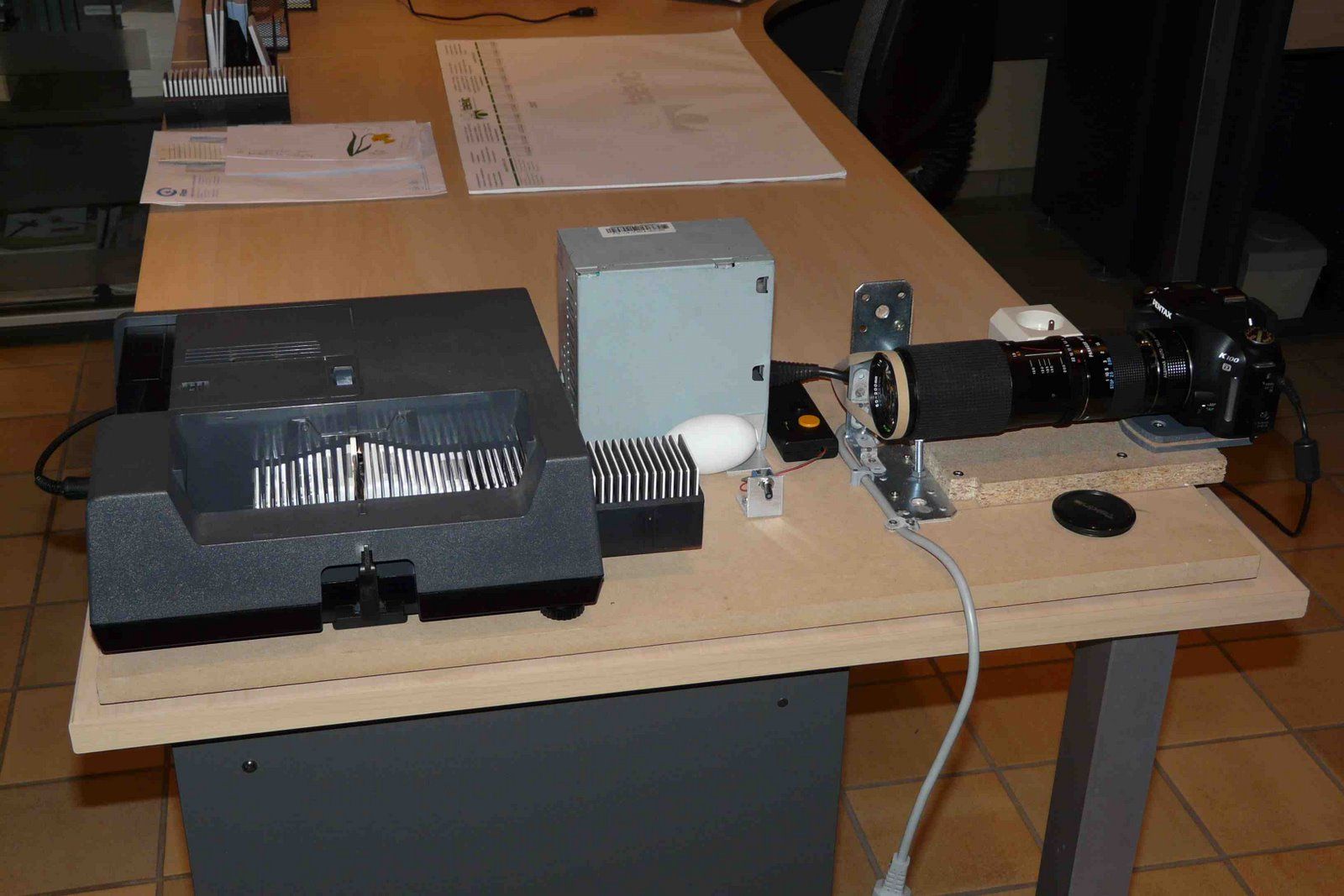

My obsolete Rotomatic Viewmaster "Automatic 510" as an automatic slide scanner. With an unexpectedly good result.If you've a projector, a DSLR body and the right lenses, you might learn here how to built one yourself... This movie shows my construction @ work ... YouTube: My home made diascanner @ work Need more information? Just send an email to diascanner@gmail.com
Afbeeldingslocatie: https://lh6.ggpht.com/_cqfk6ytsmrc/R6LJZajaANI/AAAAAAAAAB4/V8USFEE3iJE/s128/opstelling1.jpg

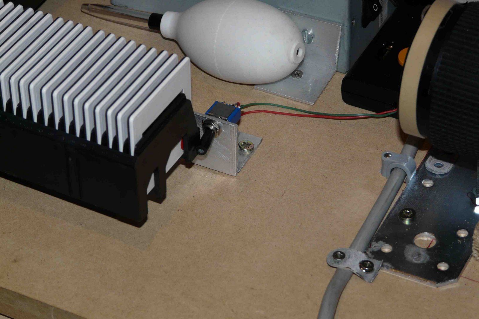

First of all, the remote push button is connected to a toggle switch to control the advance and the arrival of the charger in the last position (with the last slide staying inside)
Afbeeldingslocatie: https://lh4.ggpht.com/_cqfk6ytsmrc/R6LJZ6jaAOI/AAAAAAAAACE/QD3d3F7pdVg/s128/opstelling2.jpg

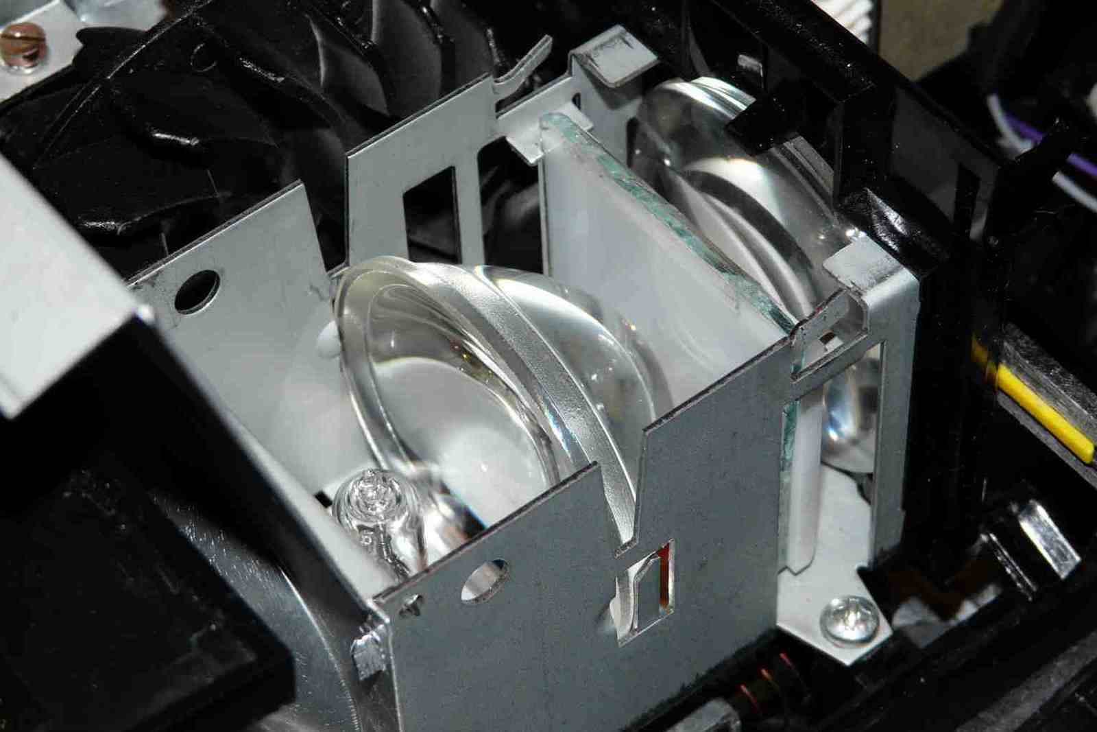

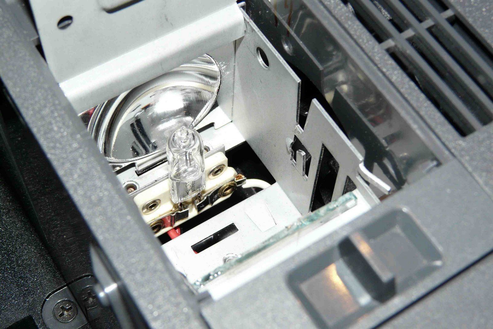

The original projector lamp of 150 Watts was replaced with a light source of 50 watts. I did let the light source permanently on. The lower power also means less risk over overheating.
Afbeeldingslocatie: https://lh4.ggpht.com/_cqfk6ytsmrc/R6LJb6jaASI/AAAAAAAAACk/xYSvrK20-10/s128/opstelling6.jpg

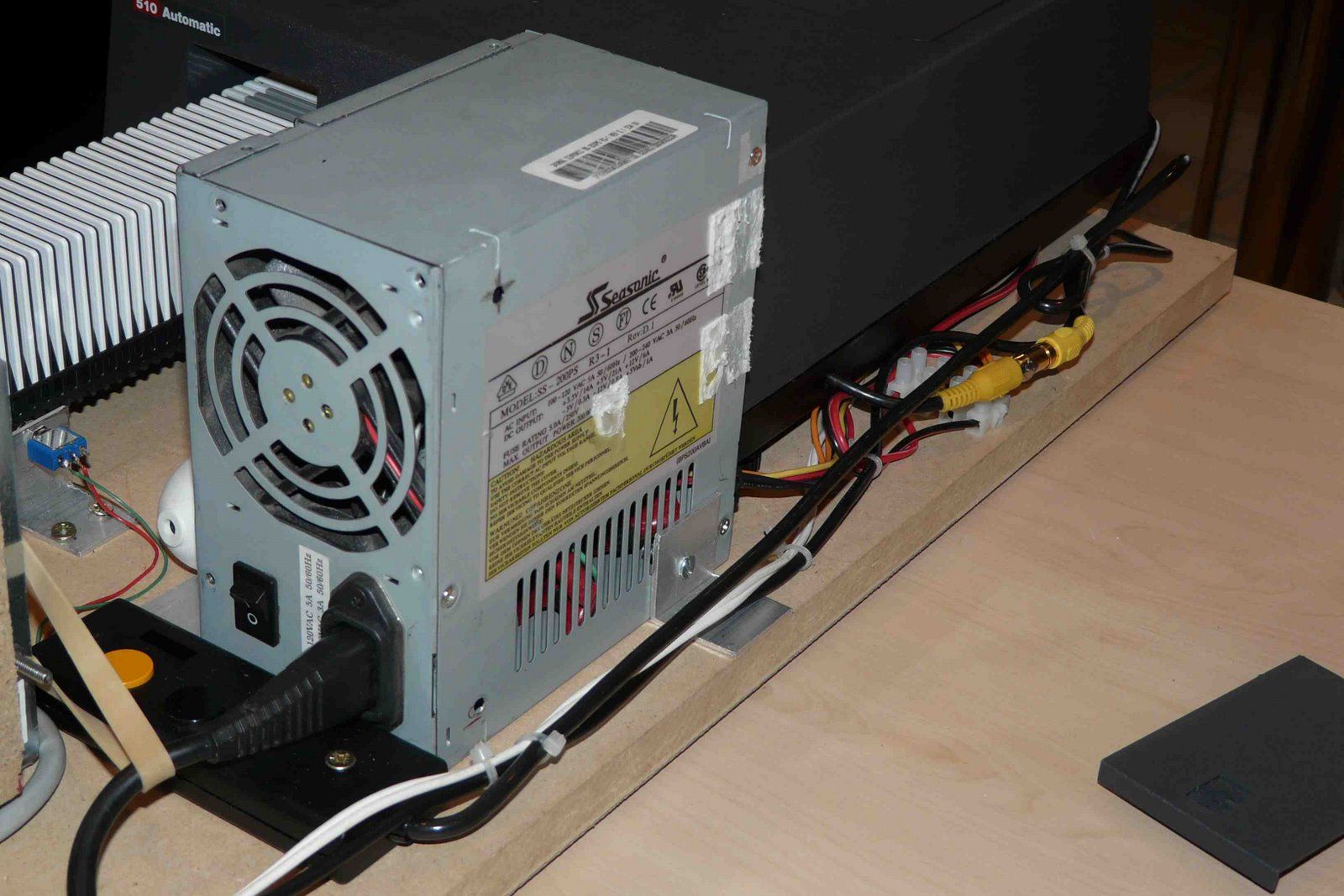

I used the 12V of an old PC power supply that can provide just enough power to feed the 50W light source …
Afbeeldingslocatie: https://lh5.ggpht.com/_cqfk6ytsmrc/R6LJcKjaATI/AAAAAAAAACs/YjTwsEQnlck/s128/opstelling7.jpg
A piece of milk glass (plexi) replacing the filterglass, together with the parabolic lenses take care of the uniform light distribution.
Afbeeldingslocatie: https://lh4.ggpht.com/_cqfk6ytsmrc/R7Ynw6KmBBI/AAAAAAAAAaU/MIr5yEbM0E8/s128/P1030375.jpg
Take care that there is no dust on those lenses, especially on the flat sides otherwise you may see some dark spots on the pictures…
Afbeeldingslocatie: https://lh4.ggpht.com/_cqfk6ytsmrc/R7Ynw6KmBAI/AAAAAAAAAaM/NSeXPTmR3jE/s128/P1030374.jpg

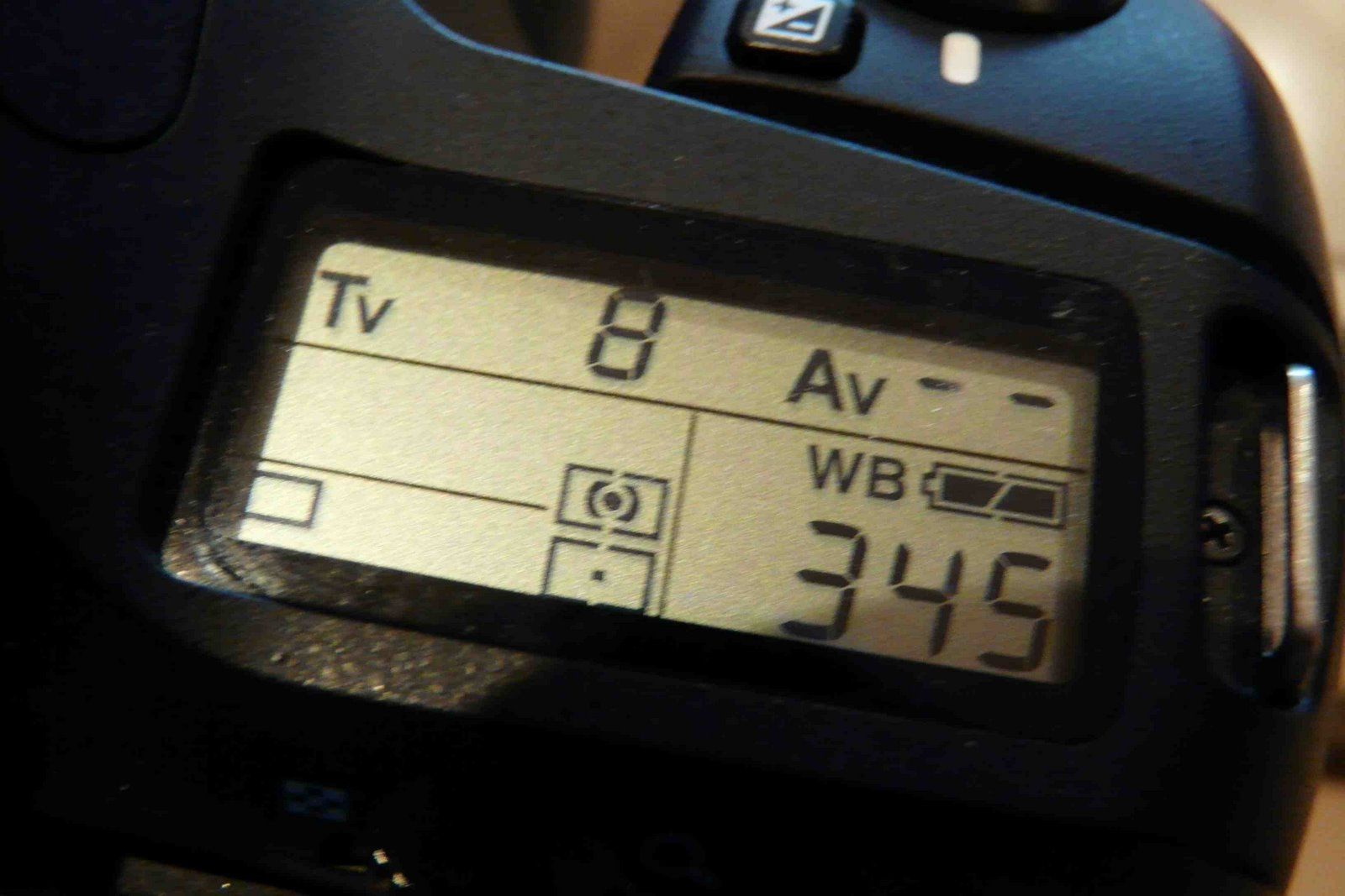

The shutter of the K100D, triggered by the micro switch, should only be open as long as the slide is not moving. With shutter times of 1/10 or 1/8, I was able to let the automatic changer run permanent without any kind of stop or delays…
Afbeeldingslocatie: https://lh3.ggpht.com/_cqfk6ytsmrc/R6LJeqjaAZI/AAAAAAAAADc/UhXaVcnsf0Y/s128/opstelling13.jpg

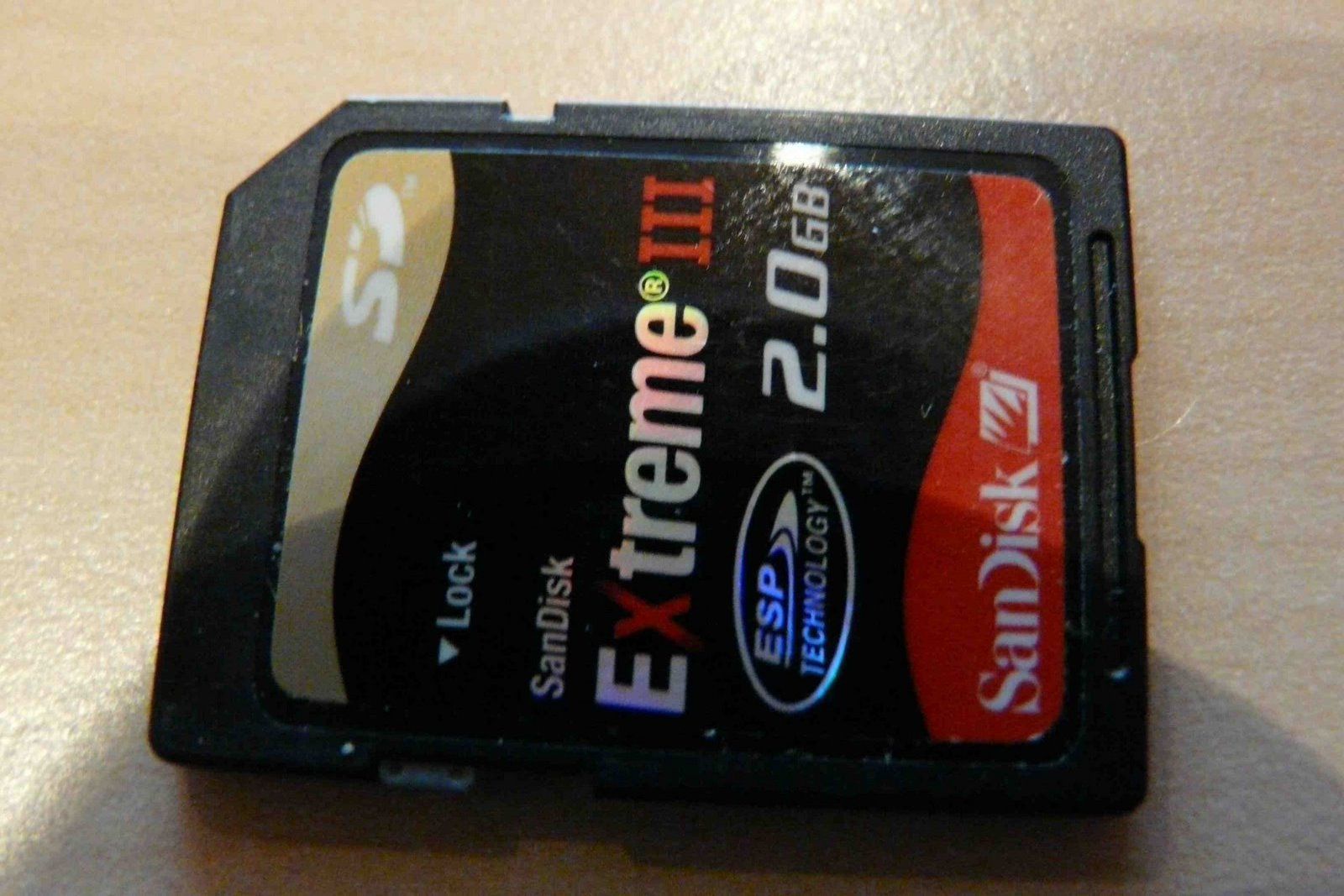

You better use a FAST flash storage card, otherwise the DSLR will refuse to follow the pace...
Afbeeldingslocatie: https://lh5.ggpht.com/_cqfk6ytsmrc/R6LJfKjaAaI/AAAAAAAAADk/VJXMqIgAqMc/s128/opstelling14.jpg

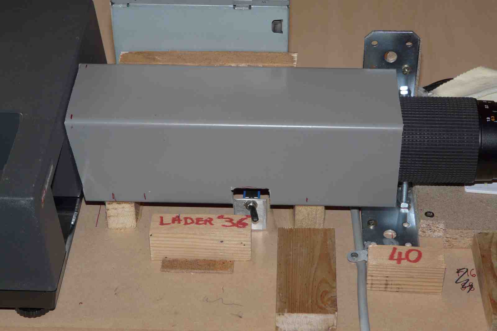

I also made a foreclosure to avoid direct sunlight and some wooden blocks to trigger the tumble switch with shorter chargers (I had to run chargers of 50, 40 and 36 positions)
Afbeeldingslocatie: https://lh4.ggpht.com/_cqfk6ytsmrc/R7hxdaKmBKI/AAAAAAAAAdk/W7fB5YkfbQ4/s128/P1030381.jpg

Het is gelukt. Niet supermooi en zeker voor verbetering vatbaar, maar afgelopen zaterdag hebben we 2700 dia's gefotografeerd zodat we die nu met mijn vader en anderen kunnen gaan bekijken.
Ik heb via Astro Products wat teflon plaatjes besteld van 10x10 en daarmee de lamp gedimd. Lens uit de projector, oude macro lens op de SLR, op manual focus, diafragma vast op F8 en klikken maar...
