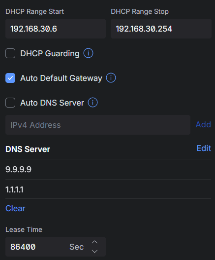

Bedankt voor jullie reacties, ik ben nextdns nu aan het testen. EDNS anonymized werkt goed.
Ik probeer de ip adressen van de ultralow1 en 2 te achterhalen, heeft iemand deze?
  • stormfly
Samplex schreef op zondag 13 april 2025 @ 18:54:
Our network spans many locations worldwide, striving to have a presence in the main city of most countries or states.
In each location, we always select two different providers with distinct network paths, hosted in separate datacenters.
Most locations are accessible via anycast, while all locations are available through ultralow (unicast with DNS steering).
We provide two anycast IPs assigned to the two different classes of providers present in each location, as described above. They have no preference over one another and are in place to ensure that if one becomes unreachable for any reason, the other will continue to operate. The DNS client will automatically fall back.
Note that if one provider fails in one location, the associated anycast IP will automatically be rerouted to another location. This combination offers high reliability.
With ultralow, the mechanism is similar, but our DNS steering system does all the work. Our *.dns.nextdns.io hostname does always resolve to two IPs across two different providers for a given location, and we also reroute to other locations when a provider's health in a location is degraded.
Ultralow provides access to more locations, potentially offering even lower latency than with anycast. For ultralow to function, you need to connect via our hostnames, which only works with encrypted protocols like DoH (DNS over HTTPS), DoT (DNS over TLS), and DoQ (DNS over QUIC).
https://help.nextdns.io/t...t-is-anycast-and-ultralow

  • Spixo
  • Laatst online: 12:11
Ik heb op mijn UXG Lite NextDNS CLI geïnstalleerd. Op zich werkt het ideaal, alle devices in huis maken automatisch gebruik van NextDNS.
Wat ik echter graag zou willen is dat een specifiek VLAN is uitgesloten. Dat VLAN moet dus gebruik maken van de internetprovider DNS (of welke andere service dan ook).
Ik dacht dit op te kunnen lossen met de -profile parameter, maar dat lukt helaas niet. Iemand de gouden tip voor mij?
  • Mr-D.
  • Laatst online: 11:57
Mr-D.
interpunctie? no hero here
Spixo schreef op maandag 14 september 2026 @ 20:39:
ik doe in het bewuste netwerk mijn eigen DNS servers invullen en dan gaat er niets via NextDNS dit voorbeeld is bij mij Vlan30
