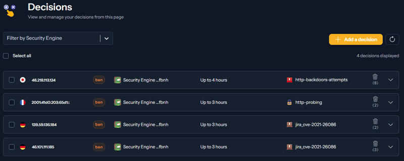

  • alex3305
  • Laatst online: 18-10 11:44
@Mars Warrior Even voortgezet uit het Docker topic...
Ik heb in Crowdsec de AppSec configuratie aangemaakt in de acquis.d map:
appsec.yaml
YAML:
listen_addr: 0.0.0.0:7422
appsec_config: crowdsecurity/appsec-default
source: appsec
labels:
  type: appsec
En daarna in de Traefik CrowdSec plugin AppSec aangezet:
crowdsec.yaml
YAML:
http:
  middlewares:
    crowdsec:
      plugin:
        bouncer:
          enabled: true
          crowdsecAppsecEnabled: true
          crowdsecAppsecHost: crowdsec:7422
          crowdsecAppsecPath: "/"
Dat was het. Ik gebruik in Crowdsec o.a. de volgende collections:
  • crowdsecurity/appsec-generic-rules
  • crowdsecurity/appsec-virtual-patching
  • crowdsecurity/appsec-crs
  • crowdsecurity/appsec-crs-inband
  • crowdsecurity/base-http-scenarios
  • crowdsecurity/home-assistant
  • crowdsecurity/http-cve
  • crowdsecurity/http-dos
  • crowdsecurity/http-extended-context
  • crowdsecurity/plex
  • crowdsecurity/traefik
  • crowdsecurity/whitelist-good-actors
En volgens cscli metrics werkt dit ook:
alex@LeeTower:~# docker exec traefik-crowdsec cscli metrics
| Acquisition Metrics                                                                                                                       |
| Source                                          | Lines read | Lines parsed | Lines unparsed | Lines poured to bucket | Lines whitelisted |
| appsec:appsec                                   | 92         | 92           | -              | 89                     | -                 |
| file:/var/log/home-assistant/home-assistant.log | 498        | -            | 498            | -                      | -                 |
| file:/var/log/traefik/access.log                | 80.56k     | 80.56k       | -              | 2.43k                  | 81.88k            |
| Appsec Metrics                      |
| Appsec Engine | Processed | Blocked |
| localAppSec   | 3.90k     | 40      |
| Scenario Metrics                                                                                         |
| Scenario                                   | Current Count | Overflows | Instantiated | Poured | Expired |
| crowdsecurity/appsec-native                | -             | -         | 1            | 1      | 1       |
| crowdsecurity/appsec-vpatch                | -             | 1         | 35           | 36     | 34      |
| crowdsecurity/crowdsec-appsec-outofband    | -             | 2         | 22           | 52     | 20      |
| crowdsecurity/http-admin-interface-probing | -             | 2         | 7            | 14     | 5       |
| crowdsecurity/http-backdoors-attempts      | -             | -         | 1            | 1      | 1       |
| crowdsecurity/http-bad-user-agent          | -             | 2         | 5            | 7      | 3       |
| crowdsecurity/http-crawl-non_statics       | -             | -         | 876          | 1.03k  | 876     |
| crowdsecurity/http-dos-swithcing-ua        | -             | -         | 852          | 883    | 852     |
| crowdsecurity/http-probing                 | -             | 10        | 206          | 356    | 196     |
| crowdsecurity/http-sensitive-files         | -             | 2         | 102          | 114    | 100     |
| crowdsecurity/http-wordpress-scan          | -             | 3         | 7            | 16     | 4       |
| crowdsecurity/jira_cve-2021-26086          | -             | 3         | 3            | -      | -       |
  • Mars Warrior
  • Laatst online: 20-10 10:16
Mars Warrior
Earth, the final frontier
alex3305 schreef op zaterdag 11 oktober 2025 @ 15:16:
appsec.yaml
YAML:
source: appsec
labels:
  type: appsec
Ok. Die is identiek :+
crowdsec.yaml
YAML:
http:
  middlewares:
    crowdsec:
      plugin:
        bouncer:
          enabled: true
Hmmm. Ik neem aan dat je de rest hebt weggelaten, zoals de LapiURl en LapiKey. Zonder start het bij mij niet op.
| Appsec Metrics                      |
| Scenario Metrics                                                                                         |
Hmm. Ja, het zou allemaal in één keer moeten werken, maar bij mij dus nog niet.
Op het moment dat ik enabled: true zet, dan gaan alle interne sites op 403, toegang geweigerd.
Maar ik krijg inmiddels al een hint waar het fout gaat. Ondanks dat ik overal infra-crowdsec heb staan, blijft "iets" crowdsec zoeken, die bestaat natuurlijk niet, en blijkbaar gaat het dan fout.
Bash Session:
DEBUG: CrowdsecBouncerTraefikPlugin: 2025/10/11 16:47:44 handleRemediationServeHTTP ip:168.119.123.75 remediation:t
DEBUG: CrowdsecBouncerTraefikPlugin: 2025/10/11 16:48:03 ServeHTTP ip:18.193.252.127 isTrusted:false
DEBUG: CrowdsecBouncerTraefikPlugin: 2025/10/11 16:48:03 cache:Get key:18.193.252.127
DEBUG: CrowdsecBouncerTraefikPlugin: 2025/10/11 16:48:03 ServeHTTP:Get ip:18.193.252.127 isBanned:false cache:miss
DEBUG: CrowdsecBouncerTraefikPlugin: 2025/10/11 16:48:03 ServeHTTP:handleNoStreamCache ip:18.193.252.127 isBanned:t crowdsecQuery:unreachable url:http://crowdsec:8080/v1/decisions?ip=18.193.252.127 Get "http://crowdsec:8080/v1/decisions?ip=18.193.252.127": dial tcp: lookup crowdsec on 127.0.0.11:53: no such host
DEBUG: CrowdsecBouncerTraefikPlugin: 2025/10/11 16:48:03 handleRemediationServeHTTP ip:18.193.252.127 remediation:t

Grappig dat als Traefik en CrowdSec samen hun werk doen, en je geen enkele alert meer hebt, dat de console van CrowdSec dan gaat twijfelen of CrowdSec nog wel werkt. Blijkbaar zit daar geen communicatie tussen om dat aan te geven...
Afbeeldingslocatie: https://tweakers.net/i/8z41pFKO3RaKWP_uBHKOGlhacXc=/fit-in/4000x4000/filters:no_upscale():strip_exif()/f/image/5nXDK659W0XSjGZgpacrxwnn.png?f=user_large
Je wordt hierdoor ook "gestraft" doordat je in dit soort gevallen de "Lite" blocklist krijgt (max 3k IP's), en niet de volledige omdat je nu niks meer bijdraagt door het gebrek aan alerts. Dus ze schroeven de beveiliging omlaag zodat er weer alerts kunnen komen |:(
Ze gaan er natuurlijk ook standaard vanuit dat je een ban van 4h doet. Bij mij zijn ze (bijna altijd) permanent, dus daarmee ook geen last van terugkerende alerts en dus decisions. Immers, botjes leren niet van een straf, die gaan gewoon door.
En custom AppSec collections/parsers/scenario's/alerts tellen niet, want die kunnen ze niet verifieren...
Ik heb dus wel een aantal van die custom dingen draaien om bijv. Wordfence blocks in de access log door te zetten naar CrowdSec. Het is nu enkel wachten op een onverlaat die weer een poging doet om in te loggen met "admin" of een andere logische gebruikersnaam :X
Al met al dus na 4 dagen een mooi resultaat: ik zie bijna geen 4** status codes meer in de logs voorbijkomen. Alles is een stuk rustiger. Voorlopig dus ook geen noodzaak om de hele lijst van ThreatHive (126.000 IPs) toe te passen.
