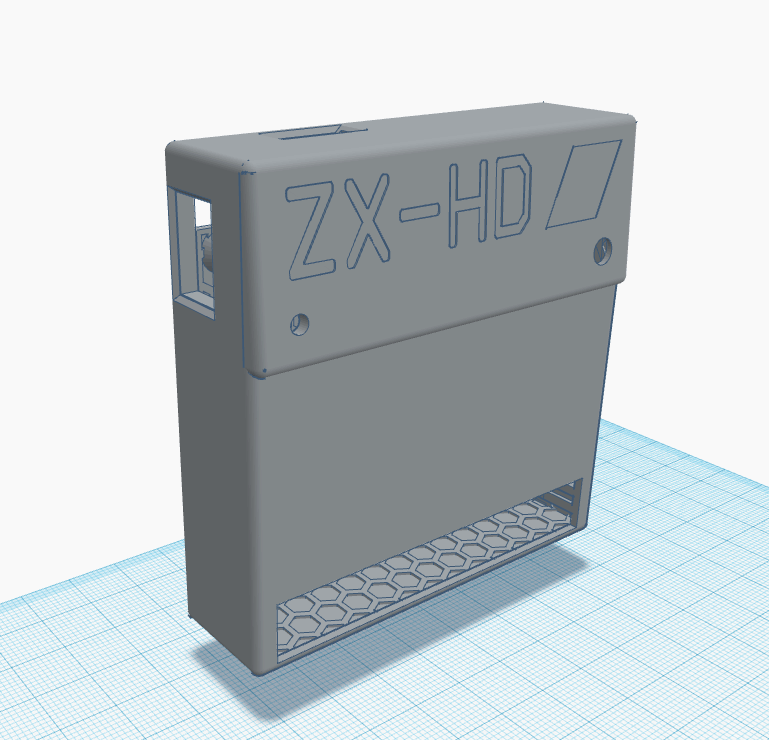

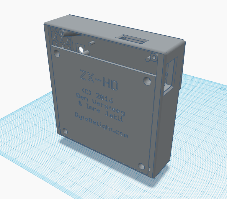

Video van de geprinte behuizing in 'strong & flexible plastic' van Shapeways:
Afbeeldingslocatie: http://tweakers.net/ext/f/XMKOOjLU54fry5IQUKeGuJ01/full.jpg
Retro Computer hardware: http://bytedelight.com
  • ByteDelight
  • Laatst online: 25-12-2025
ByteDelight
Retro computing is alive!
Crosspost van ander forum:
The second batch of SLS printed cases from ShapeWays arrived!
This one has an extra layer with a honeycomb pattern:
Afbeeldingslocatie: http://benophetinternet.nl/hobby/vanmezelf/SAM_0353.JPG
But, I'm not completely satisfied.
Let's start with the positive side: the case is far more rigid now with the honeycomb pattern!
It's much harder to press or bend the case now.
I'll try to show it here:
Afbeeldingslocatie: http://benophetinternet.nl/hobby/vanmezelf/SAM_0355.JPG
Afbeeldingslocatie: http://benophetinternet.nl/hobby/vanmezelf/SAM_0354.JPG
But now for the 'dark side', well, not so dark as it should be...
There is some color difference noticeable:
Afbeeldingslocatie: http://benophetinternet.nl/hobby/vanmezelf/SAM_0350.JPG
Afbeeldingslocatie: http://benophetinternet.nl/hobby/vanmezelf/SAM_0352.JPG
This gives me the idea it's spray painted, but I thought the cases were made out of black nylon powder.
But it turns it's white inside:
Afbeeldingslocatie: http://benophetinternet.nl/hobby/vanmezelf/SAM_0349.JPG
I checked the first prototype, and it's the same:
Afbeeldingslocatie: http://benophetinternet.nl/hobby/vanmezelf/SAM_0348.JPG
If the paintjob is done like this, I might better do it myself.
And that would be a lot cheaper too.
The print quality seems to be better with the second prototype: the text on top is sharper.
But it's now noticeable that the font size could be a bit larger as it doesn't show all detail.
Here are photos of both cases from the second batch:
Afbeeldingslocatie: http://benophetinternet.nl/hobby/vanmezelf/SAM_0358.JPG
Afbeeldingslocatie: http://benophetinternet.nl/hobby/vanmezelf/SAM_0359.JPG
The second prototype also had text on the bottom, but the quality of the print of that lacks every detail.
One of the two is almost not noticeable:
Afbeeldingslocatie: http://benophetinternet.nl/hobby/vanmezelf/SAM_0356.JPG
Afbeeldingslocatie: http://benophetinternet.nl/hobby/vanmezelf/SAM_0357.JPG
So that text should be larger too, or we have to think of something else: a sticker or text at the side of the case.
It seems to be caused by the nylon powder not solidifying quick enough, causing similar effects as with filament, but on a smaller scale.
I checked the insides of the case parts to verify this.
The bottom part has a sharp pattern:
Afbeeldingslocatie: http://benophetinternet.nl/hobby/vanmezelf/SAM_0361.JPG
But the upper part seems smoother because of the solidifying time.
Conclusions:
1. I definately go for the honeycomb pattern, making it far more rigid.
2. I will contact shapeways about the poor paint job, and ask if it's possible to paint the material myself.
3. I will look for alternative white SLS services which lowers the price significantly.
Still, it is a beautiful product so far!

Ik gebruik sinds enkele maanden Tinkercad om zelf m'n ontwerpen online te kunnen maken, en dat lukt aardig:
Afbeeldingslocatie: https://tweakers.net/ext/f/EImyIj5uqZQmqNOmLekuKIbu/full.png
Afbeeldingslocatie: https://tweakers.net/ext/f/TmmKJUJMkeD0AsEe5551ZPVk/full.png
Ik weet dat er gemakkelijkere tools zijn, zoals Autodesk Fusion 3D, maar ik vind het wel fijn dat ik de ontwerpen altijd bij me heb.
