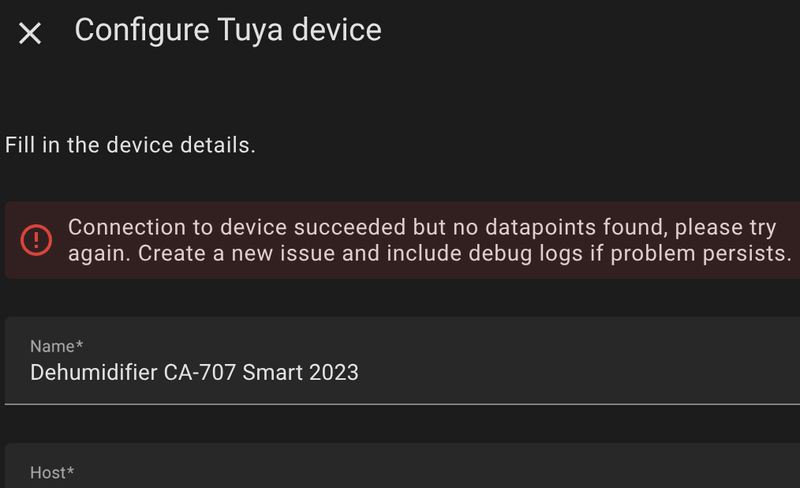

I finally got around to trying again. Unfortunately in localTuya I keep getting the following message:
Connection to device succeeded but no datapoints found, please try again. Create a new issue and include debug logs if problem persists.
Afbeeldingslocatie: https://tweakers.net/i/lGWAfmgRzi4zgL5g5sBuSX7k18E=/800x/filters:strip_exif()/f/image/aWiCQ43kgORiDVM4ORO7NXoM.png?f=fotoalbum_large
Both protocol 3.3 and 3.4. Any chance you can provide screenshots of your settings in localTuya?

Thank you for sharing. It took me a while, but I figured out the problem: The "local key" fetched by localTuya is different from the "local key" on iot.tuya.com.
At some point I did re-add the dehumidifier to my network, but I also re-loaded localTuya. I did not realize the key was different. The error message "connection succeeded (but no datapoints found)" made me assume at least the key was correct.
Adding the device is a bit spartan (and I see you did a better job adding DP's like Ion, Tank full etc.) but at least I can turn it on and off now!
