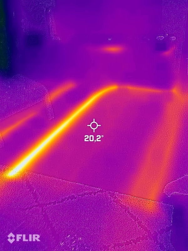

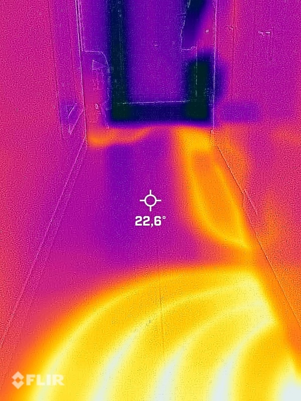

Also I tried to check with an IR camera and saw there some spots with no heating which shouldn't be the case I think.
Afbeeldingslocatie: https://tweakers.net/i/jXobbGIMmTeZwHSxprU0A5PocVY=/x800/filters:strip_icc():strip_exif()/f/image/Ak39He1drxSeHOD2nmK6qnUQ.jpg?f=fotoalbum_large
Afbeeldingslocatie: https://tweakers.net/i/i4p-X5P_9X0DPT5hMIU6o5cNj3M=/x800/filters:strip_icc():strip_exif()/f/image/ts4dHHgtFEVYkRY5AqsFnNfJ.jpg?f=fotoalbum_large
Afbeeldingslocatie: https://tweakers.net/i/DHPlIfloHahBMy6Wb78bBUJ3XOc=/x800/filters:strip_icc():strip_exif()/f/image/hD100XTQ6My4XdyLCVNOcQvu.jpg?f=fotoalbum_large
Can you please help me what could be the reason for it? how can I fix it? or should I leave it as it is.
Thanks a lot!
  • Proton_
  • Laatst online: 31-10 18:36
Proton_
Team Welles
If you point the IR camera to the manifold (verdeler), are all return and supply temperatures about equal and above 25°C ? If not, then air can be an issue and it should be purged one circuit at a time. If they are about equal, then the cold spots simply don't have an underfloor tube and there is not much you can do.

I checked them so while the heating are working the supply temperatures are in the range of 58 to 60 something like this for the return some of them are 22.5 some are higher 26. So it might seem like I need to do the purger you're talking about.
Im the vattenvall device the entering temperature is around 70 and the return is around 22.5 - 23.
I checked the document provided by the company when they installed the underfloor heating (that was long time ago 2008) and it seems there should be pipes covering all places.
Can you tell me please how to do the purge one circuit at a time?
