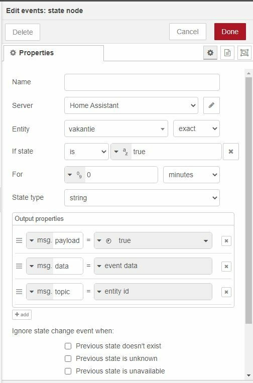

[{"id":"cdb45ce2cb3823b8","type":"server-state-changed","z":"11ad4ca1edecbc85","name":"","server":"b62cc5f5.7d4ab8","version":4,"exposeToHomeAssistant":false,"haConfig":[{"property":"name","value":""},{"property":"icon","value":""}],"entityidfilter":"input_boolean.vakantie","entityidfiltertype":"exact","outputinitially":false,"state_type":"str","haltifstate":"true","halt_if_type":"str","halt_if_compare":"is","outputs":2,"output_only_on_state_change":false,"for":"0","forType":"num","forUnits":"minutes","ignorePrevStateNull":false,"ignorePrevStateUnknown":false,"ignorePrevStateUnavailable":false,"ignoreCurrentStateUnknown":false,"ignoreCurrentStateUnavailable":false,"outputProperties":[{"property":"payload","propertyType":"msg","value":"true","valueType":"bool"},{"property":"data","propertyType":"msg","value":"","valueType":"eventData"},{"property":"topic","propertyType":"msg","value":"","valueType":"triggerId"}],"x":230,"y":200,"wires":[["ef5b9aaad6508aad","b87f38d2fb1eb90e"],[]]},{"id":"ef5b9aaad6508aad","type":"debug","z":"11ad4ca1edecbc85","name":"debug 3","active":true,"tosidebar":true,"console":false,"tostatus":true,"complete":"payload","targetType":"msg","statusVal":"payload","statusType":"auto","x":500,"y":80,"wires":[]},{"id":"b87f38d2fb1eb90e","type":"api-call-service","z":"11ad4ca1edecbc85","name":"","server":"b62cc5f5.7d4ab8","version":5,"debugenabled":false,"domain":"light","service":"turn_on","areaId":[],"deviceId":[],"entityId":["light.woonkamer"],"data":"","dataType":"json","mergeContext":"","mustacheAltTags":false,"outputProperties":[],"queue":"none","x":670,"y":220,"wires":[[]]},{"id":"b62cc5f5.7d4ab8","type":"server","name":"Home Assistant","addon":true}]
Ik moet bekennen dat de code niet erg leesbaar is,
Ik heb de configuratie van de switch even als capture bijgevoegd. Mogelijk is dat makkelijker. De uitgang van de switch koppel ik met een wire de call naar de lamp. Want ikheb het geoeld dat ik daar iets niet goed doe

Even snel voor je uitgeprobeerd, maar je probleem zit in de check die je doet in de 'state_changed'-node
De 'state_changed' geeft als output 'on' of 'off', en niet true of false.
[{"id":"285f1f3dfa858b1f","type":"server-state-changed","z":"c6d0e2bf13cbd98d","name":"","server":"b62cc5f5.7d4ab8","version":4,"exposeToHomeAssistant":false,"haConfig":[{"property":"name","value":""},{"property":"icon","value":""}],"entityidfilter":"input_boolean.vakantie","entityidfiltertype":"exact","outputinitially":false,"state_type":"str","haltifstate":"true","halt_if_type":"str","halt_if_compare":"is","outputs":2,"output_only_on_state_change":false,"for":"0","forType":"num","forUnits":"minutes","ignorePrevStateNull":false,"ignorePrevStateUnknown":false,"ignorePrevStateUnavailable":false,"ignoreCurrentStateUnknown":false,"ignoreCurrentStateUnavailable":false,"outputProperties":[{"property":"payload","propertyType":"msg","value":"true","valueType":"bool"},{"property":"data","propertyType":"msg","value":"","valueType":"eventData"},{"property":"topic","propertyType":"msg","value":"","valueType":"triggerId"}],"x":290,"y":1300,"wires":[["ebdc62a246d67502","7638d4656aa4b224"],["ebdc62a246d67502"]]},{"id":"ebdc62a246d67502","type":"debug","z":"c6d0e2bf13cbd98d","name":"debug 3","active":true,"tosidebar":true,"console":false,"tostatus":true,"complete":"true","targetType":"full","statusVal":"payload","statusType":"auto","x":660,"y":1220,"wires":[]},{"id":"7638d4656aa4b224","type":"api-call-service","z":"c6d0e2bf13cbd98d","name":"","server":"b62cc5f5.7d4ab8","version":5,"debugenabled":false,"domain":"light","service":"turn_on","areaId":[],"deviceId":[],"entityId":["light.woonkamer"],"data":"","dataType":"json","mergeContext":"","mustacheAltTags":false,"outputProperties":[],"queue":"none","x":730,"y":1320,"wires":[[]]},{"id":"b62cc5f5.7d4ab8","type":"server","name":"Home Assistant","addon":true}]
Importeer deze even, wat een kopie is van jouw flow. Ik heb hierbij de debug-node aan zowel de true als false-output geknoopt, en de debug-node op 'complete msg-object' gezet in plaats van 'msg.payload'.
Hierdoor kun je veel beter zien welke data er allemaal doorgegeven wordt.
