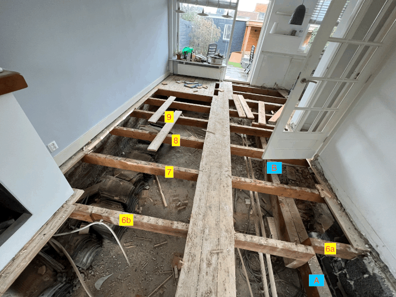

Hi,
Big update on the topic! Sorry, I'm too tired to type it in Dutch.
I got the keys on Monday. I have had a lot of fun since. I started to remove the stuff, especially the old wooden underfloor with my father (thanks to him!) that we did today. For now, only the beams remain. This is kind of stressful. The foam concrete company comes next Tuesday for the foil, and next Wednesday for the concrete. Some beams for sure do not hold anything, some do hold a wall and I'm not sure how to deal with them.
Afbeeldingslocatie: https://tweakers.net/i/Bpn5cBAvirwZl94H3LYvW7jr8n0=/800x/filters:gifsicle():strip_exif()/f/image/5AQdiziVUdyBGggwR0bybOVq.gif?f=fotoalbum_large
I think I can remove 1, 2, 3 and 4. 5a may cary some part of the wall, so I think I only should make it shorter.
Afbeeldingslocatie: https://tweakers.net/i/Z2r_VXZ_39oxZPAs7rwRVSrMhko=/x800/filters:gifsicle():strip_exif()/f/image/6n9pUi8m1b0J1id1shS94Vhp.gif?f=fotoalbum_large
Maybe I can remove 5b, it does not seem that it's carrying the chimney. 5C does (see other picture below). 7 does not hold anything (maybe some part of the wall close to the door?).
Afbeeldingslocatie: https://tweakers.net/i/Ty9uJp0rGwXq4oqaNLITTa0pdws=/x800/filters:gifsicle():strip_exif()/f/image/XMDdj5zq9qX4cW9U9u1YDwMv.gif?f=fotoalbum_large
Afbeeldingslocatie: https://tweakers.net/i/udcT3xMagj94io0Dhn3t6rOJhG4=/800x/filters:gifsicle():strip_exif()/f/image/0b4cv5jtxmmxTpV6Lowakj04.gif?f=fotoalbum_large
10, 11, 12 and 13 can be removed I think.
Afbeeldingslocatie: https://tweakers.net/i/REc8Wg_iaDpKFlmb_ZelxpWrQjA=/800x/filters:gifsicle():strip_exif()/f/image/otVXk3NltF5TZFyYeGjn4LfA.gif?f=fotoalbum_large
7, 8 and 9 carry the wall close to the door. I can probably make it shorter until B.
Afbeeldingslocatie: https://tweakers.net/i/8Cbl5hsafFYgiiNHNI5CTPvyIms=/800x/filters:gifsicle():strip_exif()/f/image/kJobMqnoa0MLWKeC6GiZ7Gov.gif?f=fotoalbum_large
5C, as mentioned earlier; seems to hold the chimney. It also seems that this is the beam from the neighbor! It's a hook huis, other houses were built at the same time and as the same building. Some beams that do not seem to carry something from my side may hold something for the neighbor...
Afbeeldingslocatie: https://tweakers.net/i/4vUXWrPUpi9nGFAa_q2os1bgoJE=/800x/filters:gifsicle():strip_exif()/f/image/ZFg8IzYI0PCSCdFI5PdQjWZO.gif?f=fotoalbum_large
8 and 9 carry some wall. So I could make it shorter to B.
For now, I cannot remove A or B since it's holding some other supporting beams....

Voor zover mijn kennis reikt kan er geen enkele houten balk blijven zitten als er schuimbeton wordt gestort.
Er zal dus een stukje fundering onder de schoorsteen moeten worden gemaakt, er van uitgaande dat de schoorsteen moet blijven bestaan(maar waarom zou je dat willen). Hetzelfde geldt voor de muur van de hal, die moet op de bodem van de kruipruimte worden ondersteund zodat de balken weg kunnen. Ik neem aan dat het geen dragende muur is en dus de oplossing vrij eenvoudig kan zijn, een stapel tegels op de bodem van de kruipruimte.
Dat jij en de buren samen gebruik maken van dezelfde balken is een vreemde constructie.
Heb je een bouwtekening waarin te zien is welke muren dragend zijn?

Ik zou inderdaad een bouwtekening bij de gemeente opvragen indien je die niet hebt en vraag dan om alle bouwtekeningen van het huis, voor het geval er door de jaren heen verbouwingen en daarmee nieuwe tekeningen zijn geweest. Ik heb dit tijdens corona gedaan dus kreeg gewoon digitale versies gemaild en moest daarvoor 'administratiekosten' betalen.
Bij mij zijn destijds alle balken (en balkenkoppen) verwijderd voor het schuimbeton maar een gemetseld muurtje (voor ondersteuning draagbalk) kon gewoon blijven staan. Ik had het geluk dat de gang op de kelder stond en de schoorsteen doorgemetseld was.
Als ik jou was zou ik het bedrijf vandaag even bellen om te vragen naar die balken, want bij mij was ook heel duidelijk aangegeven dat er geen houten balken (of koppen) achter mochten blijven. Volgens mij in verband met uitzetten en vochtafgifte van het schuimbeton...
Denk dat je de dakpannen op de één na laatste foto ook moet vervangen met stenen.
En houd er rekening mee dat je alle balkenkoppen uit de muur moet verwijderen. Dit viel ons nog vies tegen, sommige zaten echt muurvast. Dus zou zeker wel vandaag alle mogelijke balken verwijderen en starten met de balkenkoppen uit de muur te halen. En de vloer van de kruipruimte moet zo vlak/egaal mogelijk zijn, dus al het puin moet je nog opruimen en vloer aanvegen etc.
Ik zie ook nog leidingen. Je weet dat je die moet isoleren met een mantelbuis als er vloeistof doorheen gaat? Tenzij ze het flexibele leidingen met isolatie zijn natuurlijk. Dan kunnen ze onder het folie, net als de elektrakabels.

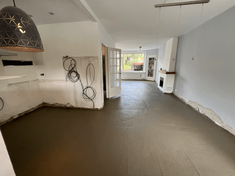

Elke dag komt met een nieuw probleem. Ik had verwacht dat het schuimbeton vlakker zou zijn. Ik heb hoogteverschillen (hoewel ik niet kan zeggen hoeveel) en ik denk niet dat ik Fermacell direct op de vloer kan leggen zoals het is. Ik dacht aan egaline. Sommige worden door het parketbedrijf op de Fermacell gezet, voordat ze het parket verlijmen. Wat denk je?

Nu toch vloerverwarming en dan +- 7cm cement dekvloer?

@benito
Sen schreef op donderdag 25 augustus 2022 @ 17:31:
Dat dus, noppenplaat met vloerverwarming met cement dekvloer of anhydriet.
  • D-e-n
  • Laatst online: 23:28
@benito
Zat de vloerverwarming niet inbegrepen bij de schuimbeton vloer? Dat leek zo in je openingspost.

Er werd mij een andere oplossing voorgesteld, hoewel ik moet toegeven dat de cementdekvloer van het betonbedrijf veel gemakkelijker was... Ik had niet genoeg tijd om het te laten drogen. Mij werd voorgesteld om Fermacell-platen te plaatsen die door het vloerverwarmingsbedrijf zullen worden gefreesd. Nadat ze de pijpen hebben geplaatst, worden de sleuven afgedicht. Vervolgens zal het parketbedrijf egaline plaatsen en het parket lijmen.

Tja waarom dan niet gewoon isolatie in de kruipruimte en die platen op de houten vloer.
Dit is echt een oplossing die energie technische nergens op slaat.

De vloer was niet echt stabiel en op sommige plaatsen lager. Deze oplossing werd voorgesteld door het parketbedrijf. De Fermacell is slechts 25 mm. Ander voordeel: het hoeft niet te drogen.

Egalisatie korrels is je antwoord. Maar een hele rare oplossing.
Je had ook met egalisatie korrels over de houten vloer gekund en daar de fermacell plaat op.

Ik zit met precies de zelfde situatie. Keuze voor schuimbeton ivm oplossen van vochtproblemen en door een wanddoorbraak worden alle vloerbalken al doorgezaagd. Maar een deel van de woning zal een houten vloer houden ivm de ondergelegen kelder. Hierdoor overweeg ik om met korrels te egaliseren op het schuimbeton, want voor een dekvloer hebben wij eigenlijk ook geen tijd (droogtijd).
Af en toe denk ik er ook aan om gewoon de balken weer terug te plaatsen en toch tussen de balken te isoleren. Ik ben benieuwd wat je uiteindelijk hebt gekozen en of dit bevalt. @benito

VanEck schreef op maandag 27 oktober 2025 @ 13:31:
Hoezo geen tijd? Zijn die paar dagen extra voor een dekvloer een probleem? Als je toch al op je slaapkamer of in de schuur aan het kamperen bent kunnen die extra dagen droogtijd er toch ook wel bij? Dan ben je voor altijd klaar.

Zandcement met versneller duurt alsnog 2 weken, daarna kan ik pas de vloerverwarming erin frezen. Parket verlijmd leggen kan ook pas als de dekvloer volledig is uitgehard. Dus het gaat 2 a 3 weken extra tijd kosten
