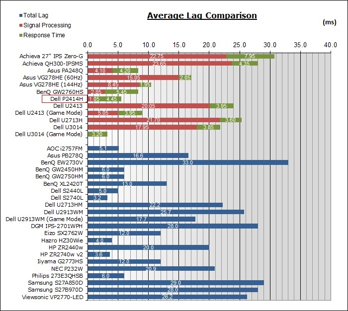

input lag
The Dell P2414H showed an average total display lag of only 5.5ms during the initial tests. This lag was very low overall, equating to less than half a frame. We measured half the average G2G response time as 4.45ms and so we can estimate that the signal processing is approximately 1.05ms. This represents a very low lag and means the screen should be perfectly fine, even for fast FPS gaming.
Grafiekje die de vergelijking CRT vs hedendaagse monitors toont
bron: http://www.tftcentral.co.uk/reviews/dell_p2414h.htm
We have provided a comparison above against other models we have tested to give an indication between screens. Those shown with blue bars in the bottom half represent the total "display lag" as at the time of review we did not have access to an oscilloscope system to measure the response time element and provide an estimation of the signal processing. The screens tested more recently in the top half are split into two measurements which are based on our overall display lag tests (using SMTT) and half the average G2G response time, as measured by the oscilloscope. The response time is split from the overall display lag and shown on the graph as the green bar. From there, the signal processing (red bar) can be provided as a good estimation.
