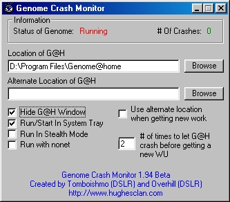

Crashmonitor: This program checks the G@H... thread every 60 seconds. If it is running, nothing happens, but if G@H... has crashed it will restart it.
On the second restart, it deletes the WU and gets a new one. Afbeeldingslocatie: http://www.hughesclan.com/downloads/crashmon.JPG
