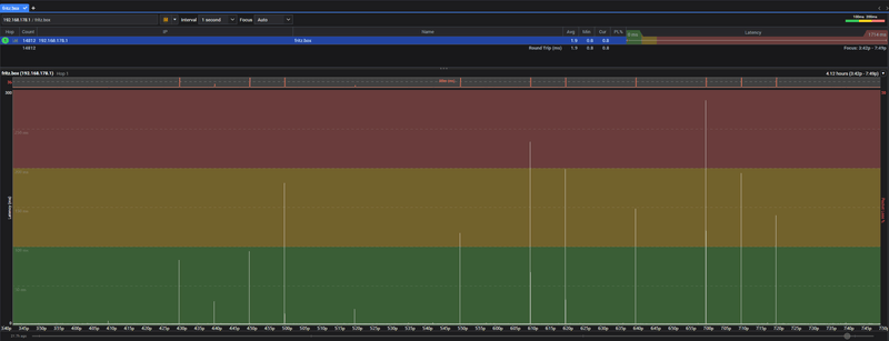

Hi!
I have Odido for a while and I have been using their router ZYXEL T-54, but I always had issues with it (My setup is full wireless; no ethernet cables around). I notice this mainly in the form of lag spikes while gaming:
  • I play online games (e.g. Call of Duty, Insurgence Sandstorm, etc) which I noticed lag-spikes intermittently, causing stutters and other weird things such as the sound dissaperaring and coming back after 1-2 seconds
  • I built a local gaming streaming from my Desktop to my TV using Apollo + Moonlight, and the local network simply can't handle it. As soon as one extra device connects to it and starts to use the network (e.g. watch a Youtube in 4K) , the whole gaming experience degrades with jitters and slow connection warnings;
The issues above both confirmed that the router was the bottleneck. When using the cable directly into it, the issues were gone. The router is located in the hallway in the middle of my apartment; the wifi signal is strong in all devices that are using it.
So I ended up upgrading from Zyxel T-54 to Fritzbox 5090 Pro , which seemed like a great improvement. I noticed that I could do my gaming streaming with multiple devices connected and using the network without any issues, which is a great improvement, but one problem still there: I am still having jitters/lag-spikes constantly every 10 minutes, which ends up degrading both the multiplayer and localhost experience. (Btw, I am investigating this on here in case anyone is interested to look at).
So, while waiting for the answer from Frtizbox support and Reddit folks, I am also looking for possible router alternatives to Fritzbox which I can use to fix my setup.
Does anyone have any recommendations for other routes? or perhaps any suggestions in how can I fix this problem?
Thanks!

I get it, cable solves the problem, but it is too much of hassle for me to pull it around the whole apartment unfortunately.
It is hard to believe the neighbors Wifi is causing this too. This is a periodic latency spike that happens every 10 minutes, it is not a spike that happens randomly, and its interval is very specific: every 10 minutes, on a specific timestamp interval such as 18h:17m:40s, 18h:27m:40s , and so on. I can also see that I am the only one using 5 GHz channel 36. So it feels like neighbor signals it not the issue here..

@SMSfreakie I tested with a wire, the problem is gone. Happens only on Wifi
@MAX3400 I will test the PingPlotter disconnecting multiple devices from it and seeing if the issue persists. It could be that a specific device is doing that.. I haven't seen that before though! That is new to me

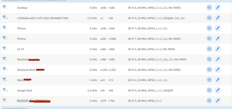

These are the devices connected and some properties, maybe it gives some insights
Afbeeldingslocatie: https://tweakers.net/i/V-OKDM8qtG9PhmvKjt38End0jQ4=/800x/filters:strip_exif()/f/image/3kcepfcriXGHZFvmFSGeer1A.png?f=fotoalbum_large

Je zou eens WiFi Assist kunnen uitzetten op de iPhone en kijken of dat beter gaat?

So it seems when the iPhone 17 pro and the apple watch aren't connected it seems to work fine?? Can you keep those suspect devices off the network for a longer test? (24h should be enough)
Just to make sure it's not a coincidence..
And to which network do they connect normally? 2.4ghz of the 5ghz?
And do both networks (2.4 and 5g) have exactly the same issues? Or didn't you test that...

@Frogmen So, I started splitting the Wifi channels because I thought it would solve this issue, but turned out it didn't fix it :-(
@SMSfreakie I did a test this afternoon - disconnected the iPhones and just connected my Macbook and my LG TV on the 5 GHz channel and the issue still continued.. I am using the TV, Desktop, Macbooks and iPhones/AppleWatch on 5 GHz. Other devices such as Google Nest, Chromecast, I connect on 2 GHz .
I didn't test the 2 GHz network. I did focus only on 5 GHz Afbeeldingslocatie: https://tweakers.net/i/xGZv15jO9K6cwJblQZwEO1rxodo=/800x/filters:strip_exif()/f/image/RNquvCfmAHYk1Rfz98RLUfEa.png?f=fotoalbum_large
