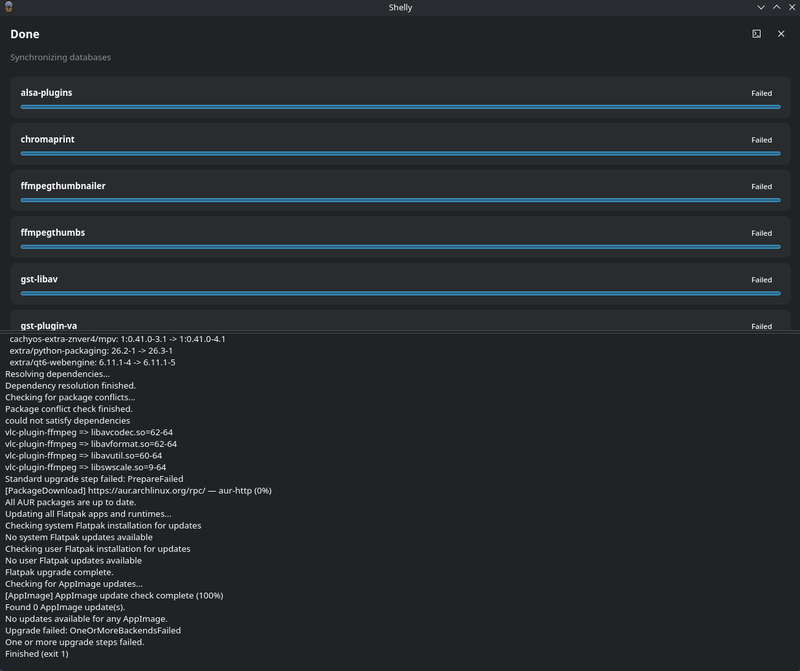

Met google krijg ik dit te zien:
https://www.google.com/search?q=installing+ffmpeg++breaks+dependency+%27libavcodec.so%3D62-64%27+required+by+vlc-plugin-ffmpeg&sca_esv=38057d684074d37c&sxsrf=APpeQnvNzfXIjhiIour0I_0Z30zsb1wcKA%3A1786138101111&ei=9U12ar6uBpTri-gP_o-0qQc&biw=2560&bih=1309&ved=0ahUKEwj-_KT4uo-WAxWU9QIHHf4HLXUQ4dUDCBA&uact=5&oq=installing+ffmpeg++breaks+dependency+%27libavcodec.so%3D62-64%27+required+by+vlc-plugin-ffmpeg&gs_lp=Egxnd3Mtd2l6LXNlcnAiWGluc3RhbGxpbmcgZmZtcGVnICBicmVha3MgZGVwZW5kZW5jeSAnbGliYXZjb2RlYy5zbz02Mi02NCcgcmVxdWlyZWQgYnkgdmxjLXBsdWdpbi1mZm1wZWdIigdQAFgAcAB4AJABAJgBKqABKqoBATG4AQPIAQD4AQGYAgCgAgCYAwCSBwCgB2qyBwC4BwDCBwDIBwCACAE&sclient=gws-wiz-serp
Met shelly krijg ik dit te zien:
Afbeeldingslocatie: https://tweakers.net/i/YSFr8vnkV1mh4zELjloG9kkE03U=/800x/filters:strip_exif()/f/image/m9JRz11rk1FwiTxPhzvCgb1V.png?f=fotoalbum_large

:: Pre-transactie-hooks uitvoeren...
(1/2) Performing snapper pre snapshots for the following configurations...
==> root: 973
(2/2) Waiting for limine-snapper-sync to finish...
:: Pakketveranderingen verwerken...
(  1/110) upgraden alsa-plugins                                                                            [---------------------------------------------------------------] 100%
(  2/110) upgraden x265                                                                                    [---------------------------------------------------------------] 100%
(  3/110) upgraden ffmpeg                                                                                  [---------------------------------------------------------------] 100%
(  4/110) upgraden chromaprint                                                                             [---------------------------------------------------------------] 100%
(  5/110) upgraden ffmpeg4.4                                                                               [---------------------------------------------------------------] 100%
(  6/110) upgraden ffmpegthumbnailer                                                                       [---------------------------------------------------------------] 100%
(  7/110) upgraden ffmpegthumbs                                                                            [---------------------------------------------------------------] 100%
(  8/110) upgraden gstreamer                                                                               [---------------------------------------------------------------] 100%
(  9/110) upgraden gst-plugins-base-libs                                                                   [---------------------------------------------------------------] 100%
( 10/110) upgraden gst-libav                                                                               [---------------------------------------------------------------] 100%
( 11/110) upgraden gst-plugins-bad-libs                                                                    [---------------------------------------------------------------] 100%
( 12/110) upgraden gst-plugin-va                                                                           [---------------------------------------------------------------] 100%
( 13/110) upgraden openal                                                                                  [---------------------------------------------------------------] 100%
( 14/110) upgraden openexr                                                                                 [---------------------------------------------------------------] 100%
( 15/110) upgraden gst-plugins-bad                                                                         [---------------------------------------------------------------] 100%
( 16/110) upgraden gst-plugins-base                                                                        [---------------------------------------------------------------] 100%
( 17/110) upgraden gst-plugins-good                                                                        [---------------------------------------------------------------] 100%
( 18/110) upgraden gst-plugins-ugly                                                                        [---------------------------------------------------------------] 100%
( 19/110) upgraden hardinfo2                                                                               [---------------------------------------------------------------] 100%
( 20/110) upgraden kfilemetadata                                                                           [---------------------------------------------------------------] 100%
( 21/110) upgraden mpv                                                                                     [---------------------------------------------------------------] 100%
( 22/110) upgraden haruna                                                                                  [---------------------------------------------------------------] 100%
( 23/110) upgraden kpipewire                                                                               [---------------------------------------------------------------] 100%
( 24/110) upgraden libheif                                                                                 [---------------------------------------------------------------] 100%
( 25/110) upgraden libvlc                                                                                  [---------------------------------------------------------------] 100%
( 26/110) upgraden opencv                                                                                  [---------------------------------------------------------------] 100%
( 27/110) upgraden python-packaging                                                                        [---------------------------------------------------------------] 100%
( 28/110) upgraden qt6-multimedia-ffmpeg                                                                   [---------------------------------------------------------------] 100%
( 29/110) upgraden qt6-multimedia                                                                          [---------------------------------------------------------------] 100%
( 30/110) upgraden qt6-webengine                                                                           [---------------------------------------------------------------] 100%
( 31/110) upgraden vlc-plugin-alsa                                                                         [---------------------------------------------------------------] 100%
( 32/110) upgraden vlc-plugin-a52dec                                                                       [---------------------------------------------------------------] 100%
( 33/110) upgraden vlc-plugin-archive                                                                      [---------------------------------------------------------------] 100%
( 34/110) upgraden vlc-plugin-dav1d                                                                        [---------------------------------------------------------------] 100%
( 35/110) upgraden vlc-plugin-dbus                                                                         [---------------------------------------------------------------] 100%
( 36/110) upgraden vlc-plugin-dbus-screensaver                                                             [---------------------------------------------------------------] 100%
( 37/110) upgraden vlc-plugin-faad2                                                                        [---------------------------------------------------------------] 100%
( 38/110) upgraden vlc-plugin-flac                                                                         [---------------------------------------------------------------] 100%
( 39/110) upgraden vlc-plugin-gnutls                                                                       [---------------------------------------------------------------] 100%
( 40/110) upgraden vlc-plugin-inflate                                                                      [---------------------------------------------------------------] 100%
( 41/110) upgraden vlc-plugin-jpeg                                                                         [---------------------------------------------------------------] 100%
( 42/110) upgraden vlc-plugin-journal                                                                      [---------------------------------------------------------------] 100%
( 43/110) upgraden vlc-plugin-matroska                                                                     [---------------------------------------------------------------] 100%
( 44/110) upgraden vlc-plugin-mpg123                                                                       [---------------------------------------------------------------] 100%
( 45/110) upgraden vlc-plugin-ogg                                                                          [---------------------------------------------------------------] 100%
( 46/110) upgraden vlc-plugin-opus                                                                         [---------------------------------------------------------------] 100%
( 47/110) upgraden vlc-plugin-png                                                                          [---------------------------------------------------------------] 100%
( 48/110) upgraden vlc-plugin-shout                                                                        [---------------------------------------------------------------] 100%
( 49/110) upgraden vlc-plugin-speex                                                                        [---------------------------------------------------------------] 100%
( 50/110) upgraden vlc-plugin-tag                                                                          [---------------------------------------------------------------] 100%
( 51/110) upgraden vlc-plugin-theora                                                                       [---------------------------------------------------------------] 100%
( 52/110) upgraden vlc-plugin-twolame                                                                      [---------------------------------------------------------------] 100%
( 53/110) upgraden vlc-plugin-vorbis                                                                       [---------------------------------------------------------------] 100%
( 54/110) upgraden vlc-plugin-vpx                                                                          [---------------------------------------------------------------] 100%
( 55/110) upgraden vlc-plugin-xml                                                                          [---------------------------------------------------------------] 100%
( 56/110) upgraden vlc-plugins-base                                                                        [---------------------------------------------------------------] 100%
( 57/110) upgraden vlc-cli                                                                                 [---------------------------------------------------------------] 100%
( 58/110) upgraden vlc-plugin-lua                                                                          [---------------------------------------------------------------] 100%
( 59/110) upgraden vlc-plugin-pulse                                                                        [---------------------------------------------------------------] 100%
( 60/110) upgraden vlc-plugins-video-output                                                                [---------------------------------------------------------------] 100%
( 61/110) upgraden vlc-gui-qt                                                                              [---------------------------------------------------------------] 100%
( 62/110) upgraden vlc                                                                                     [---------------------------------------------------------------] 100%
( 63/110) upgraden vlc-plugin-aalib                                                                        [---------------------------------------------------------------] 100%
( 64/110) upgraden vlc-plugin-aom                                                                          [---------------------------------------------------------------] 100%
( 65/110) upgraden vlc-plugin-aribb24                                                                      [---------------------------------------------------------------] 100%
( 66/110) upgraden vlc-plugin-aribb25                                                                      [---------------------------------------------------------------] 100%
( 67/110) upgraden vlc-plugin-ass                                                                          [---------------------------------------------------------------] 100%
( 68/110) upgraden vlc-plugin-avahi                                                                        [---------------------------------------------------------------] 100%
( 69/110) upgraden vlc-plugin-bluray                                                                       [---------------------------------------------------------------] 100%
( 70/110) upgraden vlc-plugin-caca                                                                         [---------------------------------------------------------------] 100%
( 71/110) upgraden vlc-plugin-cddb                                                                         [---------------------------------------------------------------] 100%
( 72/110) upgraden vlc-plugin-chromecast                                                                   [---------------------------------------------------------------] 100%
( 73/110) upgraden vlc-plugin-dca                                                                          [---------------------------------------------------------------] 100%
( 74/110) upgraden vlc-plugin-dvb                                                                          [---------------------------------------------------------------] 100%
( 75/110) upgraden vlc-plugin-dvd                                                                          [---------------------------------------------------------------] 100%
( 76/110) upgraden vlc-plugin-ffmpeg                                                                       [---------------------------------------------------------------] 100%
( 77/110) upgraden vlc-plugin-firewire                                                                     [---------------------------------------------------------------] 100%
( 78/110) upgraden vlc-plugin-fluidsynth                                                                   [---------------------------------------------------------------] 100%
( 79/110) upgraden vlc-plugin-freetype                                                                     [---------------------------------------------------------------] 100%
( 80/110) upgraden vlc-plugin-gme                                                                          [---------------------------------------------------------------] 100%
( 81/110) upgraden vlc-plugin-gstreamer                                                                    [---------------------------------------------------------------] 100%
( 82/110) upgraden vlc-plugin-jack                                                                         [---------------------------------------------------------------] 100%
( 83/110) upgraden vlc-plugin-kate                                                                         [---------------------------------------------------------------] 100%
( 84/110) upgraden vlc-plugin-libsecret                                                                    [---------------------------------------------------------------] 100%
( 85/110) upgraden vlc-plugin-lirc                                                                         [---------------------------------------------------------------] 100%
( 86/110) upgraden vlc-plugin-live555                                                                      [---------------------------------------------------------------] 100%
( 87/110) upgraden vlc-plugin-mad                                                                          [---------------------------------------------------------------] 100%
( 88/110) upgraden vlc-plugin-mdns                                                                         [---------------------------------------------------------------] 100%
( 89/110) upgraden vlc-plugin-modplug                                                                      [---------------------------------------------------------------] 100%
( 90/110) upgraden vlc-plugin-mpeg2                                                                        [---------------------------------------------------------------] 100%
( 91/110) upgraden vlc-plugin-mtp                                                                          [---------------------------------------------------------------] 100%
( 92/110) upgraden vlc-plugin-musepack                                                                     [---------------------------------------------------------------] 100%
( 93/110) upgraden vlc-plugin-nfs                                                                          [---------------------------------------------------------------] 100%
( 94/110) upgraden vlc-plugin-notify                                                                       [---------------------------------------------------------------] 100%
( 95/110) upgraden vlc-plugin-samplerate                                                                   [---------------------------------------------------------------] 100%
( 96/110) upgraden vlc-plugin-sdl                                                                          [---------------------------------------------------------------] 100%
( 97/110) upgraden vlc-plugin-sftp                                                                         [---------------------------------------------------------------] 100%
( 98/110) upgraden vlc-plugin-smb                                                                          [---------------------------------------------------------------] 100%
( 99/110) upgraden vlc-plugin-soxr                                                                         [---------------------------------------------------------------] 100%
(100/110) upgraden vlc-plugin-srt                                                                          [---------------------------------------------------------------] 100%
(101/110) upgraden vlc-plugin-svg                                                                          [---------------------------------------------------------------] 100%
(102/110) upgraden vlc-plugin-udev                                                                         [---------------------------------------------------------------] 100%
(103/110) upgraden vlc-plugin-upnp                                                                         [---------------------------------------------------------------] 100%
(104/110) upgraden vlc-plugin-x264                                                                         [---------------------------------------------------------------] 100%
(105/110) upgraden vlc-plugin-x265                                                                         [---------------------------------------------------------------] 100%
(106/110) upgraden vlc-plugin-zvbi                                                                         [---------------------------------------------------------------] 100%

Dan moet ik even langer wachten totdat er weer een upgrade komt voor ffmpeg.
Maar tot nu toe eindelijk verder gekomen.

~ 30s
Topic mag gesloten worden. Alles is weer gefixed.
http://specs.tweak.to/12249 Nieuwe stuff, zie link links.
  • Cyphax
Cyphax
Moderator LNX/AI
Fijn dat het is opgelost! Ik heb wel het verzoek om lange logs in een code-blokje te plaatsen. Die zijn ingeklapt, dat scheelt veel scrollwerk. :)
Vraag blijft of je in de nabije toekomst weer tegen dingen aan gaat lopen. Uiteraard is Tweakers nr1, maar CachyOS heeft een eigen forum waar ook veel tips in staan. Ik heb deze dependencies niet gezien onder Bazzite. Op mijn laptop staat CachyOS en ik zal even opletten of dit ook de laptop treft.
  • Hero of Time
  • Laatst online: 22:17
Hero of Time
Moderator LNX
There is only one Legend
Dit is niet ongewoon bij rolling release distro's. Updates komen niet tegelijk, zeker bij mirrors kan er verschil zitten wanneer die beschikbaar zijn. Grote kans dus dat een package al wijst naar dependencies die nog onderweg zijn. Gewoon wachten en later weer eens proberen.
Commandline FTW
