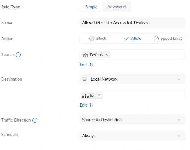

vanaf dit stukje zou het moeten werken
You probably want to access your IoT device, for example, from your main (default) VLAN. To do this we can create another Traffic Rule to allow traffic from the Default network to the IoT network. Now this is where Traffic Rules become a bit confusing for most, let’s first create the rule and I will then explain it a bit:
Afbeeldingslocatie: https://tweakers.net/i/_zzECpEHKNc8xcBayRNdT2Bhh4I=/fit-in/4920x3264/filters:max_bytes(3145728):no_upscale():strip_exif()/f/image/I7qqSZC5vETmMPQqdka19yoS.webp?f=user_large

@bdevogt dit heb ik dus gedaan :s
- rule type: simple
- action: allow
- source: default
- destionation: local network ==> guest
- trafic direction: source to destination
- schedule: always
