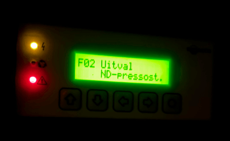

I bought a house with a warmtepomp waterkotte A1, and I am making the maintenance every year, inclusive, last one was end of September this year.
Today arrived home from work and wifey said there is no hot water.
Checked the warmtepomp and have the error below:
Afbeeldingslocatie: https://tweakers.net/i/f9P_sCGDMcz3D9QDb5L-x7mHY0s=/fit-in/4000x4000/filters:no_upscale():strip_exif()/f/image/3wXNT7N5tbsWkJO7BslT0FjV.png?f=user_large
Now, with Christmas incoming and family coming to visit, it is not the best timing...
Any help? Anything I can do to fix this? Or....
Thanks in advance!
Francisco
  • AUijtdehaag
It sounds like you're dealing with an issue related to the ND-Pressostat on your Waterkotte heat pump. The ND-Pressostat (low-pressure switch) is a safety device that monitors the pressure in the refrigerant circuit. When it detects low pressure, it shuts off the compressor to prevent damage.
Common issues with the ND-Pressostat can include:
- **Low refrigerant levels**: This is one of the most common causes. If the refrigerant is low, the pressure in the system drops, triggering the ND-Pressostat.
- **Blockages or leaks**: Any blockage in the refrigerant lines or leaks can also cause low pressure.
- **Faulty pressostat**: Sometimes, the ND-Pressostat itself can be faulty and may need replacement.
If you're experiencing this issue, it might be a good idea to have a professional technician check your system. They can diagnose the exact cause and recommend the appropriate fix.
Is this the issue you're facing, or do you have more details about the problem?
