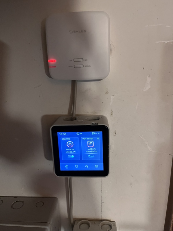

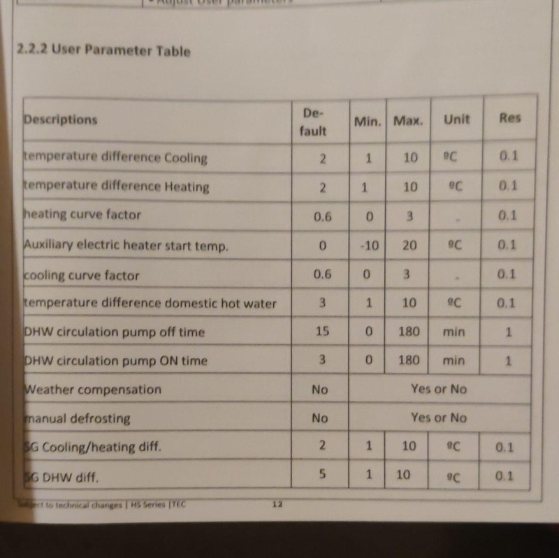

Hello,
Could someone post their values used in your electric heating system with normal radiators?
I live in a 1980 row house with energy label A but the average electricity consumption is 20kWh to 25 kWh per day. I feel something is off with the settings but I'm not able to find out what's wrong. The fan in the outdoor unit switches on every now and then that increases the electricity consumed.
Afbeeldingslocatie: https://tweakers.net/i/vZrb_rtFiYb8XWHhTOMCSPL8oUg=/x800/filters:strip_icc():strip_exif()/f/image/WQCq1bgMk2tIIIgqC6eH6wXH.jpg?f=fotoalbum_large
Afbeeldingslocatie: https://tweakers.net/i/H3pY9Tu52jVCxsZZQd0QNSVYN4g=/800x/filters:strip_icc():strip_exif()/f/image/4feP4XYNh62NygRxXiyZEykC.jpg?f=fotoalbum_large
I tried resetting the values to the one shown in the manual, but that didn't help either.
Model - TEC HS08 8kW Monobloc propaan with Daikin RVS 200ltr Boiler
Thermostat temperature is set at 21.5°C. It takes too long to heat up. For example it takes 2 hours from 19.5 till 20.5 degrees. In an hour the thermostat is back to 19 degrees and heating runs again. I have set the DHW to 50 degrees.
The photo shows the default values set in the touch screen unit placed near the boiler in the Attic (according to the manual)
The company is not very responsive to help us out with this issue.
Thanks in advance.
