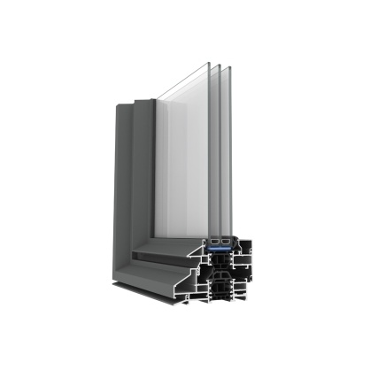

Aliplast Max Light steel
Afbeeldingslocatie: https://tweakers.net/i/_vbjEfKOvSzABRA7xwAl_hy-IA4=/fit-in/4920x3264/filters:max_bytes(3145728):no_upscale():strip_icc():fill(white):strip_exif()/f/image/NyQSo5XOcxH2g9HX6CRT7nPX.jpg?f=user_large
