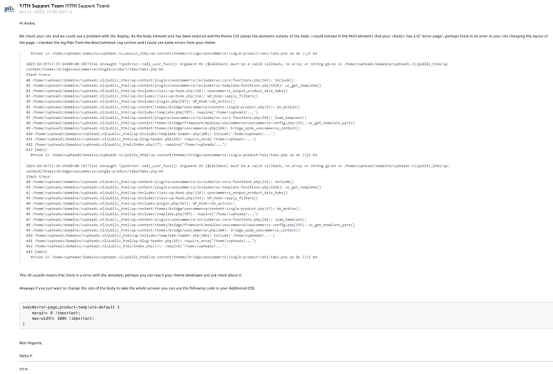

Contact gehad met de support afdeling van Yith, zij gaven aan dat het probleem bij mijn theme ligt. en gaven mij onderstaande conclusie mee. (screenshot meegestuurd)
We check your site and we could see a problem with the display. As the body element size has been reduced and the theme CSS places the elements outside of the body. I could noticed in the html elements that your <body> has a ID "error-page", perhaps there is an error in your site changing the layout of the page. I checked the log files from the WooCommece Log section and I could see some errors from your theme:
Afbeeldingslocatie: https://tweakers.net/i/PlPf3v-0H3eSHxTTHzRSl7AgISI=/800x/filters:strip_exif()/f/image/U4dPoqk3nYjHORTyEWZJUJGs.png?f=fotoalbum_large
This ID usually means that there is a error with the template, perhaps you can reach your theme developer and ask more about it.
