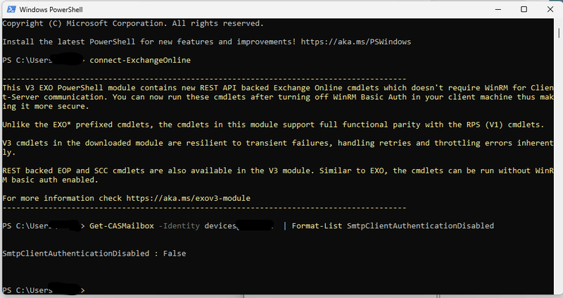

Nog even gechecked:
Get-CASMailbox -Identity xxxxxxxx@###.nl  | Format-List SmtpClientAuthenticationDisabled
SmtpClientAuthenticationDisabled : False
