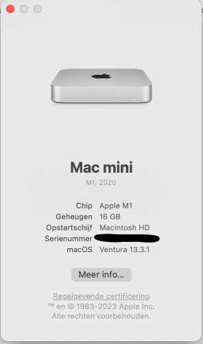

Specs mac mini:
Afbeeldingslocatie: https://tweakers.net/i/v0UzUc_9gC7mOEaspJUpz5XORwY=/full-fit-in/4000x4000/filters:no_upscale():fill(white):strip_exif()/f/image/PcwSwjuArZvrOEHSfBduzC4H.png?f=user_large
