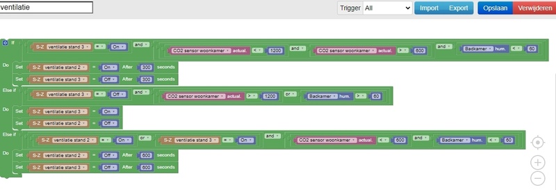

Hoe stuur je je ventilatie aan nu? Via wifi of iets dergelijks?
Ik heb er zelf 1 in blockly staan voor ventilatie (ook met co2).
Kan ze wel delen, kan je het zo overnemen.
Afbeeldingslocatie: https://tweakers.net/i/mWuk5Ngu8h-bQPQT2GrJWKuHUiw=/800x/filters:strip_icc():strip_exif()/f/image/eXHtNLHTovNYnKmWtku1ebHV.jpg?f=fotoalbum_large
nog makkelijker, hier het schript.
<xml xmlns="http://www.w3.org/1999/xhtml"><block type="domoticzcontrols_ifelseif" id="^JbMbqvFJP;(=td);iVb" x="-775" y="-187"><mutation elseif="2"></mutation><value name="IF0"><block type="logic_operation" id="xbeo7*,MHdj}b/Qj.kv-"><field name="OP">AND</field><value name="A"><block type="logic_compare" id="1sL@q]+yh~/cvL}Xd`1,"><field name="OP">EQ</field><value name="A"><block type="switchvariablesSZ" id="Mz8]e.dpTe3#R/WXPz4W"><field name="Switch">134</field></block></value><value name="B"><block type="logic_states" id="wlF?n-TL`f3HP]JcjO@L"><field name="State">On</field></block></value></block></value><value name="B"><block type="logic_operation" id="3;:zhi/V3vzhgGbZH(lt"><field name="OP">AND</field><value name="A"><block type="logic_operation" id="|L|IyGhiX:1Q]2.GSI00"><field name="OP">AND</field><value name="A"><block type="logic_compare" id="y)QUw/X$z3AVV+~~!TJJ"><field name="OP">LT</field><value name="A"><block type="utilityvariables" id="67fGLIG];;GCVz/!YS;8"><field name="Utility">120</field></block></value><value name="B"><block type="math_number" id="Hw-~GKkml*KV{h[RGeIF"><field name="NUM">1200</field></block></value></block></value><value name="B"><block type="logic_compare" id="pP`_E7:)pILoo8C@ODmR"><field name="OP">GT</field><value name="A"><block type="utilityvariables" id="(--9O,yH)$3/]g+GBj#9"><field name="Utility">120</field></block></value><value name="B"><block type="math_number" id="lbhBwVf]mQhCx30V:5Er"><field name="NUM">600</field></block></value></block></value></block></value><value name="B"><block type="logic_compare" id="iiCo}GeXop.ZQ,:S}_i%"><field name="OP">LT</field><value name="A"><block type="humidityvariables" id="UwR/9Diz4n_0;#,A.]oQ"><field name="Humidity">130</field></block></value><value name="B"><block type="math_number" id="s*rk%V[];chOMVBwFT_O"><field name="NUM">60</field></block></value></block></value></block></value></block></value><statement name="DO0"><block type="logic_setafter" id="C!KC/){ST5!uYVH#W@9Z"><value name="A"><block type="switchvariablesSZ" id="6a*)Z8l8kvP=38DkqJ]3"><field name="Switch">135</field></block></value><value name="B"><block type="logic_states" id=",%zdYPiJZKUjopf:t#00"><field name="State">On</field></block></value><value name="C"><block type="math_number" id="z!*jIRFPg5$EY@2Lg/e-"><field name="NUM">300</field></block></value><next><block type="logic_setafter" id="}C2(c[Ngj,T/}tY5X(AX"><value name="A"><block type="switchvariablesSZ" id="+5q*)ZUb~eS_v~53WzT["><field name="Switch">134</field></block></value><value name="B"><block type="logic_states" id="cLybZw{pD[%y5gPB5aYC"><field name="State">Off</field></block></value><value name="C"><block type="math_number" id="7ek]nrpieSVHu06JEtPh"><field name="NUM">300</field></block></value></block></next></block></statement><value name="IF1"><block type="logic_operation" id="y171]~N{SlPfw$$l33K$"><field name="OP">AND</field><value name="A"><block type="logic_compare" id="B1/;z4`|p:OfqwVR99*P"><field name="OP">EQ</field><value name="A"><block type="switchvariablesSZ" id=".@W$1$HmSf0)h!F}!/Ck"><field name="Switch">134</field></block></value><value name="B"><block type="logic_states" id="E#1NOyp/EYRn=]%E[.1g"><field name="State">Off</field></block></value></block></value><value name="B"><block type="logic_operation" id="uuIrdN#xw?QK3/I*bgZx"><field name="OP">OR</field><value name="A"><block type="logic_compare" id="k3wL1gFJMg7ed*!0J916"><field name="OP">GT</field><value name="A"><block type="utilityvariables" id="+_h^:B2=p{;PnbxZ:g}{"><field name="Utility">120</field></block></value><value name="B"><block type="math_number" id="+GB{zJ7@$Jg[(GAnvIoj"><field name="NUM">1200</field></block></value></block></value><value name="B"><block type="logic_compare" id="TzEKLjd({8Aiv-.@%Jlm"><field name="OP">GT</field><value name="A"><block type="humidityvariables" id="usecKmJ.**$]A2VfdmR4"><field name="Humidity">130</field></block></value><value name="B"><block type="math_number" id="?a;,bIekPKo(}C46V45X"><field name="NUM">60</field></block></value></block></value></block></value></block></value><statement name="DO1"><block type="logic_set" id="7v~Yam[km*japws[E^mj"><value name="A"><block type="switchvariablesSZ" id="KH/C.z?{$+@I/}J{FFEo"><field name="Switch">134</field></block></value><value name="B"><block type="logic_states" id="7`|3[vHsm2g}O4}pNKIQ"><field name="State">On</field></block></value><next><block type="logic_set" id="4TBc*j8@jvAydnM4]Myk"><value name="A"><block type="switchvariablesSZ" id="c:ct!smwa))Mq.+dF;r{"><field name="Switch">135</field></block></value><value name="B"><block type="logic_states" id="B%H_*)Bp#eE0byoai:j~"><field name="State">Off</field></block></value></block></next></block></statement><value name="IF2"><block type="logic_operation" id="OqLpFLH)r2Up]A/ve#=D"><field name="OP">AND</field><value name="A"><block type="logic_operation" id="BS$v)ufX~3dG|q3$h$25"><field name="OP">OR</field><value name="A"><block type="logic_compare" id="RqWrbT75xqr{h=xI`/NZ"><field name="OP">EQ</field><value name="A"><block type="switchvariablesSZ" id="i~9yjQyjlo`P$#b%cKiT"><field name="Switch">135</field></block></value><value name="B"><block type="logic_states" id="Yaa:*.-SMUXN%dNZbAkZ"><field name="State">On</field></block></value></block></value><value name="B"><block type="logic_compare" id="mnOj})$VRVZ1I.R^OP5+"><field name="OP">EQ</field><value name="A"><block type="switchvariablesSZ" id="OPP6I}qjt6jrmyAc;g!r"><field name="Switch">134</field></block></value><value name="B"><block type="logic_states" id="]uF+ZGkR3r}VC[Dc=GL)"><field name="State">On</field></block></value></block></value></block></value><value name="B"><block type="logic_operation" id="au!HTB.37/Y]Z$}Wn6(L"><field name="OP">AND</field><value name="A"><block type="logic_compare" id="h=.PQ0@oF+Dx=f,dklc?"><field name="OP">LT</field><value name="A"><block type="utilityvariables" id="(i!XVriP;;4bW-mpY-_p"><field name="Utility">120</field></block></value><value name="B"><block type="math_number" id="mLyO*b@NON:tXRLP6;d3"><field name="NUM">600</field></block></value></block></value><value name="B"><block type="logic_compare" id="KuyVJ]-NlUWGLrn=/*1h"><field name="OP">LT</field><value name="A"><block type="humidityvariables" id="Yw8Y()%olRnNp]CarFY@"><field name="Humidity">130</field></block></value><value name="B"><block type="math_number" id="mFmah0,ZA;*$c)3n`I){"><field name="NUM">60</field></block></value></block></value></block></value></block></value><statement name="DO2"><block type="logic_setafter" id="VXWAOnEVcV?_6]nf$6{k"><value name="A"><block type="switchvariablesSZ" id="mQqW6NwVXwe|6-P=J*EO"><field name="Switch">135</field></block></value><value name="B"><block type="logic_states" id="7fnioY=#9~vD(6kBm0|#"><field name="State">Off</field></block></value><value name="C"><block type="math_number" id="~J0kdpn_iAjmce+#cpy^"><field name="NUM">600</field></block></value><next><block type="logic_setafter" id="JTtZFdAQ/HA[=P/FqZ:J"><value name="A"><block type="switchvariablesSZ" id="|LCrw-/fG==6mo0BMdSJ"><field name="Switch">134</field></block></value><value name="B"><block type="logic_states" id="#f`TI3y5iffp3T0W$so("><field name="State">Off</field></block></value><value name="C"><block type="math_number" id="!4*9jVUB@G5+/~J$0hK-"><field name="NUM">600</field></block></value></block></next></block></statement></block></xml>

Murkmans schreef op dinsdag 19 januari 2021 @ 22:18:
Bedankt voor je reactie! Dat ziet er ook goed uit.
Ik stuur mijn ventilatie nu aan met klik aan uit via een 10V led dimmer. Die kan de ventilatie schakkelen op stand 1 en stand 3. 0% is stand 1, 100% is stand 3. Echter schakelt de ventilator dus niet terug naar 0% met het huidige script. Maar waarom is mij niet geheel duidelijk.
