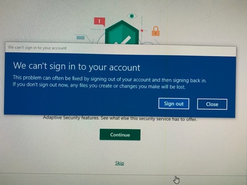

Ik krijg nu meteen na opstarten de melding
Can’t sign in to your account
The problem can often be fixed by signing out and then back in again. If you don’t sign out now, and files you create or changes you make, will be lost.
Afbeeldingslocatie: https://tweakers.net/i/hN1lbT3EAmfl6l_uwI_VyoJHMv4=/full-fit-in/4920x3264/filters:max_bytes(3145728):no_upscale():strip_icc():fill(white):strip_exif()/f/image/WHZzsTx4ncmiuvfd76LoM3Fh.jpg?f=user_large
Maar opnieuw inloggen geeft precies hetzelfde resultaat.
