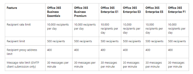

Hier staan de limit's per exchange online plan.
Afbeeldingslocatie: https://tweakers.net/i/6-OPYo3La-Bn8boQdxs9Zz2Byl0=/full-fit-in/4000x4000/filters:no_upscale():fill(white):strip_exif()/f/image/Q7bQgKDUV7nIeLb0FlPjLvab.png?f=user_large
