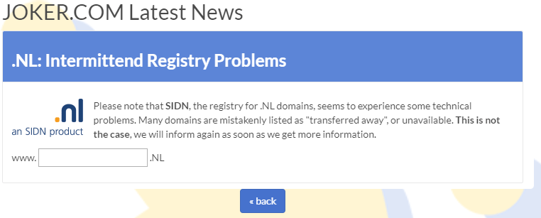

[edit]
Blijkbaar issues tussen Joker.com en SIDN.
JokerSIDNIssues
Thanks @vj_slof

Net een bericht van joker.com terug.
Dear Customer,
we have already reported this to sidn, .nl registry.
Since yesterday 02:00 UTC, sidn registry has reported all .nl domains as
to be NOT on our account.
This is normally only the case when a domain is transferred out. Because
of that you have been informed about a losing transfer.
Obviously this is not the case but a technically problem on their side.
We are currently checking with sidn registry , how and why this happened.
Fact is that the domains are still resolving.
We will restore your domains today in our system as soon as the reason
for the issue has been fixed by sidn.
We apologize for the inconvenience this may have caused.

Ja, ik heb hetzelfde probleem bij 1 van mijn .nl domeinen. Meteen Joker gemaild en had later ook dat nieuwsbericht gezien. Er staat alleen niets over op de SIDN pagina. Heel vreemd allemaal. Mijn email komt trouwens wel gewoon binnen nog.
Edit: Net ook een reactie van Joker ontvangen. Zelfde bericht als hierboven.
