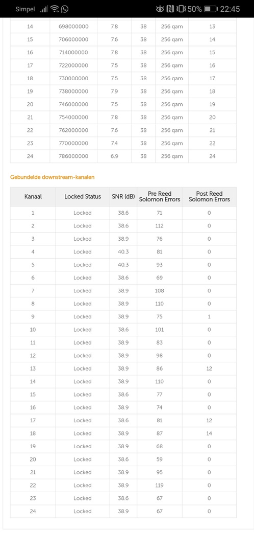

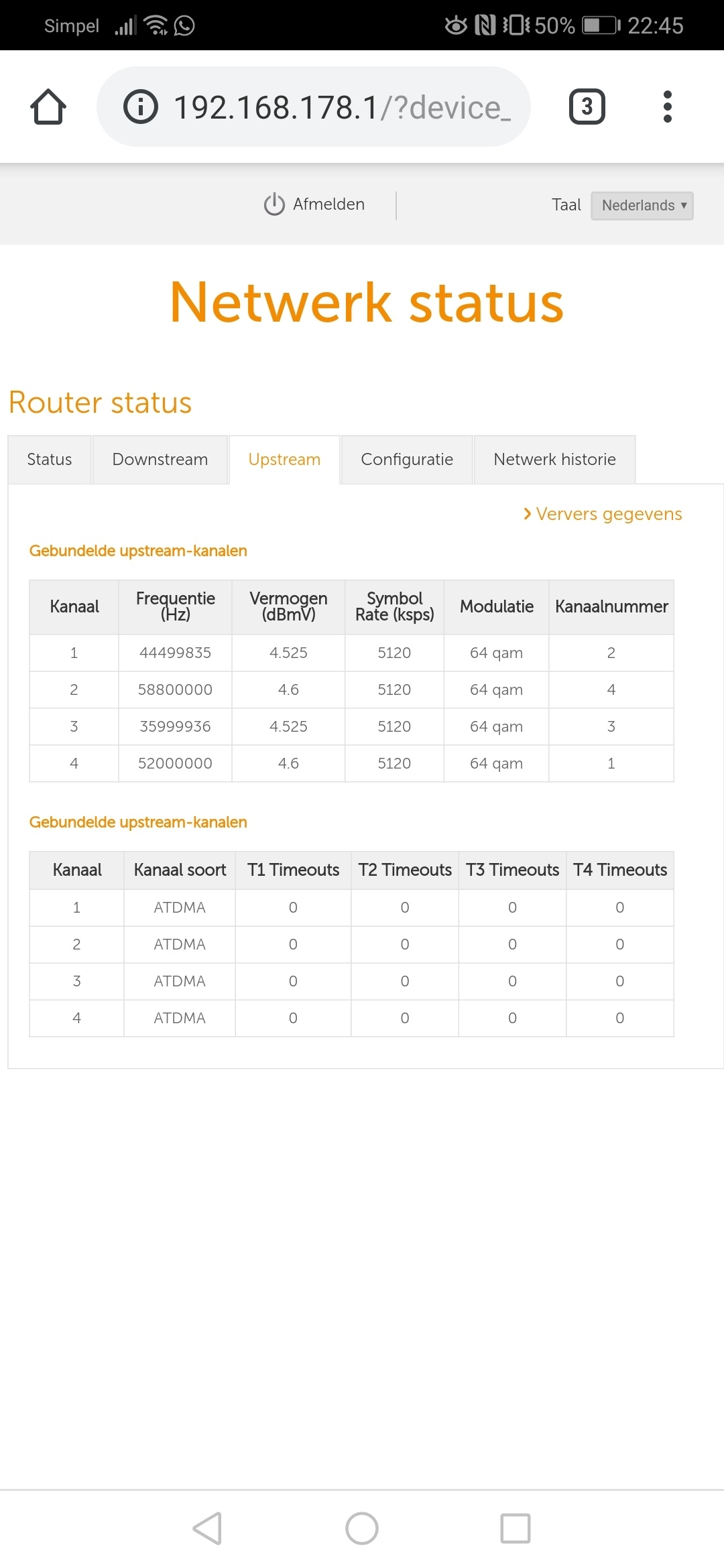

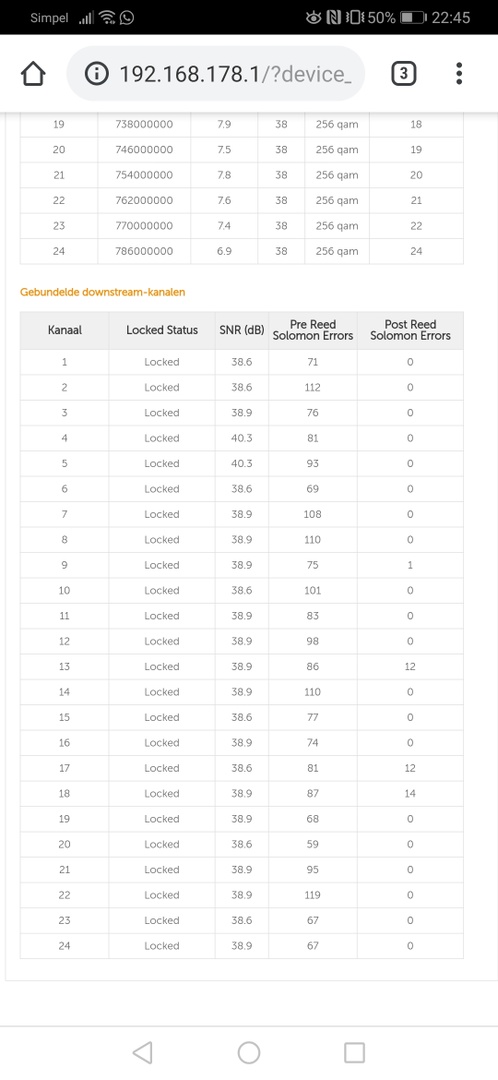

Websites die soms niet of zeer langzaam laden en apparaten die niet goed reageren zoals Chromecast en Google home.
Tweakers
Afbeeldingslocatie: https://tweakers.net/ext/f/sCMIWQhFl3TKxNhg5oP3aBsV/thumb.jpgAfbeeldingslocatie: https://tweakers.net/ext/f/C7a5DnlbYpZLIsgUu9TOXKdb/thumb.jpgAfbeeldingslocatie: https://tweakers.net/ext/f/A3LAA0HOIiEw0izuncPU8OOP/thumb.jpg
Afbeeldingslocatie: https://tweakers.net/ext/f/MyfuoWqa5k40k0iJQtdVGWG5/thumb.jpg
Netwerk historie
Tijd Prioriteit Omschrijving
20/05/2019 14:16:49 critical SYNC Timing Synchronization failure - Loss of Sync;CM-MAC=40:0d:10:89:58:d3;CMTS-MAC=00:01:5c:77:d2:61;CM-QOS=1.1;CM-VER=3.0;
20/05/2019 14:16:49 Let op! RCS Partial Service;CM-MAC=40:0d:10:89:58:d3;CMTS-MAC=00:01:5c:77:d2:61;CM-QOS=1.1;CM-VER=3.0;
20/05/2019 14:16:50 critical SYNC Timing Synchronization failure - Loss of Sync;CM-MAC=40:0d:10:89:58:d3;CMTS-MAC=00:01:5c:77:d2:61;CM-QOS=1.1;CM-VER=3.0;
20/05/2019 14:16:50 Let op! RCS Partial Service;CM-MAC=40:0d:10:89:58:d3;CMTS-MAC=00:01:5c:77:d2:61;CM-QOS=1.1;CM-VER=3.0;
20/05/2019 14:16:53 Let op! Lost MDD Timeout;CM-MAC=40:0d:10:89:58:d3;CMTS-MAC=00:01:5c:77:d2:61;CM-QOS=1.1;CM-VER=3.0;
20/05/2019 14:20:49 critical Received Response to Broadcast Maintenance Request, But no Unicast Maintenance opportunities received - T4 time out;CM-MAC=40:0d:10:89:58:d3;CMTS-MAC=00:01:5c:77:d2:61;CM-QOS=1.1;CM-VER=3.0;
20/05/2019 14:22:48 critical No Ranging Response received - T3 time-out;CM-MAC=40:0d:10:89:58:d3;CMTS-MAC=00:01:5c:77:d2:61;CM-QOS=1.1;CM-VER=3.0;
25/05/2019 15:31:45 notice SW Download INIT - Via Config file
25/05/2019 15:34:0 notice SW download Successful - Via Config file
29/05/2019 19:20:40 critical No Ranging Response received - T3 time-out;CM-MAC=40:0d:10:89:58:d3;CMTS-MAC=00:01:5c:77:d2:61;CM-QOS=1.1;CM-VER=3.0;
05/06/2019 23:36:16 Let op! RCS Partial Service;CM-MAC=40:0d:10:89:58:d3;CMTS-MAC=00:01:5c:77:d2:61;CM-QOS=1.1;CM-VER=3.0;
01/01/1970 00:01:39 critical No Ranging Response received - T3 time-out;CM-MAC=40:0d:10:89:58:d3;CMTS-MAC=00:01:5c:77:d2:61;CM-QOS=1.1;CM-VER=3.0;
09/06/2019 10:23:13 Let op! RCS Partial Service;CM-MAC=40:0d:10:89:58:d3;CMTS-MAC=00:01:5c:77:d2:61;CM-QOS=1.1;CM-VER=3.0;
01/01/1970 00:01:36 critical No Ranging Response received - T3 time-out;CM-MAC=40:0d:10:89:58:d3;CMTS-MAC=00:01:5c:77:d2:61;CM-QOS=1.1;CM-VER=3.0;
13/06/2019 11:54:45 Let op! RCS Partial Service;CM-MAC=40:0d:10:89:58:d3;CMTS-MAC=00:01:5c:77:d2:61;CM-QOS=1.1;CM-VER=3.0;
18/06/2019 16:31:15 critical No Ranging Response received - T3 time-out;CM-MAC=40:0d:10:89:58:d3;CMTS-MAC=00:01:5c:77:d2:61;CM-QOS=1.1;CM-VER=3.0;
22/06/2019 08:42:3 Let op! RCS Partial Service;CM-MAC=40:0d:10:89:58:d3;CMTS-MAC=00:01:5c:77:d2:61;CM-QOS=1.1;CM-VER=3.0;
01/01/1970 00:01:37 critical No Ranging Response received - T3 time-out;CM-MAC=40:0d:10:89:58:d3;CMTS-MAC=00:01:5c:77:d2:61;CM-QOS=1.1;CM-VER=3.0;

Ziggo... Google maar eens "No Ranging Response received" en je wordt doodgegooid met aannames en constateringen.

Het wordt tijd dat je met een betere probleem omschrijving komt want traag/haperend internet kan ook door een brakke utp kabel veroorzaakt worden of door een overvolle wifi band
Je network historie helpt ons niet verder; die geeft alleen maar aan dat je in de afgelopen maand je modem 5 keer gereboot hebt
