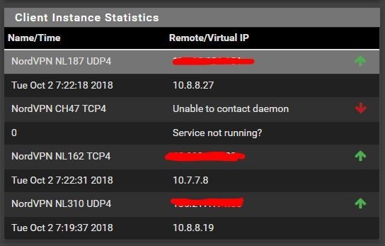

  • CollisionNL
  • Laatst online: 20-09 22:38
@Rolfie @Room42 Nou het was vannacht gelijk weer raak. De log in pfSense kan maar tot max 2000 entries vanuit de GUI.
De OpenVPN logs zien er als volgt uit en dit gaat net zolang door tot ik ochtends de restart heb uitgevoerd:

Aug 28 01:41:59 openvpn[5787]: NOTE: the current --script-security setting may allow this configuration to call user-defined scripts
Aug 28 01:41:59 openvpn[7678]: Restart pause, 300 second(s)
Aug 28 01:41:59 openvpn[7678]: SIGUSR1[soft,init_instance] received, process restarting
Aug 28 01:41:59 openvpn[7678]: Could not determine IPv4/IPv6 protocol
Aug 28 01:41:59 openvpn[7678]: RESOLVE: Cannot resolve host address: nl310.nordvpn.com:1194 (hostname nor servname provided, or not known)
Aug 28 01:41:59 openvpn[7678]: NOTE: the current --script-security setting may allow this configuration to call user-defined scripts
Aug 28 01:41:58 openvpn[4978]: Restart pause, 300 second(s)
Aug 28 01:41:58 openvpn[4978]: SIGUSR1[soft,init_instance] received, process restarting
Aug 28 01:41:58 openvpn[4978]: Could not determine IPv4/IPv6 protocol
Aug 28 01:41:58 openvpn[4978]: RESOLVE: Cannot resolve host address: nl187.nordvpn.com:1194 (hostname nor servname provided, or not known)
Aug 28 01:41:58 openvpn[4978]: NOTE: the current --script-security setting may allow this configuration to call user-defined scripts
Aug 28 01:36:59 openvpn[7678]: Restart pause, 300 second(s)
Aug 28 01:36:59 openvpn[7678]: SIGUSR1[soft,init_instance] received, process restarting
Aug 28 01:36:59 openvpn[7678]: Could not determine IPv4/IPv6 protocol
Aug 28 01:36:59 openvpn[7678]: RESOLVE: Cannot resolve host address: nl310.nordvpn.com:1194 (hostname nor servname provided, or not known)
Aug 28 01:36:59 openvpn[7678]: NOTE: the current --script-security setting may allow this configuration to call user-defined scripts
Aug 28 01:36:59 openvpn[6650]: Restart pause, 300 second(s)
Aug 28 01:36:59 openvpn[6650]: SIGUSR1[soft,init_instance] received, process restarting
Aug 28 01:36:59 openvpn[6650]: Could not determine IPv4/IPv6 protocol
Aug 28 01:36:59 openvpn[6650]: RESOLVE: Cannot resolve host address: nl162.nordvpn.com:443 (hostname nor servname provided, or not known)
Aug 28 01:36:59 openvpn[5787]: Restart pause, 300 second(s)
Aug 28 01:36:59 openvpn[5787]: SIGUSR1[soft,init_instance] received, process restarting
Aug 28 01:36:59 openvpn[5787]: Could not determine IPv4/IPv6 protocol
Aug 28 01:36:59 openvpn[5787]: RESOLVE: Cannot resolve host address: ch47.nordvpn.com:443 (hostname nor servname provided, or not known)
Aug 28 01:36:58 openvpn[6650]: RESOLVE: Cannot resolve host address: nl162.nordvpn.com:443 (hostname nor servname provided, or not known)
Aug 28 01:36:58 openvpn[5787]: RESOLVE: Cannot resolve host address: ch47.nordvpn.com:443 (hostname nor servname provided, or not known)
Aug 28 01:36:58 openvpn[5787]: NOTE: the current --script-security setting may allow this configuration to call user-defined scripts
Aug 28 01:36:58 openvpn[6650]: NOTE: the current --script-security setting may allow this configuration to call user-defined scripts
Aug 28 01:36:58 openvpn[4978]: Restart pause, 300 second(s)
Aug 28 01:36:58 openvpn[4978]: SIGUSR1[soft,init_instance] received, process restarting
Aug 28 01:36:58 openvpn[4978]: Could not determine IPv4/IPv6 protocol
Aug 28 01:36:58 openvpn[4978]: RESOLVE: Cannot resolve host address: nl187.nordvpn.com:1194 (hostname nor servname provided, or not known)
Aug 28 01:36:58 openvpn[4978]: NOTE: the current --script-security setting may allow this configuration to call user-defined scripts
De DNS log via de GUI is meer dan 2000 entries dus deze zal ik anders moeten ophalen maar ik zit nu niet thuis.
Ik neem aan dat de DNS de meeste info bevat?

Sep 14 12:31:02 openvpn[28519]: event_wait : Interrupted system call (code=4)
Sep 14 12:31:02 openvpn[28519]: /usr/local/sbin/ovpn-linkdown ovpns1 1500 1621 10.0.22.1 255.255.255.0 init
Sep 14 12:31:02 openvpn[28519]: SIGTERM[hard,] received, process exiting
Sep 14 12:31:02 openvpn[82412]: WARNING: POTENTIALLY DANGEROUS OPTION --verify-client-cert none|optional (or --client-cert-not-required) may accept clients which do not present a certificate
Sep 14 12:31:02 openvpn[82412]: OpenVPN 2.4.4 amd64-portbld-freebsd11.1 [SSL (OpenSSL)] [LZO] [LZ4] [MH/RECVDA] [AEAD] built on Mar 16 2018
Sep 14 12:31:02 openvpn[82412]: library versions: OpenSSL 1.0.2m-freebsd 2 Nov 2017, LZO 2.10
Sep 14 12:31:02 openvpn[82662]: NOTE: the current --script-security setting may allow this configuration to call user-defined scripts
Sep 14 12:31:02 openvpn[82662]: TUN/TAP device ovpns1 exists previously, keep at program end
Sep 14 12:31:02 openvpn[82662]: TUN/TAP device /dev/tun1 opened
Sep 14 12:31:02 openvpn[82662]: do_ifconfig, tt->did_ifconfig_ipv6_setup=0
Sep 14 12:31:02 openvpn[82662]: /sbin/ifconfig ovpns1 10.0.22.1 10.0.22.2 mtu 1500 netmask 255.255.255.0 up
Sep 14 12:31:02 openvpn[82662]: /usr/local/sbin/ovpn-linkup ovpns1 1500 1621 10.0.22.1 255.255.255.0 init
Sep 14 12:31:02 openvpn[82662]: UDPv4 link local (bound): [AF_INET]84.104.30.137:1194
Sep 14 12:31:02 openvpn[82662]: UDPv4 link remote: [AF_UNSPEC]
Sep 14 12:31:02 openvpn[82662]: Initialization Sequence Completed
Sep 14 12:31:02 openvpn[35067]: event_wait : Interrupted system call (code=4)
Sep 14 12:31:02 openvpn[35067]: Closing TUN/TAP interface
Sep 14 12:31:02 openvpn[35067]: /usr/local/sbin/ovpn-linkdown ovpnc2 1500 1585 10.8.8.27 255.255.255.0 init
Sep 14 12:31:02 openvpn[35067]: SIGTERM[hard,] received, process exiting
Sep 14 12:31:03 openvpn[85305]: WARNING: file '/var/etc/openvpn/client2.up' is group or others accessible
Sep 14 12:31:03 openvpn[85305]: OpenVPN 2.4.4 amd64-portbld-freebsd11.1 [SSL (OpenSSL)] [LZO] [LZ4] [MH/RECVDA] [AEAD] built on Mar 16 2018
Sep 14 12:31:03 openvpn[85305]: library versions: OpenSSL 1.0.2m-freebsd 2 Nov 2017, LZO 2.10
Sep 14 12:31:03 openvpn[85418]: MANAGEMENT: unix domain socket listening on /var/etc/openvpn/client2.sock
Sep 14 12:31:03 openvpn[85418]: NOTE: the current --script-security setting may allow this configuration to call user-defined scripts
Sep 14 12:31:03 openvpn[85418]: Outgoing Control Channel Authentication: Using 512 bit message hash 'SHA512' for HMAC authentication
Sep 14 12:31:03 openvpn[85418]: Incoming Control Channel Authentication: Using 512 bit message hash 'SHA512' for HMAC authentication
Sep 14 12:31:03 openvpn[35507]: event_wait : Interrupted system call (code=4)
Sep 14 12:31:03 openvpn[35507]: Closing TUN/TAP interface
Sep 14 12:31:03 openvpn[35507]: /usr/local/sbin/ovpn-linkdown ovpnc3 1500 1587 10.7.7.8 255.255.255.0 init
Sep 14 12:31:03 openvpn[35507]: SIGTERM[hard,] received, process exiting
Sep 14 12:31:03 openvpn[86874]: WARNING: file '/var/etc/openvpn/client3.up' is group or others accessible
Sep 14 12:31:03 openvpn[86874]: OpenVPN 2.4.4 amd64-portbld-freebsd11.1 [SSL (OpenSSL)] [LZO] [LZ4] [MH/RECVDA] [AEAD] built on Mar 16 2018
Sep 14 12:31:03 openvpn[86874]: library versions: OpenSSL 1.0.2m-freebsd 2 Nov 2017, LZO 2.10
Sep 14 12:31:03 openvpn[86892]: MANAGEMENT: unix domain socket listening on /var/etc/openvpn/client3.sock
Sep 14 12:31:03 openvpn[86892]: NOTE: the current --script-security setting may allow this configuration to call user-defined scripts
Sep 14 12:31:03 openvpn[86892]: Outgoing Control Channel Authentication: Using 512 bit message hash 'SHA512' for HMAC authentication
Sep 14 12:31:03 openvpn[86892]: Incoming Control Channel Authentication: Using 512 bit message hash 'SHA512' for HMAC authentication
Sep 14 12:31:03 openvpn[36182]: event_wait : Interrupted system call (code=4)
Sep 14 12:31:03 openvpn[36182]: Closing TUN/TAP interface
Sep 14 12:31:03 openvpn[36182]: /usr/local/sbin/ovpn-linkdown ovpnc5 1500 1587 10.7.7.8 255.255.255.0 init
Sep 14 12:31:03 openvpn[36182]: SIGTERM[hard,] received, process exiting
Sep 14 12:31:03 openvpn[98681]: WARNING: file '/var/etc/openvpn/client5.up' is group or others accessible
Sep 14 12:31:03 openvpn[98681]: OpenVPN 2.4.4 amd64-portbld-freebsd11.1 [SSL (OpenSSL)] [LZO] [LZ4] [MH/RECVDA] [AEAD] built on Mar 16 2018
Sep 14 12:31:03 openvpn[98681]: library versions: OpenSSL 1.0.2m-freebsd 2 Nov 2017, LZO 2.10
Sep 14 12:31:03 openvpn[99023]: MANAGEMENT: unix domain socket listening on /var/etc/openvpn/client5.sock
Sep 14 12:31:03 openvpn[99023]: NOTE: the current --script-security setting may allow this configuration to call user-defined scripts
Sep 14 12:31:03 openvpn[99023]: Outgoing Control Channel Authentication: Using 512 bit message hash 'SHA512' for HMAC authentication
Sep 14 12:31:03 openvpn[99023]: Incoming Control Channel Authentication: Using 512 bit message hash 'SHA512' for HMAC authentication
Sep 14 12:31:03 openvpn[36824]: event_wait : Interrupted system call (code=4)
Sep 14 12:31:03 openvpn[36824]: Closing TUN/TAP interface
Sep 14 12:31:03 openvpn[36824]: /usr/local/sbin/ovpn-linkdown ovpnc4 1500 1585 10.8.8.19 255.255.255.0 init
Sep 14 12:31:03 openvpn[36824]: SIGTERM[hard,] received, process exiting
Sep 14 12:31:04 openvpn[10964]: WARNING: file '/var/etc/openvpn/client4.up' is group or others accessible
Sep 14 12:31:04 openvpn[10964]: OpenVPN 2.4.4 amd64-portbld-freebsd11.1 [SSL (OpenSSL)] [LZO] [LZ4] [MH/RECVDA] [AEAD] built on Mar 16 2018
Sep 14 12:31:04 openvpn[10964]: library versions: OpenSSL 1.0.2m-freebsd 2 Nov 2017, LZO 2.10
Sep 14 12:31:04 openvpn[11232]: MANAGEMENT: unix domain socket listening on /var/etc/openvpn/client4.sock
Sep 14 12:31:04 openvpn[11232]: NOTE: the current --script-security setting may allow this configuration to call user-defined scripts
Sep 14 12:31:04 openvpn[11232]: Outgoing Control Channel Authentication: Using 512 bit message hash 'SHA512' for HMAC authentication
Sep 14 12:31:04 openvpn[11232]: Incoming Control Channel Authentication: Using 512 bit message hash 'SHA512' for HMAC authentication
Sep 14 12:31:07 openvpn[82662]: event_wait : Interrupted system call (code=4)
Sep 14 12:31:07 openvpn[82662]: /usr/local/sbin/ovpn-linkdown ovpns1 1500 1621 10.0.22.1 255.255.255.0 init
Sep 14 12:31:07 openvpn[82662]: SIGTERM[hard,] received, process exiting
Sep 14 12:31:07 openvpn[66621]: WARNING: POTENTIALLY DANGEROUS OPTION --verify-client-cert none|optional (or --client-cert-not-required) may accept clients which do not present a certificate
Sep 14 12:31:07 openvpn[66621]: OpenVPN 2.4.4 amd64-portbld-freebsd11.1 [SSL (OpenSSL)] [LZO] [LZ4] [MH/RECVDA] [AEAD] built on Mar 16 2018
Sep 14 12:31:07 openvpn[66621]: library versions: OpenSSL 1.0.2m-freebsd 2 Nov 2017, LZO 2.10
Sep 14 12:31:07 openvpn[66707]: NOTE: the current --script-security setting may allow this configuration to call user-defined scripts
Sep 14 12:31:07 openvpn[66707]: TUN/TAP device ovpns1 exists previously, keep at program end
Sep 14 12:31:07 openvpn[66707]: TUN/TAP device /dev/tun1 opened
Sep 14 12:31:07 openvpn[66707]: do_ifconfig, tt->did_ifconfig_ipv6_setup=0
Sep 14 12:31:07 openvpn[66707]: /sbin/ifconfig ovpns1 10.0.22.1 10.0.22.2 mtu 1500 netmask 255.255.255.0 up
Sep 14 12:31:07 openvpn[66707]: /usr/local/sbin/ovpn-linkup ovpns1 1500 1621 10.0.22.1 255.255.255.0 init
Sep 14 12:31:07 openvpn[66707]: UDPv4 link local (bound): [AF_INET]84.104.30.137:1194
Sep 14 12:31:07 openvpn[66707]: UDPv4 link remote: [AF_UNSPEC]
Sep 14 12:31:07 openvpn[66707]: Initialization Sequence Completed
Sep 14 12:31:09 openvpn[99023]: RESOLVE: Cannot resolve host address: nl162.nordvpn.com:443 (hostname nor servname provided, or not known)
Sep 14 12:31:09 openvpn[85418]: RESOLVE: Cannot resolve host address: nl187.nordvpn.com:1194 (hostname nor servname provided, or not known)
Sep 14 12:31:09 openvpn[99023]: SIGUSR1[soft,init_instance] received, process restarting
Sep 14 12:31:09 openvpn[99023]: Restart pause, 10 second(s)
Sep 14 12:31:10 openvpn[76762]: WARNING: file '/var/etc/openvpn/client2.up' is group or others accessible
Sep 14 12:31:10 openvpn[76762]: OpenVPN 2.4.4 amd64-portbld-freebsd11.1 [SSL (OpenSSL)] [LZO] [LZ4] [MH/RECVDA] [AEAD] built on Mar 16 2018
Sep 14 12:31:10 openvpn[76762]: library versions: OpenSSL 1.0.2m-freebsd 2 Nov 2017, LZO 2.10
Sep 14 12:31:10 openvpn[76803]: MANAGEMENT: unix domain socket listening on /var/etc/openvpn/client2.sock
Sep 14 12:31:10 openvpn[76803]: NOTE: the current --script-security setting may allow this configuration to call user-defined scripts
Sep 14 12:31:10 openvpn[76803]: Outgoing Control Channel Authentication: Using 512 bit message hash 'SHA512' for HMAC authentication
Sep 14 12:31:10 openvpn[76803]: Incoming Control Channel Authentication: Using 512 bit message hash 'SHA512' for HMAC authentication
Sep 14 12:31:10 openvpn[86892]: SIGTERM[hard,init_instance] received, process exiting
Sep 14 12:31:10 openvpn[76803]: Could not determine IPv4/IPv6 protocol
Sep 14 12:31:10 openvpn[76803]: SIGUSR1[soft,init_instance] received, process restarting
Sep 14 12:31:10 openvpn[76803]: Restart pause, 10 second(s)
Sep 14 12:31:11 openvpn[77039]: WARNING: file '/var/etc/openvpn/client3.up' is group or others accessible
Sep 14 12:31:11 openvpn[77039]: OpenVPN 2.4.4 amd64-portbld-freebsd11.1 [SSL (OpenSSL)] [LZO] [LZ4] [MH/RECVDA] [AEAD] built on Mar 16 2018
Sep 14 12:31:11 openvpn[77039]: library versions: OpenSSL 1.0.2m-freebsd 2 Nov 2017, LZO 2.10
Sep 14 12:31:11 openvpn[77297]: MANAGEMENT: unix domain socket listening on /var/etc/openvpn/client3.sock
Sep 14 12:31:11 openvpn[77297]: NOTE: the current --script-security setting may allow this configuration to call user-defined scripts
Sep 14 12:31:11 openvpn[77297]: Outgoing Control Channel Authentication: Using 512 bit message hash 'SHA512' for HMAC authentication
Sep 14 12:31:11 openvpn[77297]: Incoming Control Channel Authentication: Using 512 bit message hash 'SHA512' for HMAC authentication
Sep 14 12:31:11 openvpn[99023]: SIGTERM[hard,init_instance] received, process exiting
Sep 14 12:31:11 openvpn[77297]: RESOLVE: Cannot resolve host address: ch47.nordvpn.com:443 (hostname nor servname provided, or not known)
Sep 14 12:31:11 openvpn[77297]: SIGUSR1[soft,init_instance] received, process restarting
Sep 14 12:31:11 openvpn[77297]: Restart pause, 10 second(s)
Sep 14 12:31:11 openvpn[78118]: WARNING: file '/var/etc/openvpn/client5.up' is group or others accessible
Sep 14 12:31:11 openvpn[78118]: OpenVPN 2.4.4 amd64-portbld-freebsd11.1 [SSL (OpenSSL)] [LZO] [LZ4] [MH/RECVDA] [AEAD] built on Mar 16 2018
Sep 14 12:31:11 openvpn[78118]: library versions: OpenSSL 1.0.2m-freebsd 2 Nov 2017, LZO 2.10
Sep 14 12:31:11 openvpn[78452]: MANAGEMENT: unix domain socket listening on /var/etc/openvpn/client5.sock
Sep 14 12:31:11 openvpn[78452]: NOTE: the current --script-security setting may allow this configuration to call user-defined scripts
Sep 14 12:31:11 openvpn[78452]: Outgoing Control Channel Authentication: Using 512 bit message hash 'SHA512' for HMAC authentication
Sep 14 12:31:11 openvpn[78452]: Incoming Control Channel Authentication: Using 512 bit message hash 'SHA512' for HMAC authentication
Sep 14 12:31:11 openvpn[78452]: RESOLVE: Cannot resolve host address: nl162.nordvpn.com:443 (hostname nor servname provided, or not known)
Sep 14 12:31:11 openvpn[11232]: SIGTERM[hard,init_instance] received, process exiting
Sep 14 12:31:11 openvpn[78452]: SIGUSR1[soft,init_instance] received, process restarting
Sep 14 12:31:11 openvpn[78452]: Restart pause, 10 second(s)
Sep 14 12:31:11 openvpn[79009]: WARNING: file '/var/etc/openvpn/client4.up' is group or others accessible
Sep 14 12:31:11 openvpn[79009]: OpenVPN 2.4.4 amd64-portbld-freebsd11.1 [SSL (OpenSSL)] [LZO] [LZ4] [MH/RECVDA] [AEAD] built on Mar 16 2018
Sep 14 12:31:11 openvpn[79009]: library versions: OpenSSL 1.0.2m-freebsd 2 Nov 2017, LZO 2.10
Sep 14 12:31:11 openvpn[79348]: MANAGEMENT: unix domain socket listening on /var/etc/openvpn/client4.sock
Sep 14 12:31:11 openvpn[79348]: NOTE: the current --script-security setting may allow this configuration to call user-defined scripts
Sep 14 12:31:11 openvpn[79348]: Outgoing Control Channel Authentication: Using 512 bit message hash 'SHA512' for HMAC authentication
Sep 14 12:31:11 openvpn[79348]: Incoming Control Channel Authentication: Using 512 bit message hash 'SHA512' for HMAC authentication
Sep 14 12:31:11 openvpn[79348]: RESOLVE: Cannot resolve host address: nl310.nordvpn.com:1194 (hostname nor servname provided, or not known)
Sep 14 12:31:11 openvpn[79348]: Could not determine IPv4/IPv6 protocol
Sep 14 12:31:11 openvpn[79348]: SIGUSR1[soft,init_instance] received, process restarting
Sep 14 12:31:11 openvpn[79348]: Restart pause, 10 second(s)
Sep 14 12:31:20 openvpn[76803]: RESOLVE: Cannot resolve host address: nl187.nordvpn.com:1194 (hostname nor servname provided, or not known)

  • CollisionNL
Excuses ik heb geen melding gehad van jullie berichten.
Rolfie schreef op vrijdag 14 september 2018 @ 15:16:
Wat draait er op het IP: 10.8.8.19
Is dat toevallig een OpenVPN adapter IP?
Check eens op DNS daarop mag luisteren? Kan je de DNS server uitzetten op die interface?
Een van de OpenVPN tunnels.
Afbeeldingslocatie: https://tweakers.net/ext/f/dOBPbHbbJCRQHPAk43Mfz6as/medium.jpg

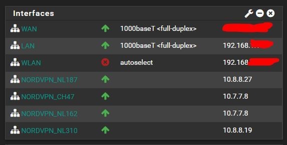

  • CollisionNL
Kennen jullie dat, dat sommige zaken zichzelf oplossen..?
Door tijdsgebrek helaas niet verder kunnen testen nav jullie input. Afgelopen week viel het mij opeens op dat ik niet elke ochtend de service hoefde te restarten. Ingelogd via gui en er stond bovenaan een crashreport melding. Geprobeerd deze te openen en dat is 1x gelukt en toen kon ik deze verzenden naar de ontwikkelaars.
Nadat ik terug kwam op het startscherm viel mij het volgende op:
Afbeeldingslocatie: https://tweakers.net/ext/f/k3MIZghsRVvHEdN0YDFCciew/thumb.jpg
De service van deze interface wil niet restarten. Kan het zijn dat er wat is geweest met deze verbinding en dat daarom de verbinding snachts er uit klapte? (door iets aan de serverside)
