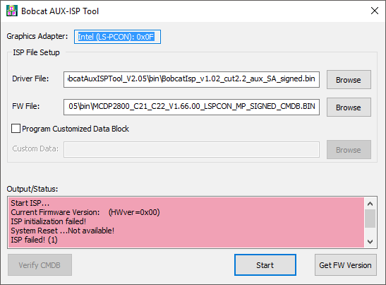

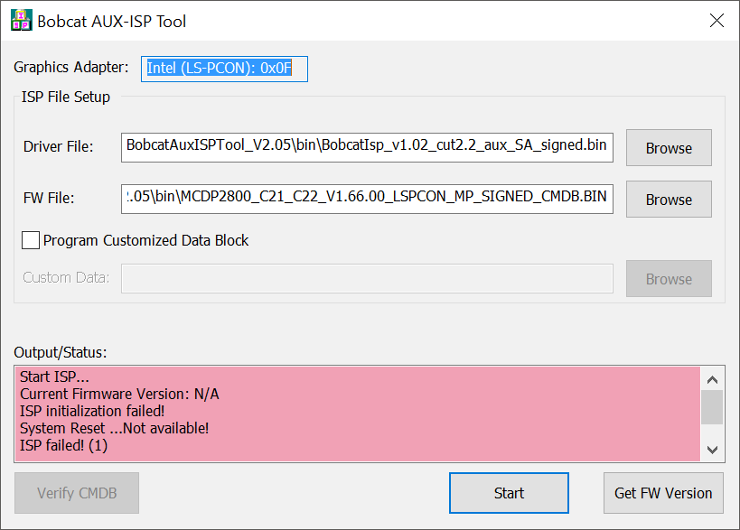

  • Geprobeerd de LSPCON-firmware bij te werken. Ik kreeg dit echter niet aan de praat. "Firmware update can't be started".
  • [/list] [code] Gfx Selection = 3 Graphics adapter initialization - Intel (LS-PCON): done! ==================================== 06/24/17 13:33:39 ==================================== Current Firmware Version: N/A ISP initialization failed! System Reset ...Not available! ISP failed! (1) ISP failed! (1) [/code]

Overigens is de output van de LSPCON upgrade tool anders bij verschillende drivers:
Microsoft Basic Display Adapter
Intel HD Graphics
Intel HD Graphics
