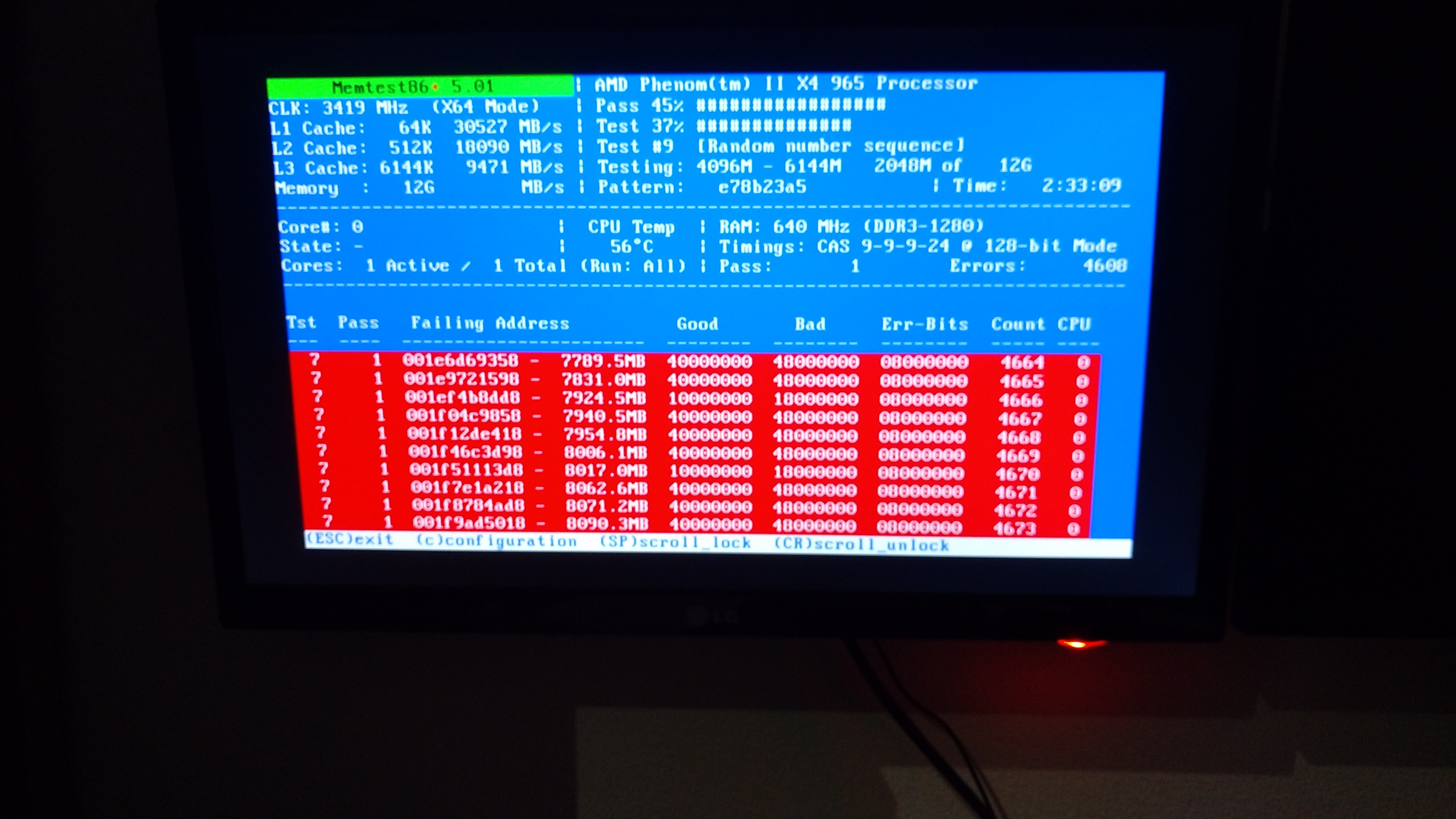

Ik heb in mijn PC 4 geheugen strips zitten. Memtest laten draaien en komt met flink wat errors. Allemaal bij 7-8GB.
Maar hoe kan ik nu achterhalen welke daadwerkelijk de schuldige is? Kan ik achterhalen vanuit memtest welke strip/gehugenslot dit is?
Plaatje van memtest (even klikken voor leesbaar formaat)

Volgens mij is die mogelijkheid er niet en zul je moeten testen per latje of per 2.
http://superuser.com/ques...dule-is-failing-memtest86
Zelfs memtest geeft het aan:
Once a memory error has been detected, determining the failing SIMM/DIMM module is not a clear cut procedure. With the large number of motherboard vendors and possible combinations of memory slots it would be difficult if not impossible to assemble complete information about how a particular error would map to a failing memory module. However, there are steps that may be taken to determine the failing module. Here are some techniques that you may wish to use:
Removing modules
This is simplest method for isolating a failing modules, but may only be employed when one or more modules can be removed from the system. By selectively removing modules from the system and then running the test you will be able to find the bad modules. Be sure to note exactly which modules are in the system when the test passes and when the test fails.
Rotating modules
When none of the modules can be removed then you may wish to rotate modules to find the failing one. This technique can only be used if there are three or more modules in the system. Change the location of two modules at a time. For example put the module from slot 1 into slot 2 and put the module from slot 2 in slot 1. Run the test and if either the failing bit or address changes then you know that the failing module is one of the ones just moved. By using several combinations of module movement you should be able to determine which module is failing.
Replacing modules
If you are unable to use either of the previous techniques then you are left to selective replacement of modules to find the failure.

Wat Outerspace aangeeft.
Als ik zo de hoeveelheid fouten zie dan zijn er misschien zelfs meerdere geheugenmodules niet helemaal lekker meer.
Ik zou gewoon 1 geheugenmodule in de pc doen en dan testen met Memtest.
Als je 1 hebt gevonden die niet goed werkt dan zou ik de rest alsnog ook controleren.

De kans dat er één of meerdere geheugenlatjes kapot zijn is groot. Andere oorzaken kunnen zijn:
- Bug in de BIOS: Geheugen staat te hoog geklokt, wordt te warm en geeft vervolgens fouten.
- Moederborddefect: Lekkende of bolstaande elco's rondom de geheugenslots.
- Statische lading, wanneer pc niet is aangesloten op een correct geaarde wandcontactdoos.
- Stof tussen de latjes en de sloten of een defect aan één of meerdere sloten door kortsluiting.
- Voeding geeft te weinig vermogen door aan (gedeeltes van) het moederbord.

Andere vraag, welk moederbord is het en welk geheugen ?
Als je nieuw geheugen hebt geplaatst, is dit wel compatibel ?

Het is een Gigabyte GA790xta-ud4 moederbord. Er zitten 2 typen geheugen op:
- G.Skill Ripjaw F3-14900CL9D=8GBXL
- OCZ 2x2GB welke ik zo snel niet kan achterhalen welke het precies is.
Maar met de Ripjaws eruit loopt de pc een heel stuk stabieler. Tot nu toe nog geen crashes... Dus daar lijkt het probleem te liggen.

Toch per DIMM testen met Memtest voor de zekerheid. Het zou één van de twee kunnen zijn. Het zou ook een compatibility issue kunnen zijn tussen de Ripjaws enerzijds en de OCZ DIMMs anderzijds, dus dat het met alleen de twee Ripjaws ook stabiel zou kunnen zijn.
Check daarnaast je settings - die Ripjaw Dimms willen 1.5V (high voltage DDR3). Als de OCZ reepjes 1.35V willen en het moederbord daarop ingesteld staat is het niet gek dat je problemen krijgt met de 1.5V DIMMs. Sowieso, bij hogere bus load (lees: alle DIMMslots bezet) 0.1V erbij is sowieso vaak een goed idee.

Juiste voltage ingesteld?

Ben nu de Ripjaws aan het testen. Hebben nu foutloos 2 passes gedaan. Lijkt dus de combinatie te zijn.
Hoe kan ik controleren hoe de voltages staan? In bios staan ze op auto...
