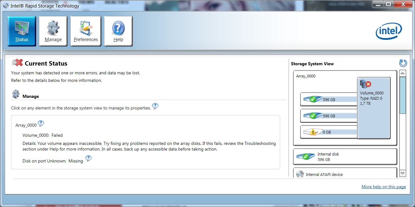

Een schijf stopt er mee in Windows 7, Raid 0 config.
Afbeeldingslocatie: http://tweakers.net/ext/f/nCBSkL7aNyp5FF6GZHpdbxhh/full.jpg
Is het nog te fixxen ?
Want de schijf wordt gewoon herkend in windows, maar vraagt om te formateren.
Bij opties staat alleen: Delete en geen reset ofzo ?

Nee, een RAID 0 failure is nagenoeg nooit te fixen.

alex3305 schreef op donderdag 06 september 2012 @ 22:08:
Okay en dit nog te proberen ?

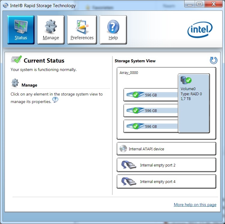

Lol, ik heb de data gewoon terug !! d:)b
Ligt aan die gare Intel ICH10R controller
Afbeeldingslocatie: http://tweakers.net/ext/f/c5nzRfx2TivGrxA0GY9fnh6J/full.jpg
Wat je doet, gewoon die guide volgen.
HowTo : Recover Intel RAID "Non-Member Disk" Error..
http://www.overclock.net/...aid-non-member-disk-error
Originally Posted by The Source Thread Above
Thanks to everyone who tried to help. I found a solution and I thought I'd share it. I was able to recover the broken array using following steps.
1. Reset both HDs to non-member using Intel BIOS utility - the utility warns that all data will be lost - in fact only metadata is lost and can be recreated using steps below.
2. Create a new array with identical settings as the broken array. It is critical that the HDs are in the array the same order as before. I was reconnecting the drives several times and lost track of correct order. Because of that I had to go through the steps twice (I guessed wrong the first time).
3. Get TestDisk from http://www.cgsecurity.org. I used Windows version (I installed a new Vista on a separate HD for this purpose).
4. Run TestDisk according to steps on the web site. If your HDs are connected in correct order, TestDisk should find the lost partition(s) within a few seconds. It ran for several hours, scanning my array and never found anything because I had HDs were connected in wrong order. After I changed the order and restarted from step #1 TestDisk found the missing partition immediately.
5. Have the TestDisk write the fixed partition table to the drive and reboot.
6. Now all your data on the array should be readable but the system might not boot (it didn't for me).
7. Run Vista repair from installation CD to fix the MBR.
Quote:
Originally Posted by Ictinike
On this part, a gent and myself went through this for Win 7 as well I've done Vista and we had to run the 3 bootrec commands to get his viable. I can't remember if I did this on Vista but it might be wise to run all three to fix the MBR in Vista as listed above. To do so:
in Command Prompt from the Recover console enter:
bootrec /fixmbr (should success)
bootrec /fixboot (should success)
bootrec /rebuildbcd (detects the Windows installation and asks you to add it to the BCD, hit YES)
8. Last but not least, send a donation to Mr. Grenier, the author of TestDisk.
