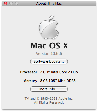

Ik heb gisteren 8GB van G.Skill in mijn Macbook Pro Unibody (late 2008) gedaan en het werkt als een trein. De volledige 8GB wordt gezien en mijn laptop is stabiel.
Op MacRumors loopt er een soort gelijke thread waarin wordt beweerd dat OSX vanaf versie 10.6.6 de volledige 8GB kan worden aangesproken.
Afbeeldingslocatie: http://img12.imageshack.us/img12/6475/screenshot20110213at514.jpg
Dit zijn de testresultaten van Rember.
Rember test "slechts" 6908MB omdat de rest van het geheugen door het OS wordt gebruikt en een deel wordt gereserveerd voor de NVIDIA kaart.

Rember Test Results
All tests passed!
Total built-in memory: 8 GB
    This is the total amount of physical memory that the computer has installed.  If this figure is not showing the correct amount of memory there may be a problem with one or more installed DIMMS.
Available memory: 6908 MB
    Available memory is the amount of physical memory that is currently not in use by any other processes.  All available memory will be used for testing when the "All" option is selected. To increase the amount of available memory, you can restart your computer before testing. If you are familiar with the command line (CLI), you can run memtest (the core of Rember) in single-user mode. See Rember help, or http://www.memtestosx.org for more information.
Requested amount: All MB
    The total amount of memory requested for testing by the Rember application. Not all requested memory can be allocated for testing. See information on "Available memory" for more information.
Memory allocated for testing: 6908 MB
    This is the total amount of memory that memtest was able to allocate for testing.  See "Available memory" section for more information.
Loops selected: 1
    Total loops selected by user for testing. All loops should complete when testing is successful. Test failure when the "Continue on Error" preference is selected will cancel tests before this number of loops has been completed. Users can also cancel testing before this number is reached.
Loops completed: 1
    Total loops completed by memtest.  Note that the Rember is not always able to identify how many loops ran.  If there are discrepancies between this and the loops selected, the log should be examined to determine exactly how many loops were performed.
Total execution time: All tests passed!  Execution time: 6549  seconds
    This is the total amount of time that it took to execute the selected tests. Execution time may vary from system to system, and is provided as a guide for determining how long users can expect tests to run based on the amount of memory installed on the system.
Testing start time: 2011-02-12 11:42:43 +0100
Testing end time: 2011-02-12 13:31:57 +0100
Rember version: 0.3.7b Memtest version: 4.22

Datzelfde geldt ook voor mijn MBP... 6GB zou kunnen, maar ik heb dus nu 8GB en werkt prima.
En heb je de boel al een goed laten vollopen? Dus dat er meer dan 6GB gebruikt wordt? Ben benieuwd of het dan wel zo stabiel blijft.
Hier nog wat fotos van de verpakking voor de geinteresseerden.
Afbeeldingslocatie: http://img97.imageshack.us/img97/28/79119033.jpg
Afbeeldingslocatie: http://img251.imageshack.us/img251/9361/65603424.jpg
Verwijderd schreef op zondag 13 februari 2011 @ 14:40:
Voor zover ik heb kunnen testen (Chrome 20 tabs + Safari 20 tabs + Photoshop CS5 + Office 2011 + Aperture + Illustrator CS5 + Windows 7 met 2GB via Parallels) loopt alles soepel. Ik wacht nu op een user van het forum van MacRumors die mij een app gaat toesturen dat je geheugen vol laat lopen.

Afbeeldingslocatie: http://tweakers.net/ext/f/ZQrAw8Wnu3KfEaB7Tn0IdhZP/full.png
Ook op mijn MacBook5.1 (unibody) draait 8GB prima nu. Memtest keurig doorgekomen ook.
Ik heb er de Kingston KTA-MB1066K2/8G in gestopt

Ok dat is mooi, heb zelf ook een Macbook5.1 (niet pro) en vroeg mij af of het kon.
Deze bevestiging is mooi :)
